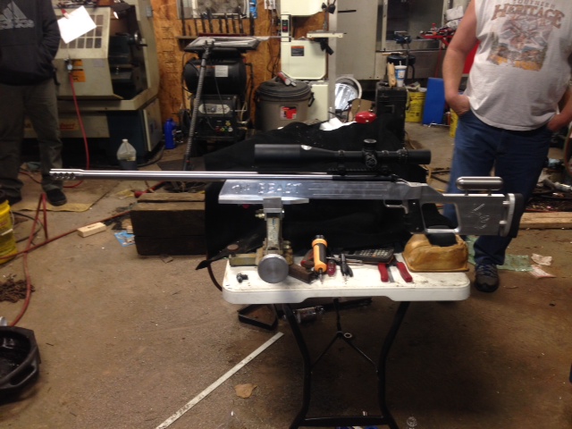

I'm new to this forum and was hoping for some help with load data for a 30-338 lapua mag.
I'm building a rifle in 30-338 lm and I can't find any data on it. the rifle is a wetherby vanguard action with a 28.5" shillen stainless steel barrel in an all aluminum stock which I machined. any help would be appreciated.
thanks keith

thanks for the idea. I kinda did the same thing with 30 06 and a 270 and figured out a percentage. I've taken it apart to sent to get ceracoted and anodized hopefully get it back together in a couple weeks and try it out.

Sorry I haven't been on here for a while. I just got the barrel back and got it bedded. Shot it this evening and was very pleased with the results. Still need to work up a load. Today we were shooting 85 grains of retumbo with a 190 gr. Sierra bthp. Getting 3000 fps and less than 1/2 " group at 100 yards. Would like to get a little more speed if possible.
just a quick update. ended up switching to h-1000 powder 87.5g,190g sierra matchkings, 3200 fps. happy with that. got to go shoot long range finally shot a 4,6,8,1000yrds with sub moa at 4,6,800 and moa at 1000. very happy with that. can't wait to go shoot prairie dogs in june.
