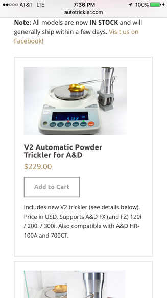

Oh and I'm also using the A&D FX120i scale with its trickler. It REALLY KEEPS THINGS VERY CONSISTENT!
