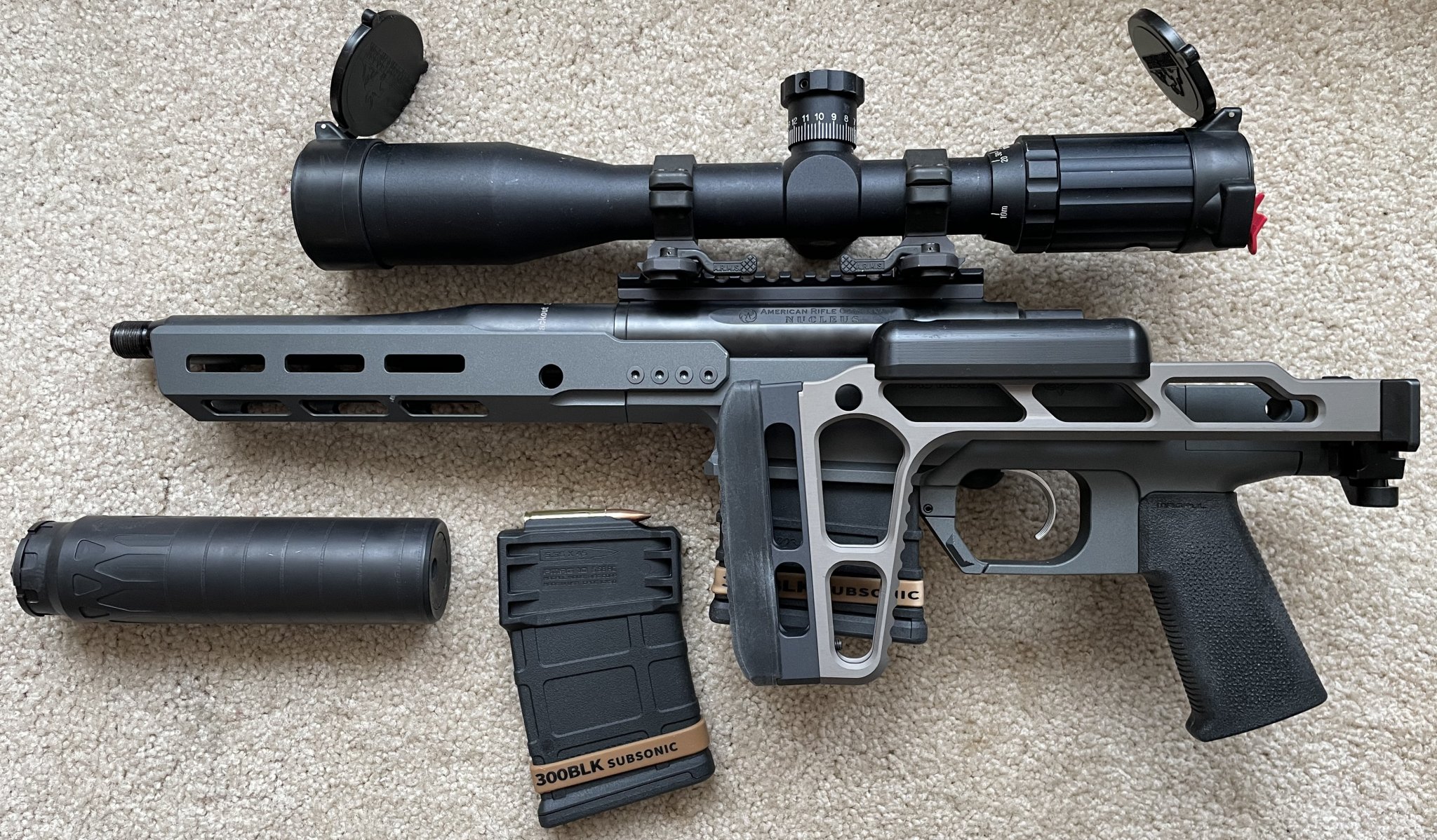

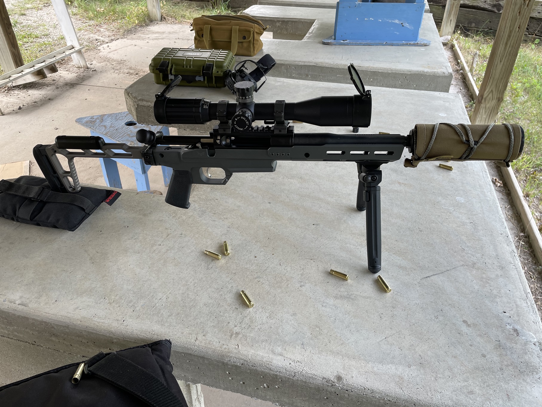

I built my own, because finding a 300blk that I wanted wasn't really out there; everything had baggage associated with it so I started with a clean slate.
Well...mainly I got an ARC Nucleus on sale last Thanksgiving and realized I didn't have a plan for it, so I made one ;)
ARC Nucleus, Preferred Barrels 9" 1/7" 300blk with a Sig taper, JTAC Screech Owl chassis, PMM "Kate Moss" stock, with a super early rev Dead Air Nomad-30 on the end of it, and a TriggerTech special on bottom. On top is an ancient 2001-ish Tasco Super Sniper 10x, which works for now...I've got another optic on order for it. I ordered the barrel and filed the paperwork to SBR it the same week; I got the SBR stamp back about a month before the barrel showed up :LOL: Not a knock on Preferred; all the barrel makers/fitters are slammed these days. Anyway the barrel just showed up on Friday, and yesterday I took it out just to make sure it wasn't a basket of shit.

The only issues I had with it were mag/feed related; Ruger .223 AICS mags don't feed at all so that's a wash; Magpul 223 AICS mags feed 3-4 rounds then rounds nosedive; you need to yank the mag and reseat the rounds and resume...the only mags that worked %100 were MDT plastic 223 AICS mags. But they are TIGHT...you need to really manhandle them in and out, not something you can do one-handed when seated or with the gun shouldered, really. At least not on mine. They seem a little wide for the stock; some rub/burnishing marks on both sides of the mag where it makes contact. I've got a few more on order now that I know they fit and work, even if they are tight.
Was it worth an expensive action, barrel, chassis, and time? Eh...maybe not really unless you have a varmint problem and need something small to pack in/out and hunt with? For a toy it's fun, though expensive. It is nice that you can fold it up to a tiny thing and shove it in a backpack...
I think money wise I'm a bit under a Q Mini Fix pistol and maybe even a little under a Christensen MPP, especially when you factor in the price of the stock and stamp which you'd need for both of those anyway.

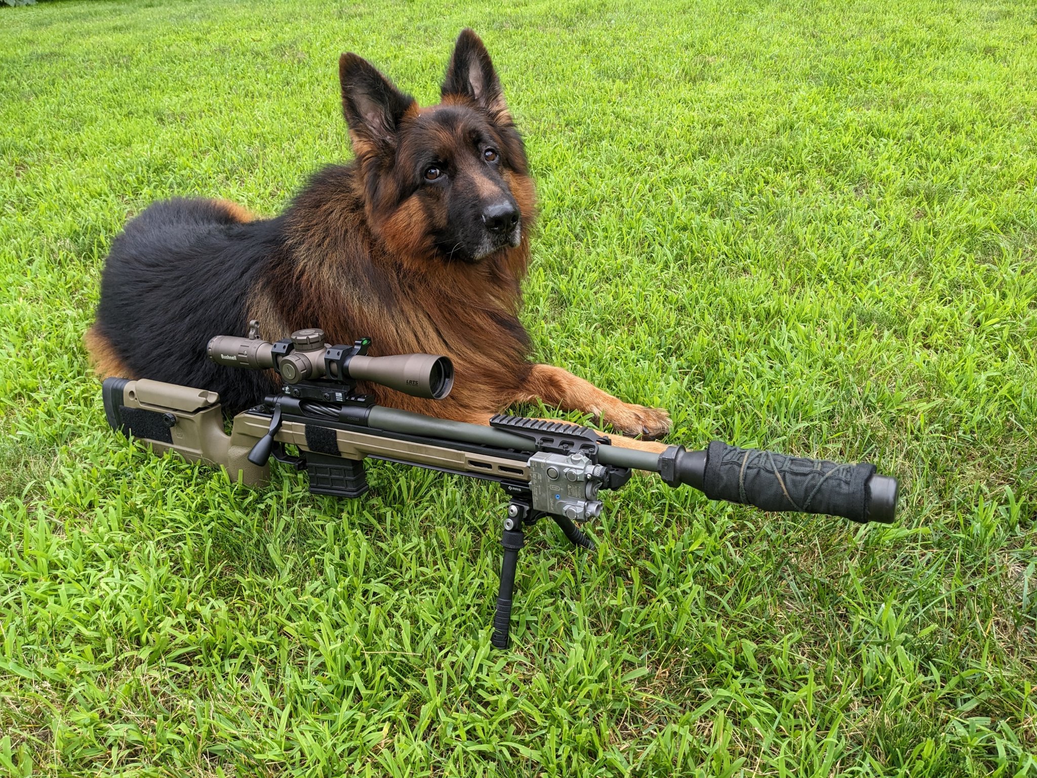

I put one together off a used Accurate Ordnance action I picked up. This is the build and what it cost me.
Accurate Ordnance Action (223 bolt), 20MOA Stiller Rail, Timney 517 Trigger, 2 Mags - $800
Wilson #4 16” Barrel threaded 5x8/24 from Fisher T&C - $600
Timney HIT Trigger (less the funds from selling the 517) - $125
KRG Bravo w. NV Bridge (had it lying around so estimating cost) - $500
Bushnell LRTS Elite FDE 4.5-18 - $650
ADM 30MOA Mount - $190
So I am into it for about $2,900. Shoots great with N110 and 220 Nosler Custom Competitions. It is honestly one of my favorite guns to shoot. I have the zero stop set about 2 mils below so I can dial down for factory Barns 110s and be pretty zeroed at 100 yards for critters if I see any. The Rex Maker 220 Expanding Subsonics hold the same POA/POI as the 220 Noslers, however, they really over penetrate (like through 3.5’+ of water jugs) which I have heard is common with those types of bullets, so I don’t expect to hunt anything outside of a squirrel or the local porcupine with them.

Nice looking rifle and a great looking pooch . congrats on both .
