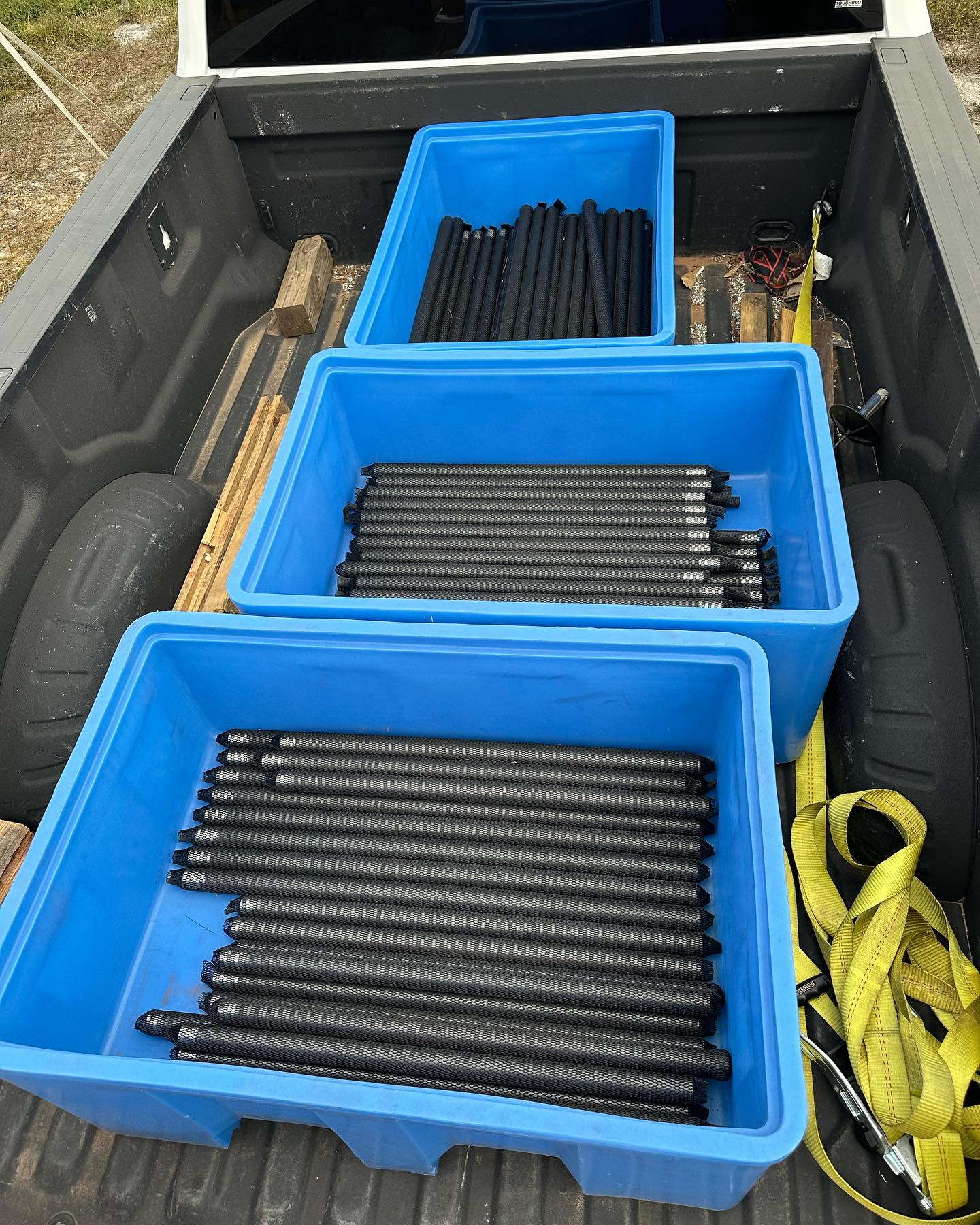

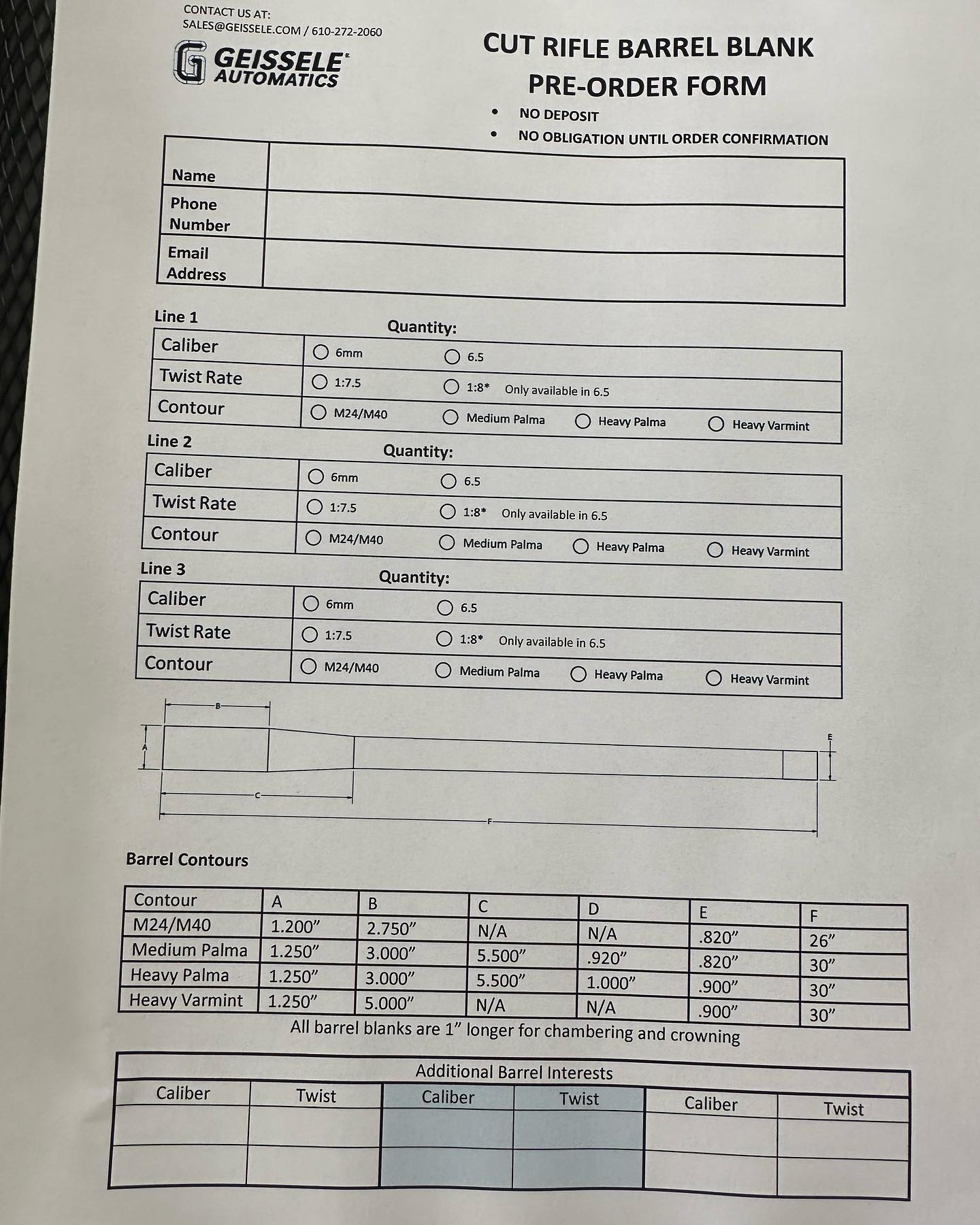

Just buy this thing. It absolutely hammers
Where are you ordering them? I don't see anything but AR barrels on their website
Call them up. They have a ton up for sale and said they will be full production in 2 weeks, with more machines coming online after that.
I do a custom contour that is similar to the MTU. I run 1.25 straight for 5” then a straight taper to finish at 1” diameter at a finished length of 32”. Easy to communicate when ordering. About to have 2 spun up in 300NMI.
Wonder if Geissele will be doing any 1.350" size barrels for the.actions that have larger breech tenon diameters. Need to call them up...

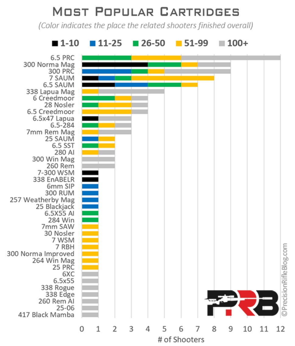

I wonder the same given Cal Zant's 2020 research; seems shooter success is driving the interest?
Could be the reason but at that point it's the shooter and how well they know their gear. If you'd have those top Norma shooters use 300 PRC I'd bet they'd finish in the same spot.
What is your contact information?
I run a 30" heavy palma and a 28" M24 both .900" at the muzzle both 1.25" barrels no problem. I even ran 80,000 + psi hybrid cases through the 30", so their should be no problem.
But do what you're comfortable with. But if I build a 300 NM probably not the improved, it will be on the 1.25" dia barrel heavy palma 8 twist.
I agree. Most of the targets in the Nightforce Steel Challenge are 700-1,500 yds which reduces the need for a more potent cartridge than the 300 PRC, except maybe extra for mv to counter wind drift? And the extra recoil would work against spotting impacts on the closer targets?
