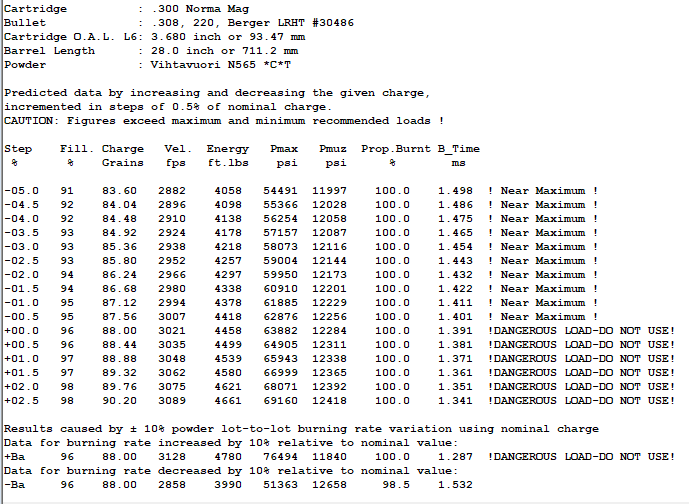

N565 isn't going to save your throat much compared to N570. You need to reduce the heat, so use N170 or N165. You'll lose 100-150fps but get potentially longer barrel life because it's single-based and generates less heat at the throat.
Here's what QL says about that combo.
Personally, I think N565 is too fast for the heavies in .300NM. It's better suited for the 200-220gr range of bullets.
Sorry to ask, would you be able to run a QL for berger 220lrht using VV n565, 28" 8.5 twist using Fed 210m (LRP). I couldn't get 215m in canada 😭. When I ask berger they don't have 565 on their data and as discussed before, VVs data is way off.
My own 220 LRHT N565 load from a couple years ago uses 87gr but is kind of hot. Here's what QL says....

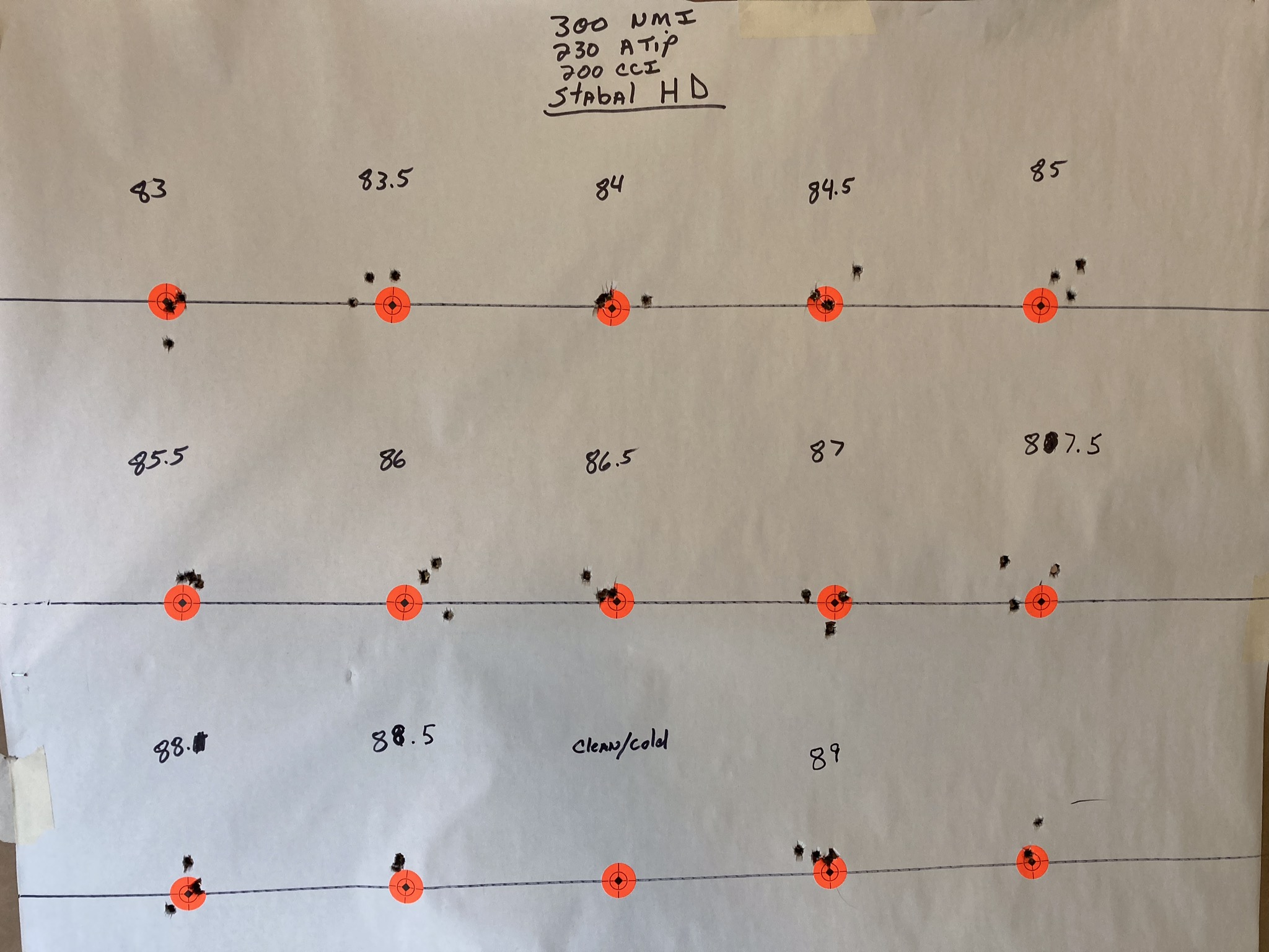

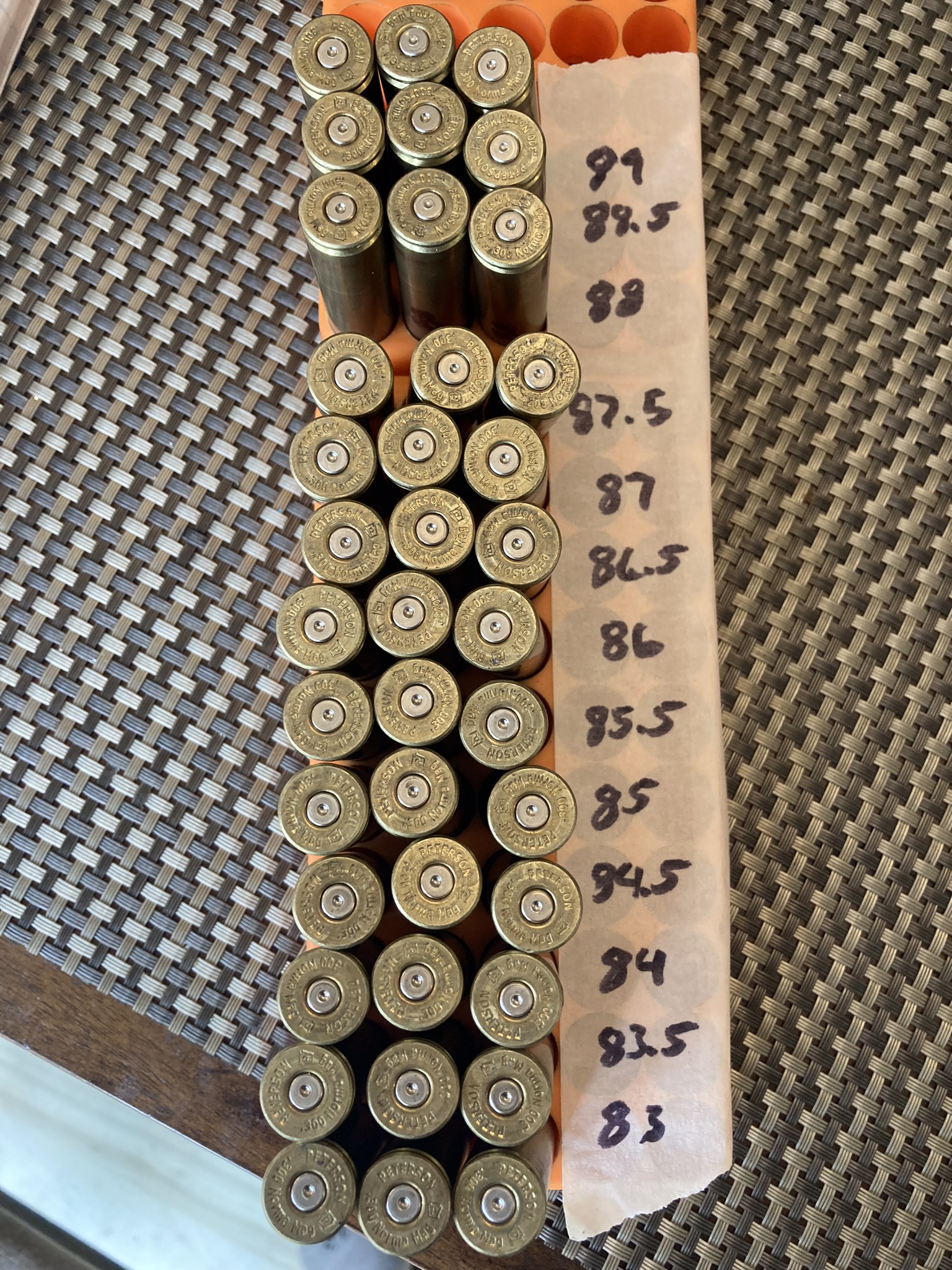

I tried some Staball HD today and it shot pretty good.
My gun is a 300 Norma Improved so keep that in mind. I couldn’t find any data but since it’s burn rate is close to Retumbo that’s where I started.
30 in Bartlein 8 twist 5r
230 gr Atip
CCI 250
Peterson brass
83 gr. No data
84 gr. 2859 fps
84.5. 2948
85. 2959
85.5. 2958
86. 2987
86.5. 3052
87. 3023
87.5. 3025
88. 2960 ?
88.5. 3053
89. 3081
There was no pressure signs or stiff bolt with any of these loads. This was only 3 shot groups.
230 gr Atip
CCI 250
Peterson brass
83 gr. No data
84 gr. 2859 fps
84.5. 2948
85. 2959
85.5. 2958
86. 2987
86.5. 3052
87. 3023
87.5. 3025
88. 2960 ?
88.5. 3053
89. 3081
I'd repeat 84.8-85.7gr in 0.3 steps with a magnum primer, maybe work on seating depth a lil. 2950 and 3050 are pretty well known speeds for great accuracy in the Norma case with 230s. My 300nmi with 230 Bergers it was 2980 3070 that it performed well but with N570 and it makes sense the nodes a bit faster with a slower burning powder. In all honesty, 2950 VS 3050 is minimal wind difference with that high bc bullet. Drops are drops, easy to figure out, that fn wind tho.........great equalizer!

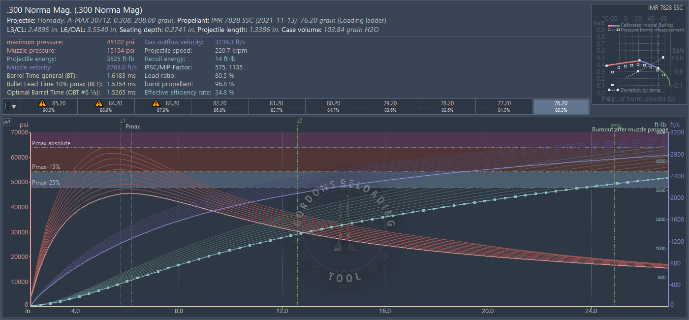

I just got 100 pieces of 300 NM brass, and want to fireform brass / break in this barrel. I bought some H1000 but would like to hold off on using that until I get to load development. I have a couple questions...
Is 100 rounds of 300 NM enough to let the throat settle in before starting to develop loads?
I have a bit of 7827 SSC and older 208 Amax's I'd like to use up for this. Any idea on a good starting load for this combo?
Please let me know if you would proceed differently, but I don't want to break into my 225 ELDM's and H1000 before I have to. Thanks in advance.
100 rounds should be plenty to break in that big a cartridge. 75-77gr 7827SSC with the 208 should do the trick, be around 2800-2850fps I'd think.
