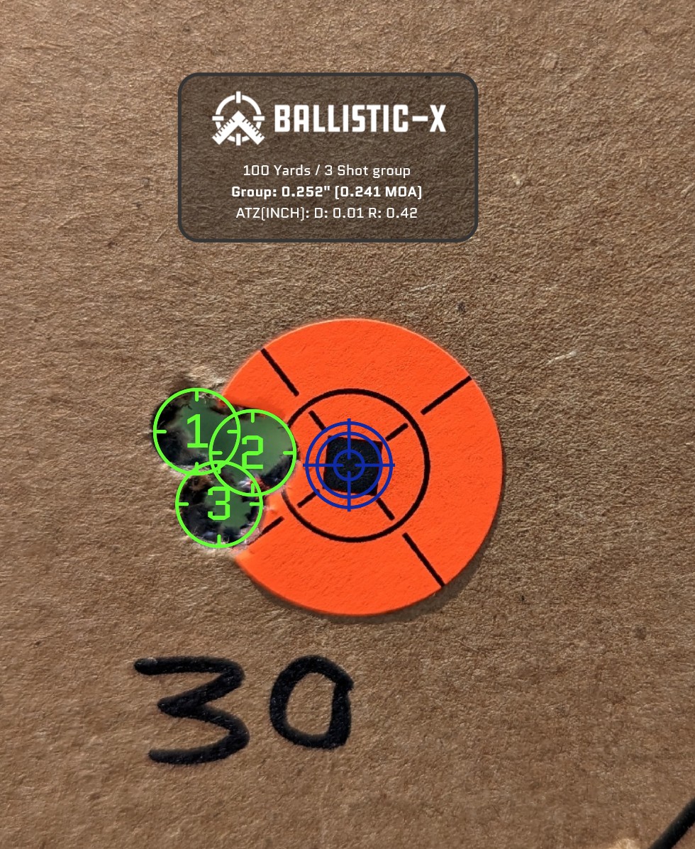

Still no pressure signs. I’m going to try a couple more grains but cut it back to .3 jumps.

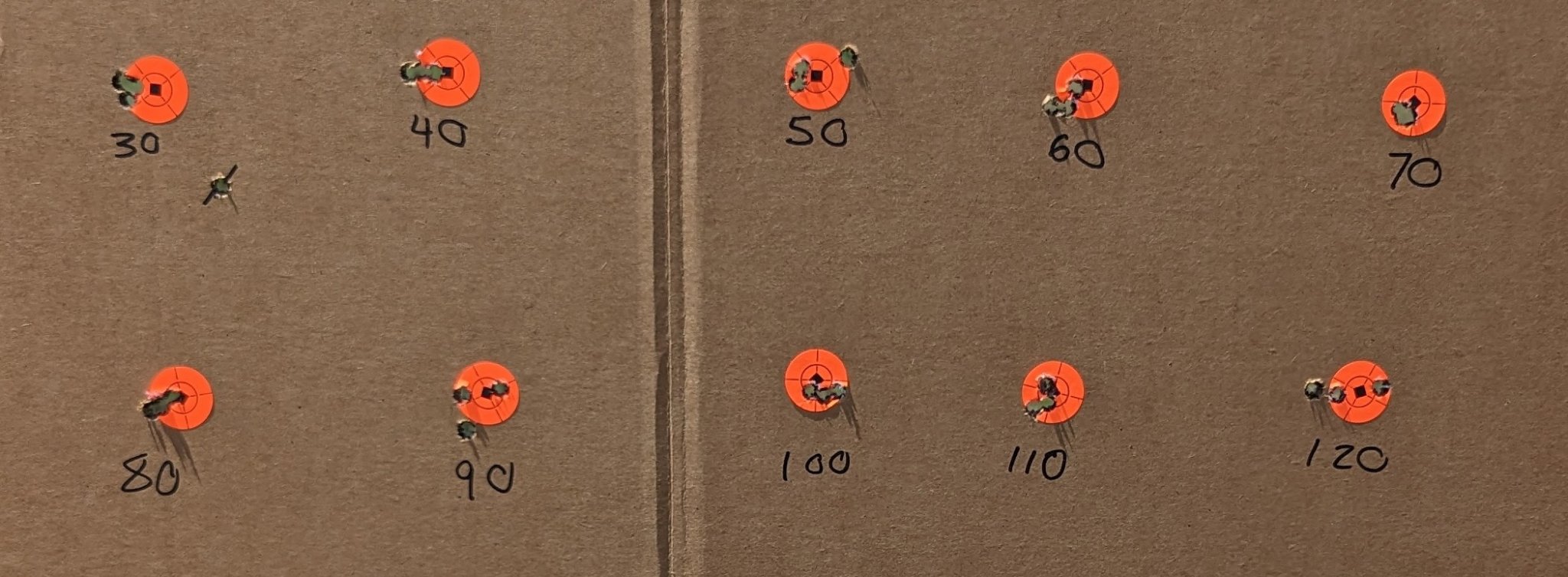

Tested jumps with the Berger 220 LRHT today, everything from .030" to .080" shot great with consistent POI. The one flyer at 0.050" was my mistake, I think that would shoot like 60 and 40 if I did my part.
I think I'll go with 0.070" although 0.030" would be a safer pick for the full like of the barrel.
Reactions: Dogtown
70 is literally the last depth that shoots well, why would you select that when the groups all blow open from 80?
The POI’s are all basically identical from 30-70, and all groups shot good. I would choose 30, so that the throat can erode another 0.50 before accuracy becomes an issue.
You're right, I was intoxicated by a tiny group at 0.070" and wasn't thinking clearly. I'm going with 0.030", final answer.

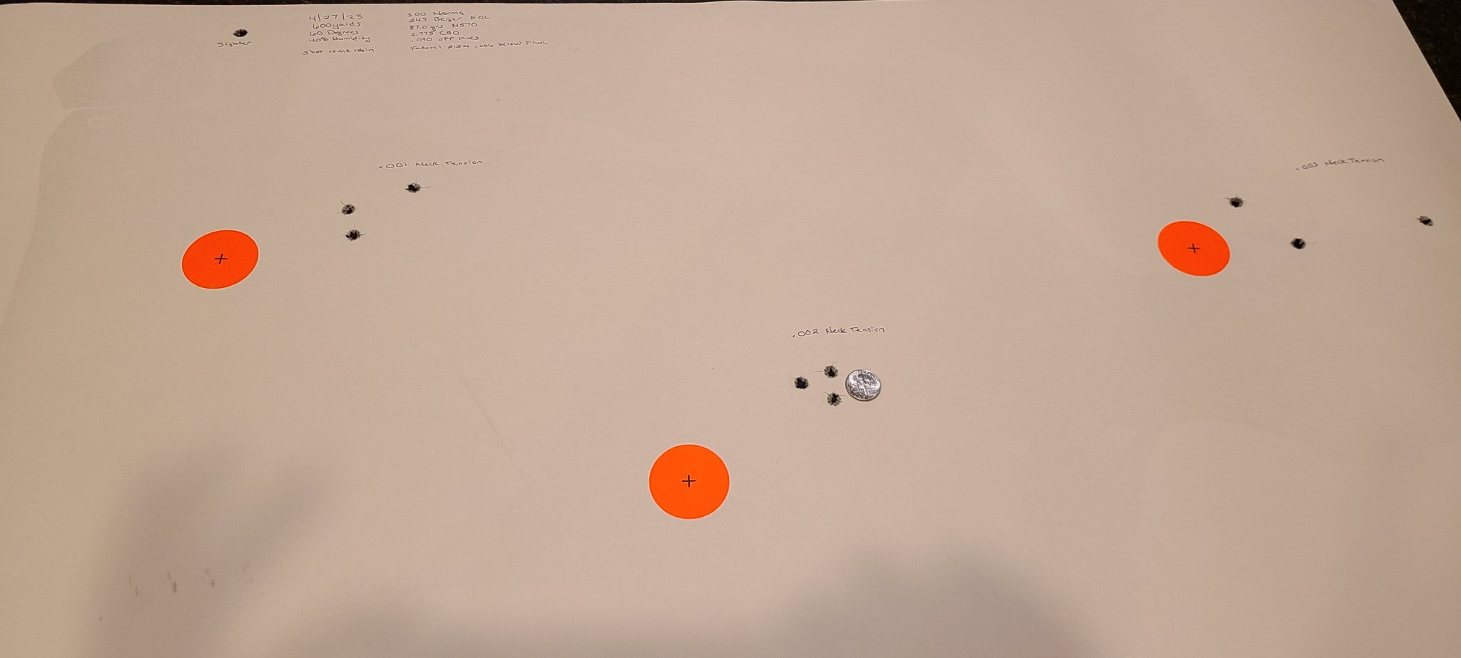

Quick neck tension experiment at 600 yards.
Started with my current load:
245 Berger EOL
87.0 grs N570
2.775" CBO
.090 Off the lands
Federal 215M all seated .006 below flush
3rd firing on Lapua brass
Avg MV-2960 fps
Forster custom honed die with decapper removed
Used .305, .306, .307 mandrel to set final neck tension
1 sighter
Groups shot round robin to eliminate variables
Upper left .001 neck tension
Center group .002 neck tension
Upper right .003 neck tension
Obviously irrelevant from a statistical standpoint but just a fun experiment tweaking a load.
Try even higher. I’ve got a couple rifles that really tighten up at .005
I wanted to but I would have to change sizing dies to do that because my Forster doesn't squeeze the neck down enough. Anything smaller than a .305 mandrel doesn't contact the inside of the neck after sizing.
And if it continues to shoot even close to that at distance I wouldn't want to change anything anyway.

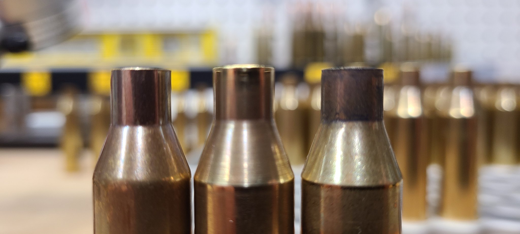

For reference:
Far left is a virgin case-neck length .306
Middle case is 2X fired and sized, shoulder bumped back .002-neck length .286
Far right is 3X fired, not sized-neck length .276
