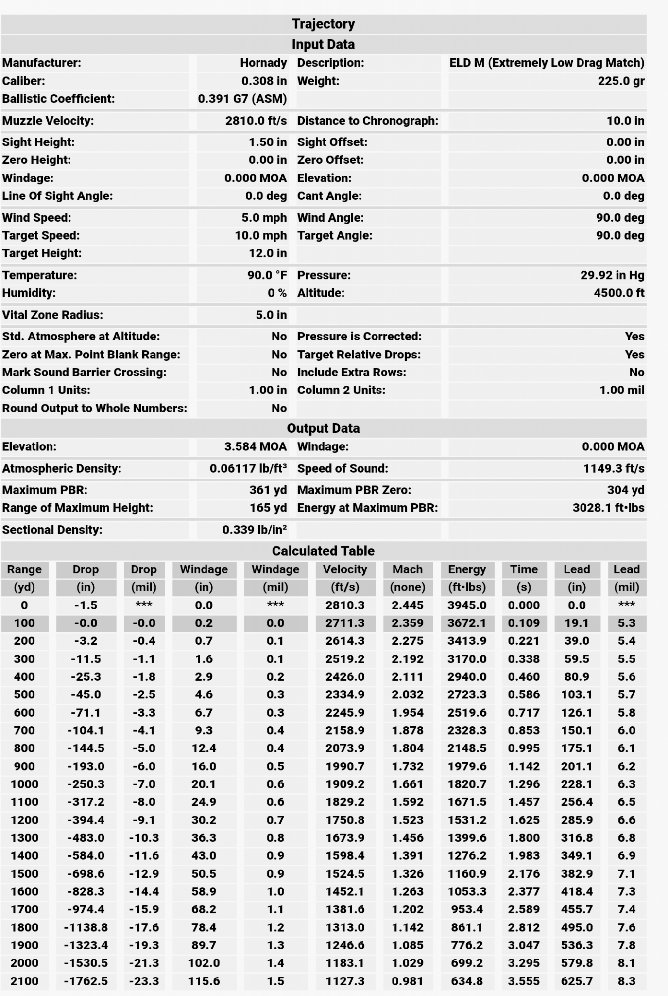

Here's the Factory Hornady 225gr ELD 300PRC load ran at 4500ft/altitude

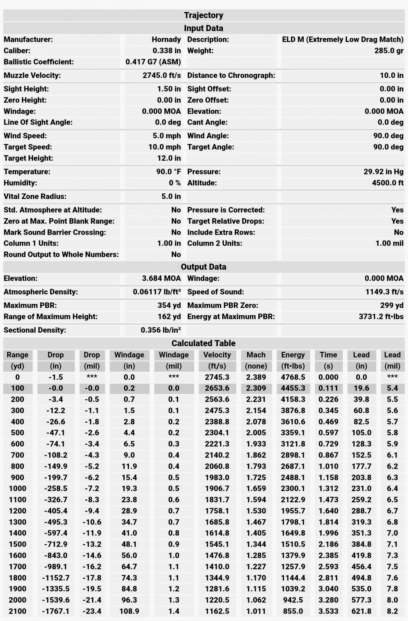

And factory Hornady 285gr ELD 338 Lapua ran at the same altitude

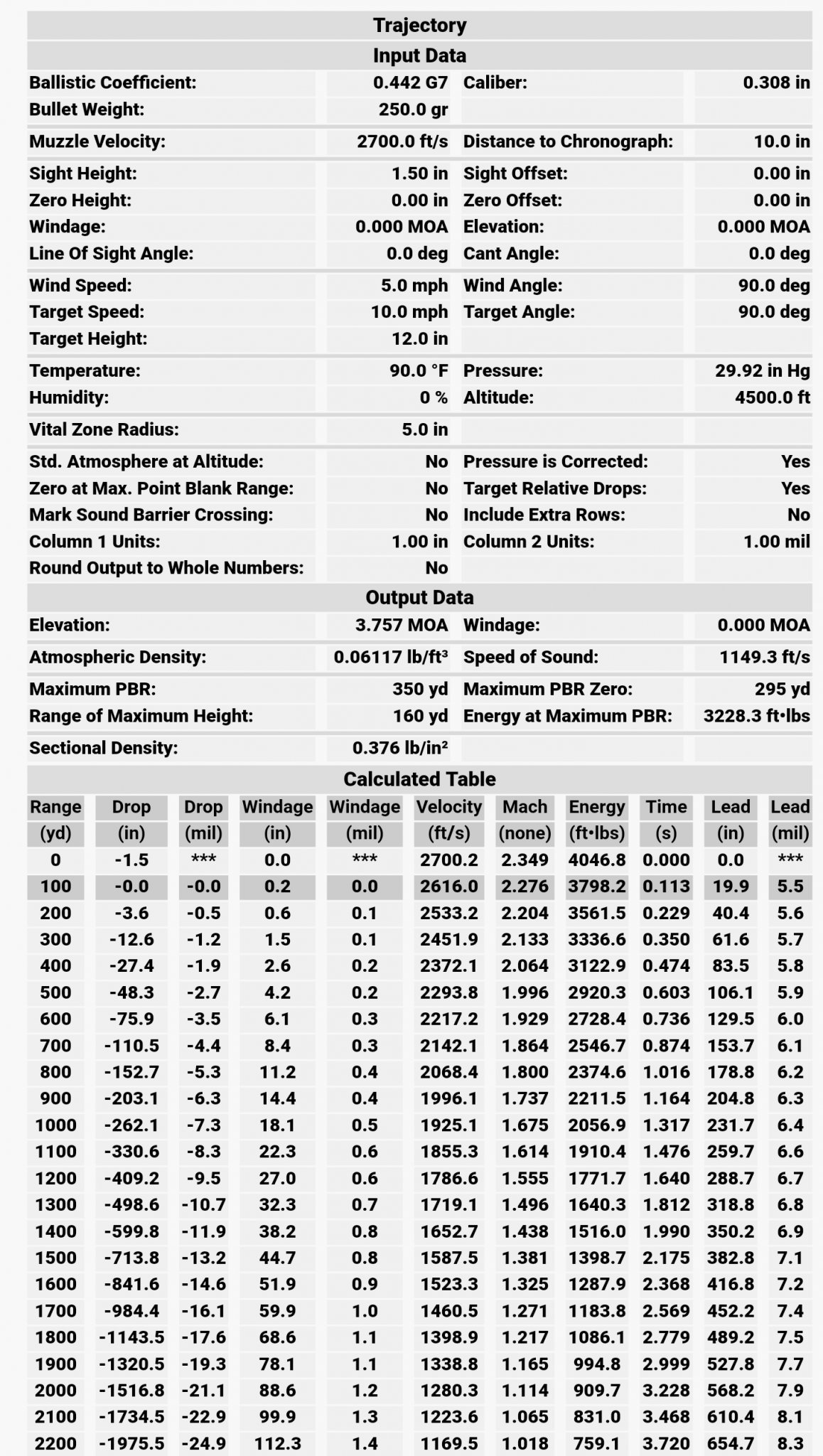

Compare that to Hornady's new A-TIP 250gr loaded into 300PRC at velocities in accordance to Hornady's load data. Again same altitude.

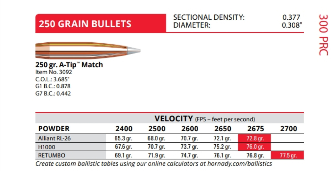

Hornady's load data on the 250gr A-TIP for 300PRC

It would appear that Hornady's claims that 300PRC with the new 250gr A-TIP outperforms 338LM are true. The 300PRC has more supersonic range, it bucks the wind better, and has just a bit less drop than 338LM. Energy differences between the two are insignificant especially beyond 1000 yards.
With the 300PRC you have the option to maximize performance by handloading the 250gr A-TIP or shot the 225 ELD which offers very impressive performance at a low cost. Either way the cost will be up to 50% of that of 300NM and 338LM and ELR is a sport in which practice is critical. This is the first time we've ever seen any of the big Magnums with ELR performance like this at anything close to this price. Used to be you had to pay an absorbent price for 338LM or 300NM for this level of performance and no doubt many of those invested in aforementioned calibers enjoyed that the high costs made capabilities which they owned more exclusive and out of reach of others but that's no longer the case which sucks for them but it's awsome for me very exciting times indeed, thank you Hornady.
