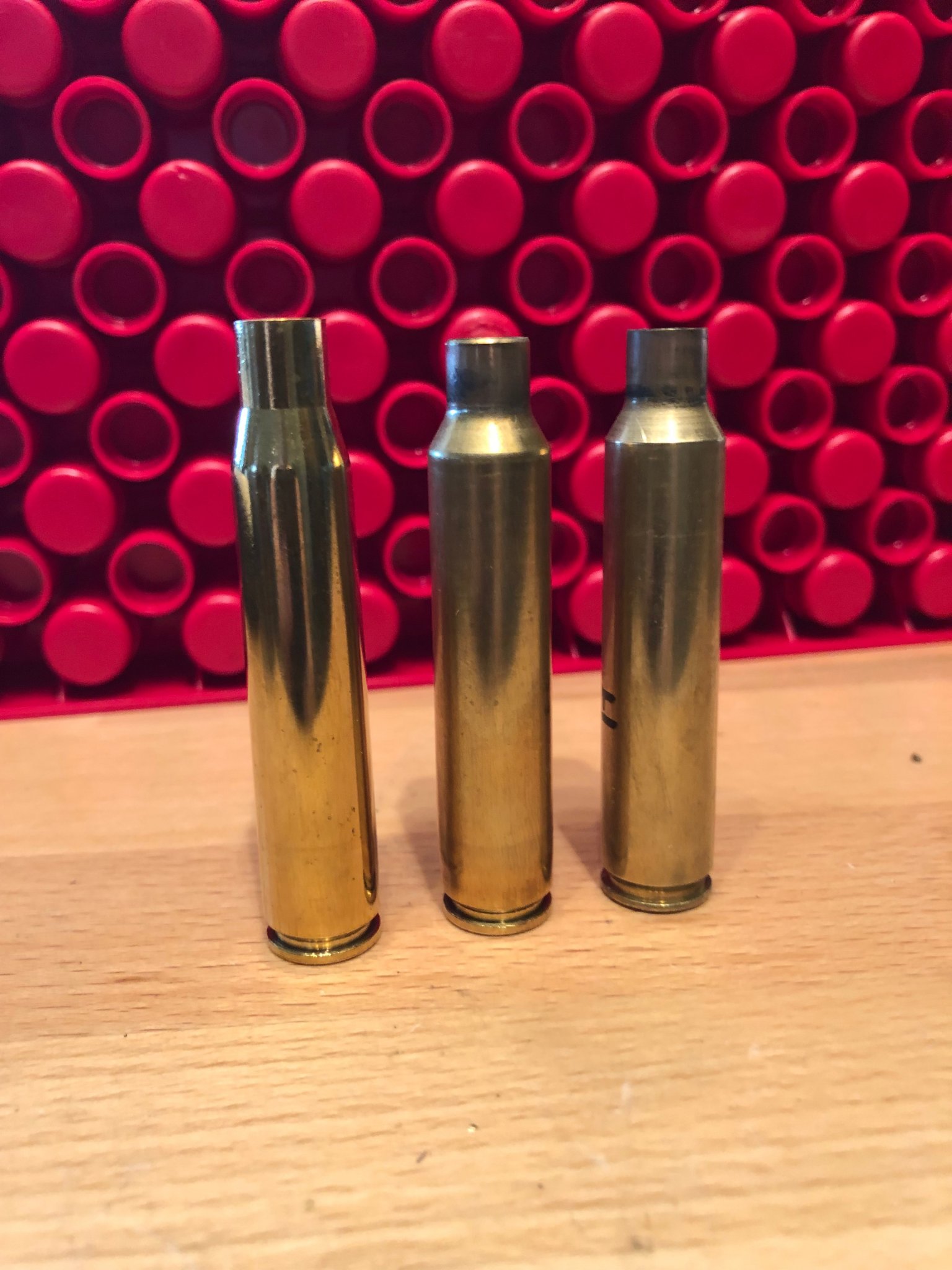

Lastly, the fire forming. I used 72gr H1000 and a 200gr ELD. Below is a pic of a new 8x68S case (left), a fire formed case (middle), and a fired Hornady 300 PRC case.
Of note: I had to toss 5 out of 68 Hornady cases due to primer pockets this go. Those RWS cases have very tight pockets.
