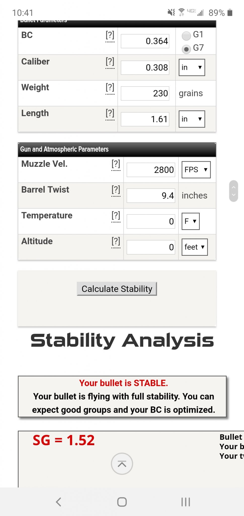

I'm at like 300 elevation or whatever San Antonio is lol.
Even in the very worst conditions I can think for San Antonio. 0 ft elevation. 0 degrees F. And even at a slower 2800 fps with a 230gr pill is still fully stable. This is with a 9.4 twist.
So either 9.4 or 9 work for you. And about 99.9999% of people out there a 9.4 is plenty for the 230s.
What app is that?

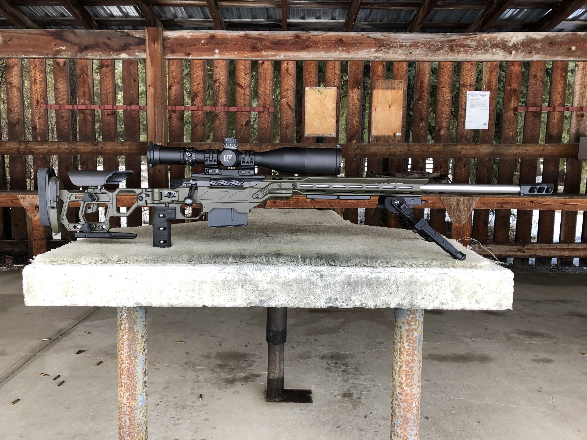

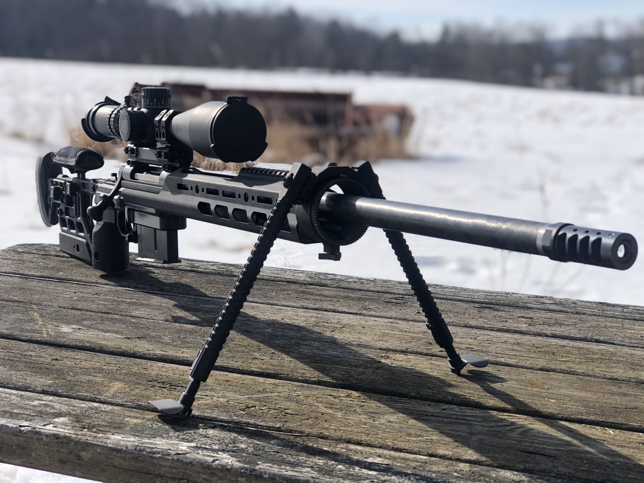

300 PRC KRG
  • Love
Reactions: Luvman and b2lee

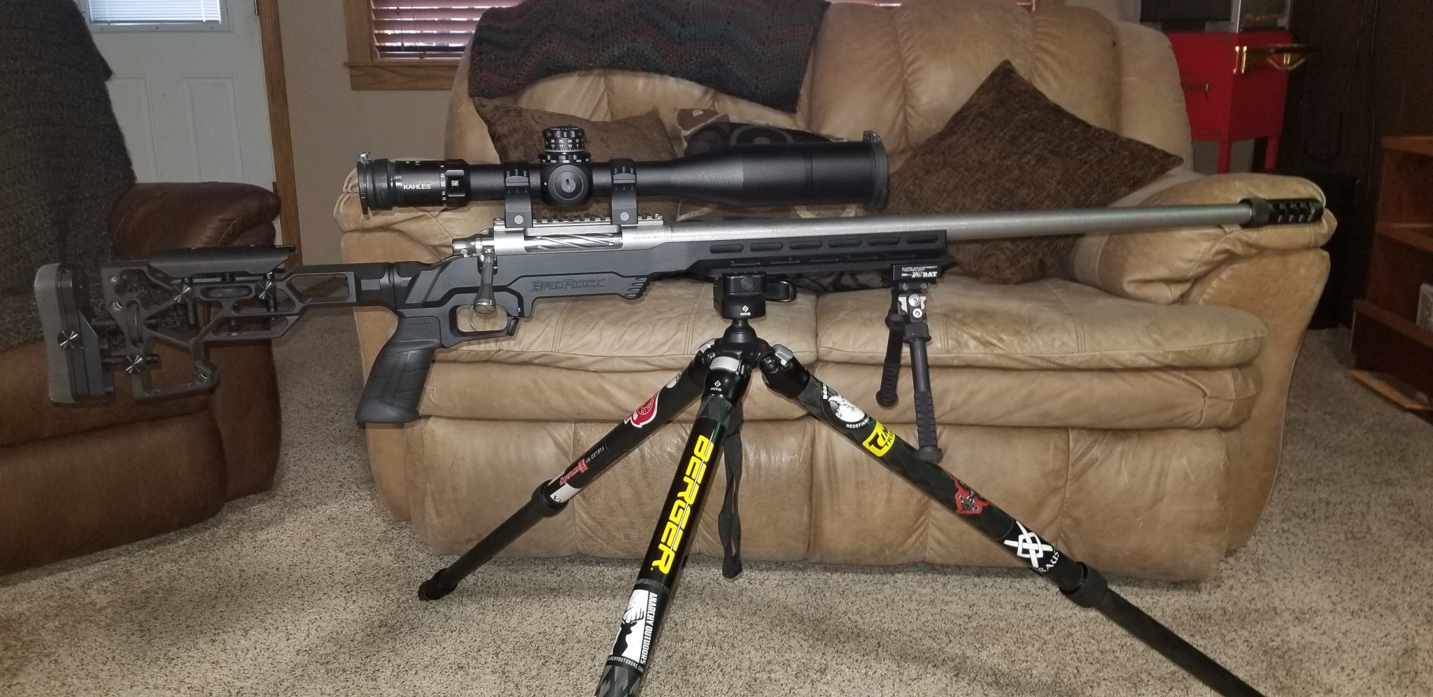

This is my budge porsche taycan....notice I didn't get the turbo and saved $50k...went with a standard color instead of the upgraded metalic.... standard wheels, and regular leather. Skimped on the power seats and the Premium package.
yep....my budget Taycan ;)
Just messing with ya man...nice rifle.
