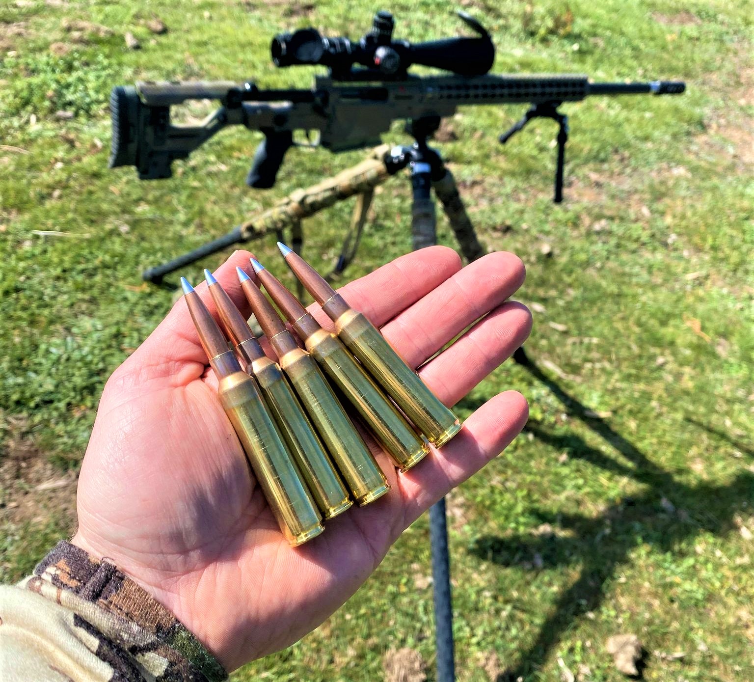

230gr A-Tips in ADG brass. 2850fps. Have been happy with these. Sitting at 0.135" off.

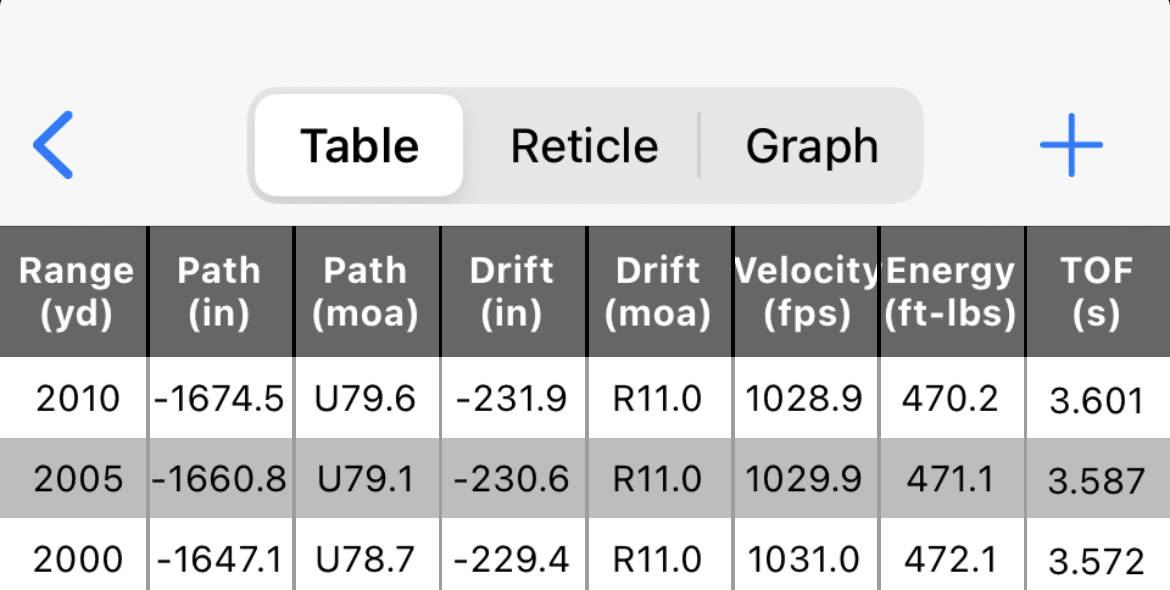

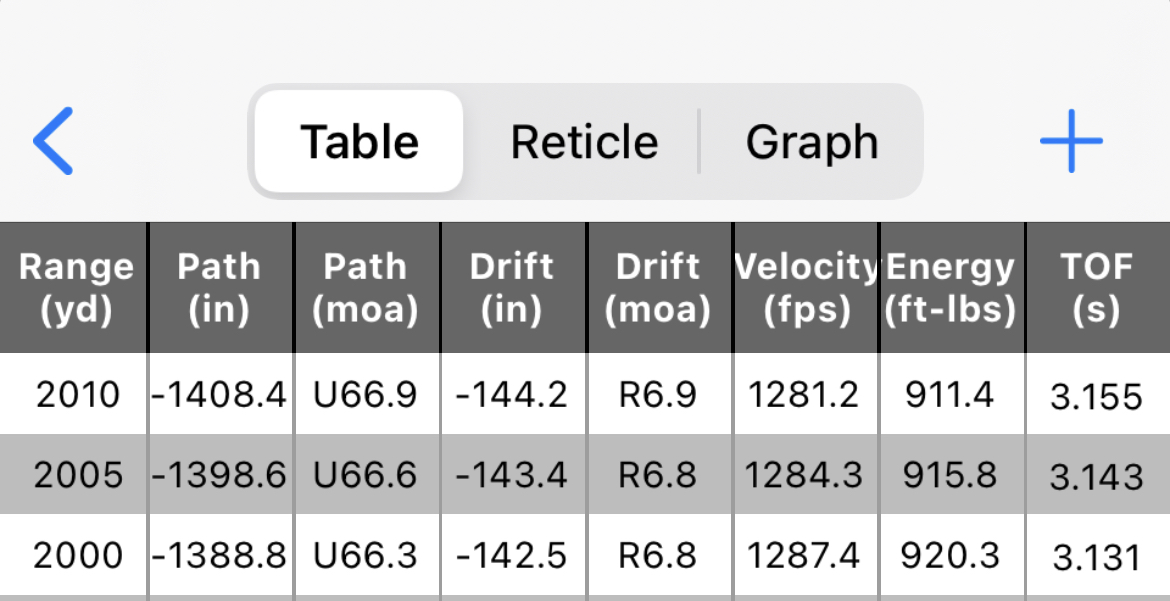

200 Sierra MK @ 3200
250 A-Tip at 2850
Edit: had tables labeled backwards.
