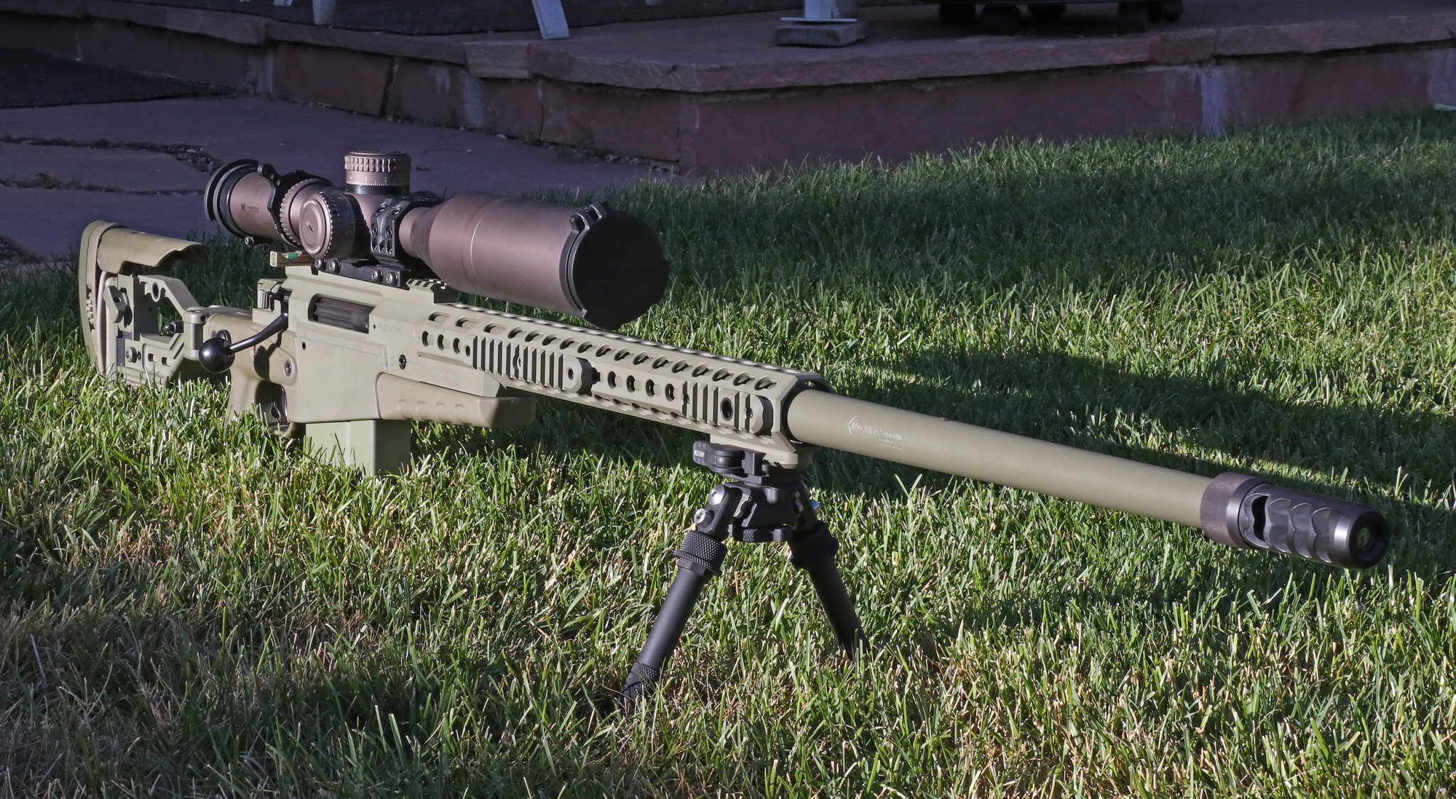

Roamin, you don't need to convince me on the PRC - I already put my money where my mouth is. But A-Tips to factory 338LM is apples and oranges since you have to handload A-Tips. In my AX, the factory 338 barrel is 27" and my PRC is 30" and the two were within a couple of mils at 2400 yards (factory Berger 300s in the 338 and factory 225s in the PRC). The big difference to me is that the recoil on the PRC is mellow and it's easy to stay on target, which is not to say the 338 is all that bad, but there is a difference. Part of that could be that the PRC has a Area 419 Sidewinder and the 338 is AI factory. It will be interesting to try the 338 A-Tips.

Single shot Lapua improved is exactly what I would do. FWIW, I just built a no holds barred single shot Lapua Improved on a Surgeon XL single shot action. My dummy round with a 300 Berger was 3.925, which put the bearing surface just above the neck shoulder junction. If you throat for the 285 Flatline at optimal COAL, you will be well over 4".
My accuracy loads with the Berger and a 30" barrel are sitting right around 3075 with RL33. Just a little perspective for those saying that the 300 PRC has better paper ballistics than a Lapua. If you maximize the performance of the Lapua case by improving and using optimal throat dimensions, powder, and barrel length, the PRC simply can't keep up. Granted, the Lapua will be a hell of a lot more expensive, but the performance difference is significant. The 285 Flatline pushing 3200 would be even more of a ballistics monster.
