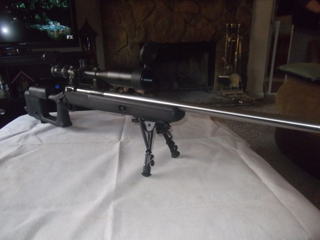

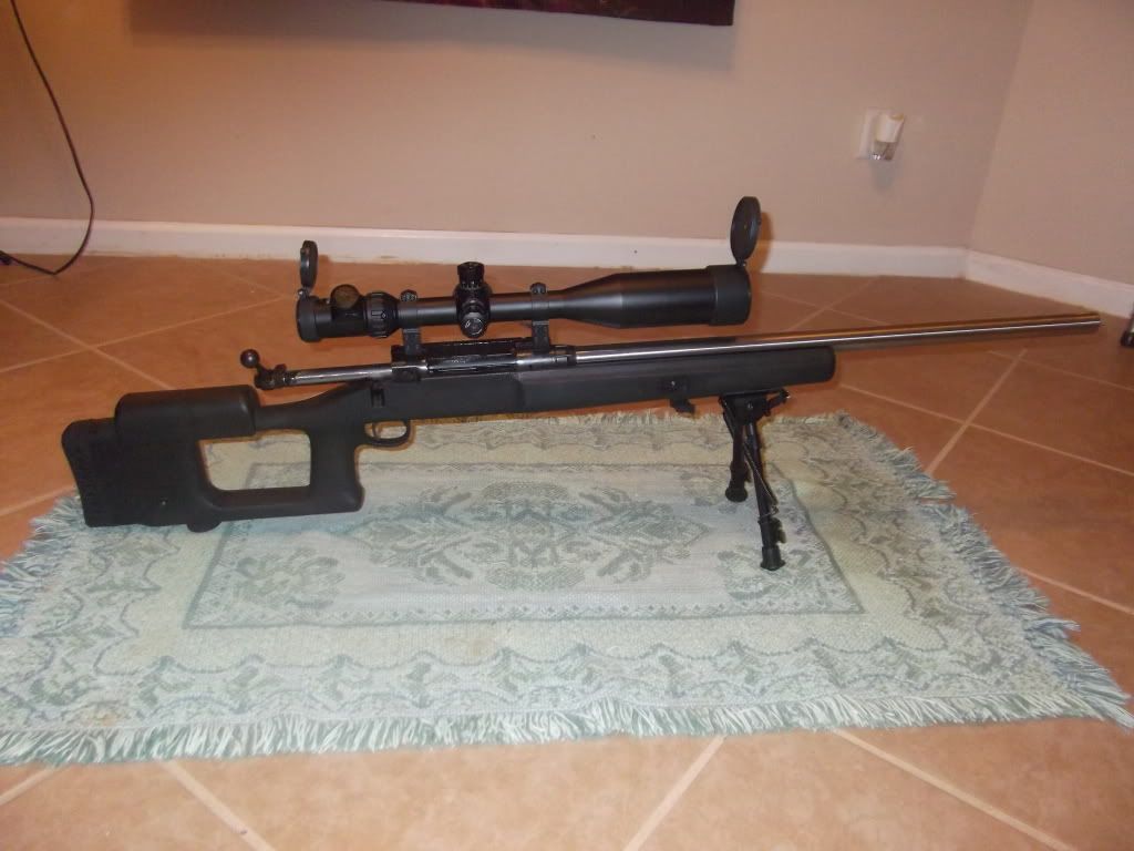

Shilen 26" stainless steel bull barrel with a jeweled trigger set at 2.5 pounds. Savage tactical stock with a Millet 4-16x50 tactical scope. This is my best friends brothers first ever custom made rifle.

Very nice rifle! I too just built my second bolt action rifle in 300 Win mag. (my first rifle is an american classic styled 243 Winchester) My 300 WM is my first tactical long range weapon and my first action truing job. I havent put it on paper yet as Im still breaking in the barrel. How heavy is you friends brothers rifle? Mine is 16 pounds and recoil is very mild. If his has a good heft to it the recoil should be manageable. And if its uncomfortable throw a muzzlebrake on it but remember to wear earplugs when shooting a braked 300 WM. They are loud as hell with a brake. Enjoy shooting it!

Honestly I don't flinch at all when I shoot it. My only problem is on some days I just can't get relaxed to shoot it no matter how much I slow my breathing down. I get to thinkin too much and feel like I am gonna shoot a benchrest scud missle with a pistol grip. But then I can calm down and shoot.

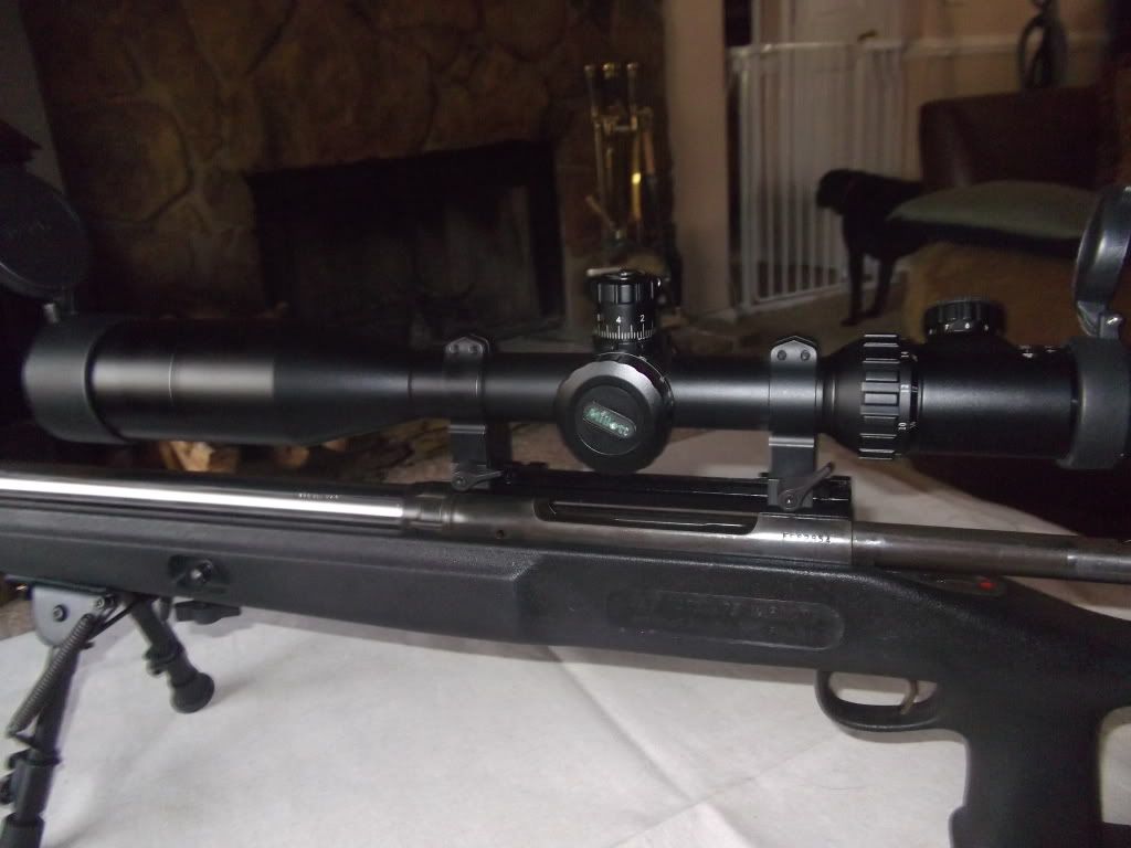

<span style="font-weight: bold">Nice shooting! Your scope rings look a little high. I'd probably look at getting some low rings. </span>

Agree with SBD47. Lower rings will give you a better cheek weld and that will help you settle in to your crosshairs better. None the less, nice shooting with your rig the way it is.

not bad for a first build get some lower scope rings you want your scope as close to your bore line as u can get it without touching or getting in the way of ejection

<div class="ubbcode-block"><div class="ubbcode-header">Originally Posted By: Cowboy1978</div><div class="ubbcode-body">if it feels good go with her, the stock doesnt look like the Chaote im use to.
who makes it? </div></div>
Thats the ultimate sniper stock by choate, the one in the OP is the ultimate varmint stock by the same maker.

Believe it or not, the damn thing is so heavy. You would think that it would kick like a mule. Surprisingly it don't kick hard at all. The overall length is right at 48".
