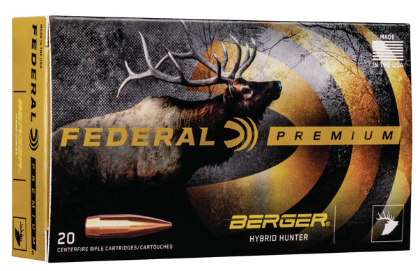

Where are you finding Berger 215gr 300NM ammo for $50.00/box?
ammoseek.com
Reactions: CarbonMTN
ammoseek.com
Ah, FEDERAL ammo with Berger bullets, not Berger ammo, which comes in Lapua brass that costs more than 2.50 for the case alone. The OP just said "300 Norma in Berger 215" without mentioning Federal, so it read like you meant Berger ammo.

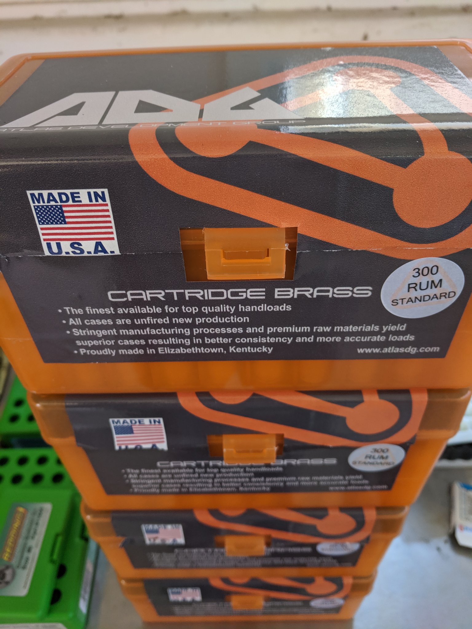

I'm a big fan of 300 Norma as well, that said the 300 RUM is sadly overlooked far to often that is easily its equal.
You are quite ight about the 300 RUM and it has the largest case capacity out of all new calibers. Another one that seems to be over looked is the Nosler 30, 26, 27, 28 calibers.
I have been looking at building something that will get me out to 2K and for the ease of being able to build it my self, I am going to do a 300WM. I did also look at the 300RUM and might do one as well down the road to reach out further.
One of the things I did was to look at average gr/H2O case capacity. Not sure on some of these..
300 RUM 110.2 gr
300 Norma 104.2 gr
30 Nosler 98.5 gr
300 PRC 97 gr
300 Win Mag 93.8 gr

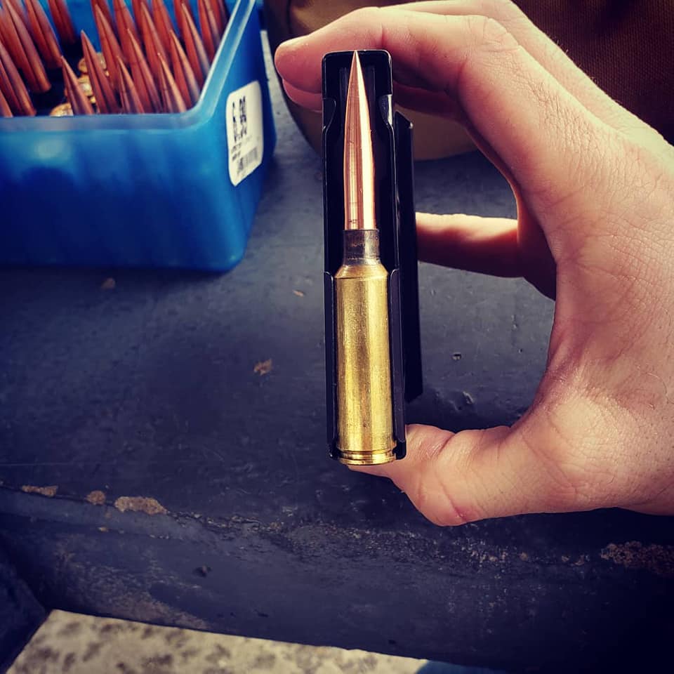

I’m currently working on a 7 twist barrel for a 300 Norma to shoot the PVA Seneca 241 grain billets that have a G7 BC of .555. I should be able to get around 3000 fps from a 30-31” barrel, shows some promising numbers run through a Kestrel.

I did not know PVA made solid pills, so I am curious on how you make out with them. Did you take a look at the Berger 30 Caliber 245 Grain Extreme Outer Limits (EOL) Elite Hunter? I think the average BC is around that as well.

No, the G7 BC of the Berger 245 is .413. The claim for the PVA bullet is far beyond anything else out there. It’s higher than most claimed BCs for .375 and .416 bullets. I wouldn’t believe it without independent verification.
I was going by the average G7 BC that both have listed...
PVA G7 BC average = 0.555*
Berger G7 Form Factor 0.893 (Form factor is an average estimation like PVA's)
I do have to agree that PVA number is inflated and is more along the lines of the Berger, which is G7 BC 0.413. Berger has some good information on No BS BC. It is one of the reasons I bought there reloading manual, it has allot of technical information in it.
For PVA's web page;
"The "Seneca" series is a turned copper projectile designed with the most demanding competitors in mind. These projectiles are the epitome of performance with their high BC, lower weight and sleek profiles. The bullet designs are all measured via acoustic chronograph and/or Doppler radar for the utmost in confidence of the equipment. The bullets are designed to be used in a broad range of competition calibers and magazines. As compared to other monolithics or hybrid construction projectiles these exhibit better form factors, better repeatability, lower weight and higher BC's. Not only are the trajectories better with these projectiles but the overall performance aids the competitor in "shootability" with reduced recoil for the performance gained.
This bullet family has multiple patents awarded for the design. Due to some of the patented features the designs are not only extremely efficient in flight but also very easy to load with conventional powders and standard chamber dimensions. The bullets are designed with bore rider geometry for use of normal throat geometry.
Each bullet is individually turned on high precision lathes and measured to ensure the utmost in consistency. These projectiles are not bulk washed/tumbled or other bulk-method processed to ensure that the sleek profiles are not damaged after machining is completed.
For example, using the 6.5mm 124gr Seneca and a conventional 130gr jacketed bullet design in comparison the Seneca performance allows a 6.5 Creedmoor shooter compete head to head with 6.5 PRC and other 6.5mm short magnum cases. THis is a huge advantage in the overall cost of ammunition, cost of an additional caliber to reload, cost of a new barrel and bolt or a whole rifle, and increased barrel life of a 6.5 Creed vs. 6.5 PRC
Length: 2.05"
Optimal Freebore: 0.090"-0.165"
G1 BC average = 1.15*
*The average BC was measured using 7tw 5R rifled barrels and being shot at approximately 2810fps. Different rifling geometry and muzzle velocity will affect the BC in a nominal manner.
TNF stands for Trajectory Normalizing Factor. It is a simplification used to accurately estimate the potential of firearms trajectories across calibers and weight ranges without the complexity of running a ballistic calculator.
TNF = Muzzle Velocity * Ballistic Coefficient
See the Patriot Valley Arms article on TNF.
Seneca G7 BC = 0.555
250gr Jacketed bullet G7 BC = 0.426
For a 2,950fps Seneca load we have a TNF value of 0.555*2850=1582
To equate that TNF value with the 250gr bullet it would need to be traveling at least 3,710 fps!
Test packages of 100ct bullets are available however the best pricing of course comes with larger volumes. Volumes of 500pcs or more will be filled in bulk packages not in 100ct bags.
30c 241gr Seneca requires a 1:7tw barrel, it will likely not be stable from slower twist rates. We cannot accept returns of projectiles due to liability reasons.
Starting load information should be based on conventional 230-240 grain projectile information in published reloading manuals. The bullets have shown good repeatability across a broad seating depth range. We suggest loading the bullets 0.020" off the lands and starting load development in that area."
From Josh Kunz FB post;
"I made some updates to the venerable 198gr 30cal design and made a variant to take advantage of the faster twist magnums starting to show up. I successfully tested today, as a repeater, from my 300wsm with a long action mag.
Bullet is 241gr, I am testing from a 7tw and will be looking for some beta testers who have 7.5 or 8 twist magnum 30cal chambers in the 0.125-0.210 freebore range
The calculated BC is based off the doppler data from the 198 and extrapolates to be around 0.55 G7 avg"
^ I have yet to chamber a fresh 31" 9 twist Bartlein - going with ~4.1" coal, good for the 225-250 grain class. Should be over 3200 with 225's. But seeing the pics of your mag-fed WSM with solids makes me want a 7 twist - those are some long projectiles!
