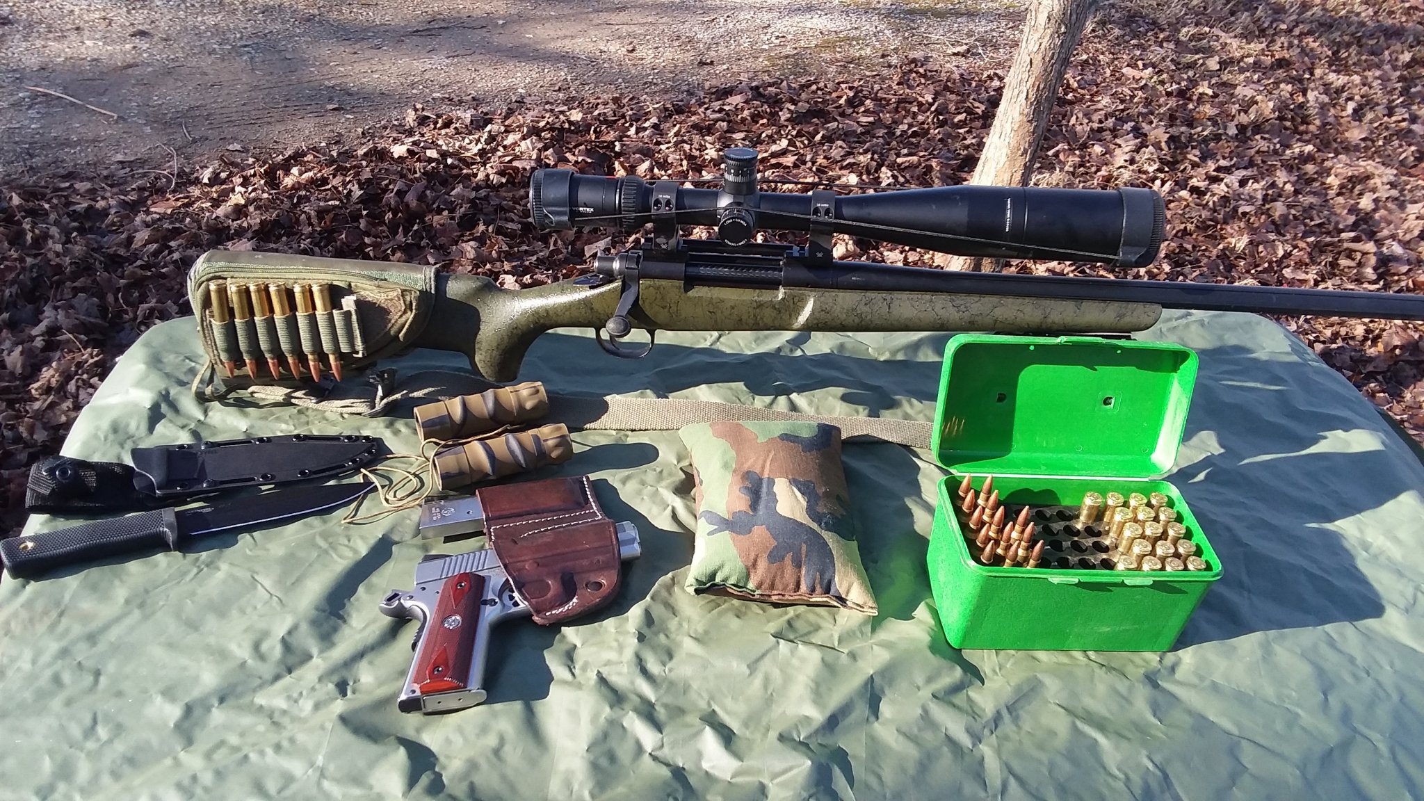

Looking at ammo shelves in stores and online . Im glad I reload 300 win mag .

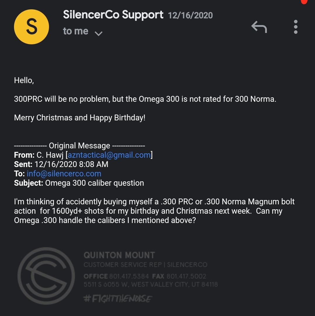

I am in the process of saving up for a .300 PRC because I cannot use .300 Norma Mag with my Silenco Omega suppressor. Can anyone here tell me what your velocities are at 1760yds for 24"-28" barreled .300 PRC? I understand velocities will differ greatly but just looking for a ballpark velocity. Thank you.
When I called SiCo they told me that the Norma or 300 RUM was fine for my Omega 300. Haven't used it on a Norma though. Alot of people say that a 338 can is perfect for a cartridge that size.
Not going to chance it. I'm going to play it safe and follow their guidance.
