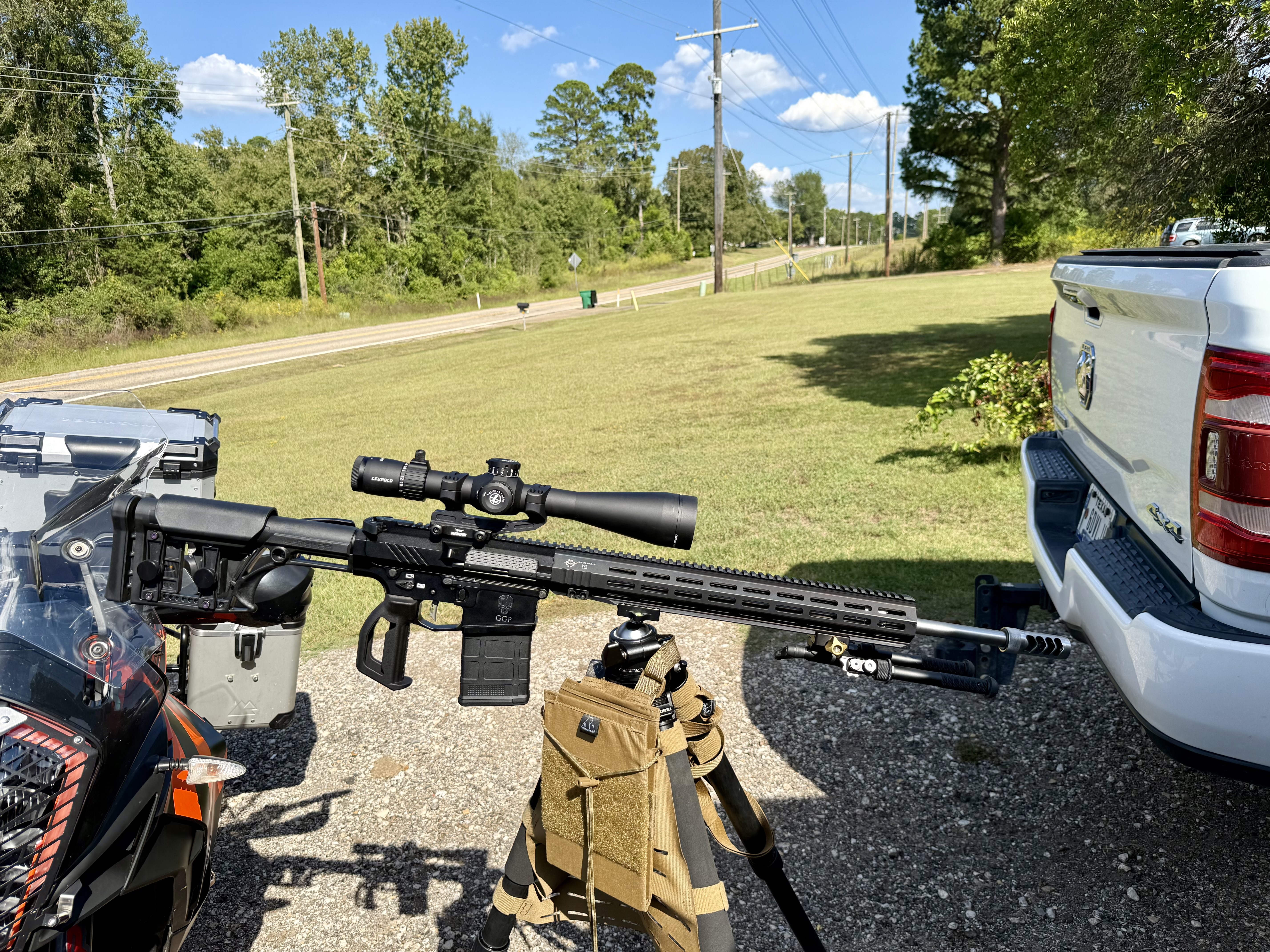

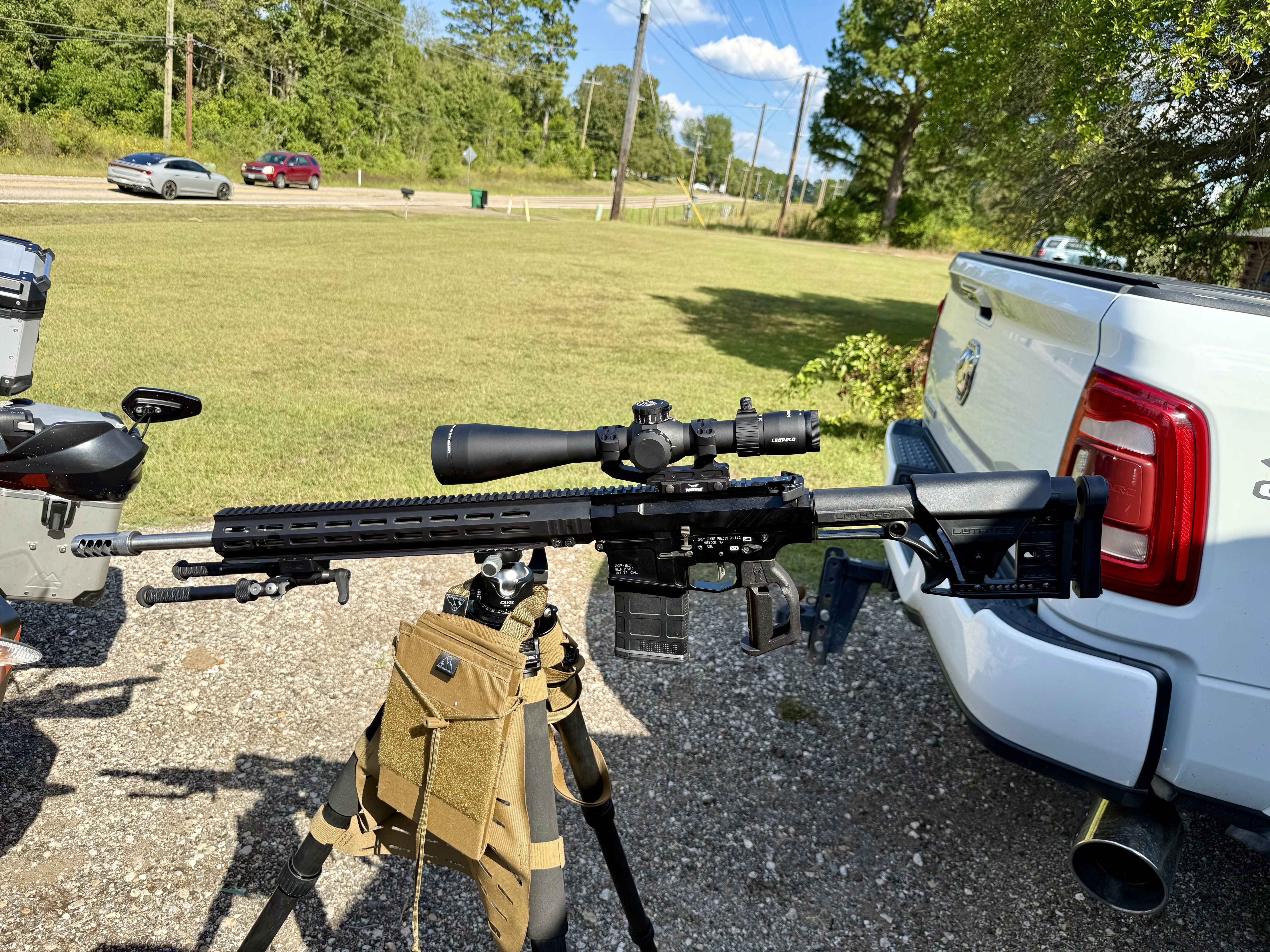

My contribution.
GGP billet upper and lower.
Luth stock and tube
JP silent capture sprint
Odin works 22” +2 barrel and matching BCG
Cross Machine 17” handguard with built in ARCA
Rise trigger (going to replace this with another diamond, it’s a decent trigger but just can’t compete with the TT for a match rifle).
Still doing load development. Did a handful of 130gr eldm’s, meh. Did another handful of 140 SMK’s, also meh. I was trying shooters world “the creed” and I’m pretty certain that’s it. It’s a super fine ball and the case is so underfilled I’m gettin shit speed (2600 at .3 over book max which claims closer to 2800) and the lack of case fill is causing inconsistency. Like 25sd is the best I’ve pulled off when I can typically get single digits with just about anything.
I haven’t had any h4350 in eons, I was always using rl16 for my creedmoor bolt gun so I’m going to order a pound of that and see if I can do better with it.
Gun looks nice and runs well though 😂😂.

How you liking the +2 gas on the 22"
Man I like it so far. This is my first ar10. I’ve had a ton of accurate ar15’s but never bothered with the bigger one. I started ahooting the gas gun show this year in the DMR class and it was so much fun I put this together to shoot open next year.
I’ve added zero weights to it so far, just as it sits I can spot my own misses at 350 yards which is very little flight time so it’s very flat recoil.
Once I get a load the rifle actually likes and I can stretch it out I’ll be happy. I was expecting snappy recoil with a lot of muzzle jump but it’s pleasantly surprised me. The only oddball thing is the gas port was too small to cycle as it came from Odin. I did some reading and a lot of guys were having to open the port to .086” from .081 it comes as. I did this, and it cycles and locks back like a champ.

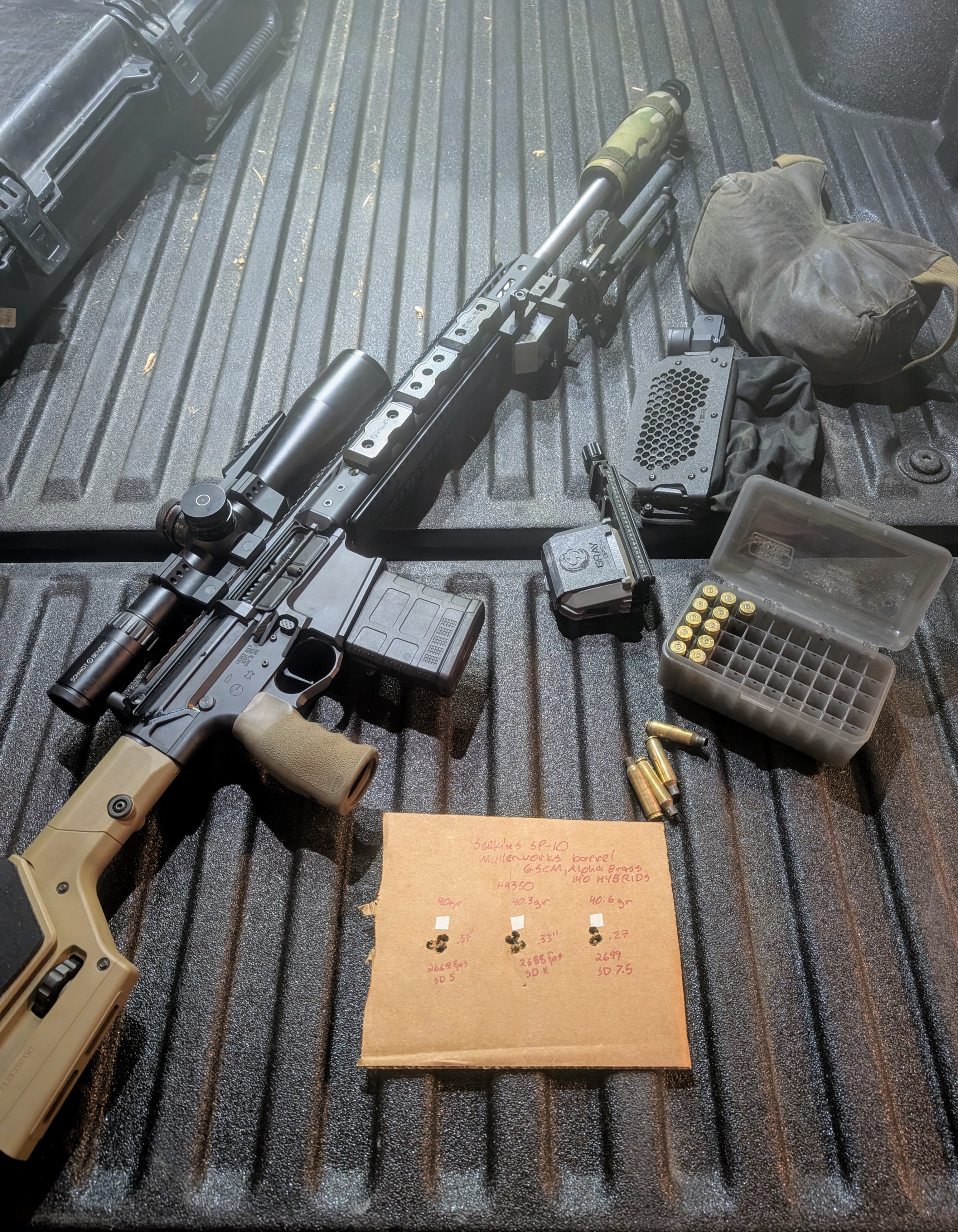

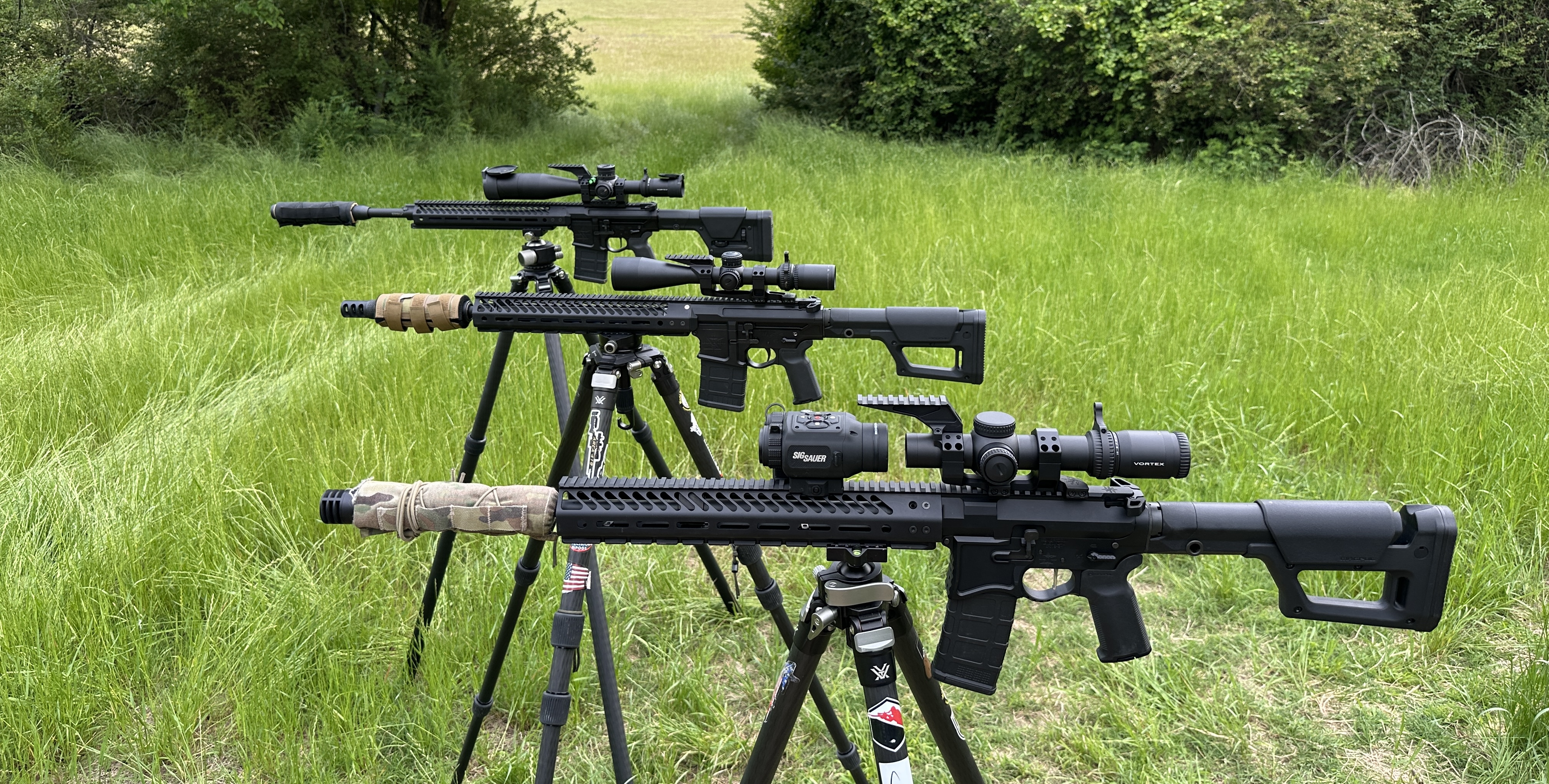

Enjoying the rattle can paint job. Shooting 200gr SMKs suppressed is a vibe I didn’t knew I needed.
Zev Tech upper/lower
Shilen 20” barrel, 308Win heavy contour
Geissele X trigger
Poorstate Armory A2 fixed stock
SLR quadrail
JPE adjustable GB
Lantac Enhanced BCG + Headspaced Shilen bolt
Sporting a American Defense mount and Burris XTR III 3.3-18
12” direct thread Form 1 baffled can
