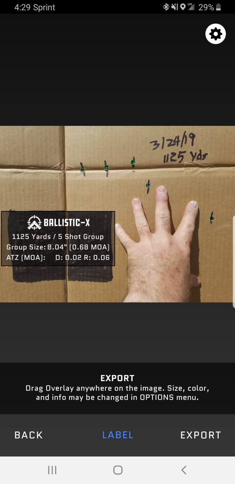

In my rifle I'm pretty sure I won't be able to improve over the factory loads. This group is with fgmm 185 juggernauts on a good day with a light steady wind.

I have an AIAX 308. I have loaded 178 ELDM's since it was new. I mostly shoot steel but have shot a few groups on paper at 1125. I can hold .75-1 moa of vehicle at that distance as long as I don't pull one. A buddy have me a box of FGGM 185 juggernauts to try. They were sub .5 moa at all distances. Resized_Screenshot_20190324-162923_Ballistic-X.jpgAt 1125 I shot this 5 round group... just one group but promising. I have some bergers to load but haven't done so yet
I have an AIAX 308. I have loaded 178 ELDM's since it was new. I mostly shoot steel but have shot a few groups on paper at 1125. I can hold .75-1 moa of vehicle at that distance as long as I don't pull one. A buddy have me a box of FGGM 185 juggernauts to try. They were sub .5 moa at all distances. View attachment 7114544At 1125 I shot this 5 round group... just one group but promising. I have some bergers to load but haven't done so yet
