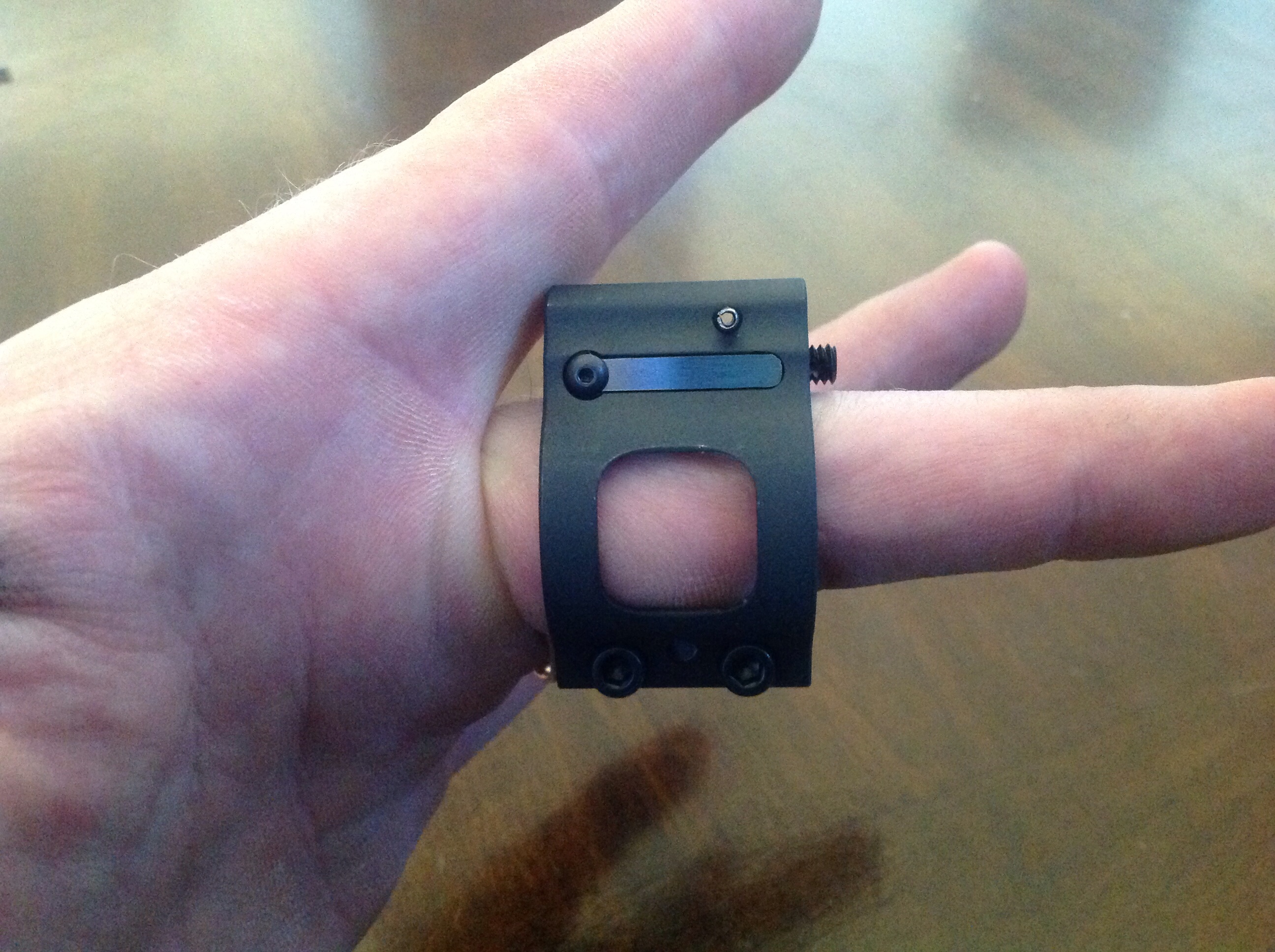

Brake boils down to whether or not you will suppress it and if you are, go with a mount that utilizes that can. SLR offers a detent adjustable, clamp on gas block that can't be beat. Hand guard is all preference. Find the guard you like and go from there. SLR makes some nice hand guards that have a nice barrel nut design.

+1 on SLR Rifleworks for gas block. MicroMOA makes a quality block as well. I'm not aware of a handguard SLR makes for the 308. Only have seen their AR15 pattern designs.

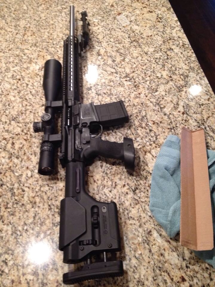

Slr .936 gas block
Jp low mass bolt carrier group
Mega maten mkm keymod "extended rifle" receiver set
Krieger 26" 308 Obermeyer barrel
Geiselle natl match trigger
Bcm charging handle
Magpul PRS stock
Bobro bipod
Nightforce nxs 5.5-22
Badger ordnance max 50 rings.
I wish I got the barrel threaded and a brake. I would go with surefire brake if I did it again

Slr .936 gas block
Bcm charging handle
Magpul PRS stock
Bobro bipod

The SLR is a great adj gas block with the addition of the detent and spring it makes dialing gas a lot easier when switching between from use with a can vs no can. As for brakes go I would look at Ross Schuler or Nathan Wright the one sells 3port and the other does the 4 and 5 port they are made extremely well and he will even tapper the brake to match your barrel profile. that being said you will need to take it to a gun smith to get it timed and opened up to your caliber if needed. Yet at $45 they will be very hard to beat.

gas block--SRL rifleworks for the locking adjustability everyone else raves about---waiting to combine shipping
