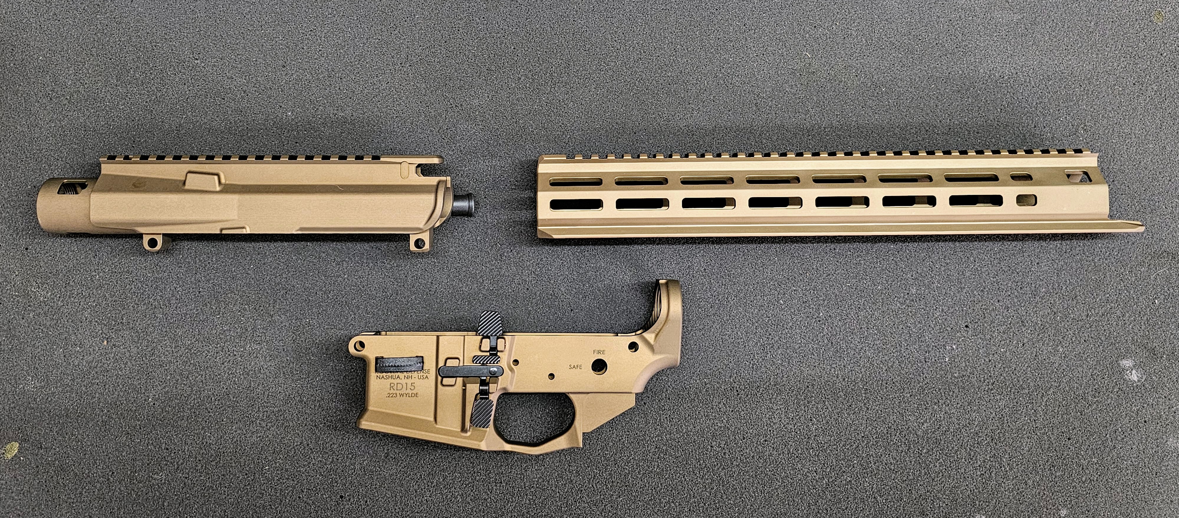

    New Custom Build #4
    (1) New Ridgeline RD15 FDE Build kit.
    (2) Geissele 18" Cut Rifled SPR Barrel.
    (3) Superlative Arms .750 AGB
    (4) VLTOR A5 H2 Buffer System with JP Rifle Length Polshed Spring.
    (5) Geissele Enhanced BCG
    (6) Geissele FDE Ambi Charging Handle.
    (7) Tuned Geissele SSA-E X Trigger.
    (8) B5 Precision Stock.
    (9) B5 Grip.
    (10) Dead Air Xeno Muzzle Brake and Suppressor mounting system.
    (11) Atlas BT65-LW17 GEN. 2 CAL BIPOD with Arca adapter.
    (12) Vortex HD Gen 3 Razor with Bobro QD Mount.

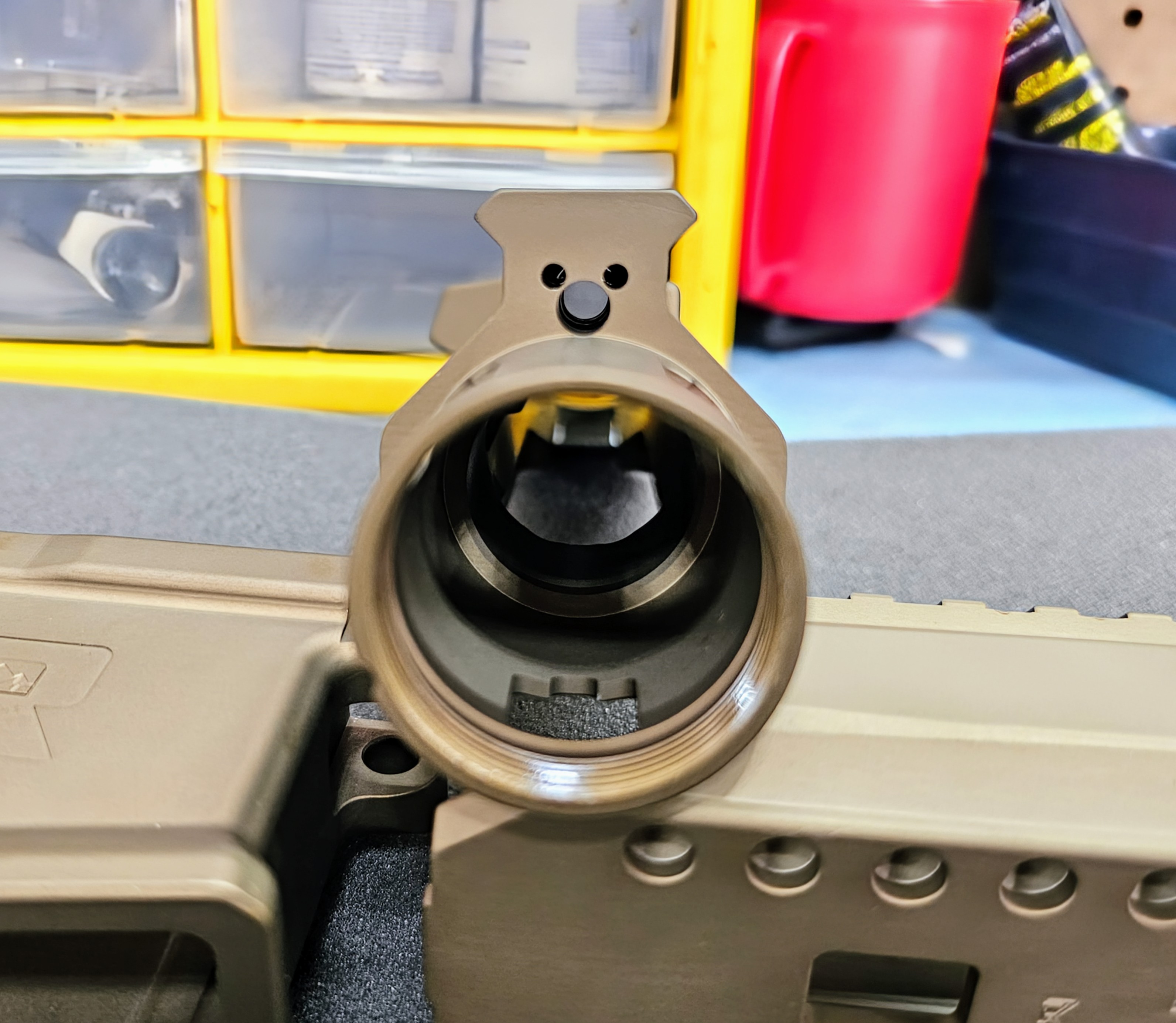

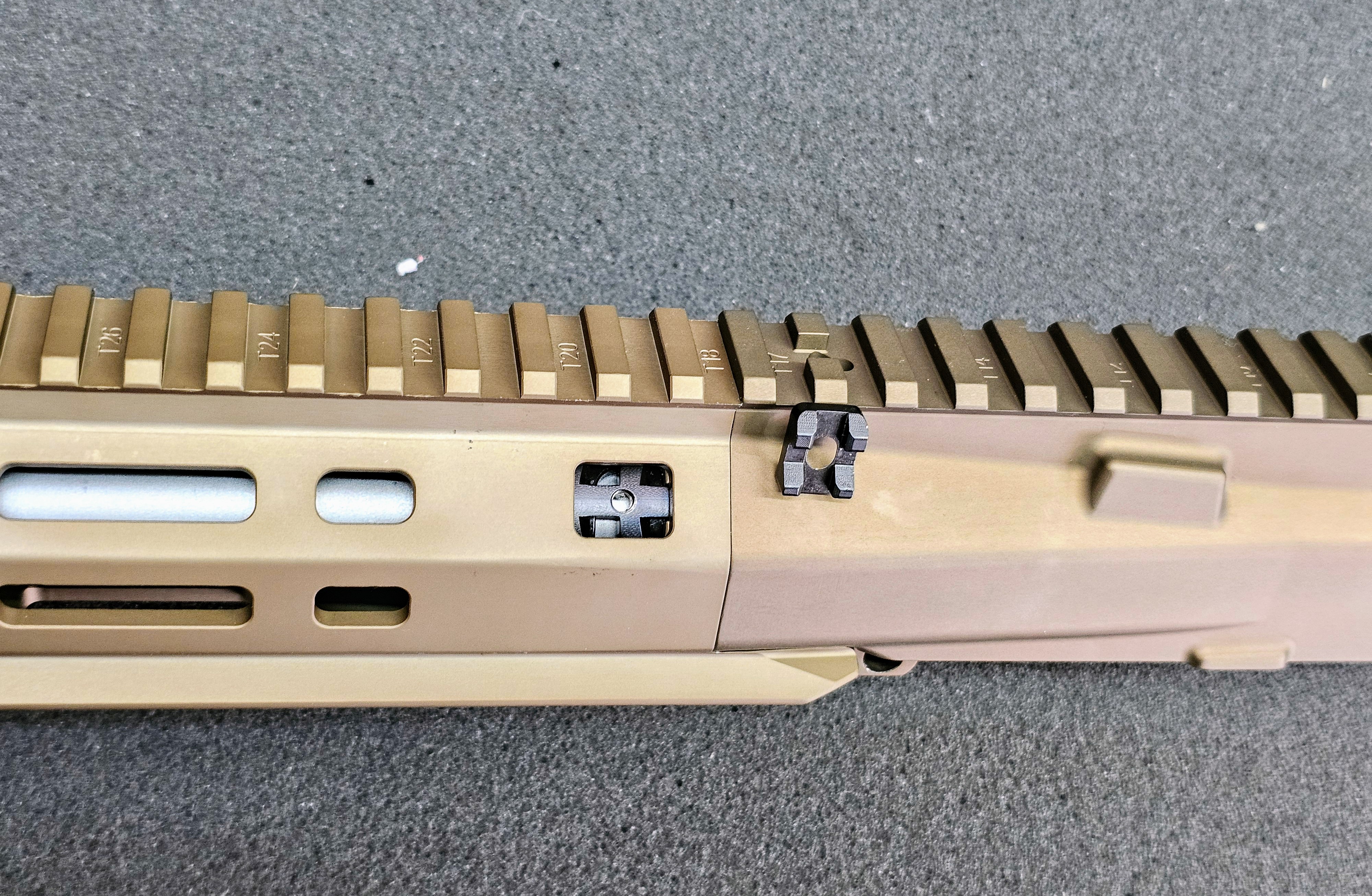

    Surprilitive Arms .750 Set Screw AGB has plenty of clearance.

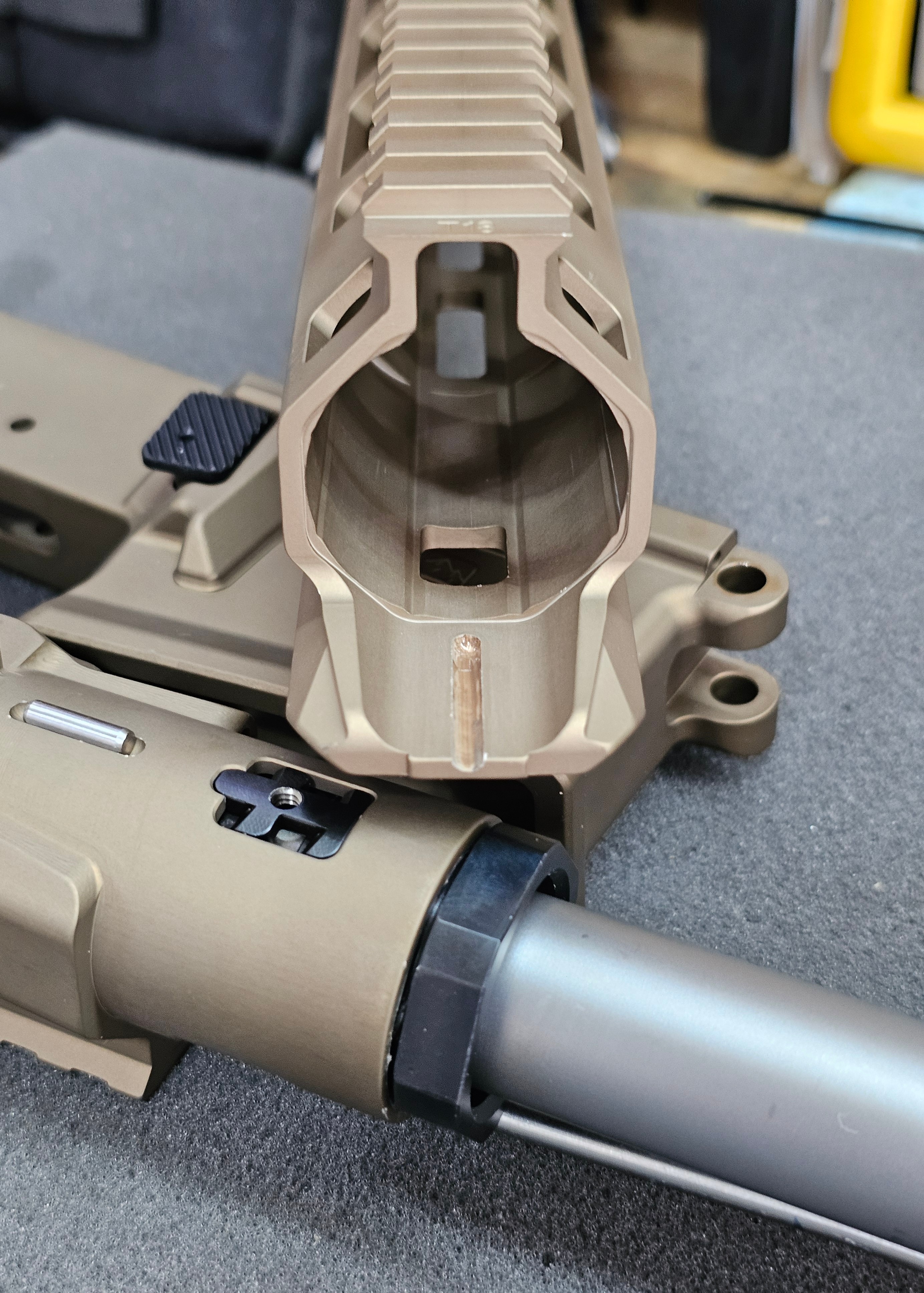

    Assembly was basic and straight forward. make sure to think ahead on what and how you'd like to assemble the RD15 Builders kit.
    Both the Barrel and Handguard are mandatory thermofit's, just remember that when you Torque the Barrel Nut down it will expand the Handguard Mounting Area of the Upper receiver requiring heat to expand the handguard for proper installation.

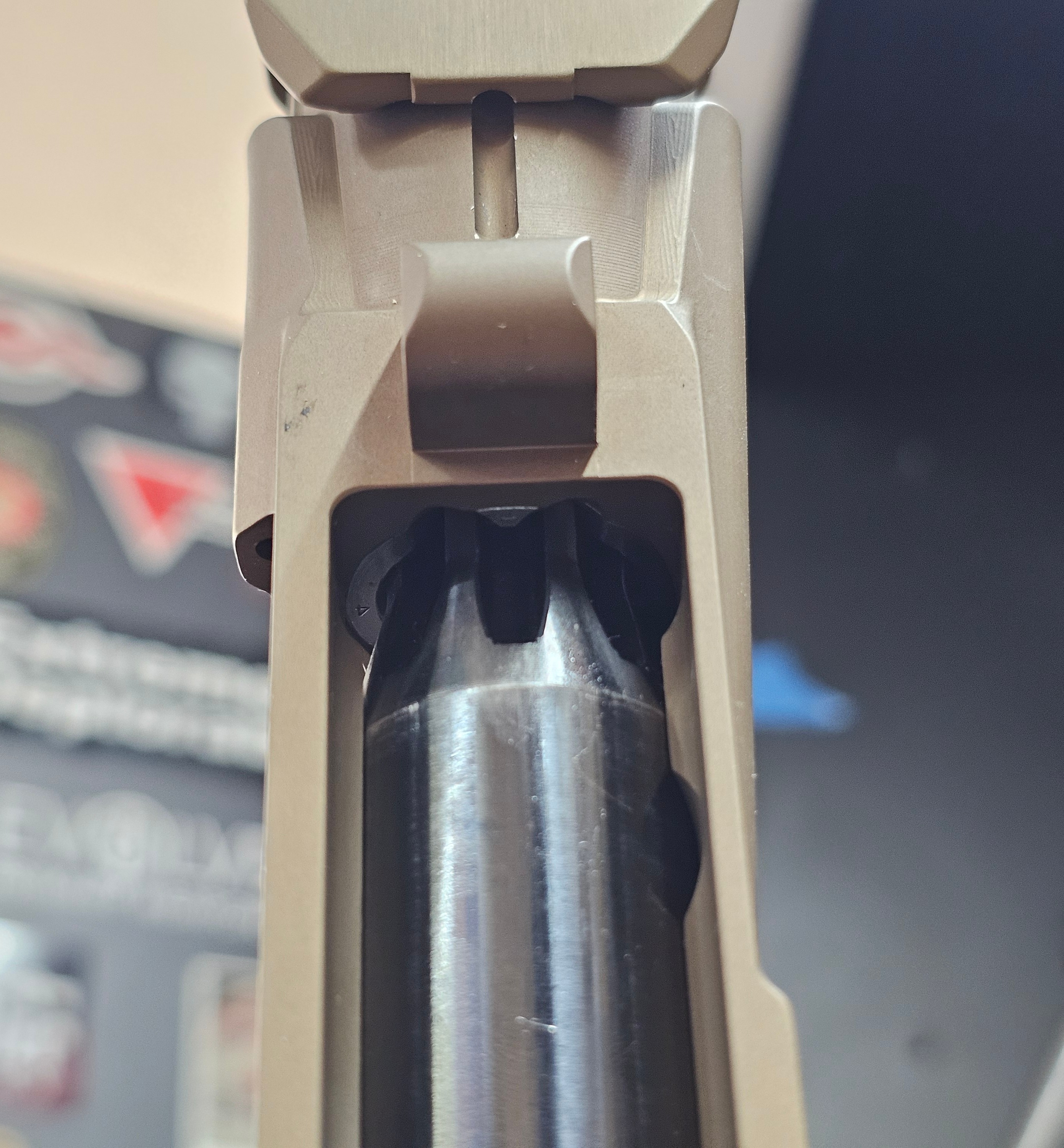

    Anti- Rotation Pin Instalation.

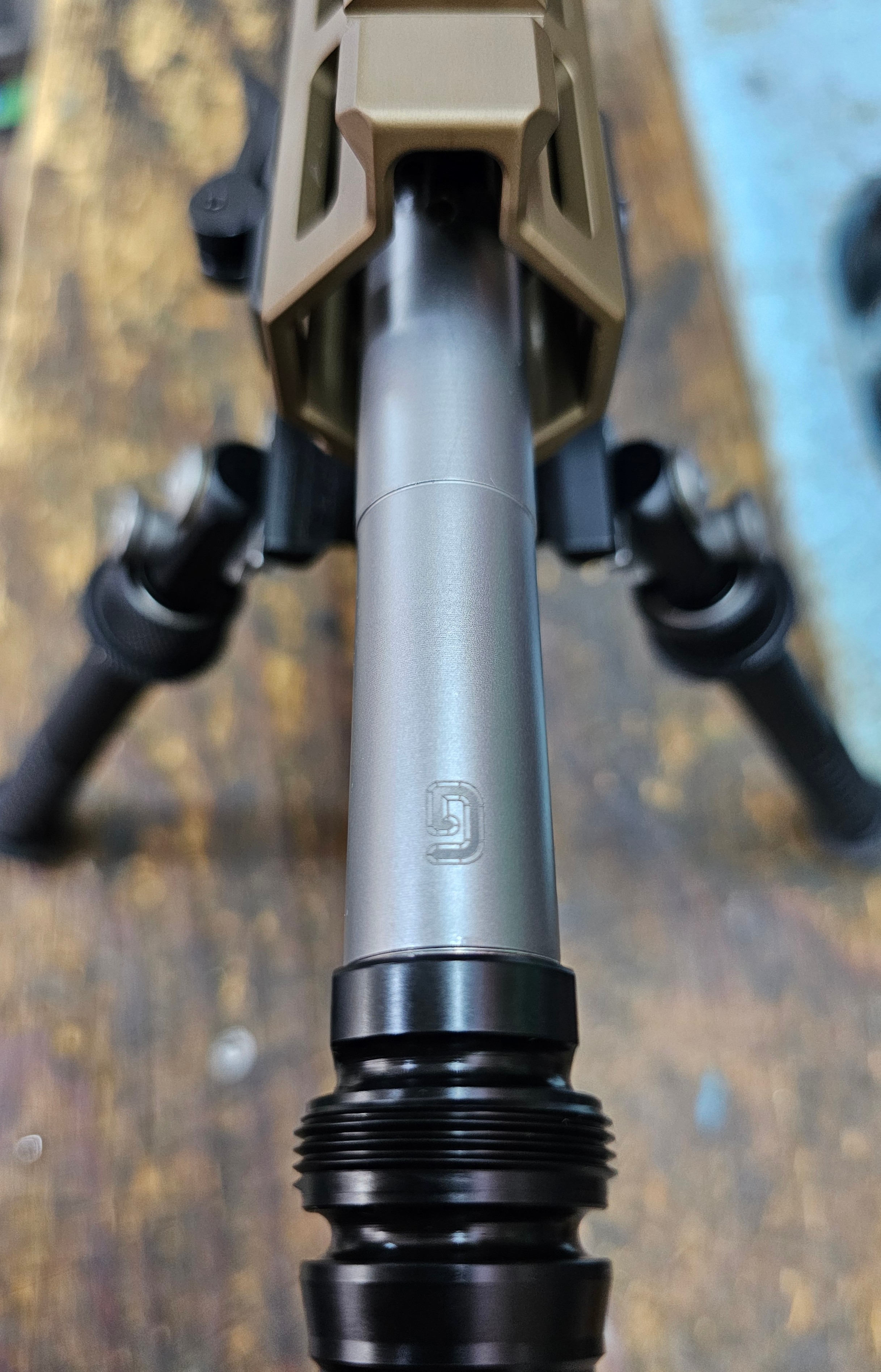

    Extra Gas Vent Ports.

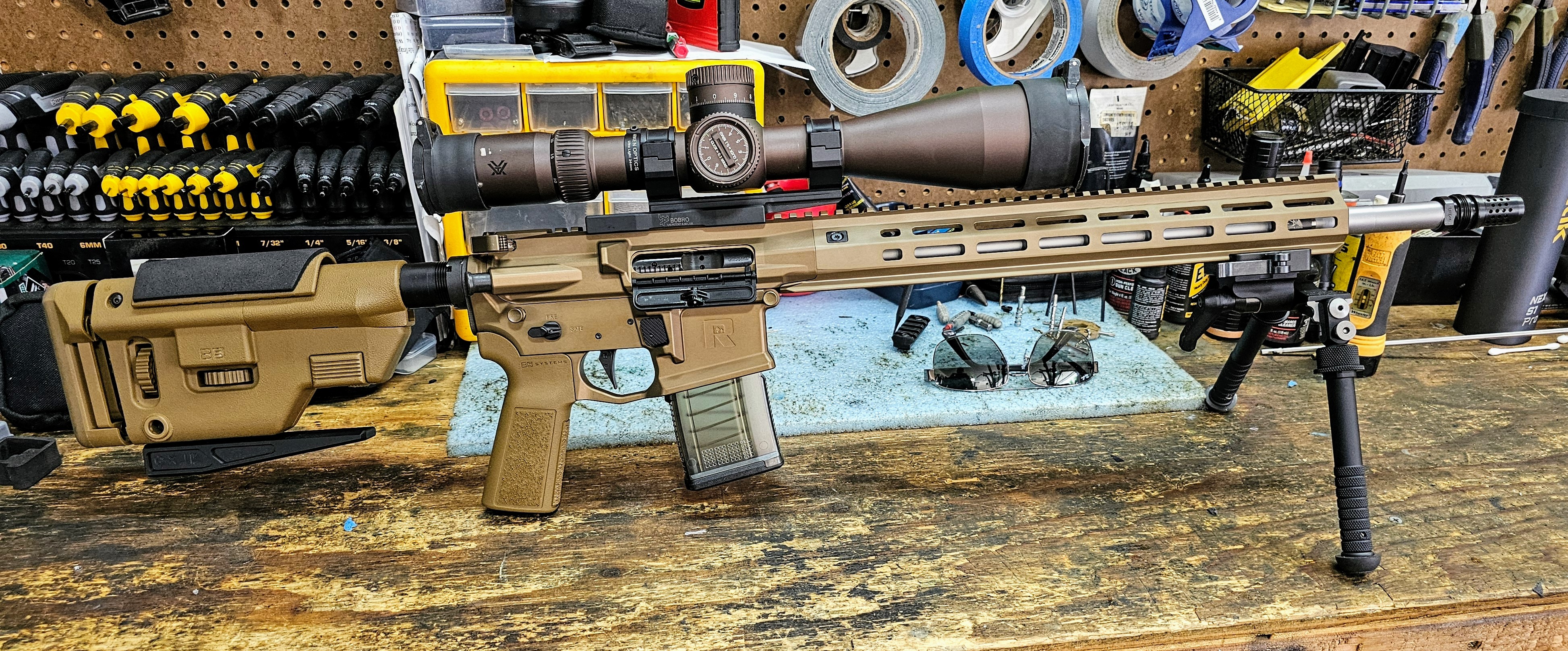

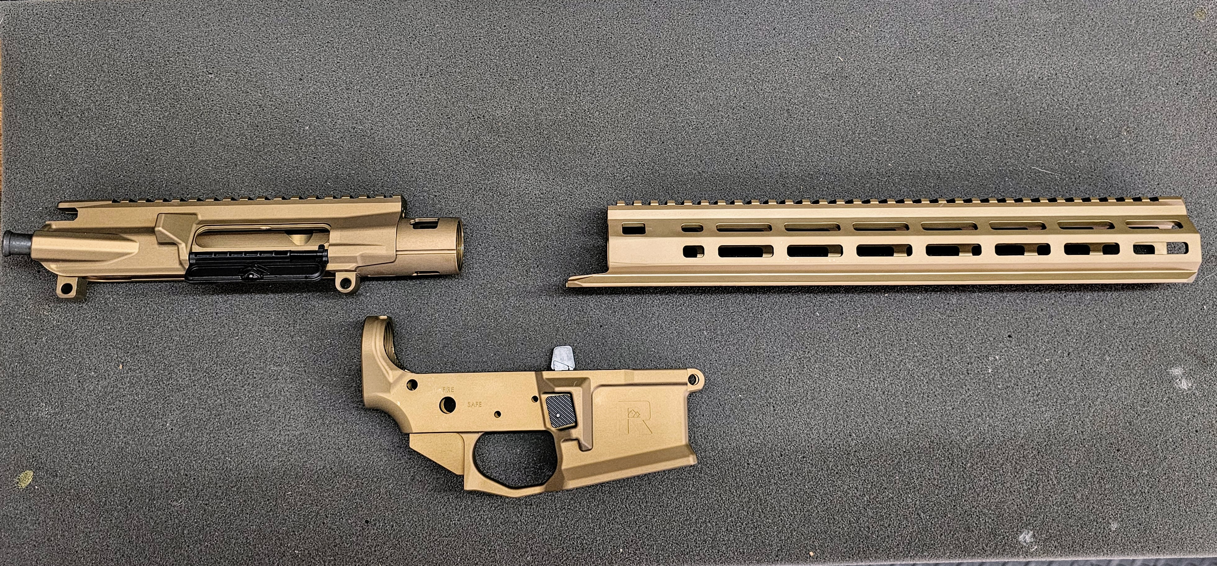

    New Custom Build #4
    (9) B5 Grip.

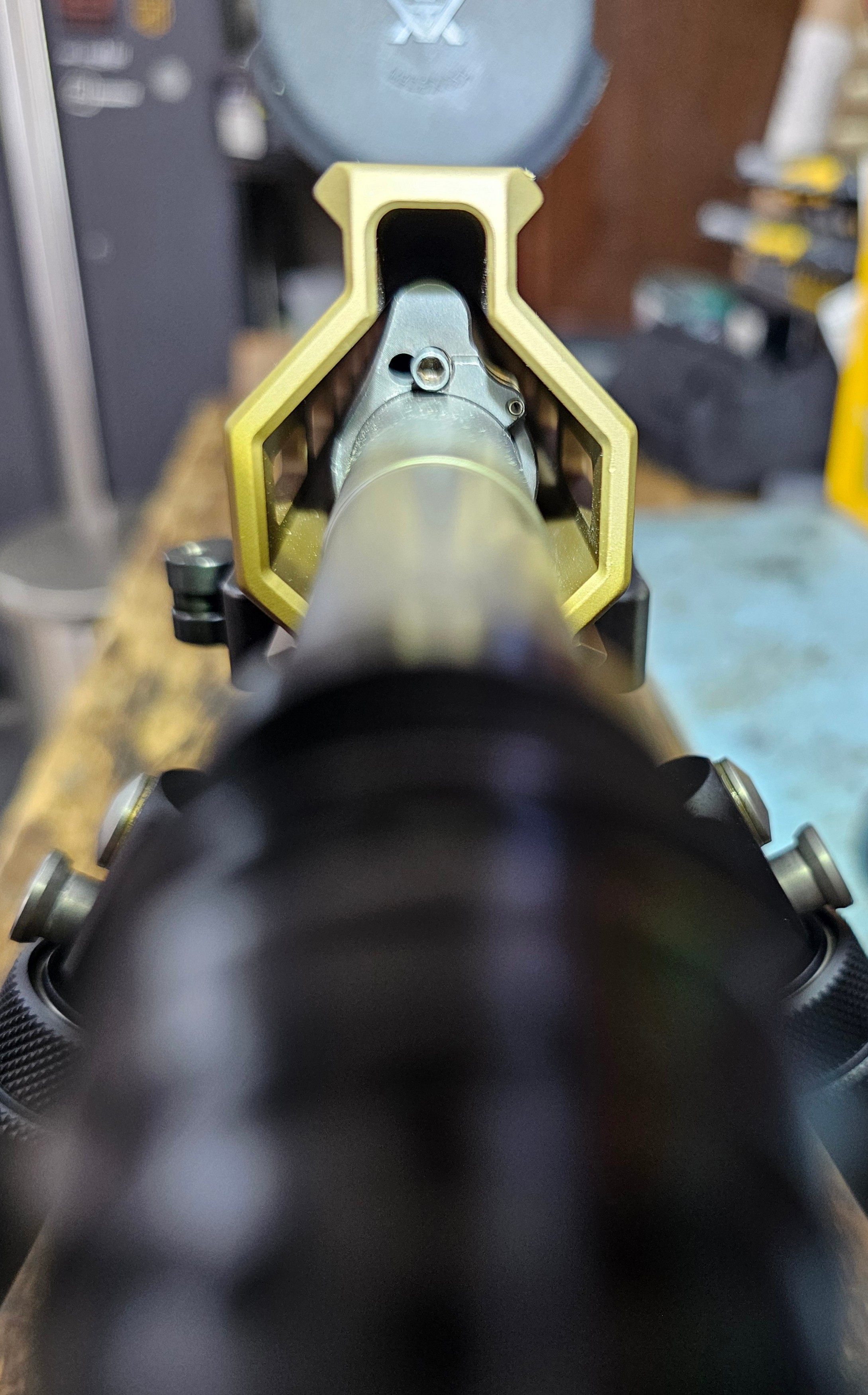

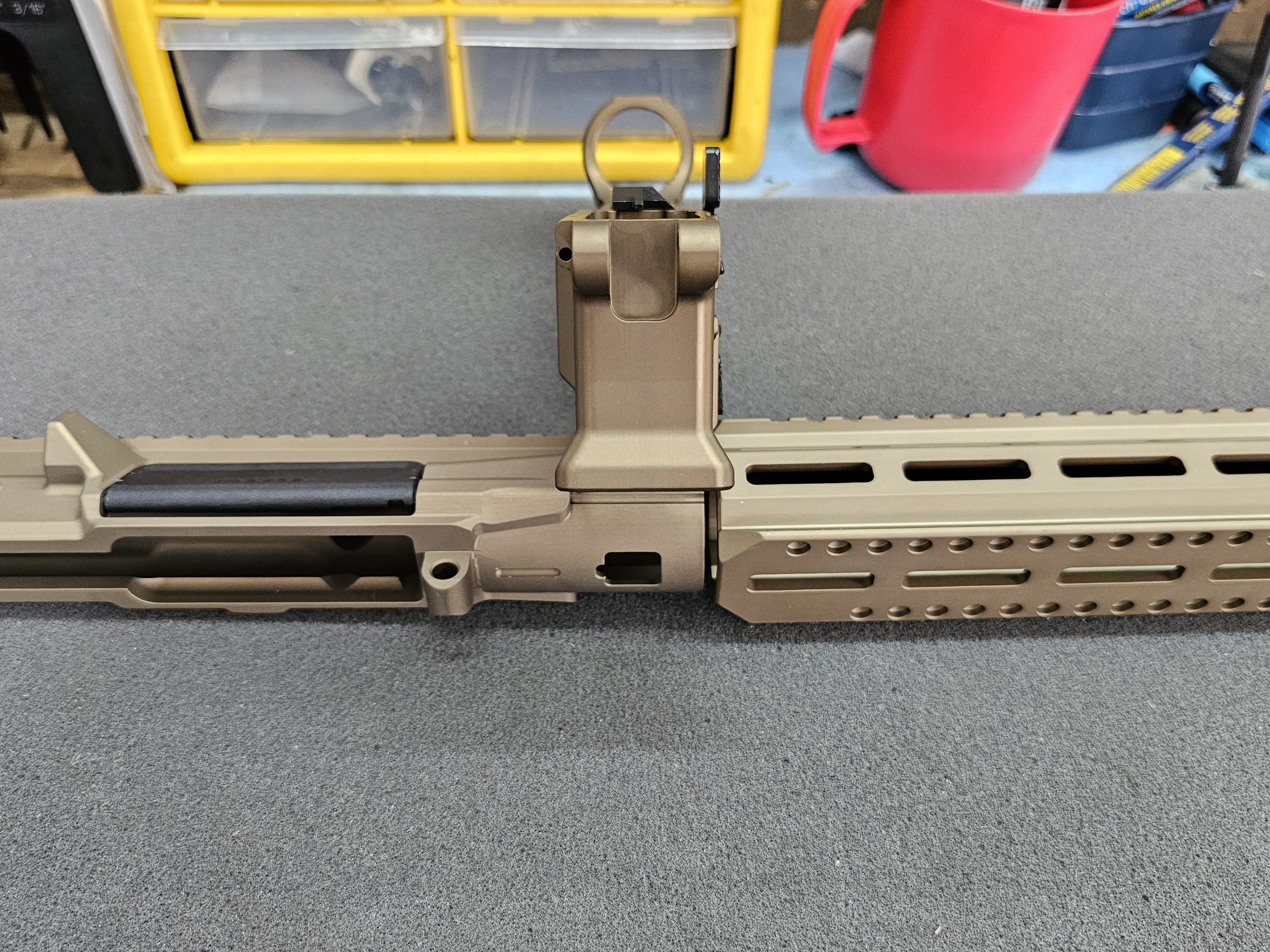

    View attachment 8699071View attachment 8699072

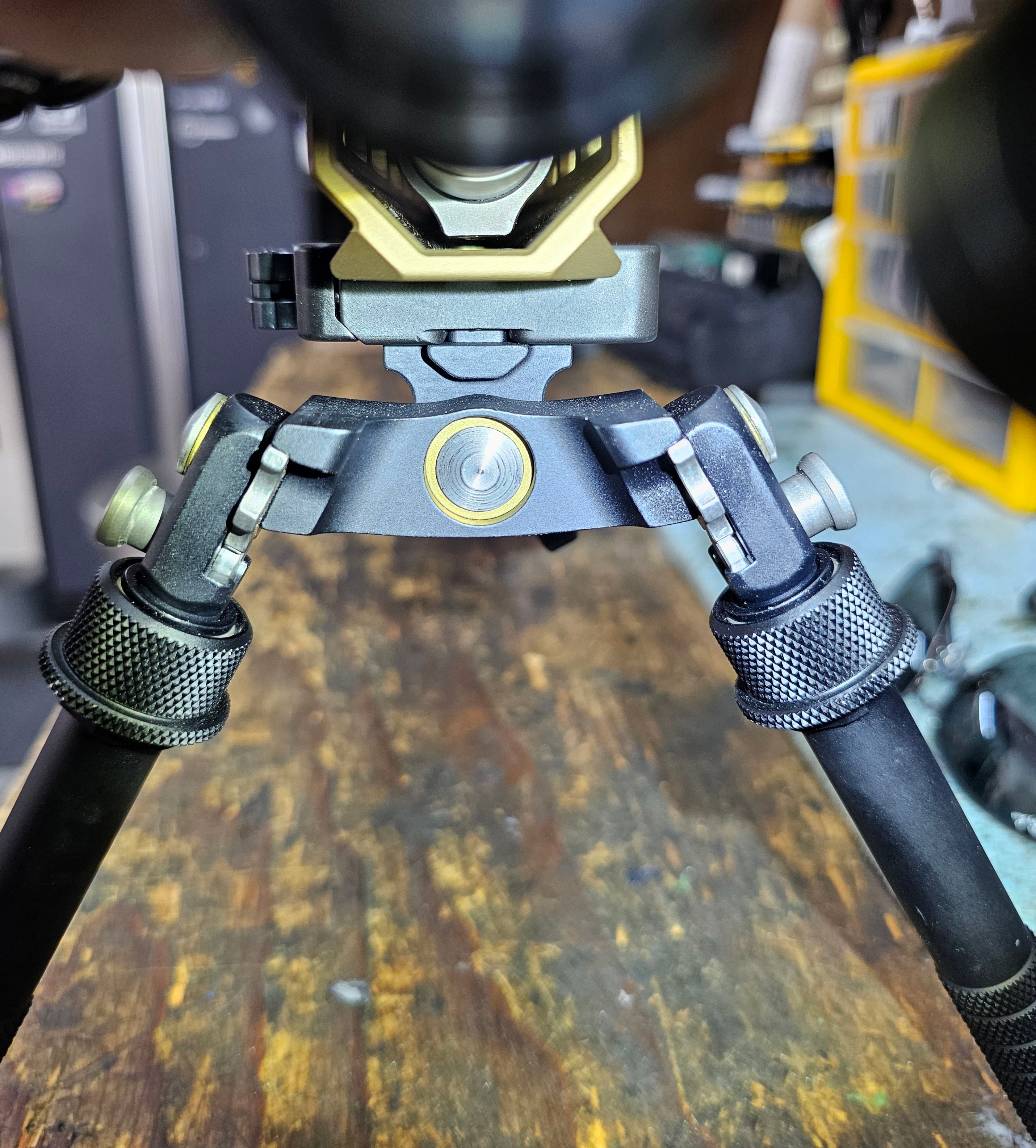

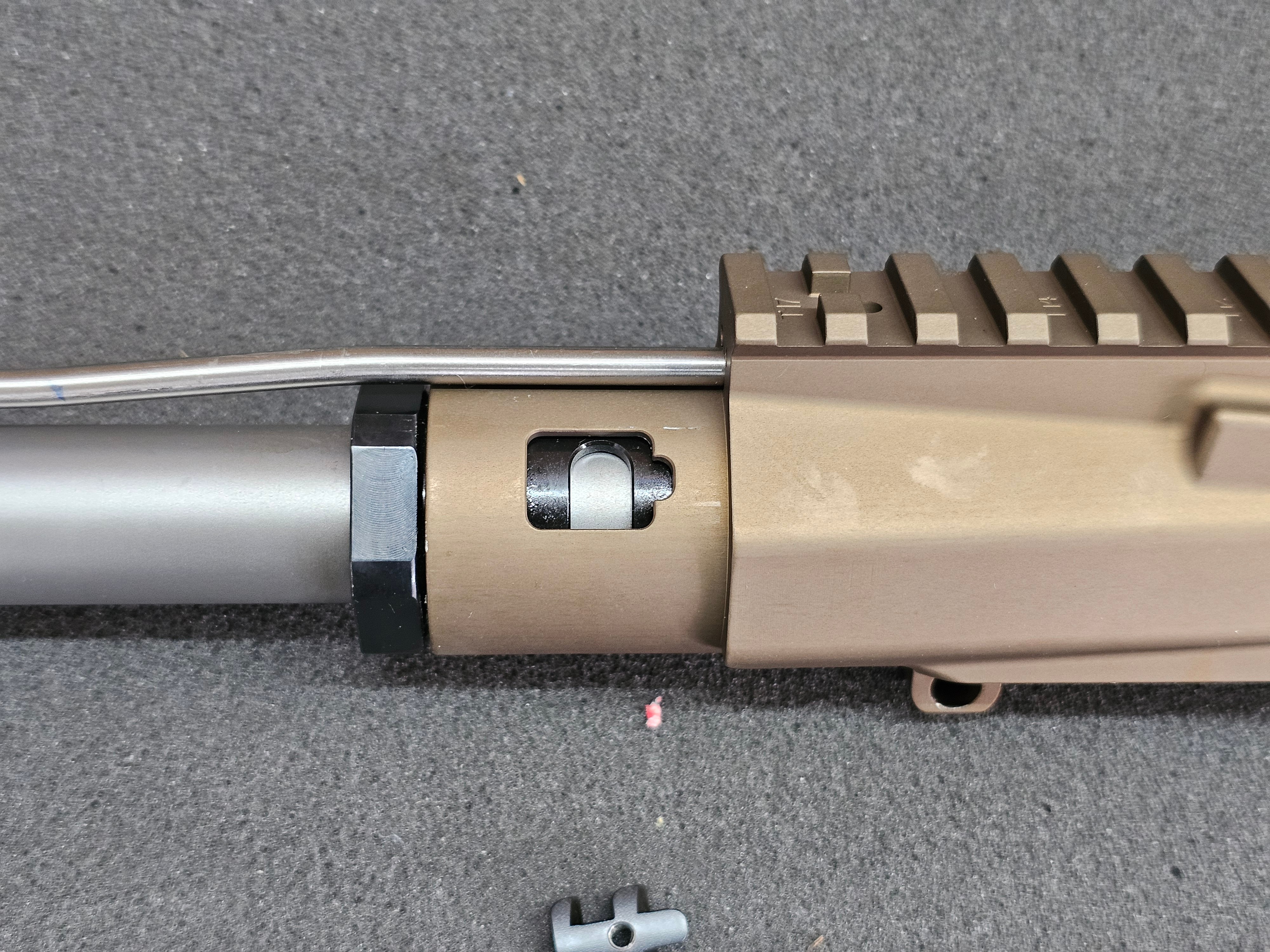

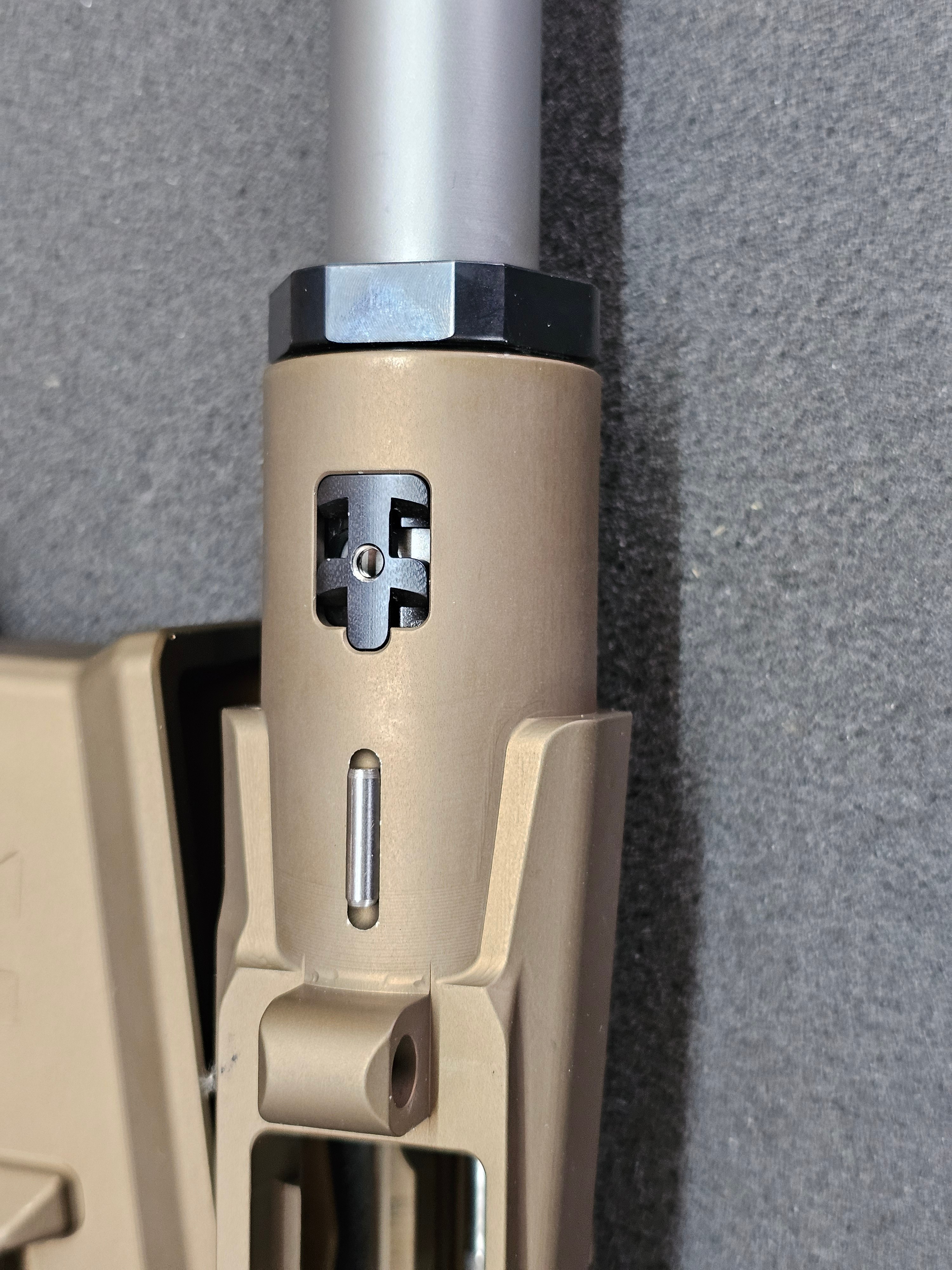

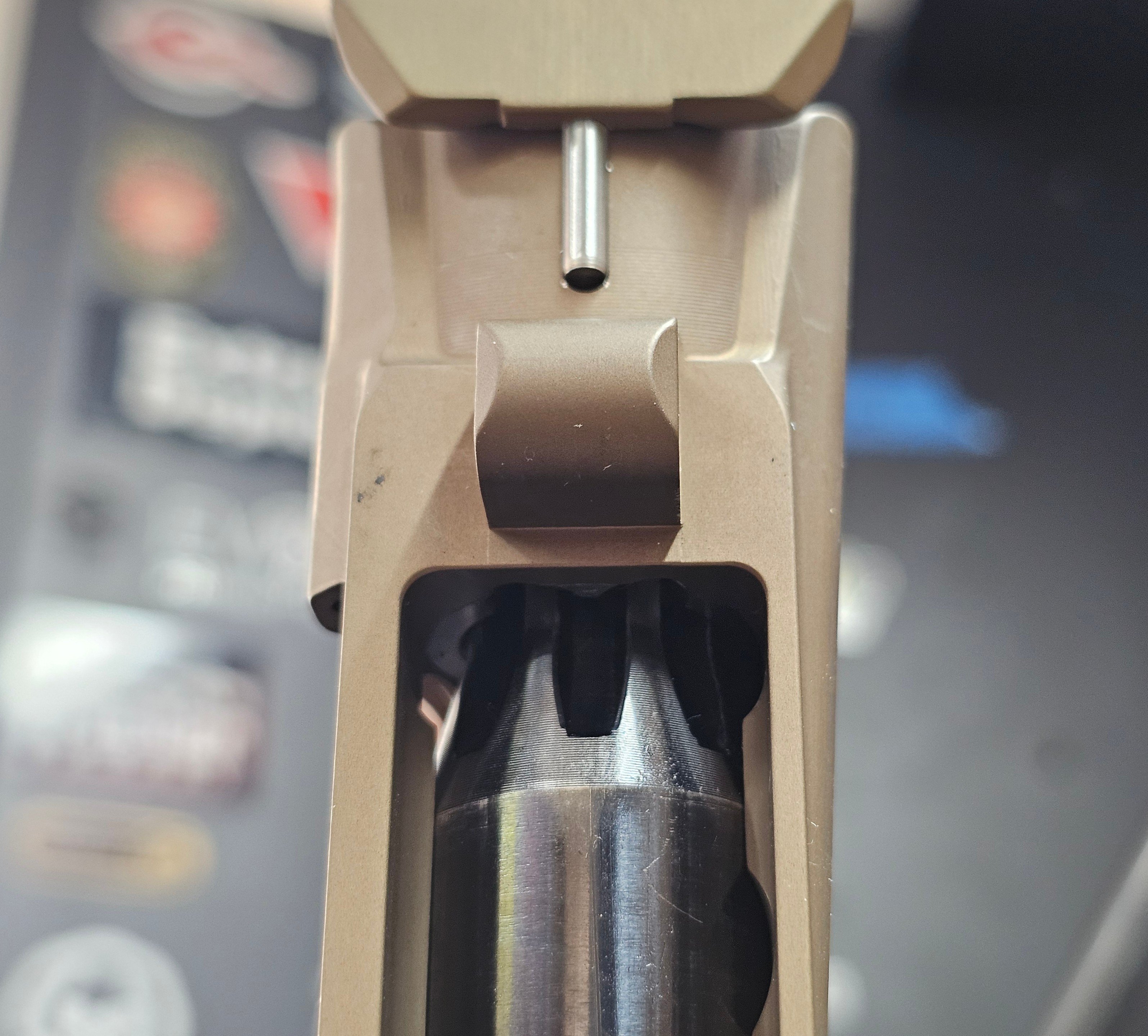

    View attachment 8699075View attachment 8699076View attachment 8699077View attachment 8699078View attachment 8699079

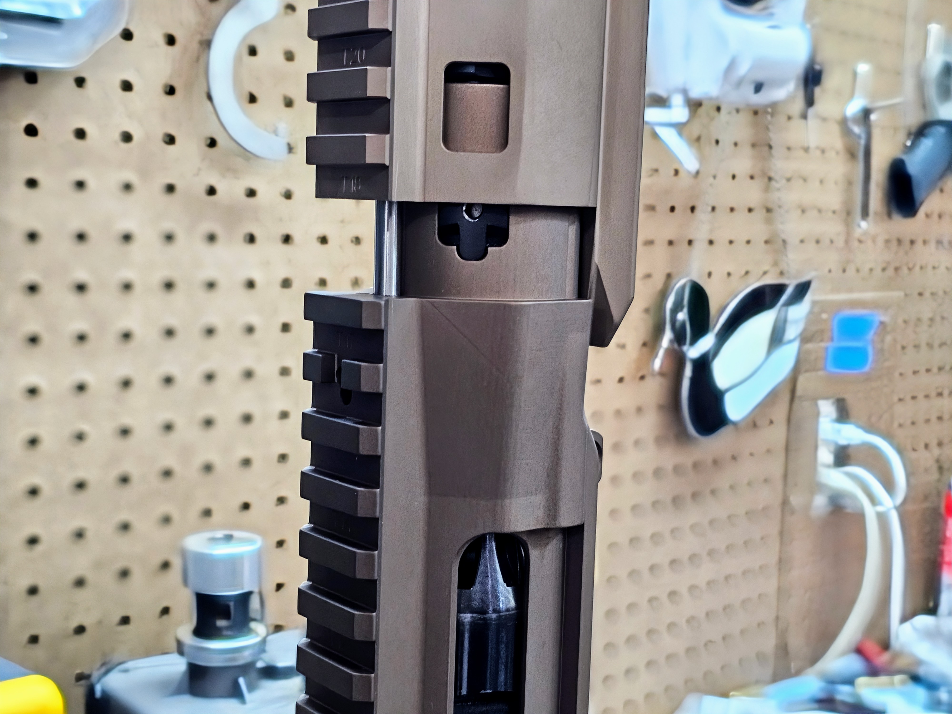

    View attachment 8699080View attachment 8699081View attachment 8699083
    View attachment 8699082View attachment 8699084

    Do you have a way to measure the clearance between the glass block and handguard ?

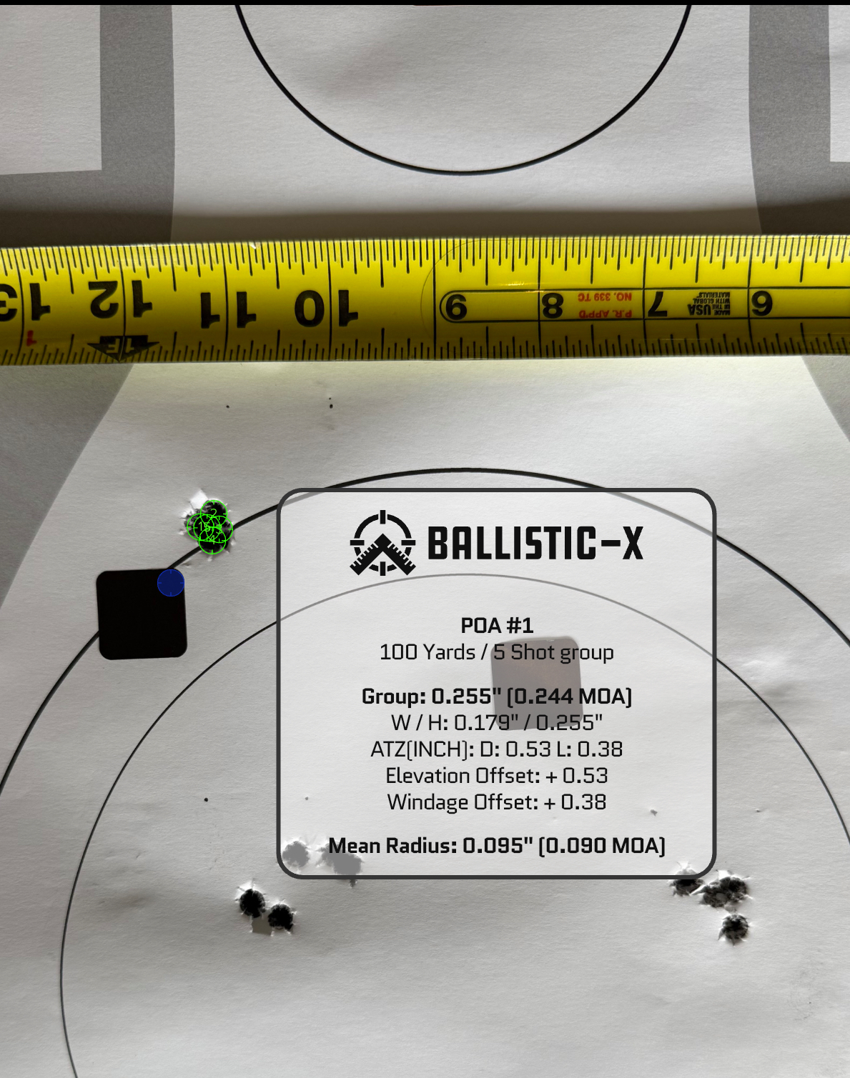

    Okay Boys and Girls I took the new RD15 out for a quickie Range Session between Honey-Do tasks.
    The barrel shoots exactly the same as my others Geissele Cut Barrels, very accurate. The Mirage today was just a FPITA!! But still turned in some solid groups.
    The Geissele Barrel in the RD15 loves the same handloads as well. I didn't have any 24.3gr TAC, 77gr SMK
    Handloads leftover but I did have 5rds of 23.8grs and it easily printed Sub Half MOA.
    These are literally the first 20rds down the barrel.
    I'll hit the range this week early in the morning and give it a solid break-in. I'm 110% confident if I shoot those four loads again with no mirage none will be over 1/2 MOA.
    There's tons of room around the .750 SA Set Screw AGB, I think the closest it comes to touching the inside of the handguard is at the top left and it's exactly a .030" clearance gap which for that style of build is adequate.
    The barrel and handguard are very rigid there's no chance there's going to be any contact from handguard flex, I could easily Mil off .020" of that top left side of the SA AGB but its not needed at all.

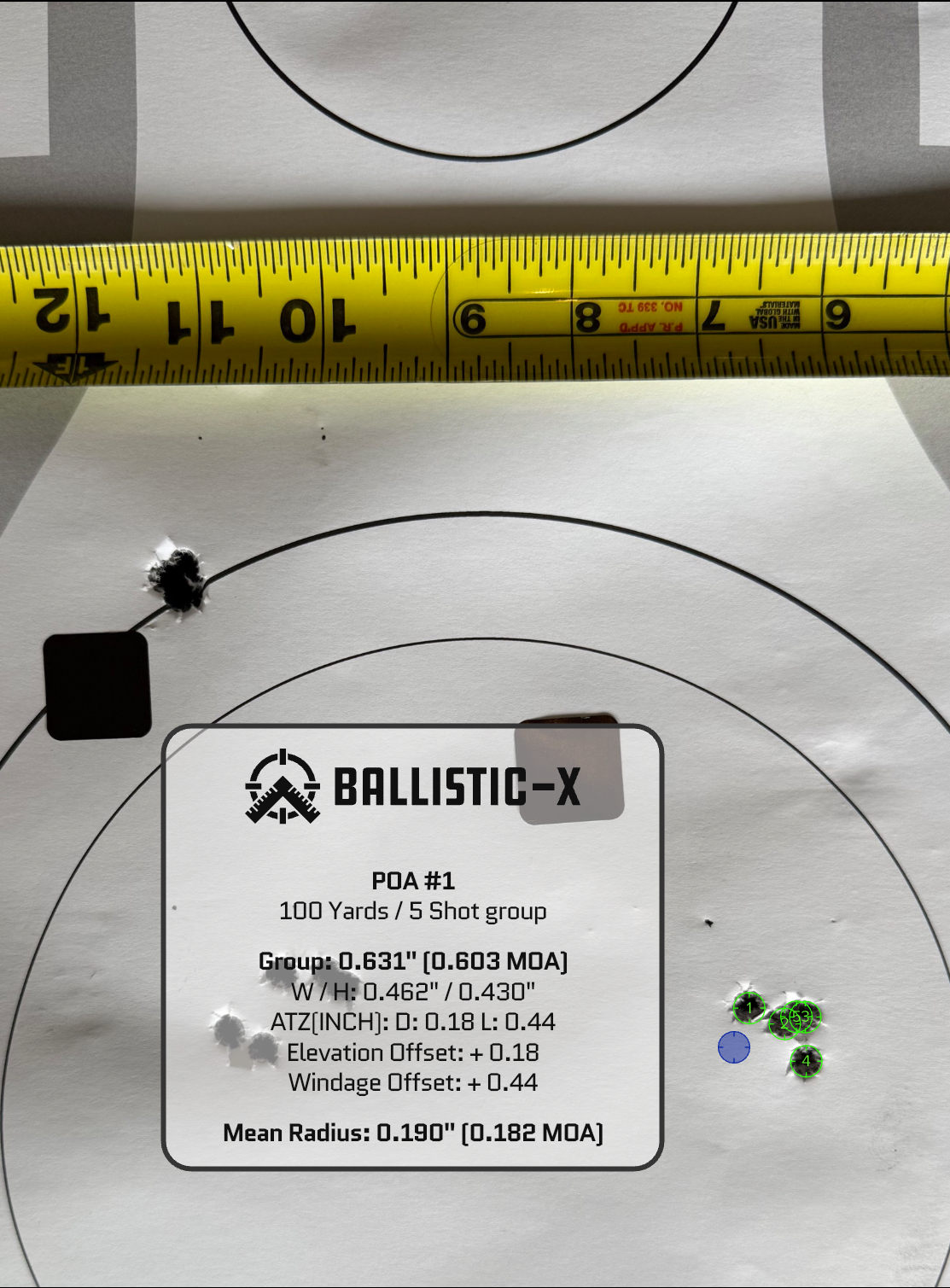

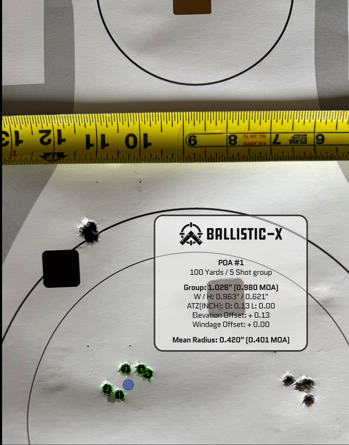

    Obligatory pics. I haven’t fired / trained rifle since I shot mammoth in January, so I wasn’t expecting stellar groups. The trigger replaced the original JP in it. I much prefer 2 stages, and the trigger really was phenomenal.
