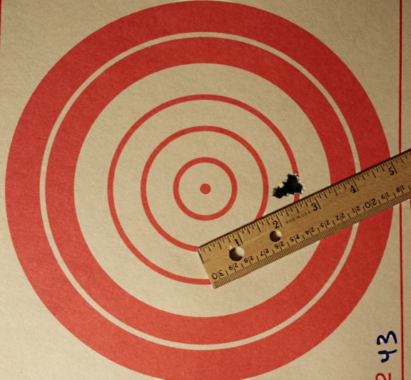

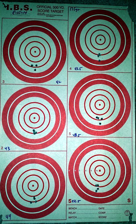

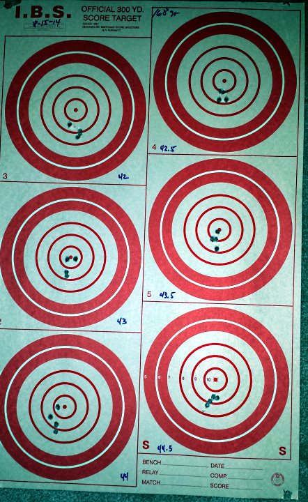

I worked up some loads for my .308, with the results in posted images.
Big question, does it make sense? Can it really be only one single load out of 12 that is good?
New Winchester brass, full length resized, trimmed to 2.005". Twelve loads, 6 each with 168/175 gr. SMK, four rounds for each powder weight (Varget), loaded on Hornady progressive, single cartridge at a time. Powder weights on the target images. COAL ~2.8" (some variation around 2.795)
Savage 10, barrel cut to 20", AAC Cyclone, Bell&Carlson stock.
Shot all 4 of each load without much lag time. Waited until I could touch my suppressor (and not get burned) before next set (played with the Savage FV-SR while waiting :)) Started with the 168 loads, then to the 175. No cleaning at all--so the best group appeared on the 33rd-36th shots.
Should I just be happy with 175gr SMK and 43gr Varget and call it a day? I plan on verifying the results with another set of loads, but don't want to do all 12 variations again. Hope I anticipated most of the questions. Oops...forgot-100 yards...
Thanks!

Don't know yet... I'd like to recreate those results at 100 yds first, then move out further... I suppose I should reload another set and see what happens at 200 and 300 yds.

The best way to assess a load would be to shoot it at distance. This causes some problems as you introduce environmental factors. While it not should all that different, a 5 round group has 20% more bullets then a 4 round group, as such when you go from a 3 to a 5 to a 10 round group the POTENTIAL to show the real loads potential increases exponentially. If you want to verify that the 43g varget load is good, and its a fairly common one, load and shoot 10 rounds on paper and chronograph the results. If I can get a real 10 round group that shoots MOA with 25 fps or less ES I call it good for my 1000 yd guns. Its even better if I can get 10 round 1.5-2" groups at 200 yds, as my range is 200 yds, that is usually where I test LR ammo and those are the kind of groups I can get. It's not uncommon when you shoot a 10 rd group to see 3-5 shots that are almost on top of each other, and 5-7 other that open the group from .25 to 1".
43 looks good bearing further proof and reproduction at distance. 20" barrel - you might be a bit light in the velocity department for >6-800 yards.

0.5 grain changes with a 40ish grain load is over 1% charge weight increment. You could be skipping over nodes. A 0.3 grain increment would be better.
Also fire the rounds round robin. Shot 1 is Round 1 of Load 1 at Target 1. Shot 2 is Round 1 of Load 2 at Target 2, Shot 3 is Round 1 of Load 3 at Target 3.
Also, space out the shots. I use 2 minutes between shots to reduce heating affects.

Yeah, I've got a star next to the 43 Varget and 175SMK in my loading notes... saw that one a lot in my research.

While each node has some width to it, the theory would predict nodes 3% or ~1.3gr apart. So *IF* 43.0 is a node, then 41.7 and 44.3 may be as well. You would have missed confirming both of them by using the specific 0.5gr increments you used.
I'm seeing a lot of vertical stringing in your groups. I just started load work with my suppressor and noticed heavy mirage after a few shots. The first time I shot through mine I noticed more vertical than I normally get. I think you should shoot your strings slower and if you see mirage from the can, let it cool some more.
But yes, 43gr looks good.

OCW only needs 3 rounds per charge increment. More does not make it work better. Same thing with distance, 100 yards for load work up, then try the load you choose at a longer range. But history shows, if you do the method right, the load WILL work at longer ranges.
