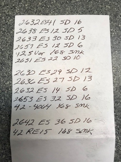

Forster FL size
Lapua Brass
These loads grouped ok but I know it can be better.
Here's the numbers from today so I'm wondering whether to play with charge weight or seating depth to increase accuracy and numbers.
I would like to get speeds up to around 2700FPS but when I try I fall out of a accuracy node.
It shoots these loads decent but I know what the rifle is capable of doing and with the numbers all over the place it tells me that it is a unstable load.
So I can play with seating depth or try playing with the load a little.
