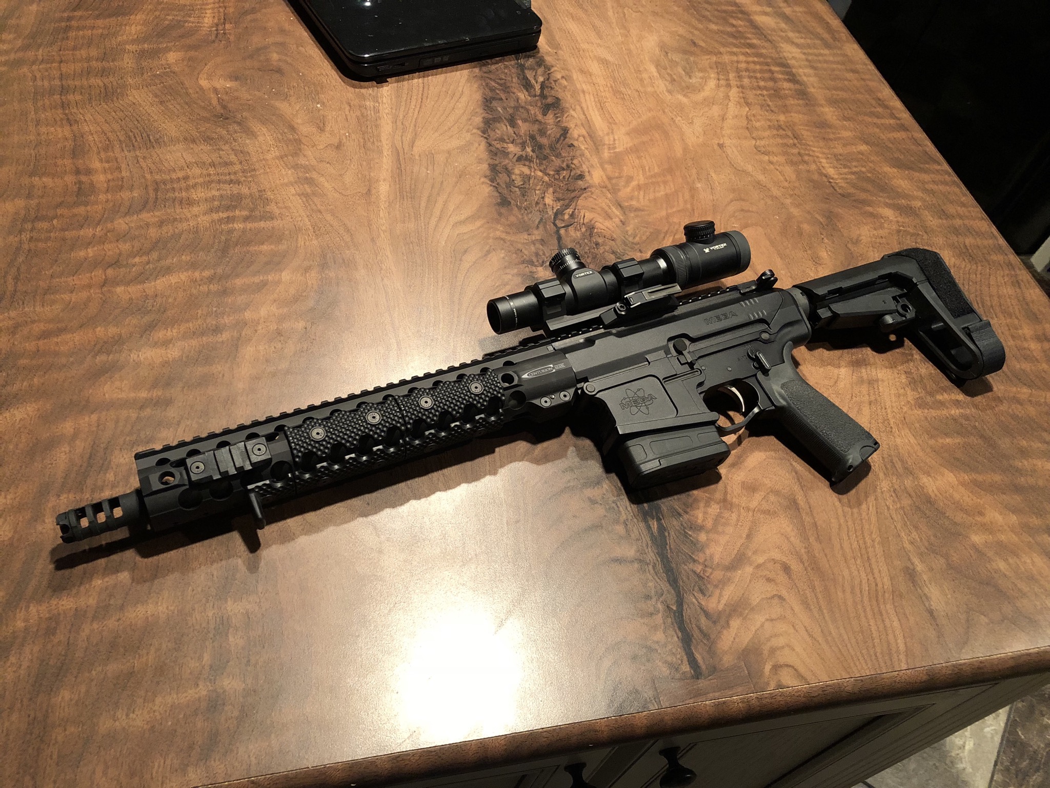

I built a 12.5” 308 pistol. Mega Maten receiver set and a Bartlein barrel from Craddock Precision. I worked up a 155 AMAX load and then bought a 16” SR 25 and the 12.5 went to the back burner.
It’s loud as shit and fun as hell. You want it build it. Easy as that.
