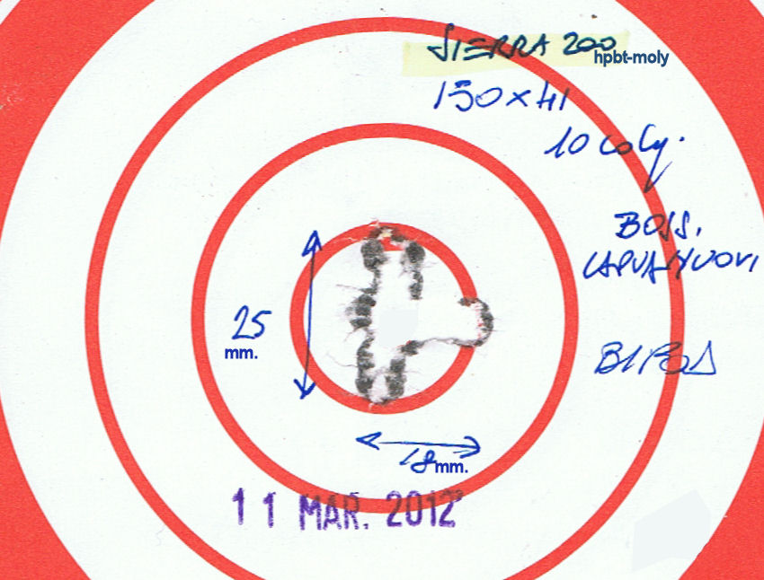

I don'have a chrono, and this was only on old try at 100mts, 26" 1-12 700varmint,anyway_ as can be seen, I'm not a fine shooter, but all the 10 shots have landed there w/out effort,therefore I'm of the opinion that this (quick) group can be easily bettered_ this was the reason behind my question to truly knowledgeable shooters/hanloaders_
If that is the average kind of grouping you get with them heavies....i would not worry to much, that is more than sufficient. The only drawback you might encounter will be not enough speed, so for long range wind and stability might become an issue. But if you seldom shoot beyond 300, than that is no issue either.
I would agree about lr speed/stability problems , even pumpin'up the dose_ the 10rds.group shows my bad habits only, anyway_ my next full ladder tests, w.N150 & heavies, will be ( I should say "must") oriented to find the nodes allowing their best accuracy inside the distance allowed here_ 500 or more is quite a rare event, here, but your observation could motivate me to ladder test even the N140, with the same bullet weights, having seen what a friend, better shooter than me, has obtained with them from his 26" 1-12 PSS_

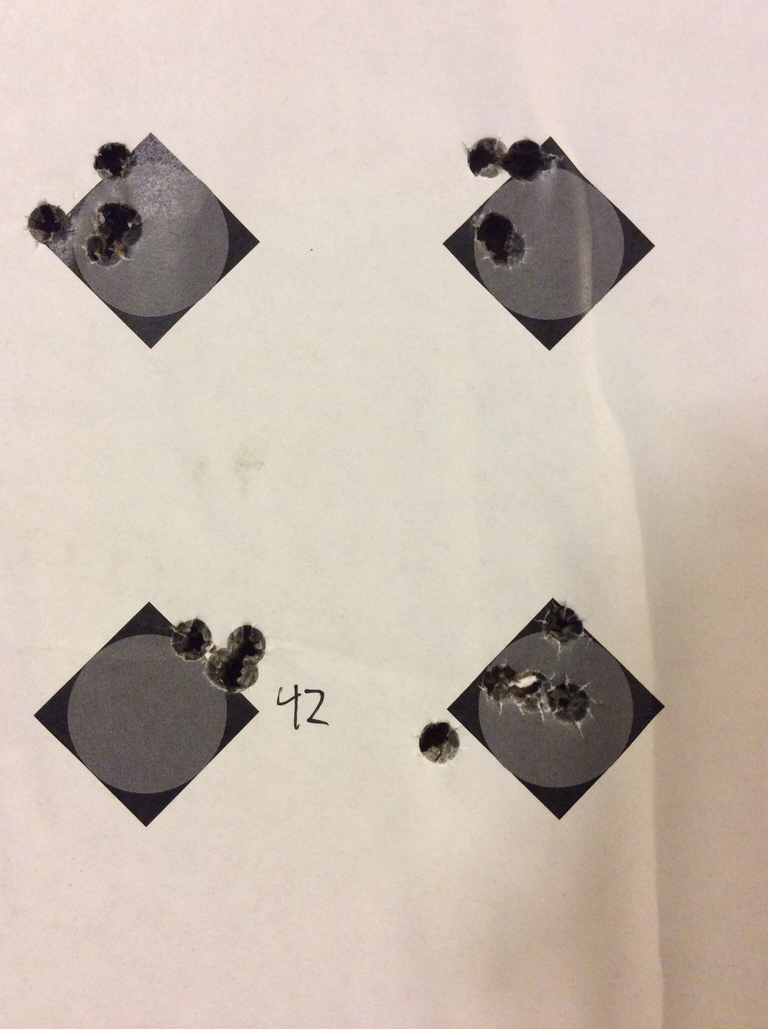

Ok so I've finally jumped on this 208 band wagon with my 20" Surgeon (1/11.25). I figured this would make awesome round for Mules this fall.
So far I've only developed load data with varget as RL17 seems to be a little tricky to find (ironic i know). Using once fired LC LR brass primed with BR2s and an OAL of 2.9" I started at 37.5 and worked up from there with a goal of 2450 FPS. Hornady books has a max at 40.0 but I creeped the loads up to 44.2 which started to make me very nervous. Besides from some lite ejector marks I wasn't getting any pressure signs which really weirded me out, no super flat primers with creators, no heavy bolt lift, frankly I just can see how a load like that wouldn't be excessive so I stop. I took a look at the bolt afterward and noted some very slight marks on the backside of the lugs. Honestly I've never really inspected my bolt this closely before in the last 4000 rounds. I'm not overly concerned about it as I fired another 300 rounds of M118LR since then with no effect on accuracy or function. I've attached some pics of the bolt (although I admit they are not the best) any thoughts on the origin of the marks are welcome.
That said I when back to 42.0-42.5 and as you can see from the last pic this looks to be a sweet spot for me and it put me right at 2466 FPS with an SD of 4 for 20 rounds.
