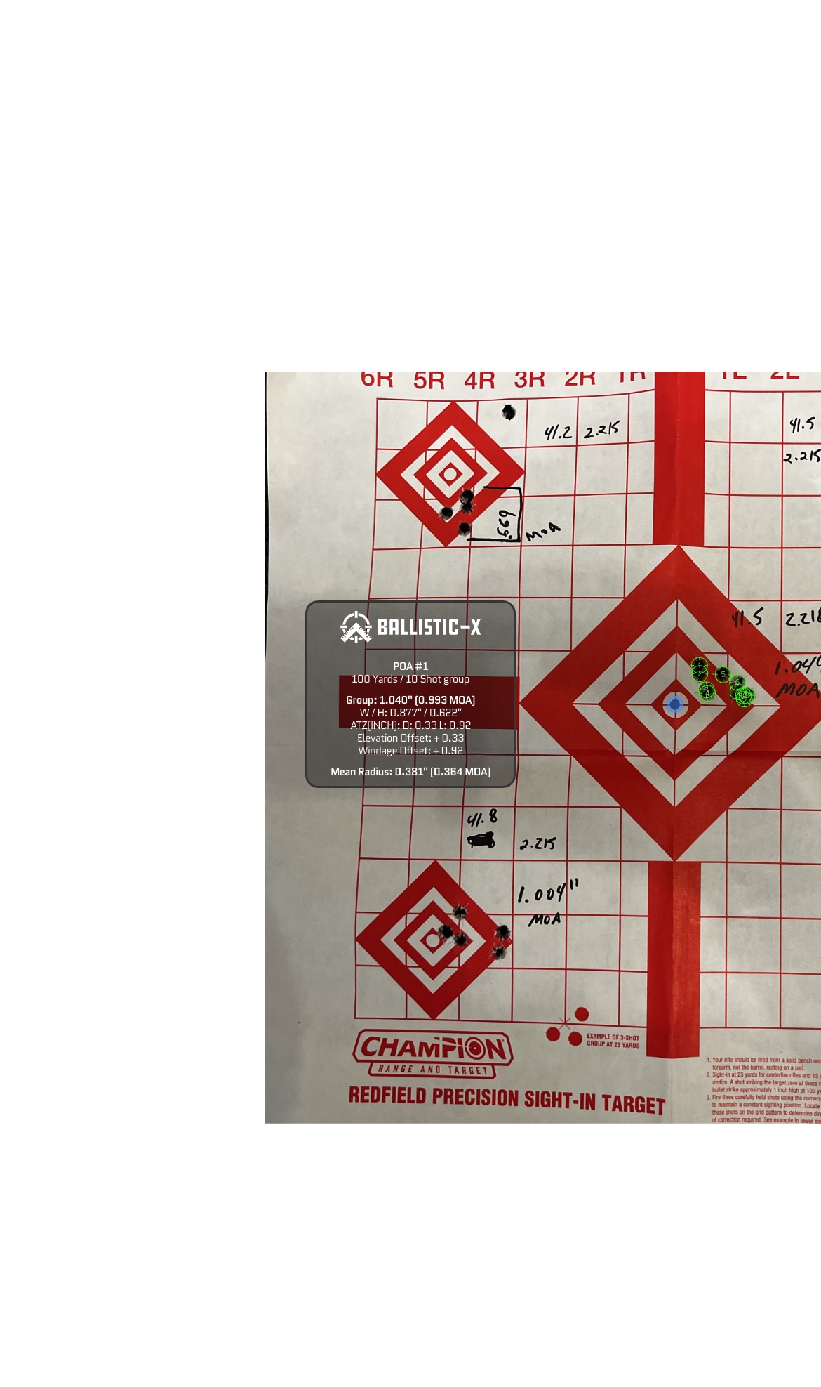

FWIW, my test results out of 16" AR10 "self-build"....
Load Date = 23 Aug 2015Powder = AR Comp
Bullet = Hornady 155 OTM BTHPPrimer =WLR
Ballistic COE = .405COAL =2.280"
GrainsAvg FPSStd DevES
Start42
2659​
2596​
2619​
2659​
26332763
42.2
2514​
2554​
2648​
2657​
259361143
42.4
2643​
2647​
2630​
2625​
2620​
26331027
42.6
2606​
2603​
2588​
2593​
2592​
2596718
42.8
2618​
2595​
2600​
2609​
2628​
26101233
43
2599​
2599​
2585​
2669​
26133384
43.2
2622​
2630​
2630​
2608​
2612​
2620922
43.4
2658​
2630​
2646​
2659​
2662​
26511232
43.6
2656​
2652​
2688​
2663​
2640​
26601648
MAX43.8
2640​
2661​
2683​
2669​
26631643

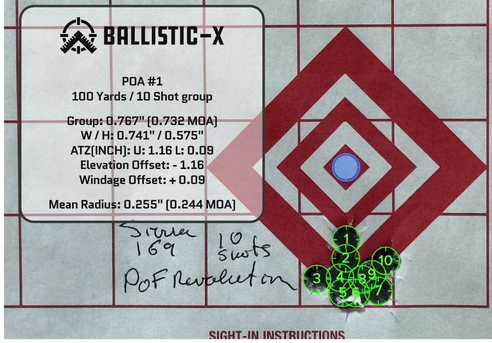

Latest load that really works out of my POF 16" Revolution gas gun.
Sierra 169SMK's
LC Brass, I sort by year now and these were '07's
CCI34 primers
IMR 4064 powder
43 grains on the nose
2.820 COAL (I'll have to look up the ogive measurement and will update when I do)
.004 under fired case length (1.625 on the Hornady comparator)
10-shot group data after bulk loading on a Dillon with manual powder throw
2528.9 FPS average
SD8.0
ES 24.3
This was sub-MOA for a 10 shot group. I probably could have made it tighter but my scope was dialed for POI and I took out the "dot" to aim at.
I've since experimented with the Berger 175 OTM's with Vhitavouri 550. First load was slooooow but five shots touching. Came in at 2289 FPS but super accurate. I had one result with a higher charge that was almost as good but need to do a 10-shot proof group first. I have 185 Juggernauts arriving today and will test those on Saturday. I have a feeling both would be better with 4046 but the VV can be used in a powder thrower and it burns so clean.

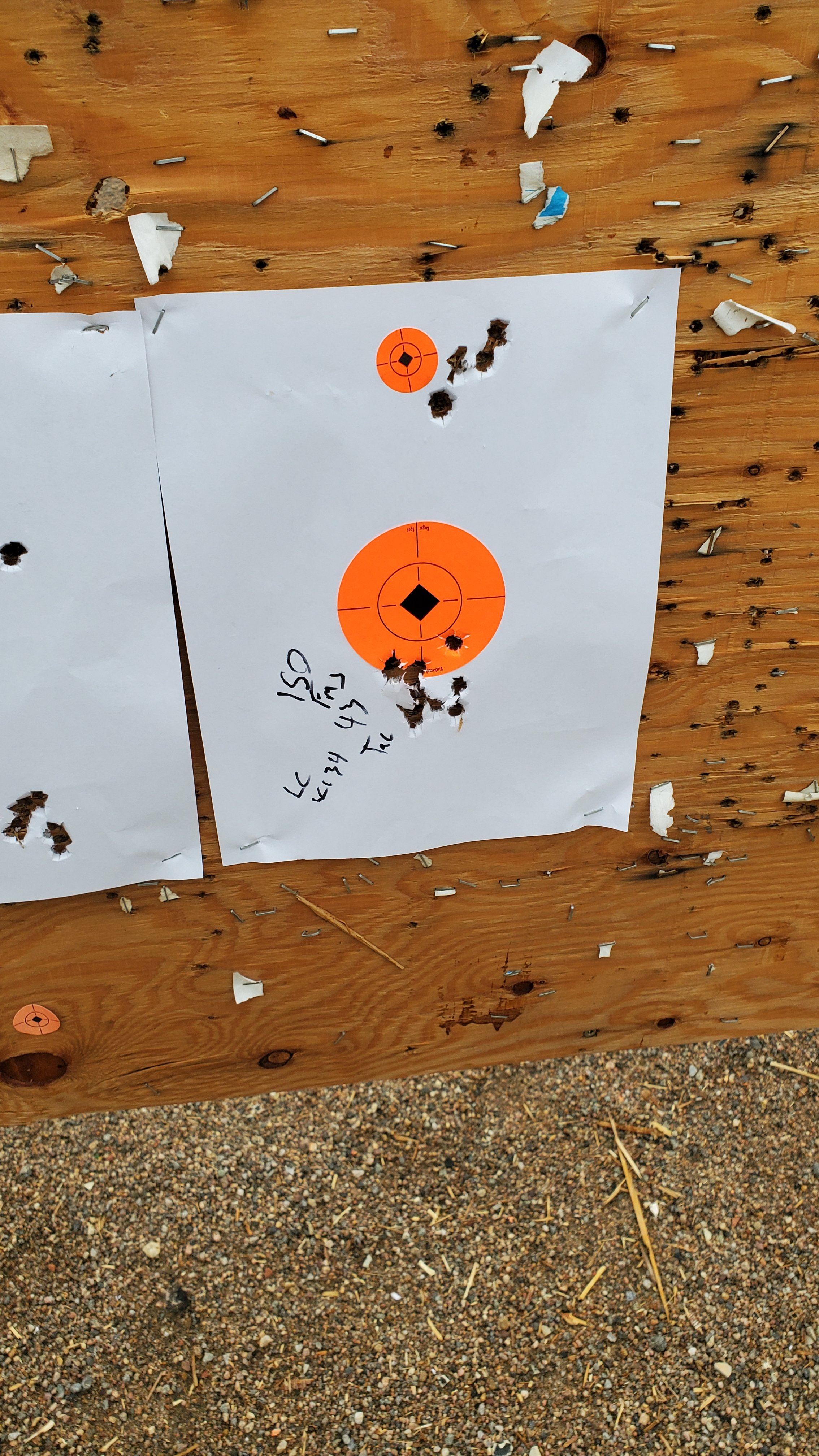

Tac has been working well for me with the 150 Hornady FMJ, for a cheap blaster load. 10 rounds into a solid 2 MOA out an AR 10. Still I want to try BLC2, I want to see just how tight I can get these 150s to shoot (mostly just like tinkering with loads).
Bottom group is 43gr of Tac under 150 FMJ, LC match brass and CCI 34s

Sierra 169SMK
CCI 34 primers
PMC Bronze cases
IMR 4064, 43 grains
COAL 2.820 with an ogive of 2.151
2526 on average out of a 16.5" barrel, suppressed. SD's are usually single digit but for the group below it was 14 with an ES of 41 which is also higher than normal. Hot day though and may have let that last one sit in the hot chamber too long. Cold barrel, 10 shot group. It's more accurate with PMC Bronze than it is with same head stamp LC brass.
