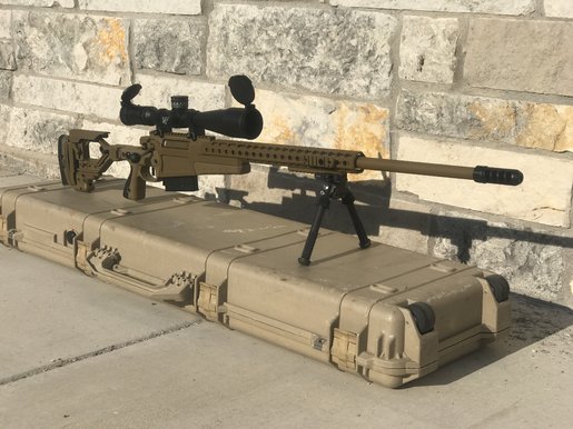

Mullerworks barrel aiax chassis badger m2013 trigger tech. Laser
