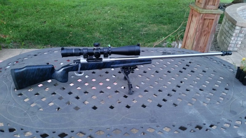

I went with a 30" McGowan Remage barrel in Sendero contour. Built it completely myself, 12.6lbs without bipod. Shoots. 3moa or better. Placed third in a 2000 yard competition against heavier and more expensive guns.

I shot 55 rounds in <4 hours in competition with my 12.6lb 338 Edge. Enough that the barrel never got to cool. The barrel wears a Heathen brake, which is excellent for reducing recoil to manageable levels while providing the shooter and spotter more protection than most brakes. But it does not reduce recoil to the level of an APA Fat Bastard. Wearing a T-shirt, I did have a black and blue shoulder my midway through the day. With a coat or a proper shoulder-mounter recoil pad, I would have had no issue shooting the rifle so much.

It does bear repeating that this was a lightweight 338 built for wilderness hunting, shot in a high volume match...and placed me on the podium regardless. A Fat Bastard brake and/or any type of recoil mad would have mitigated the issue. If it were not 80F any type of coat typically worn during hunting, I could have shot this all day.
