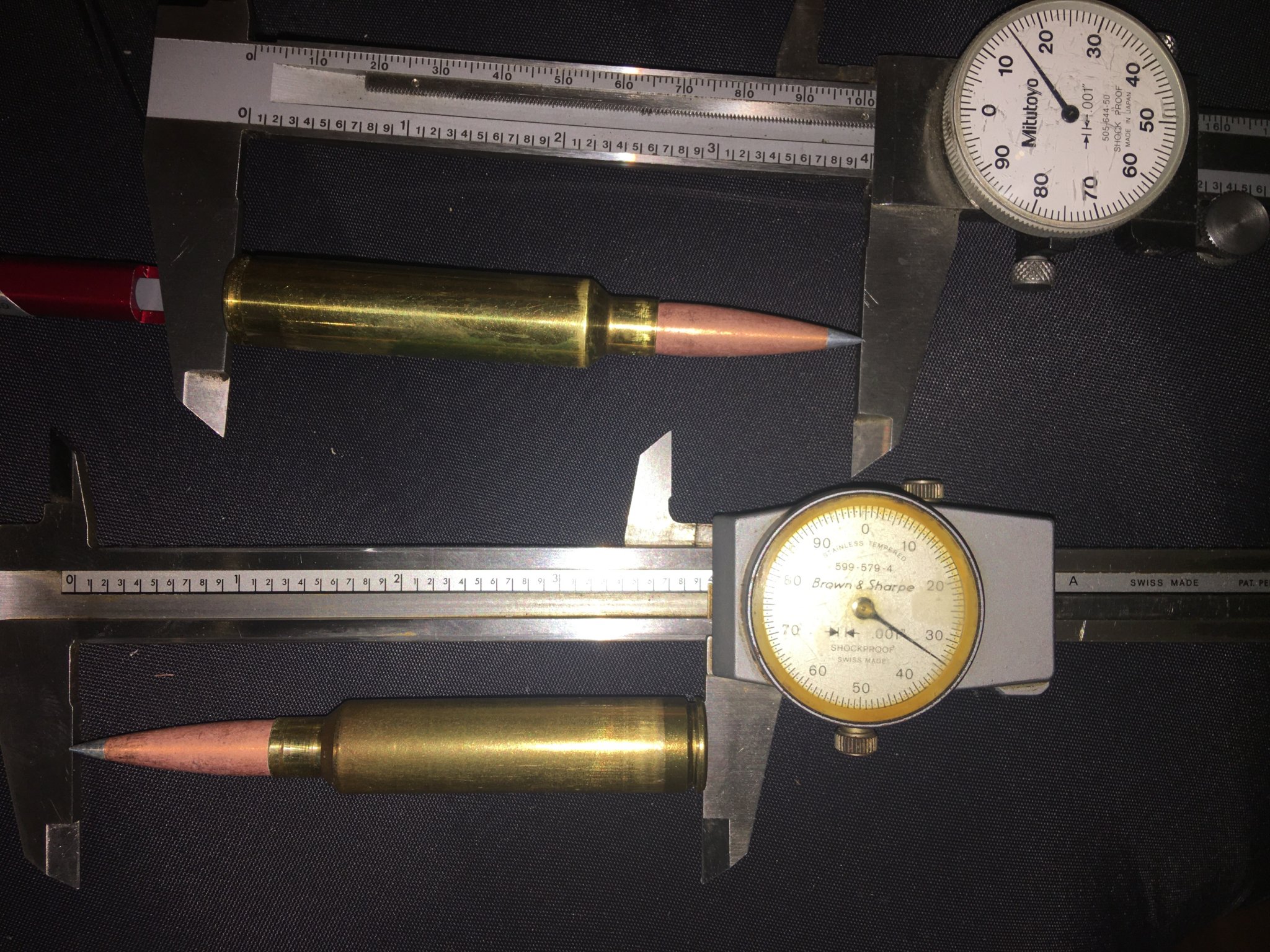

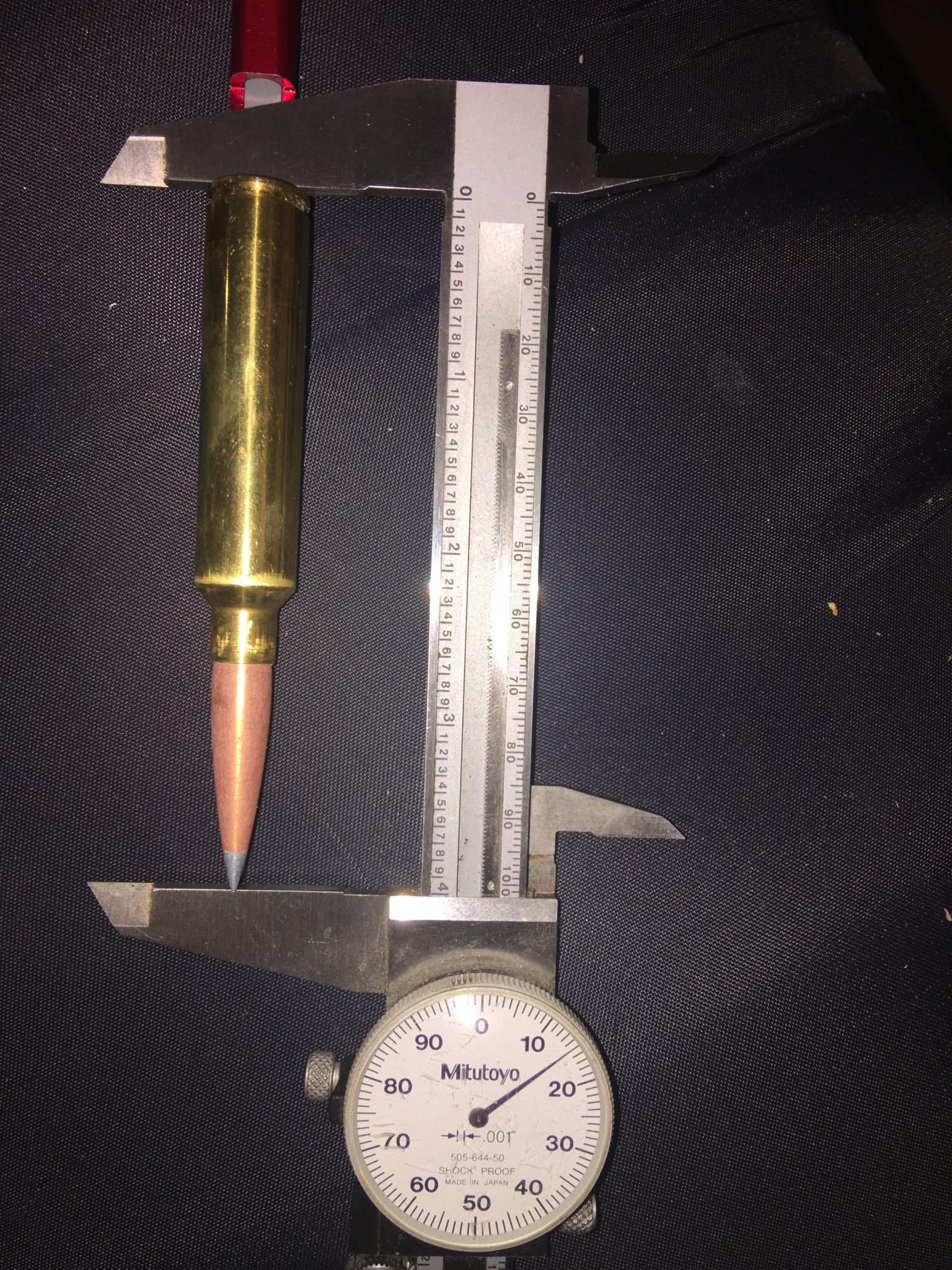

WOW 118 gr RL-33? With what bullet and COAL?

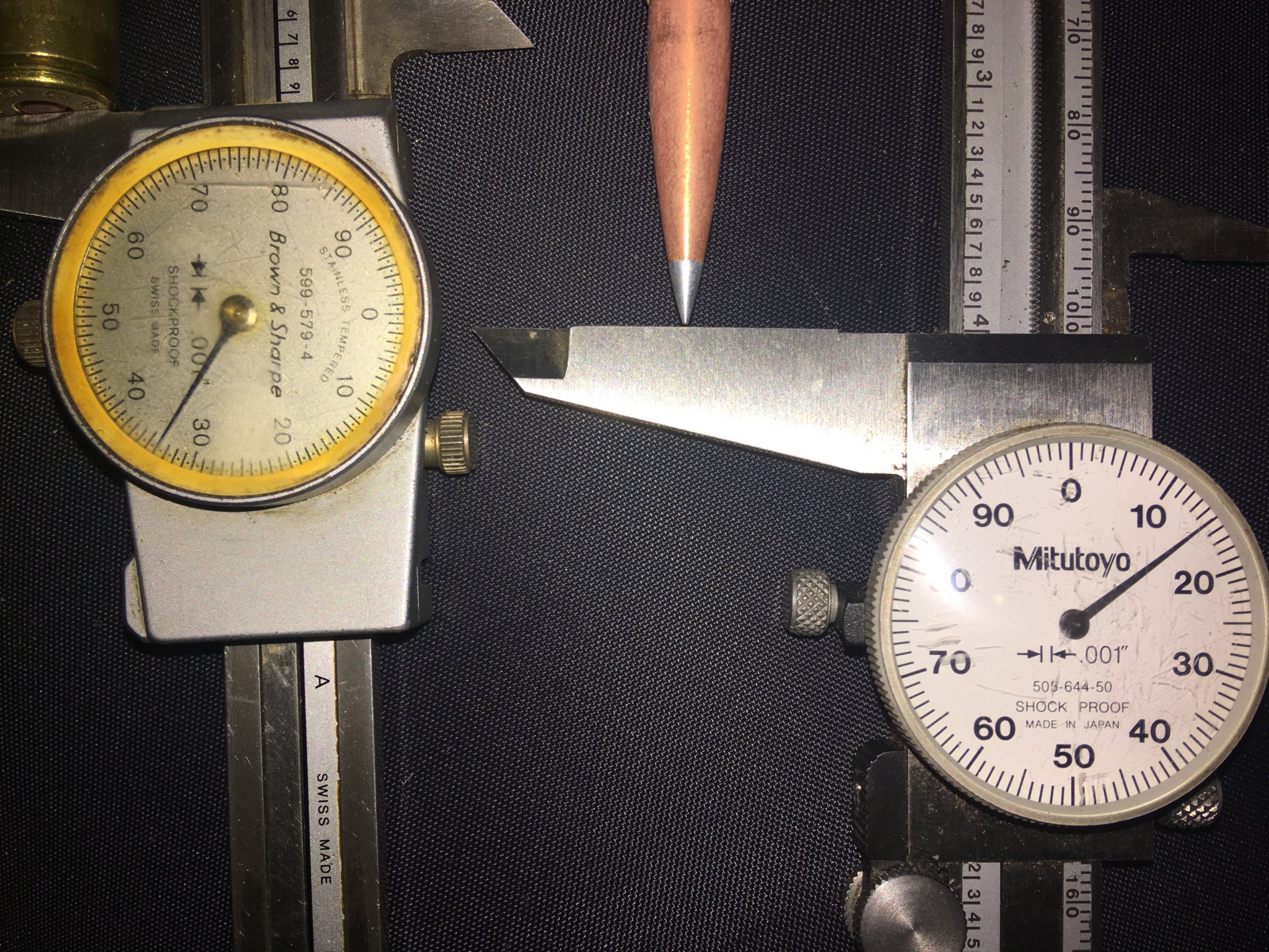

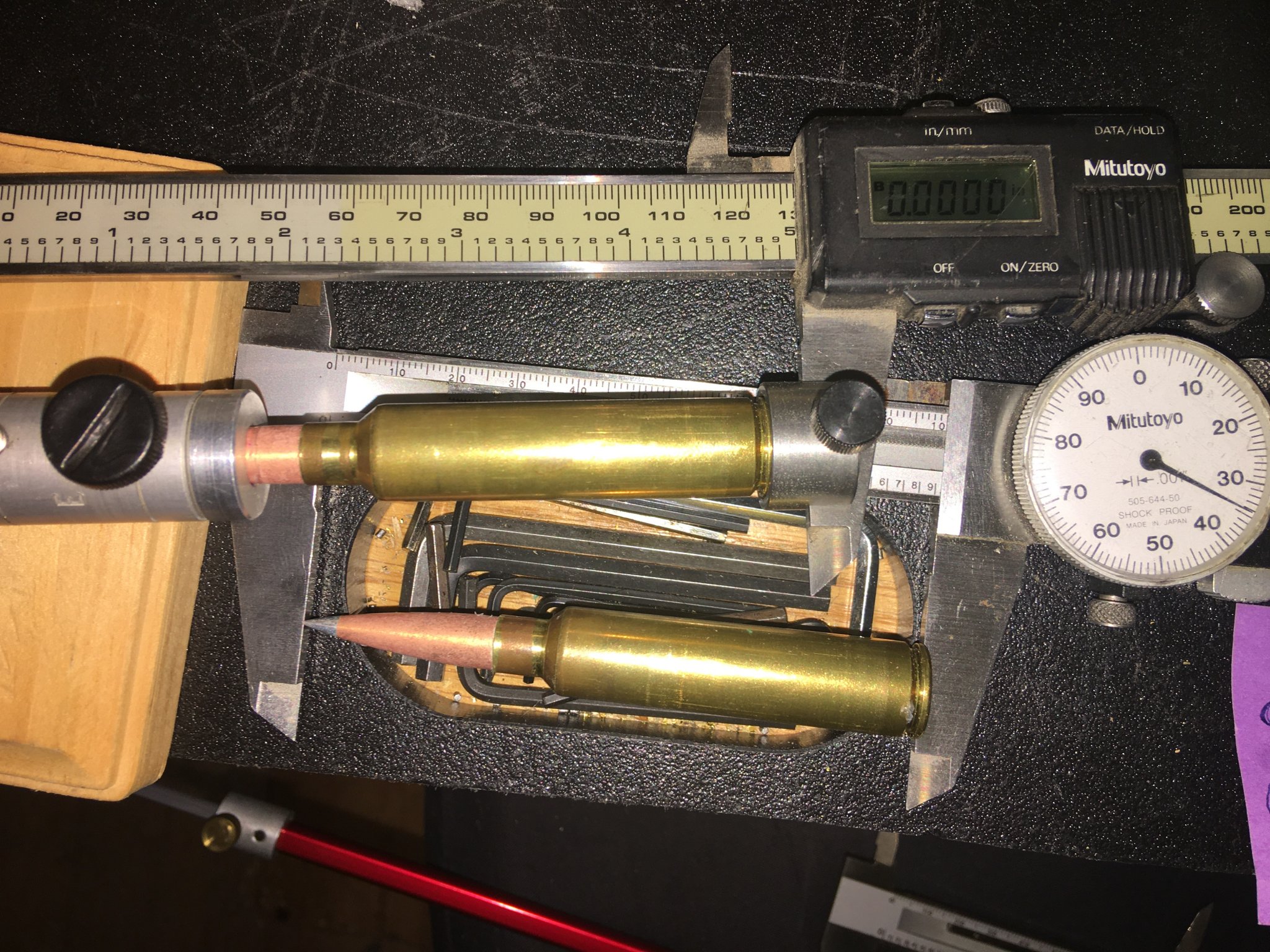

See post #41; note that those fired were 256 Flatlines. Also, that these were seated on the lands. I don't use COAL, but once in a while I'll check and usually early on in load development for each change... If I remember right these were either 4.010 or maybe the full 4.015 which is the Stoney Point (now Hornady) gauge measure of my maximum chambered base to tip (COAL, using 270 gn Badlands Super Dozers). One must remember that this measurement is derived from bare-jawed calipers. Using the standard caliper anvil (s) adds a negative factor if using dial calipers; using digital I use the CBTO as zero which obviates the need to offset. Another item not-to-be-forgotten is dimensional change occurs when changing any external component, ie; brass and/or bullet. Such influence can confuse, confound, and make complex what isn't. I think a good example is to first measure (using the Stoney) in the conventional manner. Then put the bullet in backwards. This is extreme of course, but it does show the importance of YOU measuring what YOU use regardless of what someone else measures. I've given myself a headache and successfully confused myself. Here follows some photos illustrating what I'm trying to say:

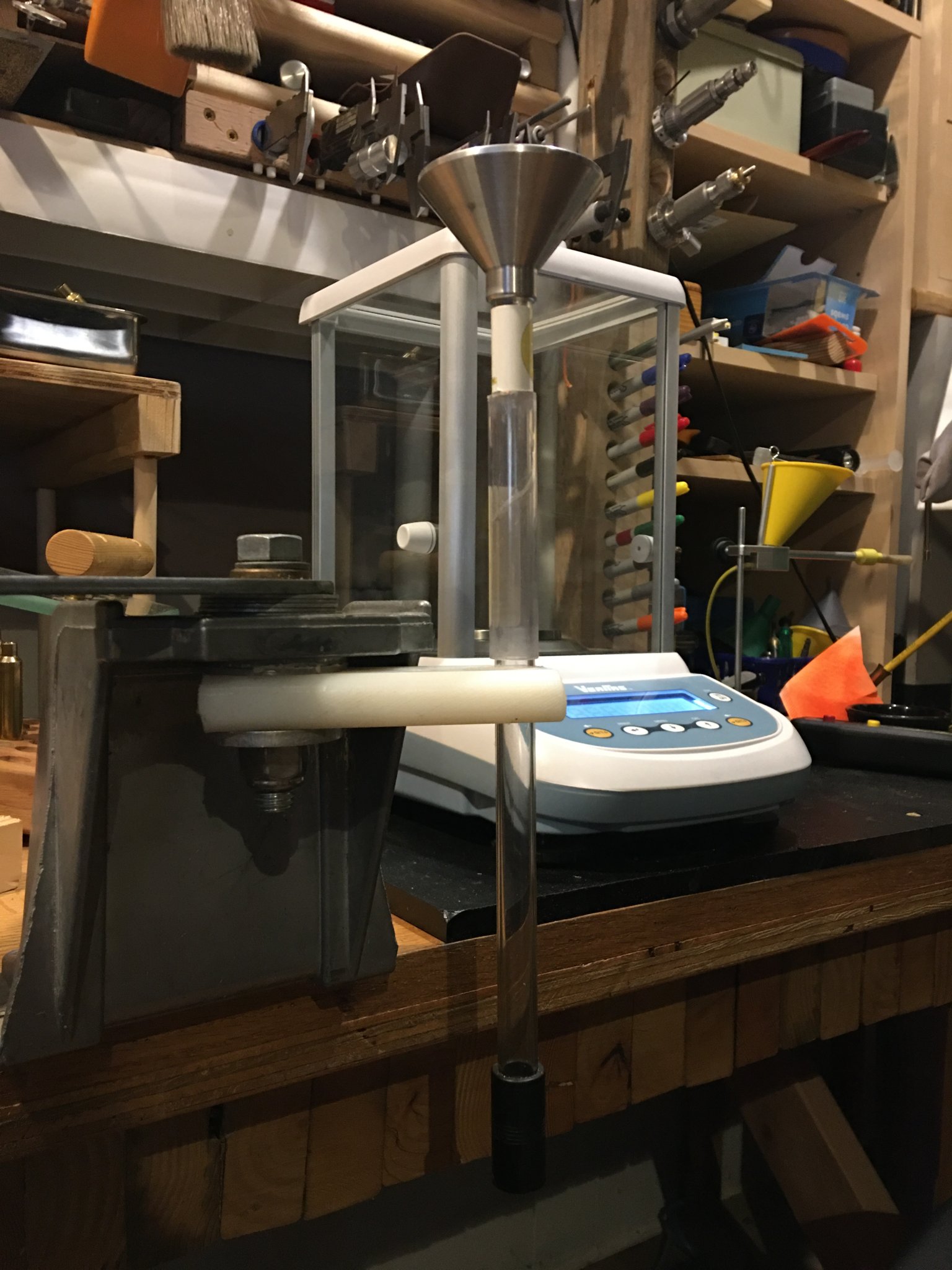

You are correct 118 of RL-33 fits in the case no problem. Using a 6 inch drop tube it settles at shoulder/neck junction. I think loaded long the boat tail will still be compressed. I need to set up a barrel for the Warner Flatlines and give it a try (work up a load) on a Surgeon XL.
Geez; should have mentioned that I use a 10" drop tube from 21st C.

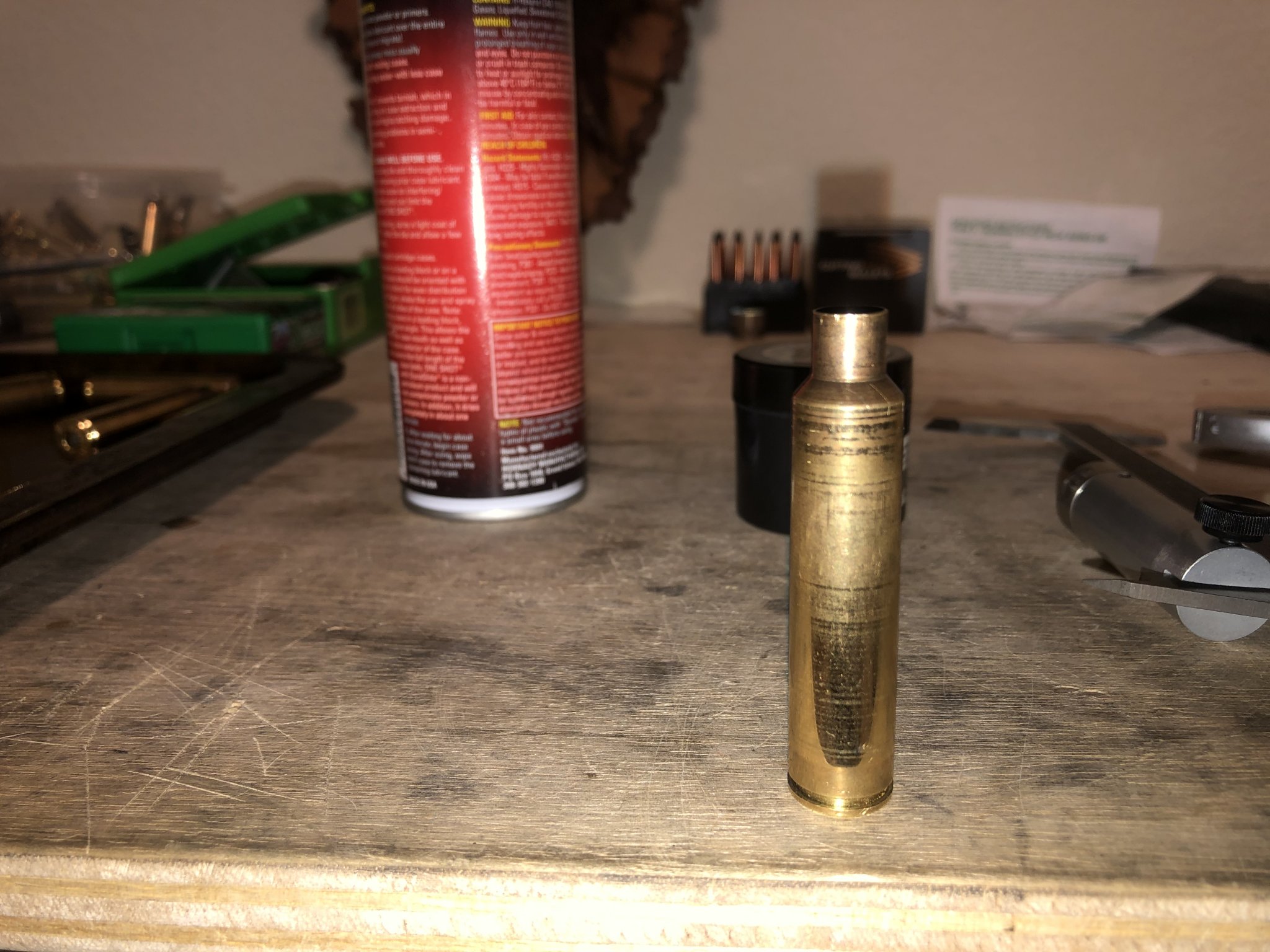

Help. As you saw in previous posts, I have a 338 AI with 40 degree shoulder. After 1 firing in a fireformed case, when seating the bullet it will collapse the shoulder. Both cutting edge and sierra bullets. If I use dry lube on the bullet before seating, it will still collapse but not as bad. I have .364 neck busing, which isn't too tight, I can pull the bullet with pliers fairly easy. Shall I go up to a .365 or .366 neck busing? What else am I missing? I could try to lube the neck with hornady spray and lube the bullet with dry case lube??
Lapua brass? Im using a .365 bushing. Chamfering? I starting using a Sinclair VLD chamfer tool. Are you wet tumbling and getting the brass to clean?
Lapua brass, no tumbling yet was going to wait after 2 to 3 firings when I start doing load development. In fact I never even brushed the neck out after the first firing just wipe off the brass by hand and then size the neck, prime, and then charge with powder
I haven't chamfered as well. I think you just answered my problem. That’s what I forgot. The brass that was not buckling was the first batch that I chamfered before I fire formed. I forgot to chamfer the second batch of only 10 rounds.
I thought something was different about the way the mouths looked…

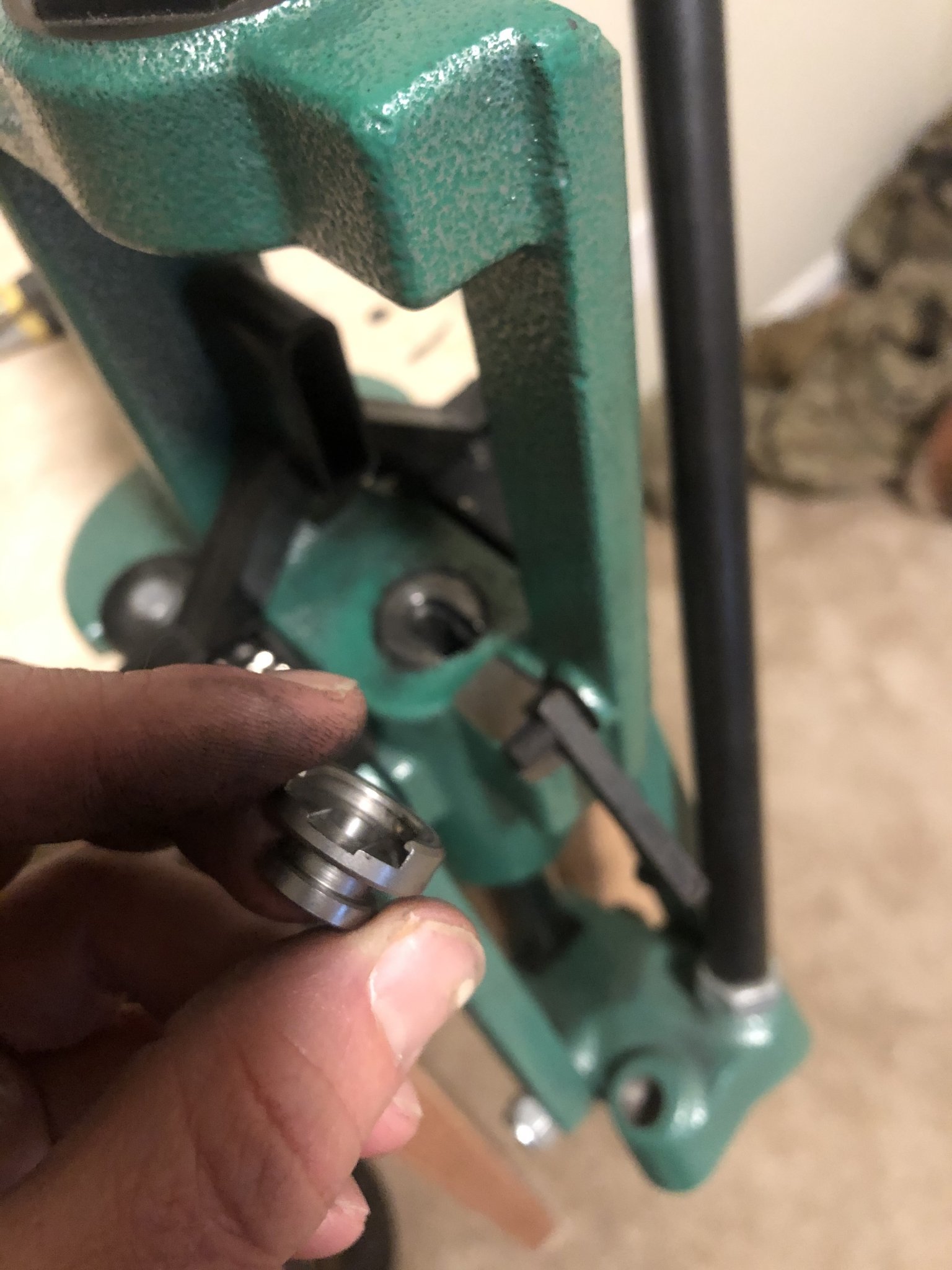

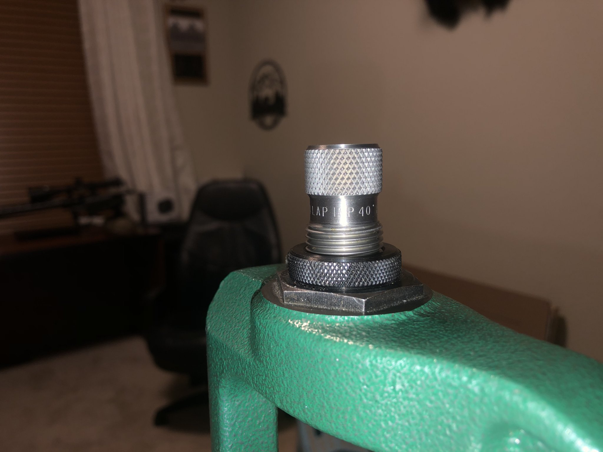

My issue is the body die doesn’t bump the shoulder back no matter how deep I screw it in. Even if I screw it in where I can’t push the handle of the rock chuck all the way through its full cycle. These are not custom dies but The guys in the custom shop at Reading looked at my reamer print and said these version one dies should work for my 40° shoulder angle based off the print dimension. I got a few weeks before I leave on a bear hunt so this is getting down to the wire. Anyone have any input?

Try taking a shell holder, measure the thickness of it with a caliper, then clamp it in a vise and file 10 thou off of it and try sizing the case(s) again. If that doesn't work, try taking some more off the shell holder. Generally they are cheaper (and not hardened) so they are easier to mess with than the die itself for a quick fix.

You mean just file the top of the shell holder that goes in the press so it’s basically creating more room to push the brass up higher?

Yup. I've had one or two sets of dies over the years that either I couldn't get the dang things to size for nothing, or they actually made the headspace *longer* (squeezed in at the shoulder, but didn't bump the shoulder back). One option is to have someone with a lathe take a bit (10-20 thou) off the bottom of the die; the other is take a little off the shell holder first to see if that really is the problem. Shell holders are way cheaper and easier to replace ;) The trick is to take it off evenly.
But if'n it were me, I'd have a spare shell holder handy, or at least on order, just in case things don't work as planned. But that's just me... ;)

Well took too much off the holder and the edge holding the case broke off leaving the case in the die, it was easy to remove. But I found another shell holder luckily. I'm thinking of finding a machine shop that will remove 20 thou off the die before screwing this shell holder up.
Do you think removing 30 thou off the bottom of the die is too much? I don't want to pay a machine shop 80$ an hour and then have 10-20 not be enough? I guess my question is does a body die resize all the way down to the bottom of it's mouth? Would I not be resizing the brass all the way if I removed 30 thou?

Yikes. How much did you take that shell holder down? I realize that with the .588 case head, there isn't a whole lot of 'meat' to the rim of the shell holder, but seems like you musta got a little wild to get it to break off?
30 thou seems like a lot, but if there isn't enough meat to the shell holder to take material off without weakening that... dunno.
Typically, most sizing dies (F/L or body) size down to within a short distance above the extractor groove on the case. The die body usually has a little bit of a chamfer or radius on the inside edge to allow for ease of getting the case into the die if things happen to be not quite lined up when you raise the ram - i.e. so the case will be guided into the die, rather than jam up on the mouth of the die.
So effectively, that's why some dies don't always size all the way down the case head as far as we might like, and why you see people resorting to things like small base dies (that squeeze in a little tighter, a little further down) or 'ring' dies (specialty dies that size *only* that area of the case) with zero radius on the entry so they can size almost all the way to the extractor groove. That's more of a situation where the shoulder has been bumped an adequate (or more than adequate) amount, but the case still won't chamber freely due to a mis-match in the fired dimension of the case web vs. the die - most common, in my experience, when 'recycling' brass from one chamber to another in the same cartridge. One chamber might have a 'fat butt' compared to the other, and until the web gets squeezed back into place, the old brass won't play nice in the new chamber.
That 20-30 thou you want to take off the base of the die would probably just be taking from the radiused region at the mouth, which doesn't actually size the case anyway... so in *theory*, it shouldn't hurt anything. I just hate permanently modifying dies, particularly ones that aren't exactly off-the-shelf commodity items (.338LM AI, vs. say, .308 Winchester).
You might want to call the die manufacturer on Monday morning and talk to their tech support as well.

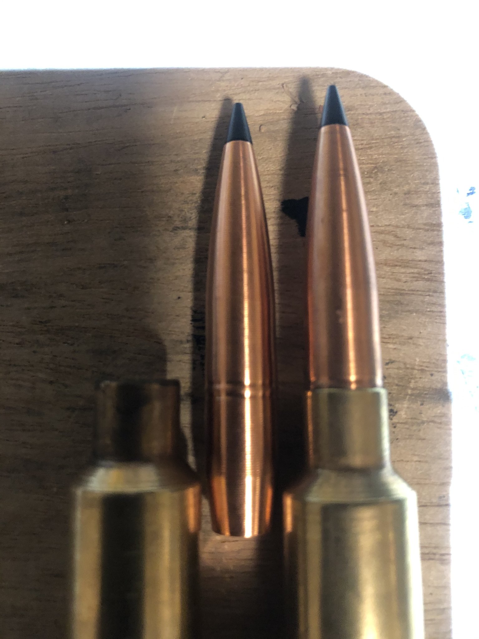

On another note. During low development I am seeing pressure signs (heavy boatlift and light extractor marks) with 107g of RL 33. I’m shooting 275 grain cutting edge lasers. Again this is with a 40° shoulder, bore Ryder through, and a 26 inch barrel. I figured I wouldn’t see you see pressure signs with a 275 grain bullet on that low of a charge. I could see running into this issue with 300g bullet possibly.
I’ve loaded the bullet out as long as I could which was into the lands about 10 thou as well as off of the lands by 10 thou to test for pressure. Both were still giving me heavy bolt lift/extractor marks.
The only thing I can think of is due to the long copper bullet it has to be down into the powder and I do hear a slight crunch with loading. I did not get a long throat installed in order to load those copper bullets out Long but I didn’t let the owner of Pacific tool engage know the exact bullet I wanted to shoot when he made the reamer for me and he assured me it wouldn’t be an issue playing with the lands but I didn’t think it was going to be an issue of the throat being too short for those bullets.
I also hear that a monolithic bullets don’t conform to the barrel as quick therefore you usually have to except a lower velocities with monolithic bullets
Also when breaking the barrel in I did shoot 108G of RL33 behind 285g ELDM and that gave me heavy boatlift as well but not as heavy as 107 grains behind these monolithic bullets.
Option: Go back to a shorter lead-based bullet like the ELD or a Berger and that will cut down how far the boat tail goes down into the powder. Any suggestions?
For the bullet to be off of the lands I have to load the seal tight band just below the mouth as if it were loaded in the shell on the left.
