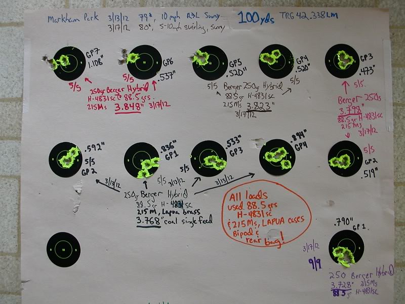

Here's the pre-production testing of the Berger 250 Hybrids I did a couple of years back. Only at 100 yds and I only got to play with seating depth, as I only had 2 weeks to get the write-up back in, but there you go:
Chris

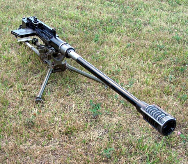

I use it to load 20mm for the Solothurn anti-tank gun as well so the 338LM is a tiny round.
A SOLOTHURN!!!! REALLY???? You, Sir, are an ass. I now utterly hate and despise you, Just Sayin'...;) (Sarc off). Additionally, any reference to a Solothurn S-18/1000 is useless, and frankly mean, without pics and/or videos on anything that relates to that magnificent piece of 1930's technology. I have wanted a Solothurn since I was a kid when I used to see the old for sale ads in the old gun rags that my grandfather used to have around the house. But, alas, that was in the '70's and there was just no way to get one. Since then they have been unobtanium for those in my income group. The fact that you have one and are still able to keep it shooting is amazing. I do hereby humbly bow down to you for you are a god.
A little overdone but always nice to see someone who knows what the Solo is and appreciates it. Very neat guns. Here are a couple pics. I'm an old codger and don't post video....hard enough to up and download

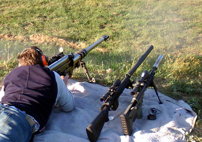

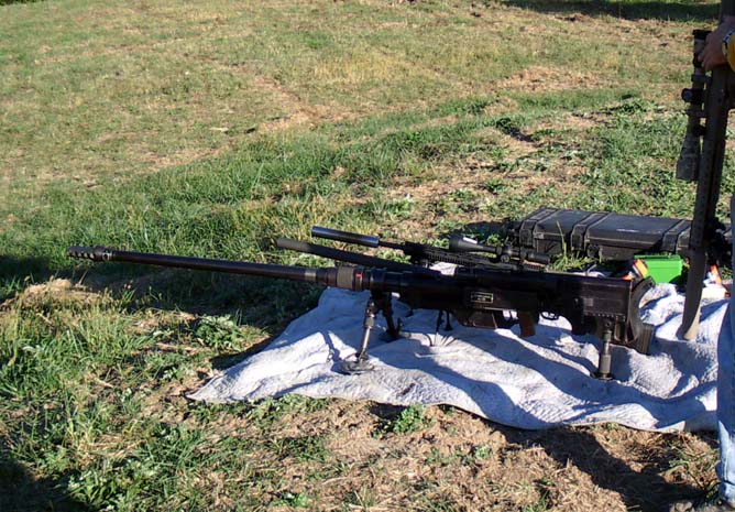

pics with my crappy internet connection. The pics of the Solo also have my DTA SRS (now covert) as well. We had some Swiss friends visiting and they wanted to shoot the Solo. They'd never seen one in the Homeland despite living about 50 miles from the factory. They like the SRS as well.
The oddball in the pics is a little larger bore...24mm and was built a few miles from the plant in Solothurn where the S18-1000 was built. Its a TB41 anti-tank gun sitting on the tripod for the Swiss MG11 watercooled maxim. They were built at WaffenFabrik Bern and had their own wheeled mount that had no elevation or traverse gear....free swing. The wheels come off and the legs flip over to make a tripod. They also fired the guns laying on the ground with no mount at all. I never fired one but I've heard they have very low recoil. Probably due to the weight and the huge muzzle brake.
We are going to test fire it next week I hope. Ammo is tough to find but cases can be loaded once you have them.
Frank

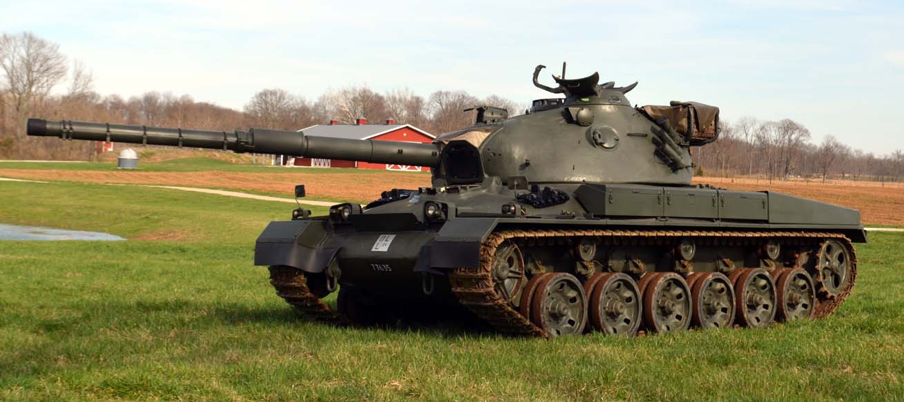

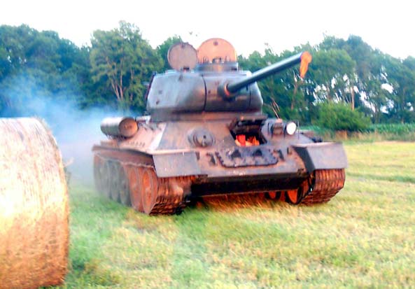

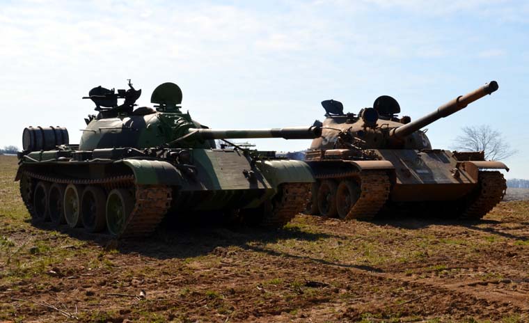

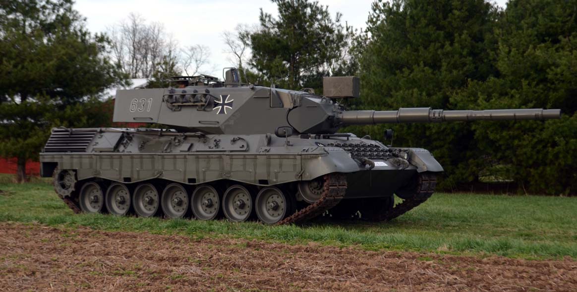

Pics are the Leopard 1, the T34-85 running, T54 and T62, and last but not least the Pz61. Did you know the Swiss built their own tanks? Did you know they even have an army? The tank is really cool, has a steering wheel and formula 1 paddle shifter, 6 speed gearbox and a mercedes 630HP V8. What a joy to drive.
Sorry to run off the thread....had to put em up there. Had some family from Switzerland too and I really like the Swiss guns. The solo and the TB41 are really cool too.
Frank
