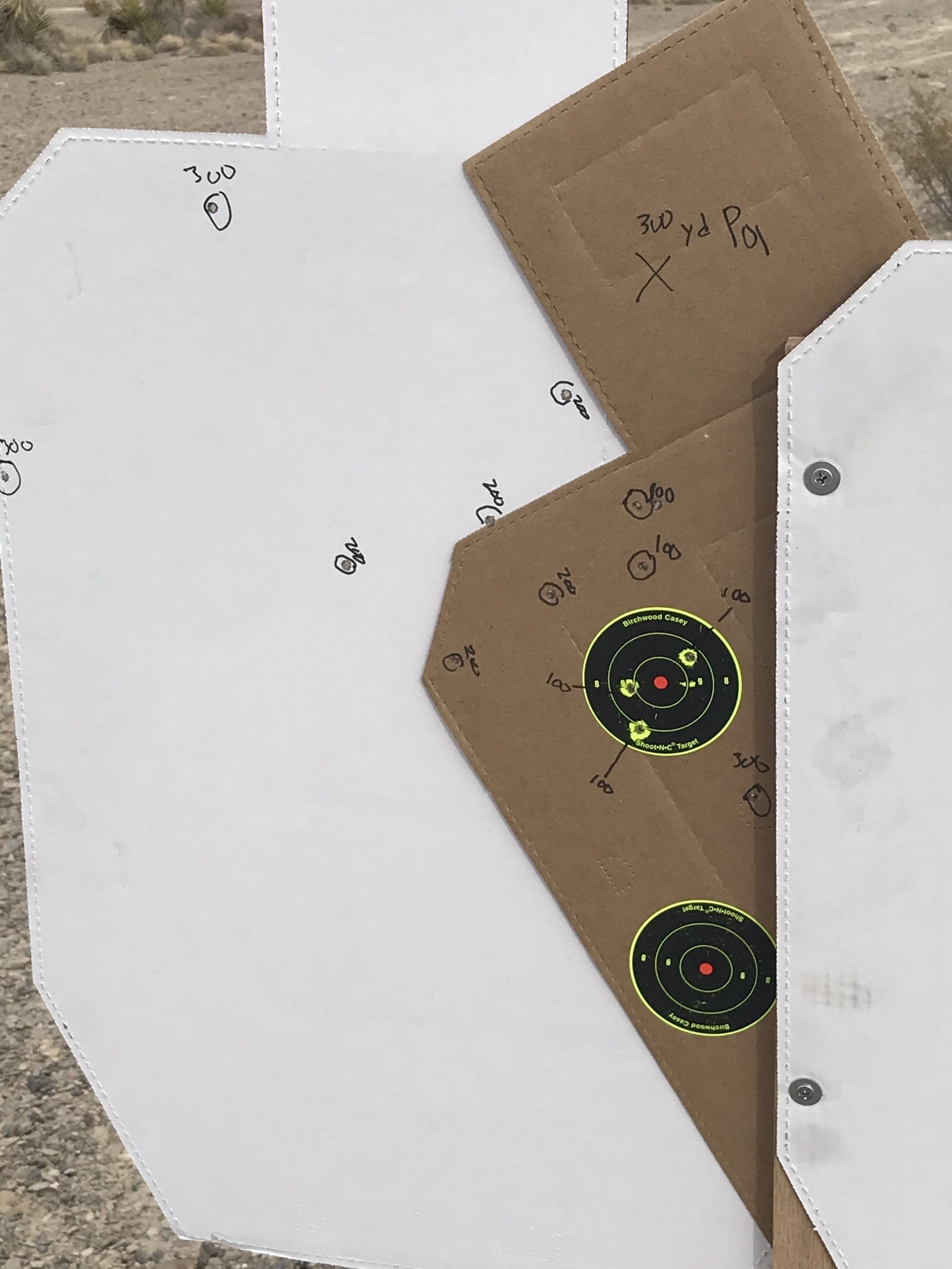

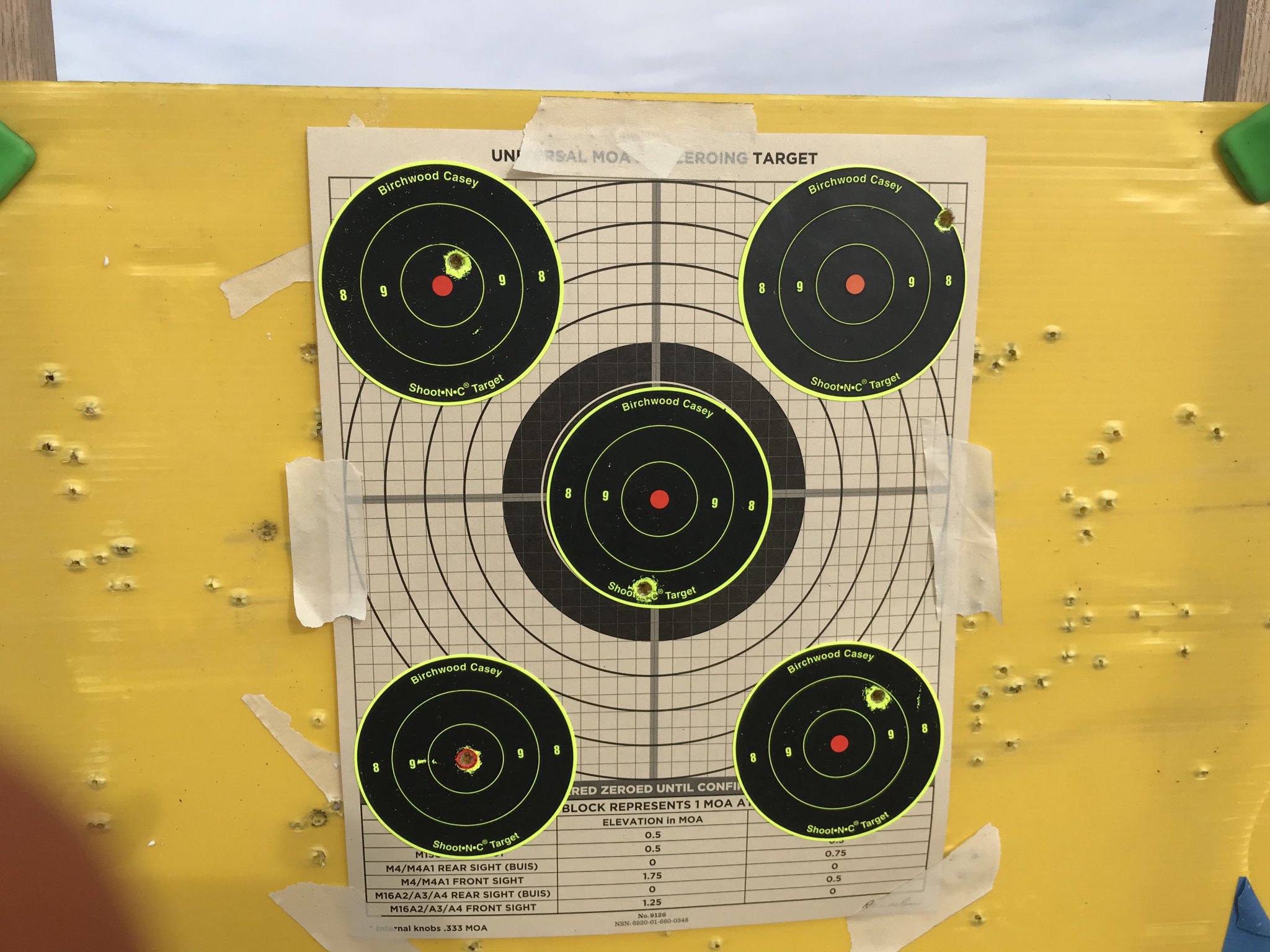

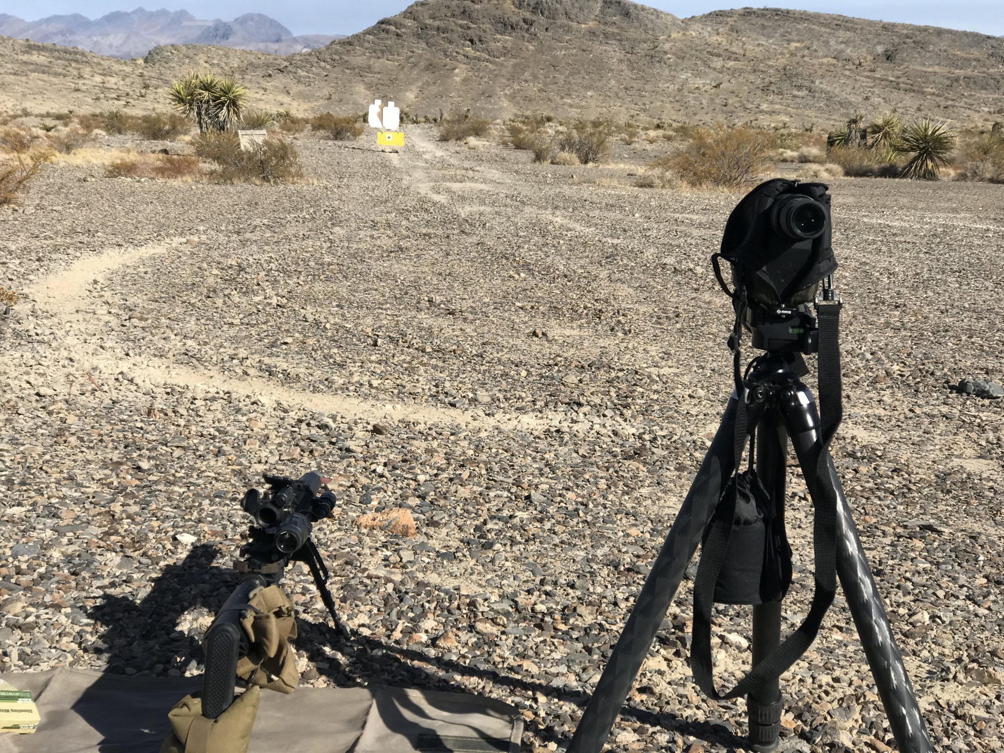

Did the experiment (well only half of it) using a 50-yard zero. Rifle was my 14.5 DD with CompM2. I didn’t use the magnifier. All shots were made prone using a bipod and rear bag. Ammo was IMI XM193 55g fmj. Temp was 45 degrees, wind was right to left by 2-4mph.
I confirmed zero then performed a dot drill at 50 yards. Afterwards I moved the target to 100, 200 and 300 yards shooting five rounds at each distance at the partially hidden silhouette (brown target)
I circled and labeled the rounds shot at each distance interval before moving to the next (one shot at 300 went high-left over the whole assembly.
Observations:
Basically, my fundamentals need work. Beyond that I can see the merit of a 50 yard zero if we assume typical Max engagement range is ~225 or so. POI was only slightly above POA (top shoot and see) At 300 yards, I held at the “head” of the brown silhouette; rounds went all over the place.
At 100 yards, my POA was the lower shoot and see and POI was the upper shoot and see; dispersion was within expectations. At 200, I need to bring it down a bit (maybe hold so the top of the dot is “touching” the target as it it was a chevron or German post reticle.
I’ll keep the zero at 50 for now while I work on fundamentals and hold overs then re-do using a 36 yard zero to see what differences are apparent. Will also shoot from different, more typical positions as opposed to prone using a bipod once I’m a bit more consistent.
Note: where it says “300yd POI”, I meant to write “300yd POA”
Feel free to ask questions.
