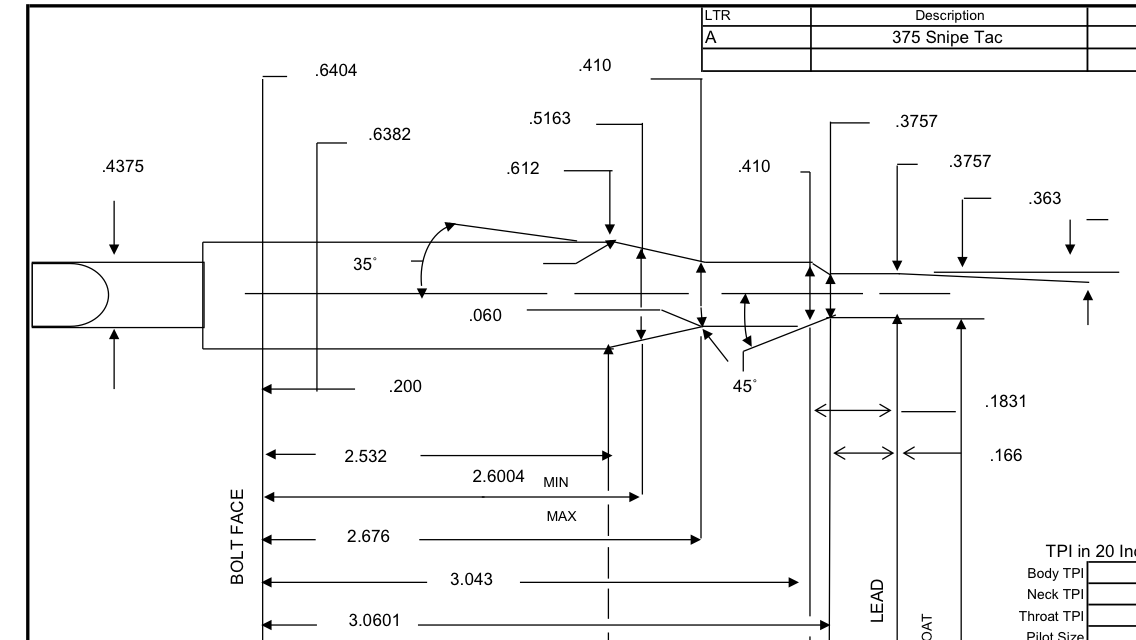

I’m running ing the same rig. I use the go-gauge to set back the shoulder. I use a shoulder datum reference attached to a caliper. Measuring the case length only tells you when to trim the cases. Maybe these photos will help
View attachment 7156867View attachment 7156868
This certainly helps! I have a call into PT&G to get the "GO" gauge so I can do exactly what you're doing here. One question for you though and this is very similar to what the reamer specs out to for my chamber, what would you trim your cases to? I'm thinking 3.030" to allow 0.010" of clearance. Thanks!
My trim to case length is 3.030”. That gives 13 thousandths of clearance in my chamber. I use a Giraud trimmer as part of my brass prep. The 35deg shoulder doesn’t have much case growth.
