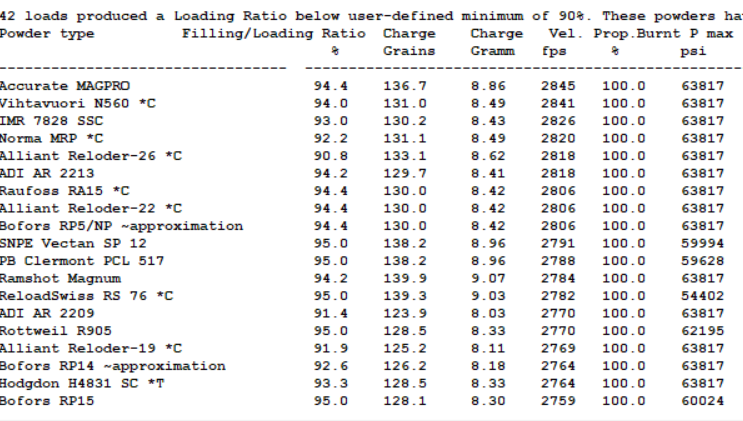

Quickload suggests a bunch of powders in that range...
You might also try N565, which is fairly new and not as popular as N560 & N570 yet. A cursory look at the predictions say you could get similar 2800fps-ish performance with that bullet in a 28" barrel.
Wow, never heard of Quickload. Many thanks for that info. I have some of these powders already. Would be nice to find alternatives for sure. Many many thanks!!
