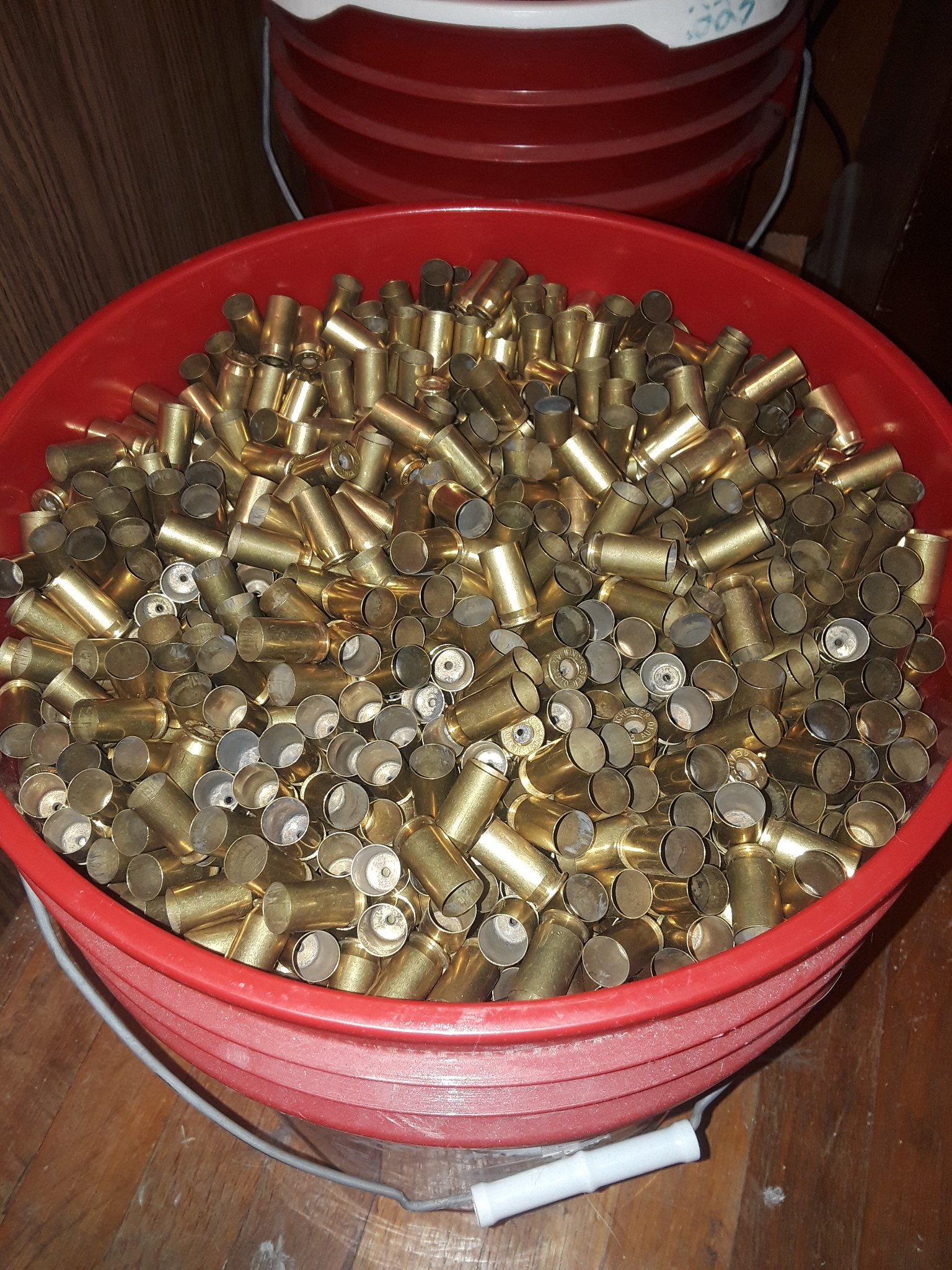

    So I reload for several rifle calibers and 9mm, 38 ,
    Have a good supply of 45 acp brass and figure time to do it.

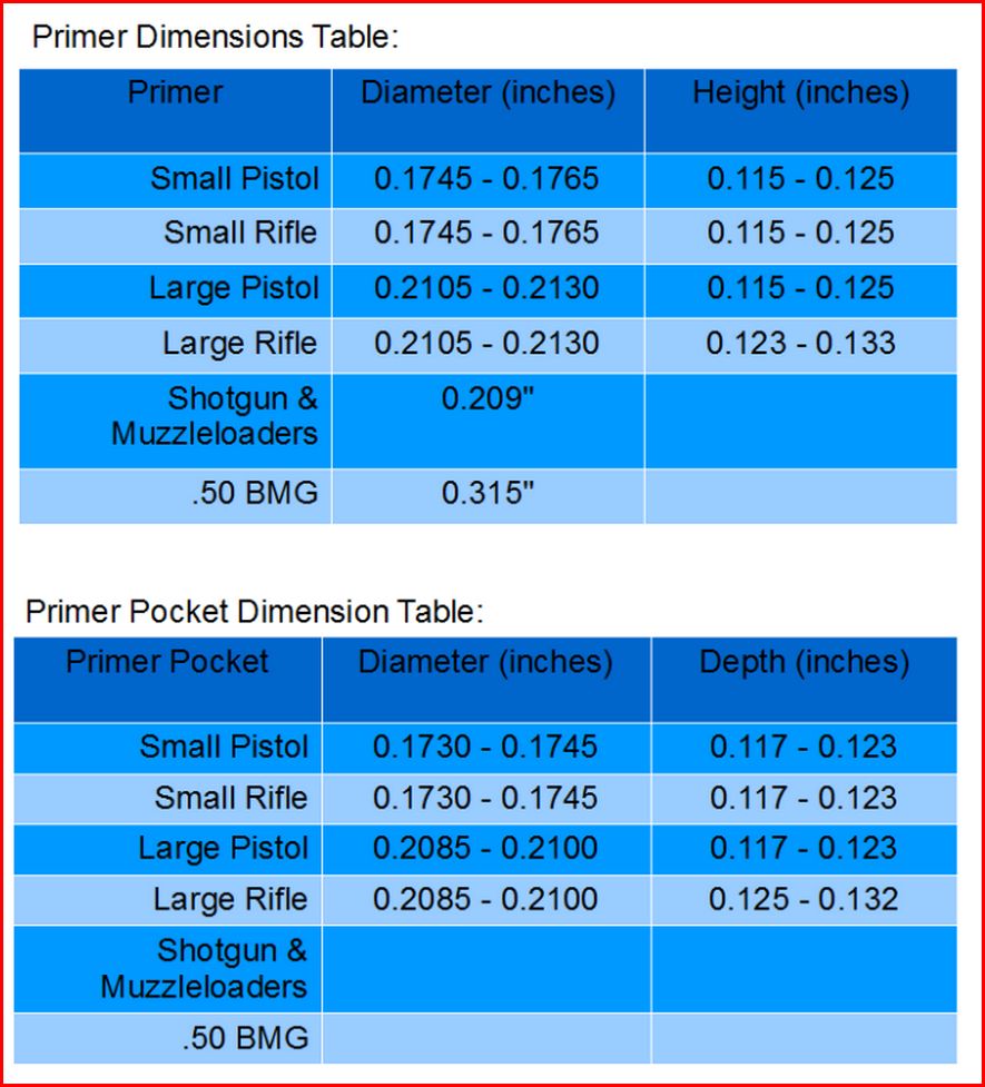

    Sorted out couple hundred large primer hulls and checked them with primer pocket gauge. Fail
    No problem ream and uniform. Oops, did not realise large pistol primer pockets were 0.008 thousands shorter.
    Brass was cleaned, deprimed, reamed and uniformed with large rifle uniformer. Then tumbled with wax.
    No large pistol primers available at the moment anyway.
    Can I use large rifle primers and reduce my powder by (x ?) Ammount? Was just wanting poofers for targets. 230g rn copper plated @ 700-750 ish.
    Or is this a 300 round brass fatality?

    Large rifle primers have more height and thicker cup material. No idea how they differ in power, but it might or might not be significant. If you are feeling lucky, you might get away with it. Sounds to me like you just ruined a bunch of perfectly good brass.

    Small rifle primers in small pistol brass is fine, if the load matches and the gun will ignite them. External dimensions of these primers are identical.
    Large rifle primers in pistol brass is not fine; large rifle are taller than large pistol and they will stand proud of the case head. Slam fires are possible, it happened to me once when I was younger and dumber and had read some of the online bs about using them for hotter loads. Be warned, the dimensions are NOT the same.
    However if you’ve reamed out the primer pockets on that 300 pieces deep enough to fit large rifle primers (i.e. screwed them up for using large pistol any more), and the gun will ignite them, then yes you can work up a load for them.

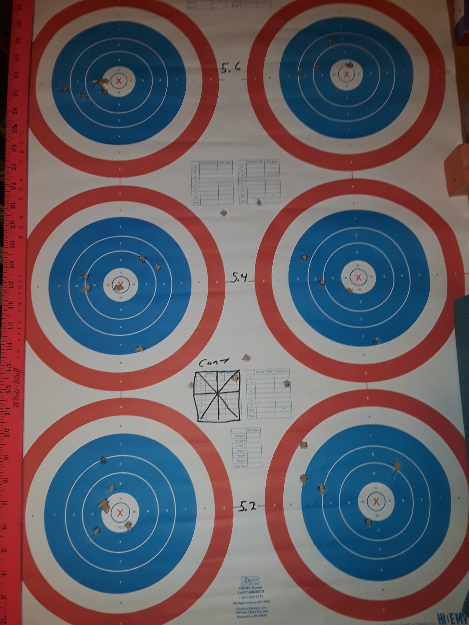

    Well I forgot to update this thread.
    The rifle primer substitution in 45 acp worked. Both large and small fired no harm no foul.
    The large rifle primers gave poor accuracy with same powder load as small.
    The small rifle primer 45 gave decent accuracy and I am adjusting the load down to see if accuracy gets better.
    The rounds on the right are lrp and same charge weight on each. First time shooting this 45 and a poor showing for me.
    The srp were more accurate
    Reactions: r.tenorio671

    with a pistol, are you sure its the primer causing the accuracy change?
    Unless you are shooting from a pistol rig, thats a tough call to make
    Yes.
    It's a small sample size and not good shooting on my part but I did this as proof of concept on the lrp in 45 brass being usable at all.
    Test worked and could be used in an emergency but side by side testing shows poorer performance with the lrp's.
    Your welcome to test and publish your own results. All you need is a LRP uniformer and patience.

    Your first sentence says the second sentence is meaningless. At least if you understand anything about testing, sample sizes, and statistics.
    I wasnt going to say it. Shooting pistol groups for accuracy, to find the right accuracy load, requires the pistol to be in a jig, at 25yds preferably. I've been done this road as a USPSA competitive shooter, and a bullseye NRA/CMP shooting. You have to remove your input into the gun to get accurate pistol data. Its not like a rifle, where on a bipod, rear bag, you can almost remove all movement.
    Like I said run your own rifle primer test in 45 acp large vs small and show the results.
    Nobody gives a rats ass of your credentials around here.
    You want to use a rest good the results should be more accurate.
    I don't have to jack with a load forever to see which is better rest or not.
    It's not accuracy data it was a simple primer substitution experiment that evidently is over your head.

    YOU made the comment about poorer performance.. not me...
    There is a photo provided that should be enough for most people as an example.
    You're a waste of bandwidth.
    :rolleyes:
    Your photo and your comments both show that you didn't prove anything. You shot a couple of minute-of-trash-can lid groups with just a few rounds each and think you can conclude accuracy results from that? Get real. You may as well have just saved the ammo and imagined the results, it'd be worth about as much.
    The only one who's having this topic go over their head is you.
