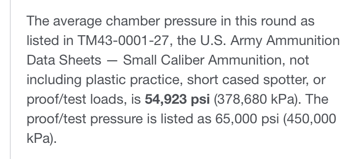

A so-called "160,000 PSI" round should never generate that type of pressure in practice. Once the brass fails, there needs to be a mechanism to vent excess pressure away from the shooter's face. Most conventional rifles do this gracefully (at least relative to the violence of the event) and protect the shooter from harm. Look at all the posts over the years where reloading mistakes have occurred or someone left a cleaning rod in the barrel or whatever; lots of broken parts, but generally only minor injury. Claiming "it's a 50 BMG LOL" doesn't make this design flaw any more excusable.
