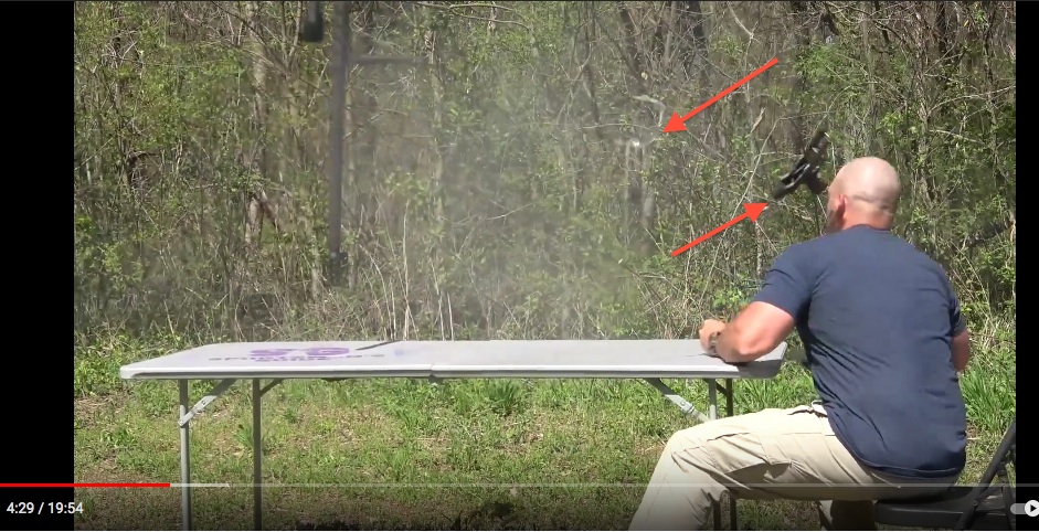

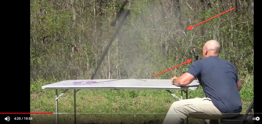

Whils the smaller shrapnel was moving faster ultimately did more damage,
the entire lower receiver also goes flying at his head :(
... near miss

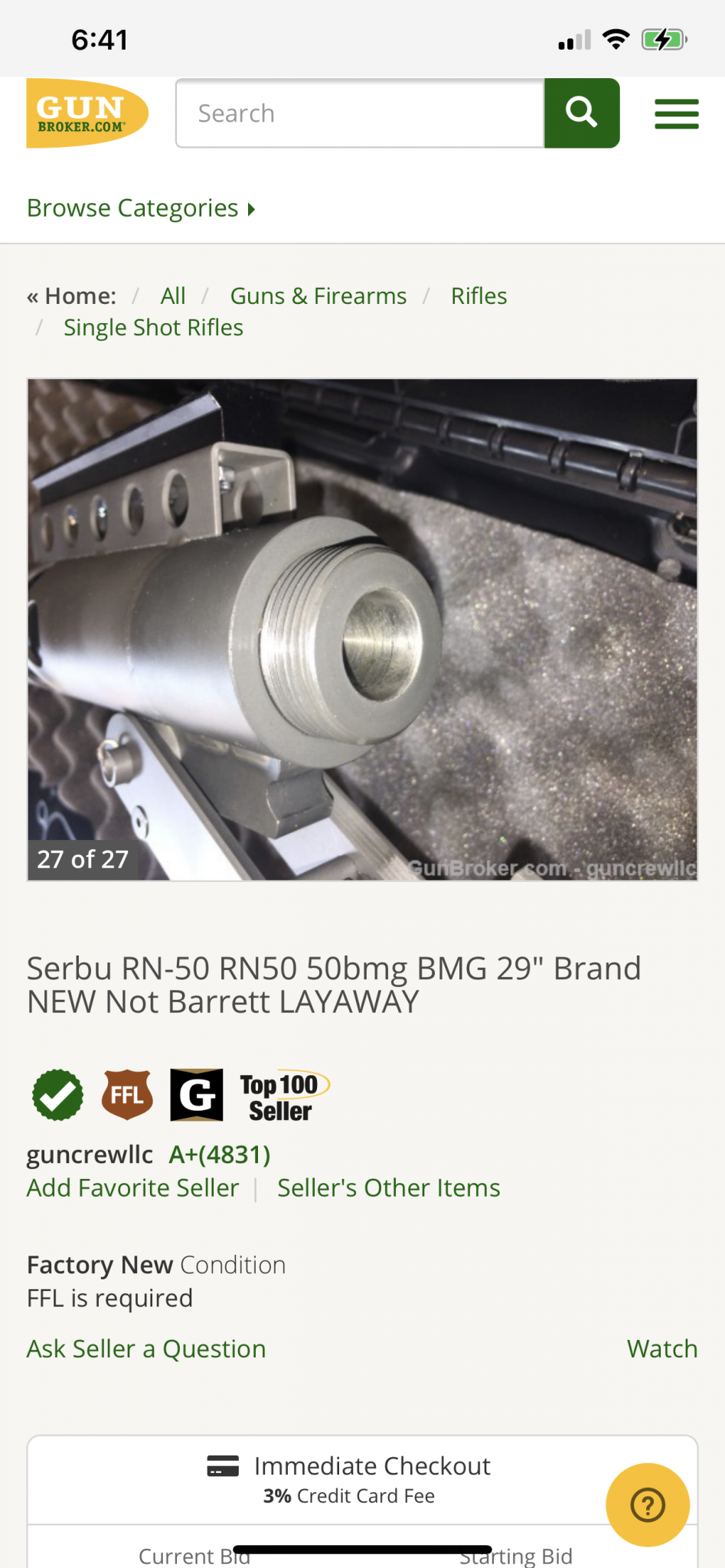

Grabbed this screenshot off gunbroker and it looks like they were designed with more than that. Maybe barrel is gradually loosening in its action/ sleeve?
comments above are spot on on the engineering of this thing. I had never looked at one until this thread. Not in any detail or even reall thought about one. The ar lower thing never seemed like a good idea.
Then adding a SLAP round? Dafaq?
But this thing should be recalled and ground up. Wtf. To paraphrase TheGerman: being poor with a .50 will get you blowed up.

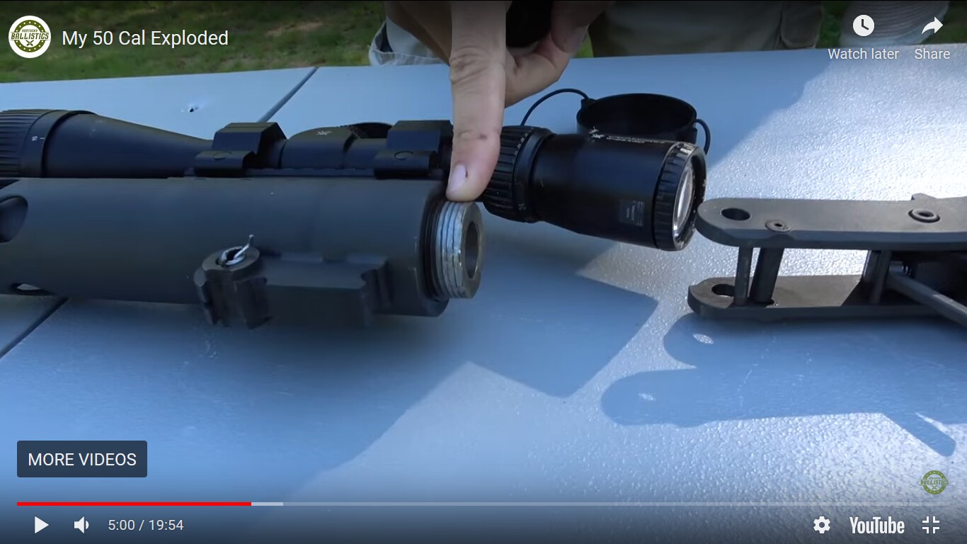

In looking at both threaded portions (blowed up and gunbroker) looks like both have about 6 threads, but in the light hard to tell. Why looks like 4 I think is 5 or 6.
still not enough.
Then you have to take into account the major and minor diameters of the male and female. Were they a perfect lap fit? That will make them incredibly strong.
Were they loosey goosey and they were relying on shoulder contact to be tight? No strength there. did repeated firing stretch the cap? Barrel chamber area expands a tiny bit on firing... and that can, over time, potentially expand the cap beyond its elastic limit enough that it can loosen up.
In the Blowed up picture, the threads do not look healthy. They look worn and rounded. Just from firing that one round? Or was this thing high-mileage and the threads were tired.
Then (again) a SLAP round in a weak, tired, under-designed .50? That it has not happened before is remarkable.

I stopped wasting my time listening when he said he spoke with Mark and they estimated right over 80k cartridge pressures to rip the screw on breech plug....................
That makes me assume a few different things:
1. Serbu does not test each build with certified proof rounds.
2. Serbu does not have dynamic FEA on the design that shows exactly what the pressure would have had to be for the failures.
3. Why does that breech plug rely solely on threads and not any lugs??
4. Unless that is some cheap alloy the pressures were significantly higher than that...the 277 Sig Fury OPERATES at 80k, lolol

So he saying he special ordered such barrel from Serbu specifically for the SLAP rounds and Serbu sent it to him with the muzzle brake on it?
Sincerely,
Theis
I thought it was in the BLOW UP video but it is not, it was in another video.
Go to around 5:20 in the video below.
After seeing the shape he ended up in after that went up in his face, I think I could stop complaing about my finger.
I really hope he does not get an infection anywhere that’s where things got really bad really fast. It goes from hey I’m on the recovery to damn no good news and this is going to take a long time of anabiotic‘s IV
