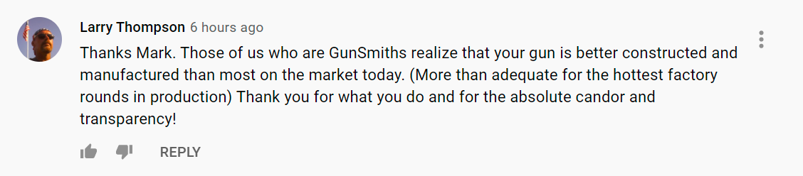

"Hottest factory rounds in production". Yeah, screw a bunch of CIP and SAAMI specs. What good are those anyhow!
P.S.: Never let Larry Thompson work on your shit.

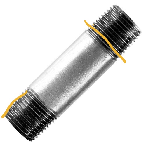

FWIW, I can manufacture a firearm that'll sufficiently fire 7.62 out of various gas pipe fittings... But it'd be fucking stupid to do so. That Serbu doesn't look a whole lot different than that.

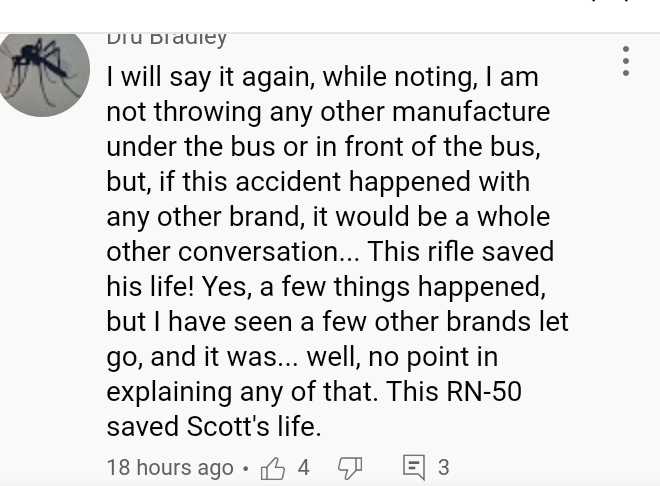

"saved his life" 🤣🤣🤣🤣🤣🤣

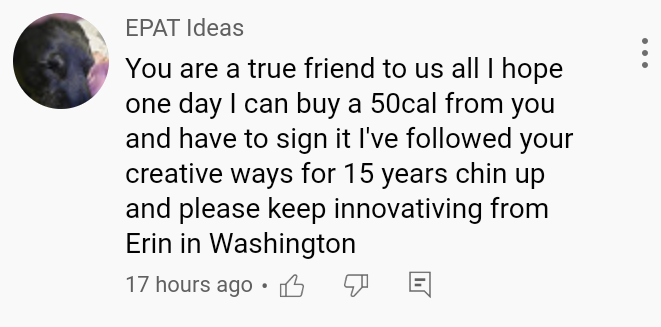

Shes followed his "creative ways"??

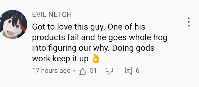

"Doing gods work".....well I guess god also destroyed Sodom and Gomorrah too sooooooo

Mordamer I think you are talking about threads shearing off at the rood like the left side mark.
Numedal I think you are thinking it would rip like the mark on the right side through the valley.
