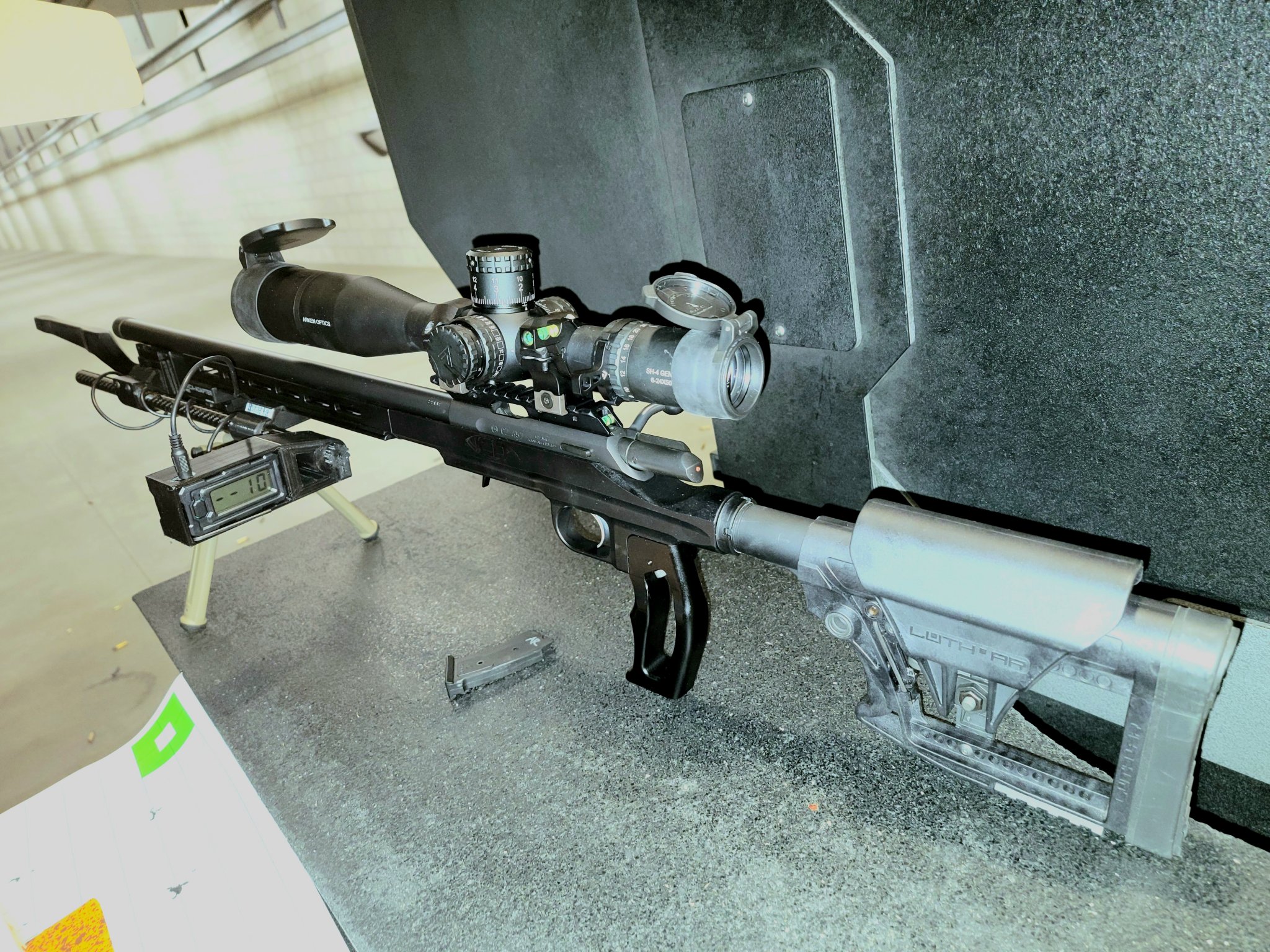

I am shooting a CZ457 Varmint barreled action in a Indian Creek Designs chassis with Luth MBA-3 stock and a Arken 6-24x50 SH4 MIL on top of 30 MOA Area 419 base.
I am zeroed at 50 yards with excellent groups (under 1/2"). My average speed is 1073 with low SDs with SK Standard plus. Strelok has been pretty accurate on the calculations under 100 yards for NRL22 competitions.
Weather conditions: Wind about 4.5 mph coming from 10:00, 84° F = DA of 4680
Strelok 100 yards calculation is 1.8 mils, which matches my results.
Strelok 300 yards calculation is 13.3 mils, and I was at 13.5 mils hitting a 12"x12" plate with 1.5 mils left for wind.
Strelok 500 yards calculation is 28.5 mils, and I had to put the turret to 24 mils, and hold over 12 mils, a total of 36 mils and 4 mils left hold. I was able to get hits on a 24"x24" plate.
Why is my DOPE way off on 500 yards? Do I need to adjust my BC?
I am still fairly new to trying to run out calculations on Strelok and figuring out BC, or a custom 22LR curve.
Thank you for inputs.
