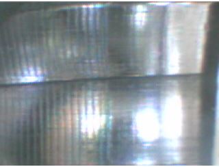

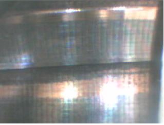

Also...just to show the difference between a savage bore and a custom barrel see the attached pics. These are not my images but what I've scoped in the past of savage. Savages like to be dirty...lol.

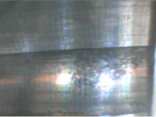

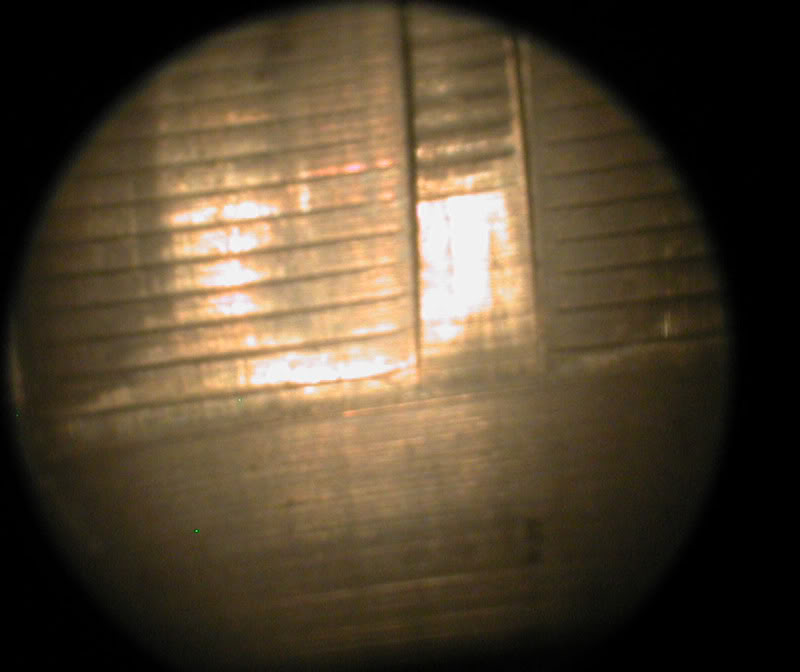

My 10 BA 6.5 CM barrel went to hell just after 800 rounds. Started shedding jacket - found copper in the gap of the thread protector and the muzzle. The tool marks are about as inconsistent as blind man driving in a wind storm.
The two photos with all the copper are after removing the carbon but just before I decided to pull it. The 2 cleaner ones are after I pulled it and took some JB to it to see if it was worth cutting down. Needless to say I either have a paper weight that use to be a barrel.
7038313
7038314
7038315
7038316
