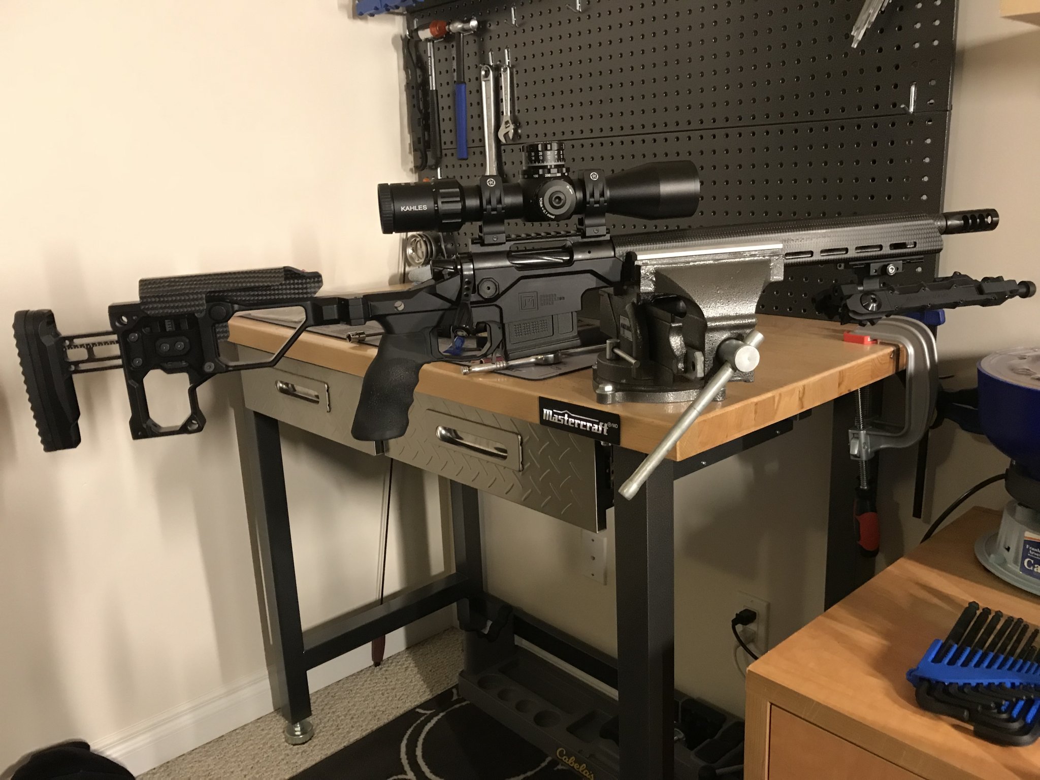

The Rifle
Action - Defiance Deviant
Barrel - 26" Krieger 1:8 MTU
Break - Area 419 Hellfire
Trigger- Timney Calvin Elite 2 Stage
Chassis - MDT ESS
Rings - ARC M10 Medium
Scope - Minox ZP5 5-25x56

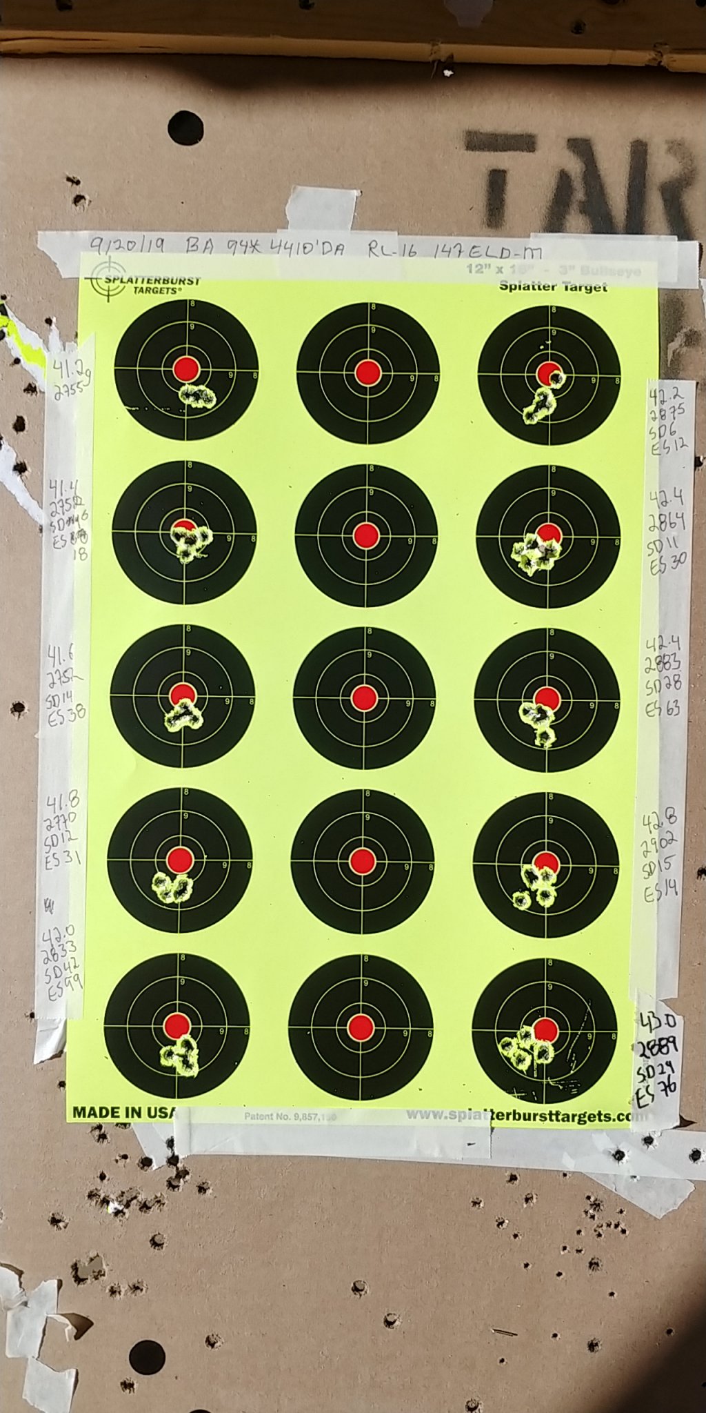

Anyone load for RPR with LRI 24 inch bbl?
I worked up a load with RL16 under 140 grain ELDM's, FGM210m primer and ones fired Hornady brass.
Worked up from 41 to 43.7, I did notice slight ejection mark and 43.7.
Loaded another 20 round at 43.5 and just shot them over magneto v3.
Although I do not see pressure signs I will back off and play with the jump at 42.7 as that looked like a nice group when I first tested the loads.

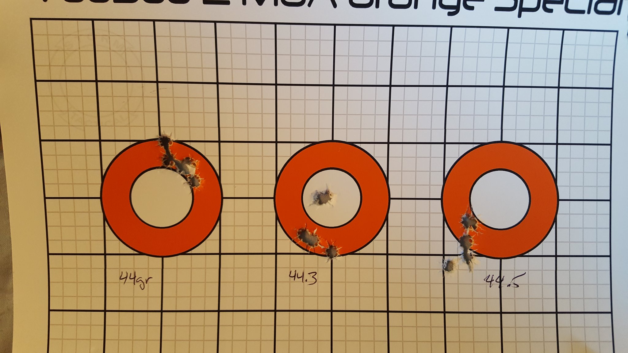

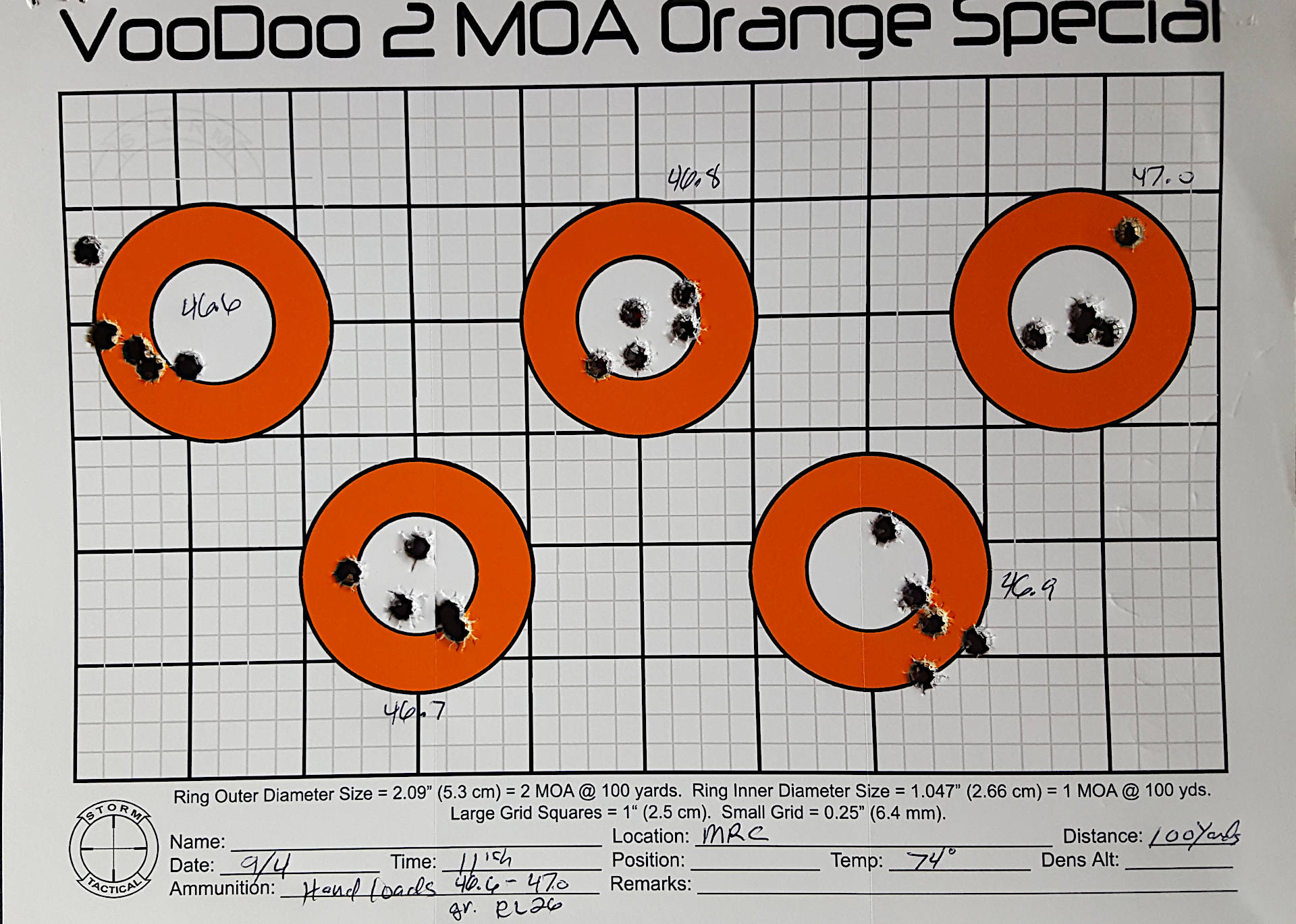

Working up my RL26 hand loads with 147 gr. ELD-M. This was yesterday at 93F and 90% Humidity. No wind. Hotter than hell but productive testing.
Worked 25 rounds from 44 gr. to 45 gr. at 100 yards on 2 MOA Dots. The lack of accuracy in most cases is my inexperience but still I'm consistently shoot sub MOA. No signs of pressure. Already loaded the next batch of 45.2 to 46.2 grs. Hornady brass, CCI primers, RL26 and Hornady 147 gr. ELD-M . Need to get velocities and spreads but I'm more interested in accuracy and pressure signs like heavy bolt lift and flat primers and ejector marks. So far it's easy peezy and as accurate as factory at half the price. I think RL26 and 147 gr. ELD-M's are gonna be my poison as I loaded 10 rounds of them at 45.2 gr. and popped a ten inch gong at 600 with still a sub MOA group.

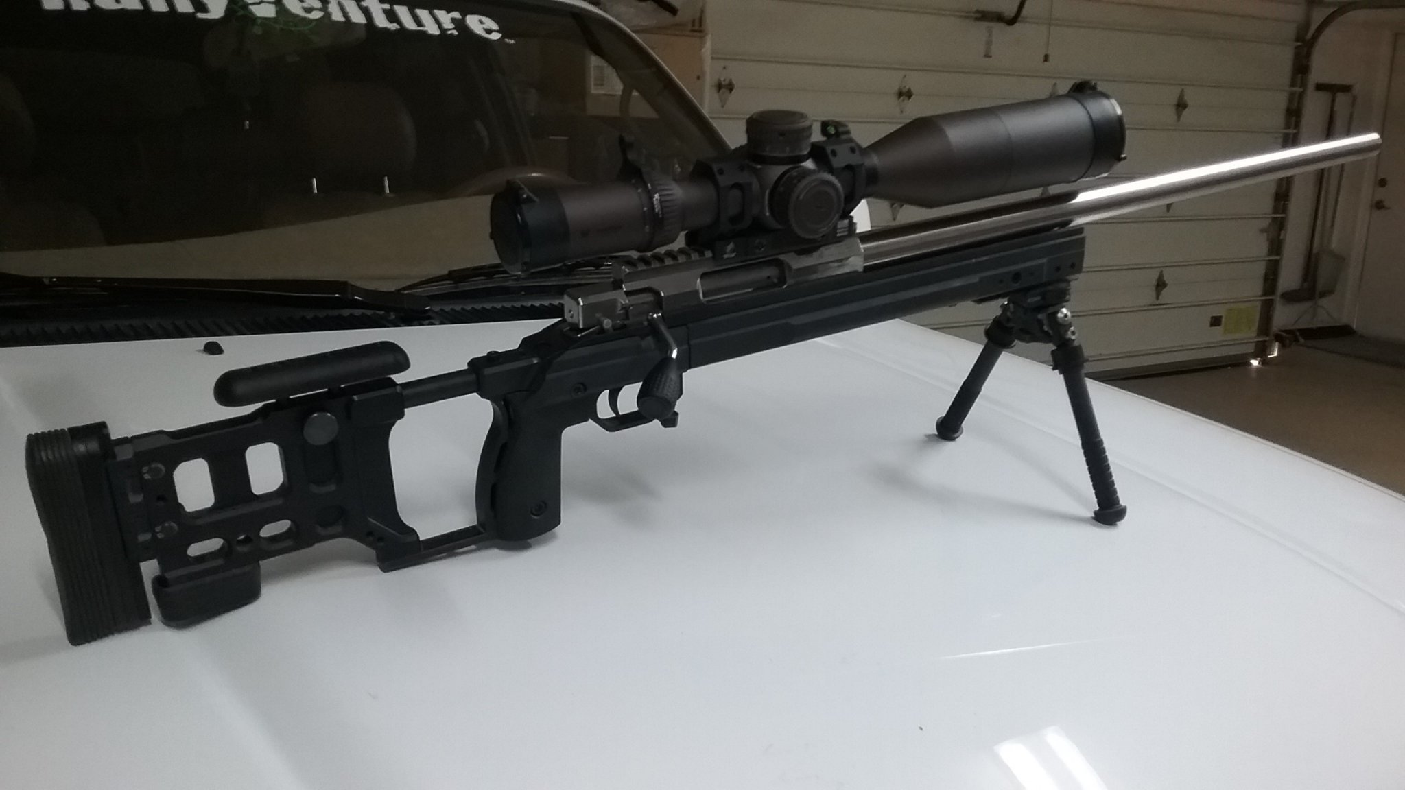

My daughter's rifle was throated for the 147 ELD to hit lands at 2.805. Seated just off the lands, she is using 40.5 grains of H4350 to get 2580 fps out of 22" barrel. 5 shot groups well under .5". It also shoots 140 vld with 42 of H4350 sub .5", 2710 FPS. Adjusting for her shorter barrel length, it seems like this jives pretty well with the OP. If RL26 comes back, may try that in there.

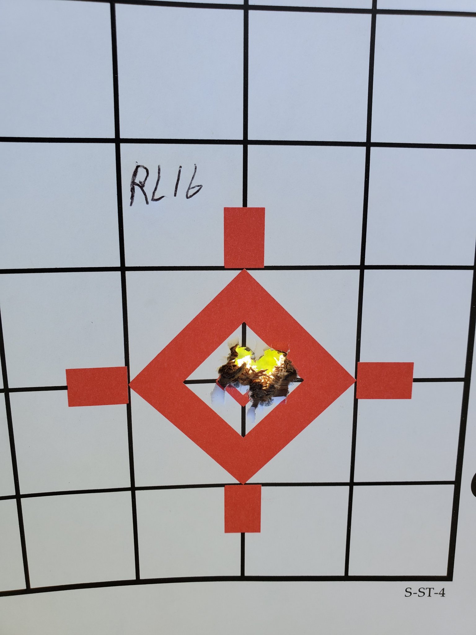

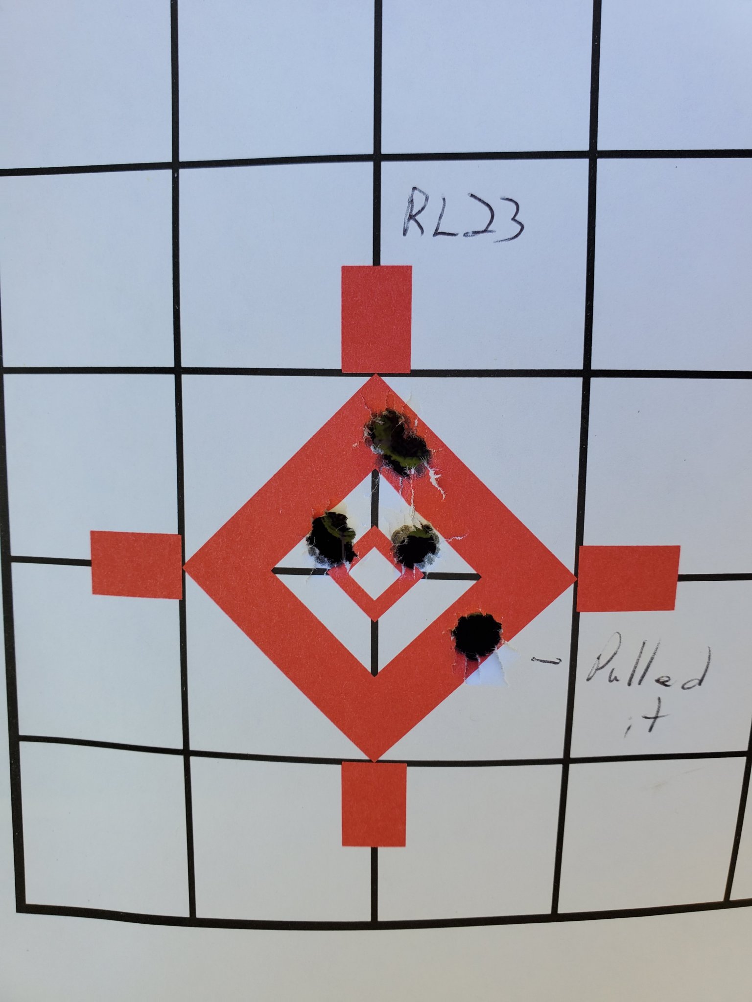

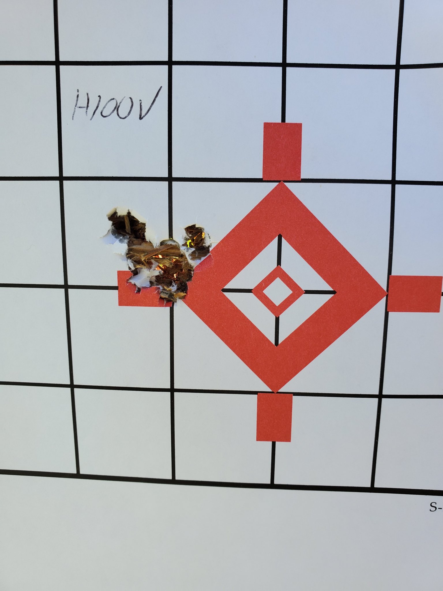

I can't find RL26 anywhere so I tested 3 alternative powders to see what I could see.
I used some leftover 143 eldx bullets. Coal of 2.785 because this puts me .010 of the lands.
Rifle is a Ruger Predator 22" barrel with a huge brake and running a 6-24 power scope on 14 power because it was hot as hell and bad mirage. 100 yard targets.
RL23
40-2343, 40.5-2347, 41-2372, 41.5-2415, 42-2433, 42.5-2469, 43-2478.
So slow as hell. However I will run another test from 43.5 to 46 because there was zero pressure signs.
RL16
40-2506, 40.5-2530, 41-2549, 41.5-2578, 42-2635, 42.5-2656, 43-2688.
Nothing special here. However the primers were flat on the 3 higher charges and the 2 highest has ejector Mark's.
H100V
40-2614, 40.5-2629, 41-2677, 41.5-2693, 42-2721, 42.5-2726, 43-2766.
So this is better. The top 4 started to show flattened primers and the highest charge did show extractor swipe. Nothing major though.
So you guys that can't find RL26 maybe give H100V a shot.
I was surprised that poi remained surprisingly close throughout the test. Here's the 7 shot groups. On the shot I pulled I also sent another one through that hole that I didn't pull. So whatever...
In short, stellar. I'm going to take it further. Need a bit less jump and some more speed. Think there is a node just above where I stopped. Check it out, I posted it here:

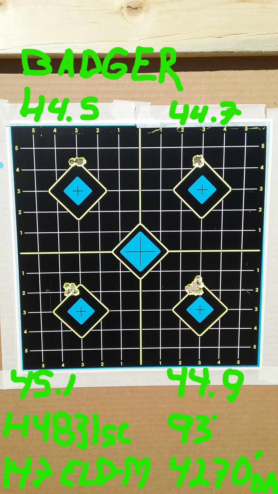

I think it's pretty clear that several of these powders will give good results. I started off with H4350, but when it got scarce I bought a lb of H4831sc, (and then later 16lbs), and that's what I've been using for the last couple years. The rifle is a Badger 2008 action with a 24" target crowned Krieger in a KRG Whiskey chassis, and it's by far the best shooting gun I've ever owned.
Reactions: Esumter
I'm sorry I didn't write the results on the target, so you'll have to look below and at my awesome Paint skills. I've been running 44.5g as my load. These are 7 shot groups, BTW.
147g ELDM - 1x Hornady Brass - CCI Primers - H4831SC - .020 off lands. Average Velocity - ES - SD
44.5g 2722 - 14 - 12
44.7g 2724 - 6 - 3
44.9g 2725 - 19 - 7
45.1g 2744 - 39 - 12

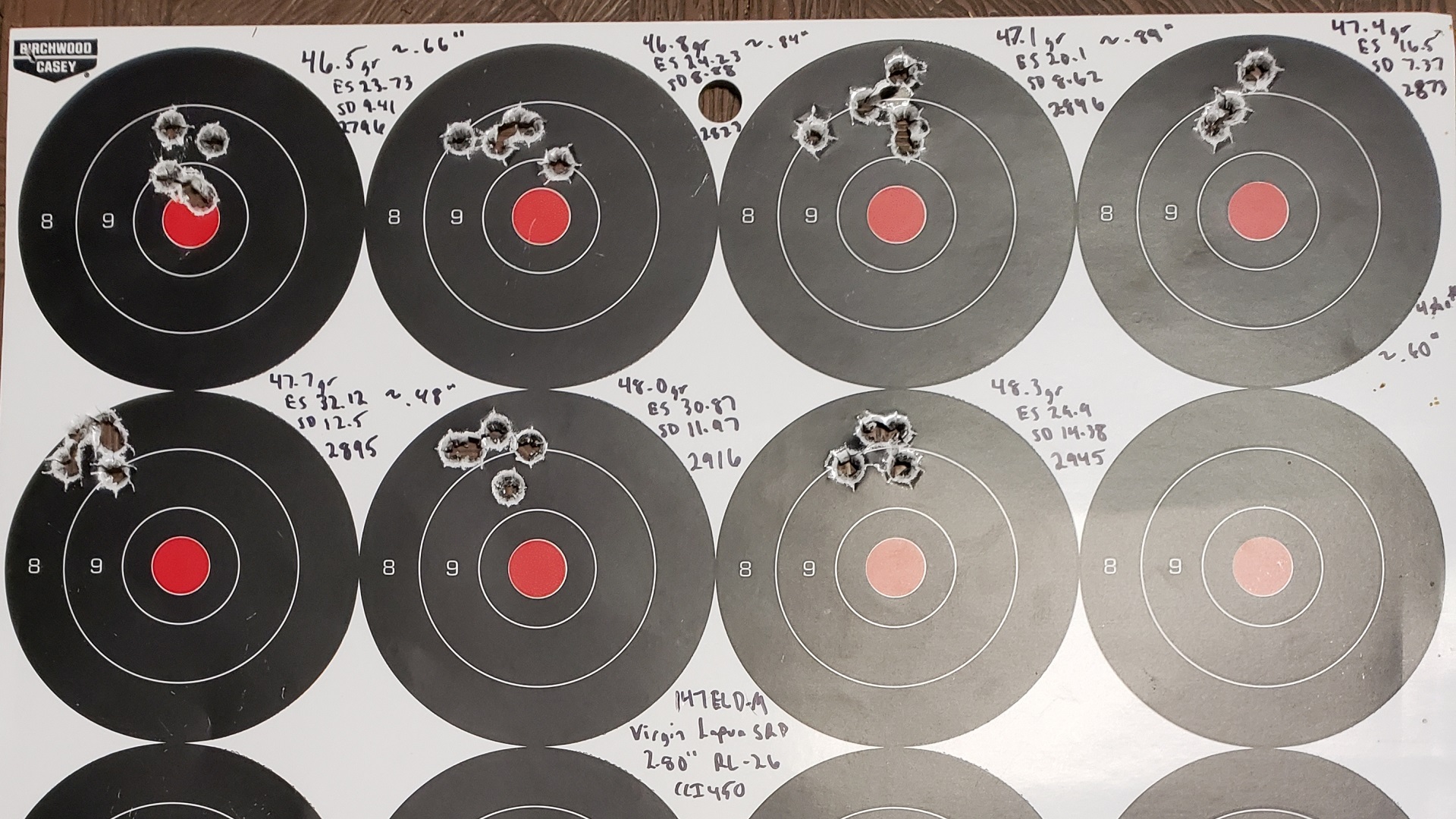

Based on the data EDMJustin provided in this thread I thought I'd try out some RL16 so loaded up ten loads of 5 rounds from 41.2 - 43.0. By the time I got to the max load it was pushing those 147's past 2900 according to my Magspeed Sporter, but the groups were opening up and I was getting some pretty good stringing. I think I'm going to load up some more starting at 40.8 - 41.4 and a second set from 42.1 - 42.4 and see if I can find a sweet spot. All of the loads below were over 2750, which is plenty for what I'm doing with the gun, (PRS), and it means it's still supersonic at 1500yds. (The velocity for 41.2 is a single shot, I didn't have the chrono adjusted properly, so I'll re-do that load and report back).
Started development with RL26 since I managed to score 2lbs from brunos. Shot with a 26" PVA built ARC nucleus BA, with a griffin 30 cal paladin can.
Virgin Lapua SRP
CCI#450
Hornady 147gr ELDM
Reloder 26
2.80" roughly .150 jump
46.5gr
AVG 2796
ES 23.73
SD 9.41
~.66"
46.8gr
AVG 2823
ES 24.23
SD 8.88
~.84"
47.1gr
AVG 2846
ES 20.1
SD 8.62
~.89"
47.4gr
AVG 2873
ES 16.5
SD 7.37
~.60 (4 shots, had one fail to go off)
47.7gr
AVG 2895
ES 32.12
SD 12.5
~.48"
48.0gr
AVG 2916
ES 30.87
SD 11.97
~.61"
48.3gr
AVG 2945
ES 29.9
SD 14.38
~.48"
Brass still looks excellent. No sticky bolt, and primers are still rounded. Bullets were deformed pretty good to get 2.80 even at 46.5gr. I'm thinking working in the 47.7-48.3 range. ES/SD weren't the best but had very similar POI.
Brass goes 46.5 on left to 48.3 on right.
