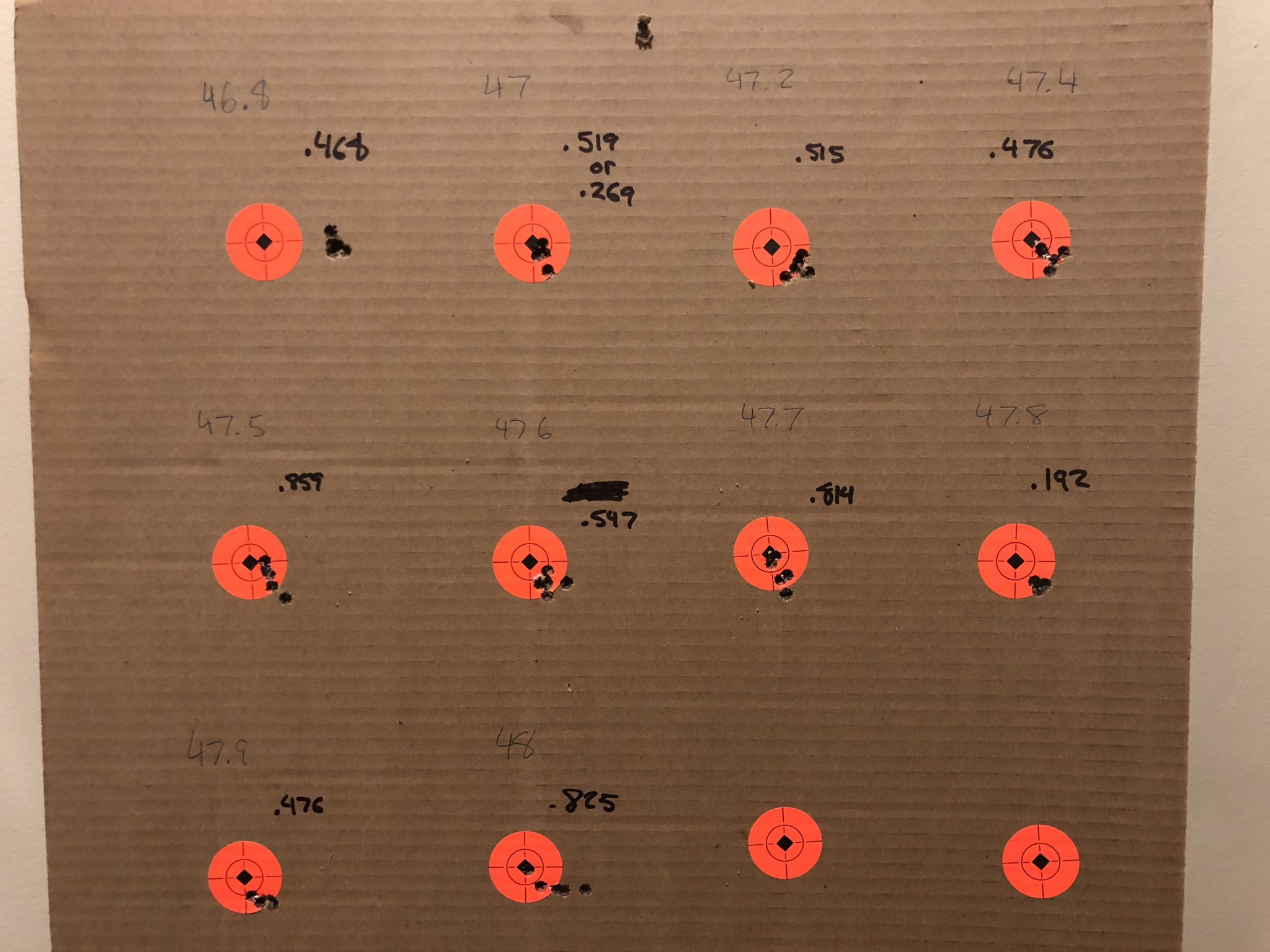

You can see in the attached image that I marked and shot the first 10 targets. All groups consist of 5 shots each.
46.8gr - I thought I did alright here. Obviously the scope was not fully adjusted, so I made a quick adjustment before shooting the next group. .468 MOA
47 - I think I found a node here. While the group overall was a .519, I am positive I threw that last shot that impacted low. Otherwise we were looking at .269 MOA. I thought this was worth taking another look at on another day with more rounds, but I also wanted to see if I could find a node with more velocity, so on we went...
47.2 - Other than the fact that it was already getting to be a long day and that was wearing on me, this one was pretty straight forward with .515 MOA
47.4 - Same as the last one. I may have neglected my platform a little and may not have been fully on my game, but nothing too exciting happened here. .476 MOA
Next I started on the loads that were spaced out by .1 just to be safe and check for signs of over pressure. Spoiler Alert, never happened. Pressure seemed fine throughout the entire load range.
****Edit**** Thanks to the watchful eye of Juggerxxx on this forum, I believe there actually are some signs of over pressure with the hottest load of the batch (48 grains). Please see the conversation below for additional information on this. ****Edit****
47.5 - I believe I pulled one really low here and was overall not at my best, but all relative. .859 MOA
47.6 - Same as 47.5, but down to .547 MOA
47.7 - Same as 47.6, but up to .814 MOA
47.8 - I did not feel like I was putting any more effort into this one, but definitely no less. Anyhow, definitely found a node here. .192
47.9 - Not bad here. .476 MOA
48 - Opening up a bit. Also this does not count the stray shot all the way to the right. That was the first shot of the day to see where approximately the point of impact would be for a quick scope adjustment. The remaining 5 impacts come to .825
So based on this experience, I think I am going to start working with a 47.8gr load with RL26. I was hoping to find something in the 2900+ velocity, but 2883 is close enough. Also, in my experience, these barrels can get faster over time, so we are all good.

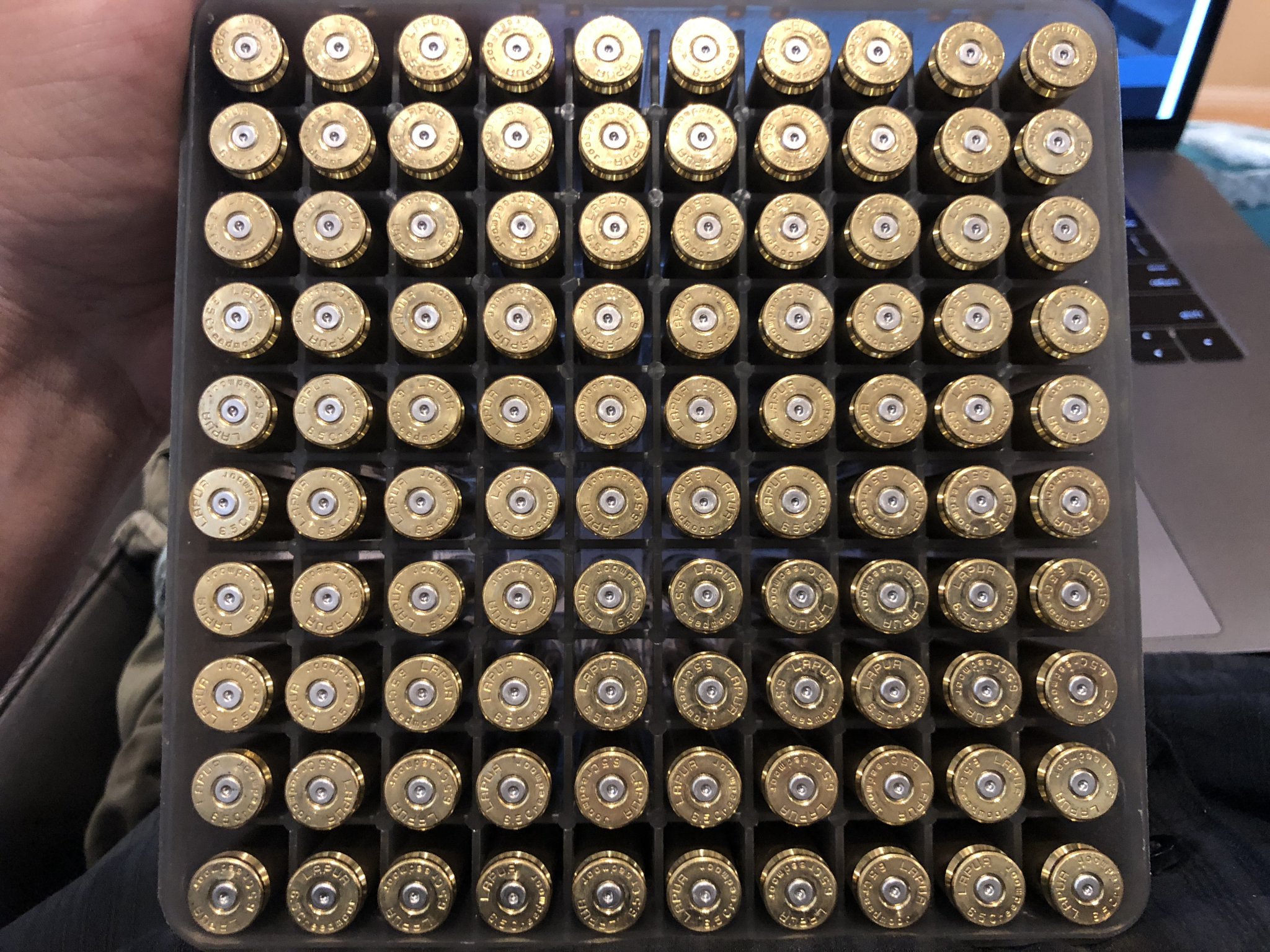

Thanks. I am not sure how much this helps. While in the ammo case, the empty cases fell out of their holders so when I put them back they were all out of place. Originally I had the loads in rows of 10 with the tier charges on the hinge side of the box. Now they are all mixed up.

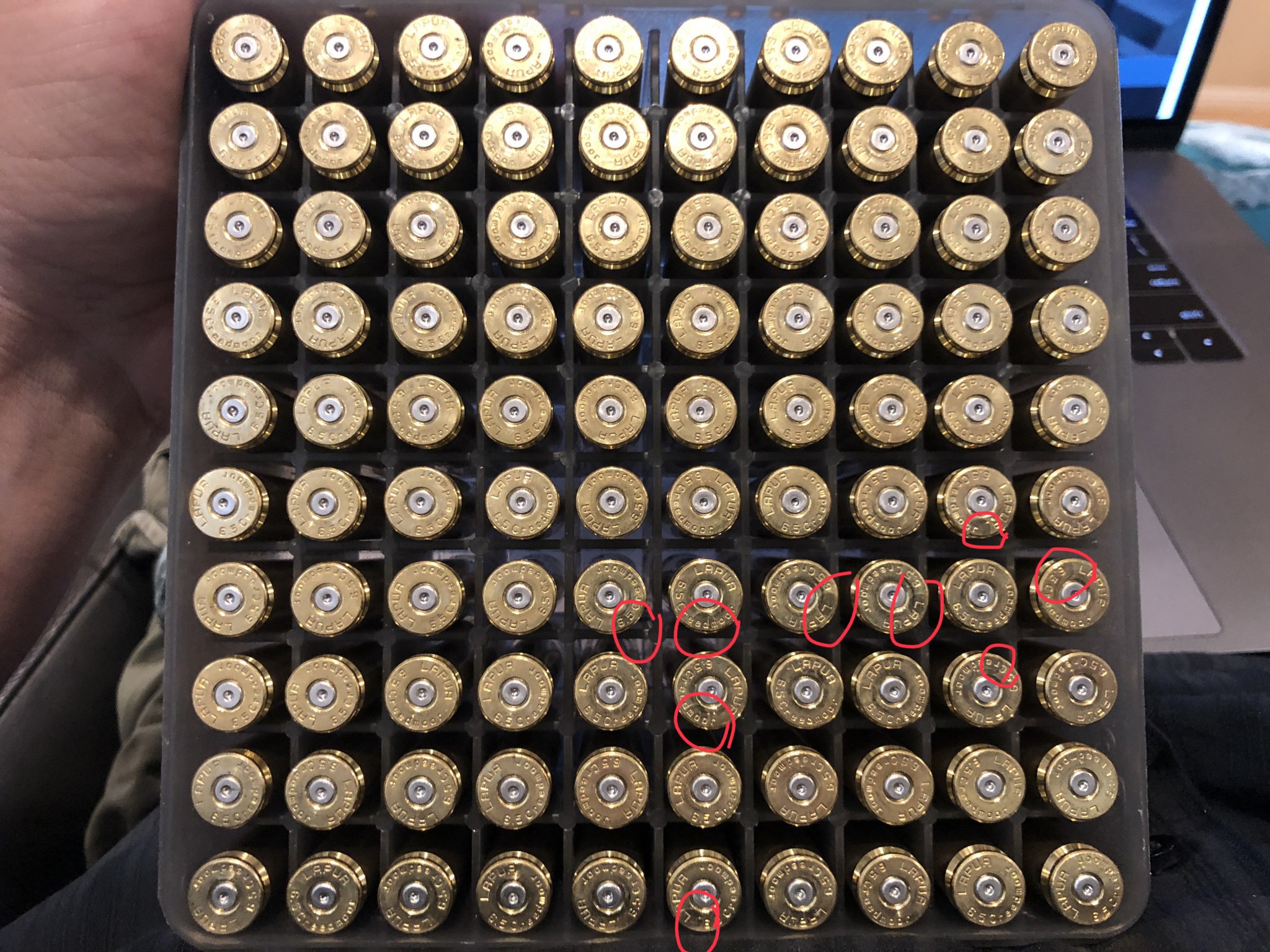

Not tying to prove you wrong or be a dick but can you check these couple of cases. Looks can be deceiving but they appear to have round ejector marks?
Not a dick at all man. That is really helpful. I do not have a lot of experience with load development like this. I have always been pretty close based on recommendations from others from a pretty vast knowledge base of .308 formulas. So I know what to look for based on things that I have read, but I lack the experience, it seems, to spot all the signs.
I believe you are 100% correct here, although I have to say that what you pointed out in the photo is far more noticeable than when I inspect the brass by eye. Looking at the same pieces her in person, the marks are so incredibly faint that I almost feel better for completely missing them.
So it seems you have marked 9 of them. Lets say there is another one floating around there for an even 10. My assumption is that this had to have occurred with the 10 rounds that were the hottest, ie the 48 grain loads.

Good to hear you are the type of person that is open and not an easily offended hothead. Keep in mind I’m not the most experienced reloader and I too am learning more and more every day.
Its very easy to miss those ejector marks. I seem to only be able to see them in the natural sun light at certain angles. I get hem back to the house and have a very hard time seeing them again. I would have to agree with you in that they are more than likely the highest powder charges but you never know. I have seen them occur in the middle of a charge range and then disappear at a higher charge. They can even happen if you have leftover solvent or oil in your chamber. Makes sense the brass needs to expand and grip the chamber walls and the lube can stop this. Here is a great writeup that Greg did on this very thing and pressure signs. https://www.primalrights.com/library/articles/understanding-pressure

I even had primers creatoring or flowing. Its hard to see from your photo but your primers appear to be in good shape. No creatoring and they look nice and rounded on the corners. Possibly from the Lapua brass and small primer pockets?
  • I don’t think there is anything wrong with the brass. I bet you cannot even really feel those ejector marks?
  • I would bet the house that the rifle, bolt, chamber, action and barrel are all still in perfect condition. My rifle still shoots awesome groups after testing the 147eld and RL26. I posted my results on another forum and there were some people with the opinion that continuing with this charge range will eventually result in either a short barrel life or the rifle exploding. This is newish territory and there isn’t much official testing down with actual pressure measurements so who knows.
  • I would load up a few of the charge you want to explore and try them out again. Pay close attention to the brass out at the range and look at it in every angle for any rings. You may even need to do the whole test over again just to know exactly where the pressure happens so you know exactly where the damage zone is and back off a bit from there.

Don’t worry about missing the ejector marks on the brass, but there’s a lesson here: the process on encoding a JPEG image reduces the dynamic range of the colors in the image (it’s a lossy process). This has the benefit of exaggerating subtle changes in color (like the ejector marks on brass). This has the effect of an image “enhancement” that makes it easier to see these marks in the photo than it is with your eyes.

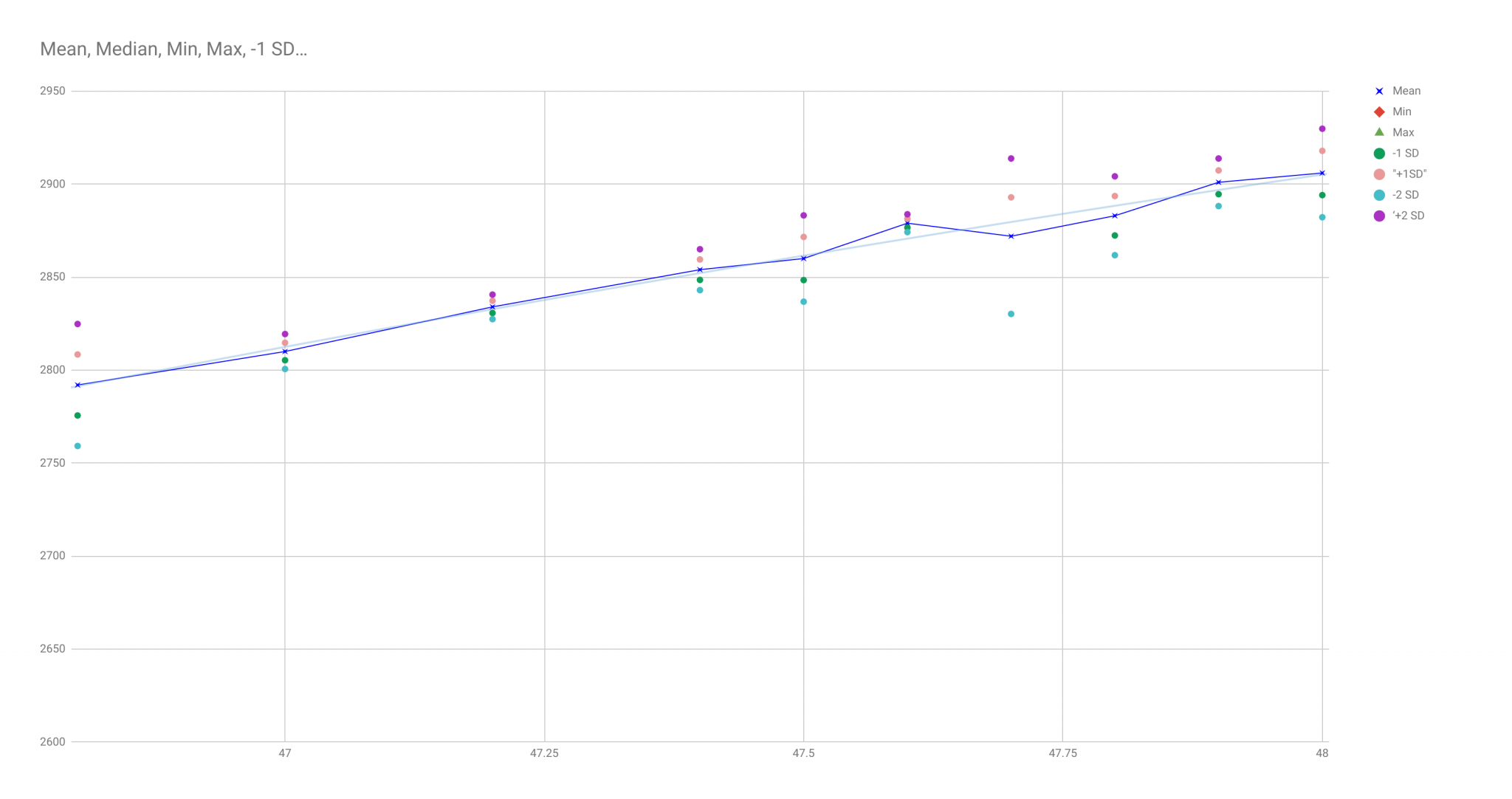

I put your data into my load development template (adapted from 6.5 Guys). Here's a link. If you look at this chart:
you see that 47.5, 47.7, and 47.8 are all under the trend line (indicating a possible speed node, where incremental powder increase changes muzzle velocity less). However the speed goes up and SDs tighten at 47.6. At 47.7, the SDs open WAY up.

The chart you posted is a great visual. It helps me understand a bit more of your explanation. Very helpful. Thank you. When you ask about my shot data, I am wondering what you mean aside from what I have posted. Can you elaborate if you have the chance? Also, I did not understand the reference to dousing the mag with water to check for pressure. Sorry, I guess I am newer at this than I previously thought.
