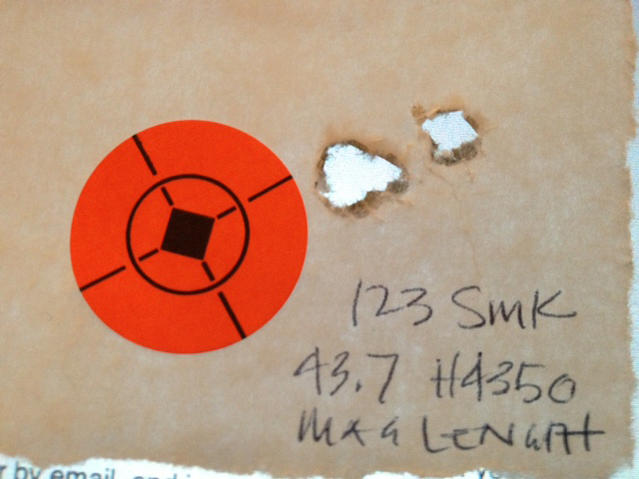

Oh yeah, 42.6gr H4350, Fed 210 primers, 1.920" case length, .298 neck bushing in a Redding full length sizing die, 2.840" OAL and 2.160" on a Hornaday comparitor. .076" jump in an 8.5 twist Bartlein barrel om a GAP Crusader.
No that didn't take long thrusty, 6 months. Next 1K rounds should take longer than that.
