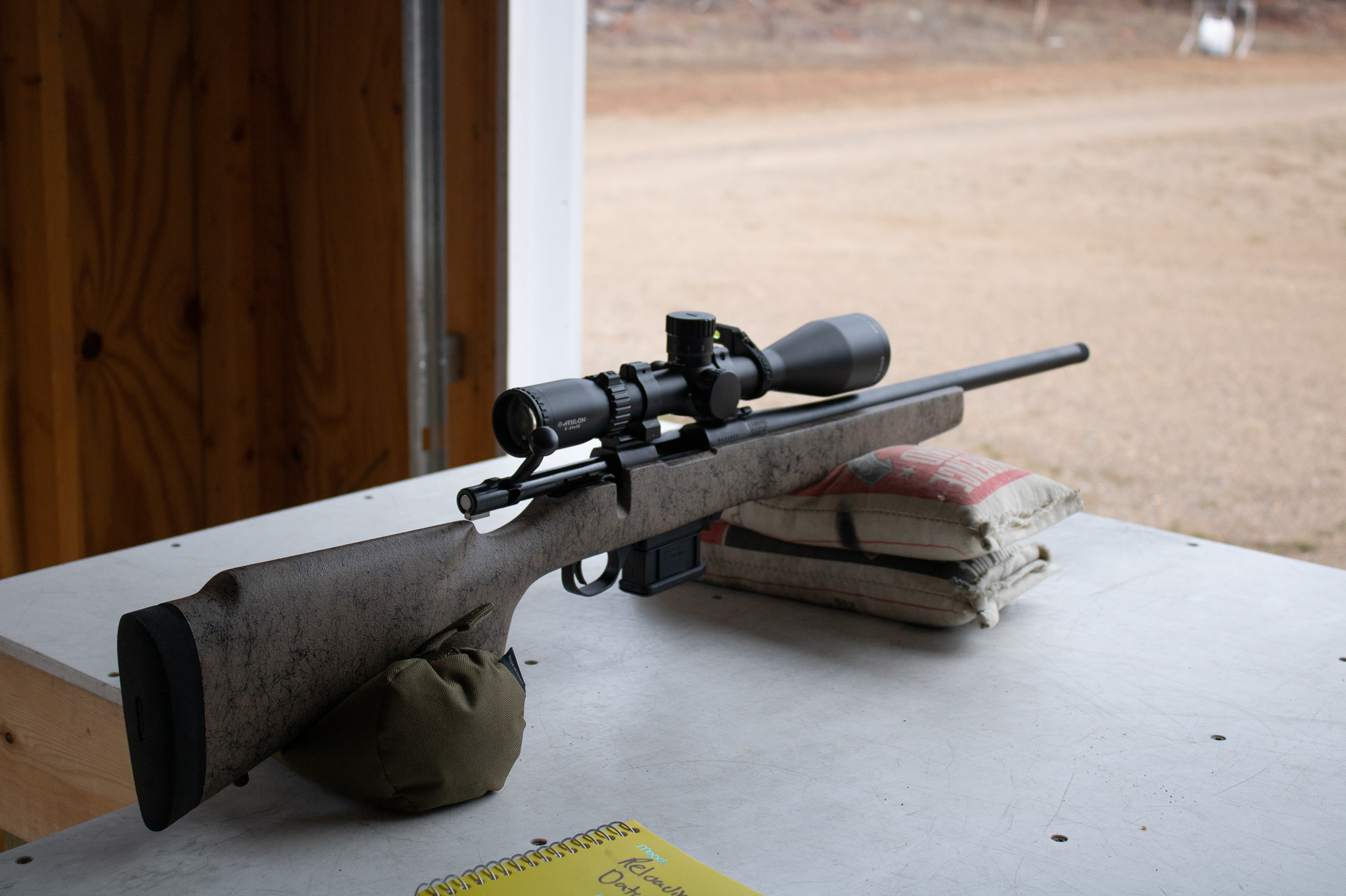

I bought the Howa 20" heavy barrel in the plastic stock, which has aluminum pillars but a plastic trigger guard. I got a DIP aluminum trigger guard because the action screws eventually squeezed through the plastic. I have an Oryx but prefer the plastic stock because it's lighter and a scope can mount low. Accuracy is the same with either stock. And that accuracy is excellent. The worst loads are 1 moa-ish and hand loads with Sierra 123 MK's are easily 1/2" at 100 yards and down to 1/4-5/16" with minimal work. I think the recoil is mild enough that the plastic stock is fine, although you may prefer the look and feel of a chassis.
Since the DIP bottom metal is $120-ish for the plastic stock you could subtract that from the cost of a chassis since you really need that DIP for the plastic stock. Check 65grendel.com if you haven't already.

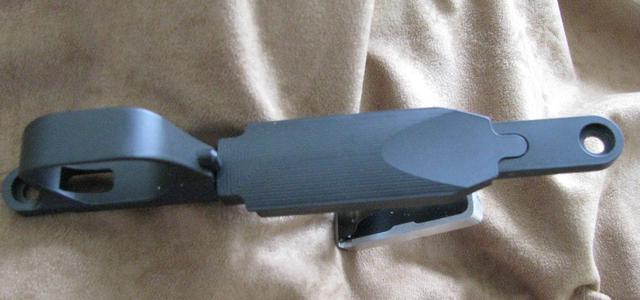

I had a howa 6.5gr heavy barrel in a b&c stock.
Factory dbm and mag wouldn't feed but i have heard they have fixed that(b&c). plus there's a few companies offering bdl metal for under 179. and one of those companies even makes stocks for them.
http://www.oregunsmithingllc.com/ has bdl and stocks.

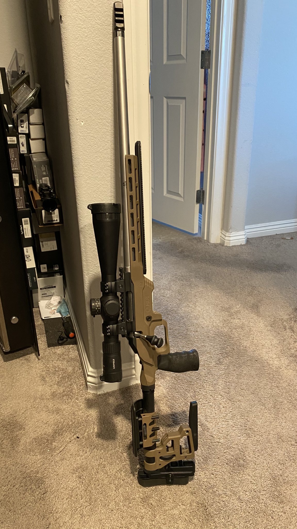

I bought a Ruger American predator a while back, it was accurate with the factory barrel but I decided to rebarrel it with a 22” heavy palma from preferred barrels out of Utah shoots very accurate no problem getting out to 1k yards. Rifle is .5 moa capable with match factory ammo, I don’t reload so I could only imagine it would perform better with a developed load. I guess my only complaint about the Ruger action is the bolt having some play but I have never had feeding issues. Idk sometimes I think about maybe have gone the 6mm CM route instead.

A barreled action from brownells, b&c stock and oregunsmithing bdl would be just under 900.
awesome, I'm out of the loop though. Is oregunsmithing a particular gunsmith, and what is bdl? Could I take it to any reputable gunsmith in my region and have them put it together and glass bed for me? Thanks!
Yes. Bdl is bottom metal. Instead of a mag u have a traditional internal mag with swing open floorplate. Holds about 4rds I think.
Is there a mechanical advantage with the fixed mag, or is this a personal preference thing? Thanks!
Edit: oh I see above, someone mentioned feed problems with the box mags. hmm
Potential feed problem. Apparently b&c fixed issue. Though the factory mags do suck
