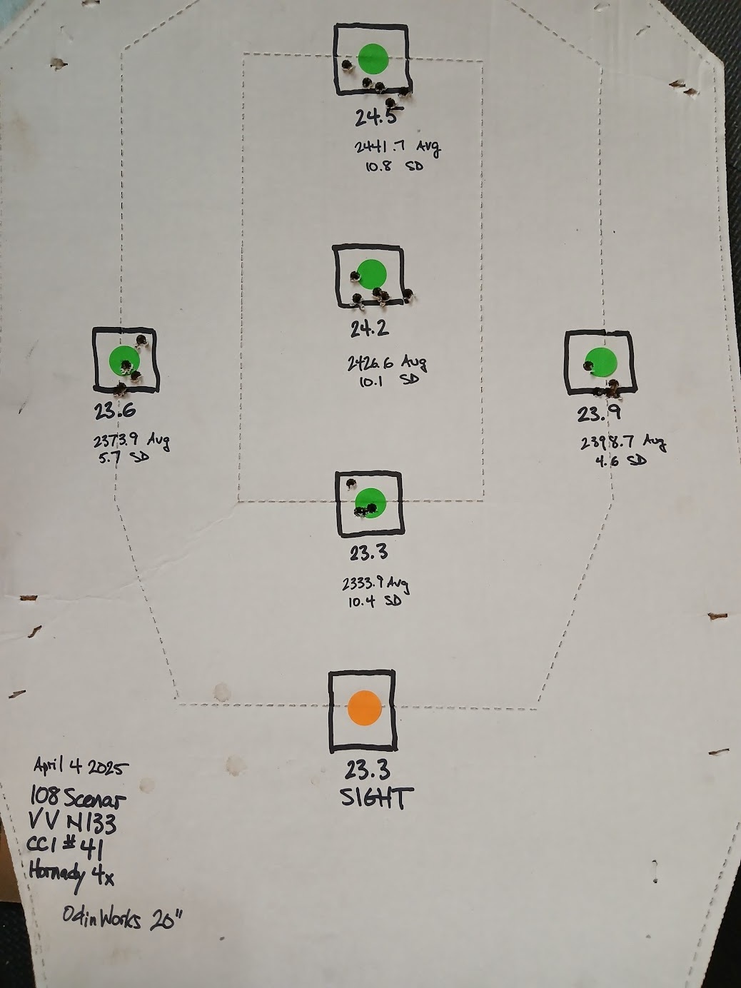

Tac is great in the grendel. I've always been curious on how n133, n135, and n140 perform in grendel but ive never known anyone to have those powders and have a grendel so they can try. It would be great appreciated if you got to test that out at some point. I myself have some Benchmark I will try but I'm always away for work. There's no telling when I'll get to it.
26.4 gr N133 with Sierra 100 gr Varminter HP in Hornady 1x brass
Velocity -- 2638 fps in 20" OdinWorks, 2544 fps in 16" Lilja
24.8 gr N133 with Sierra 107 gr Match King in Hornady 1x brass
24.5 gr N133 with Sierra 120 gr Match King in Hornady 1x brass
Velocity -- 2289 fps in 16" Lilja
These worked well in 16" Lilja and 20" OdinWorks barrels. N133 burns very clean, low SD, low ES, but not as speedy as IMR 8208 XBR or Alliant AR-Comp might be with same projectiles.
I have a load test waiting on my lazy self, for N133 and Hornady 100gr ELD-VT. I'll add that later after it's been run and I sort best charge.

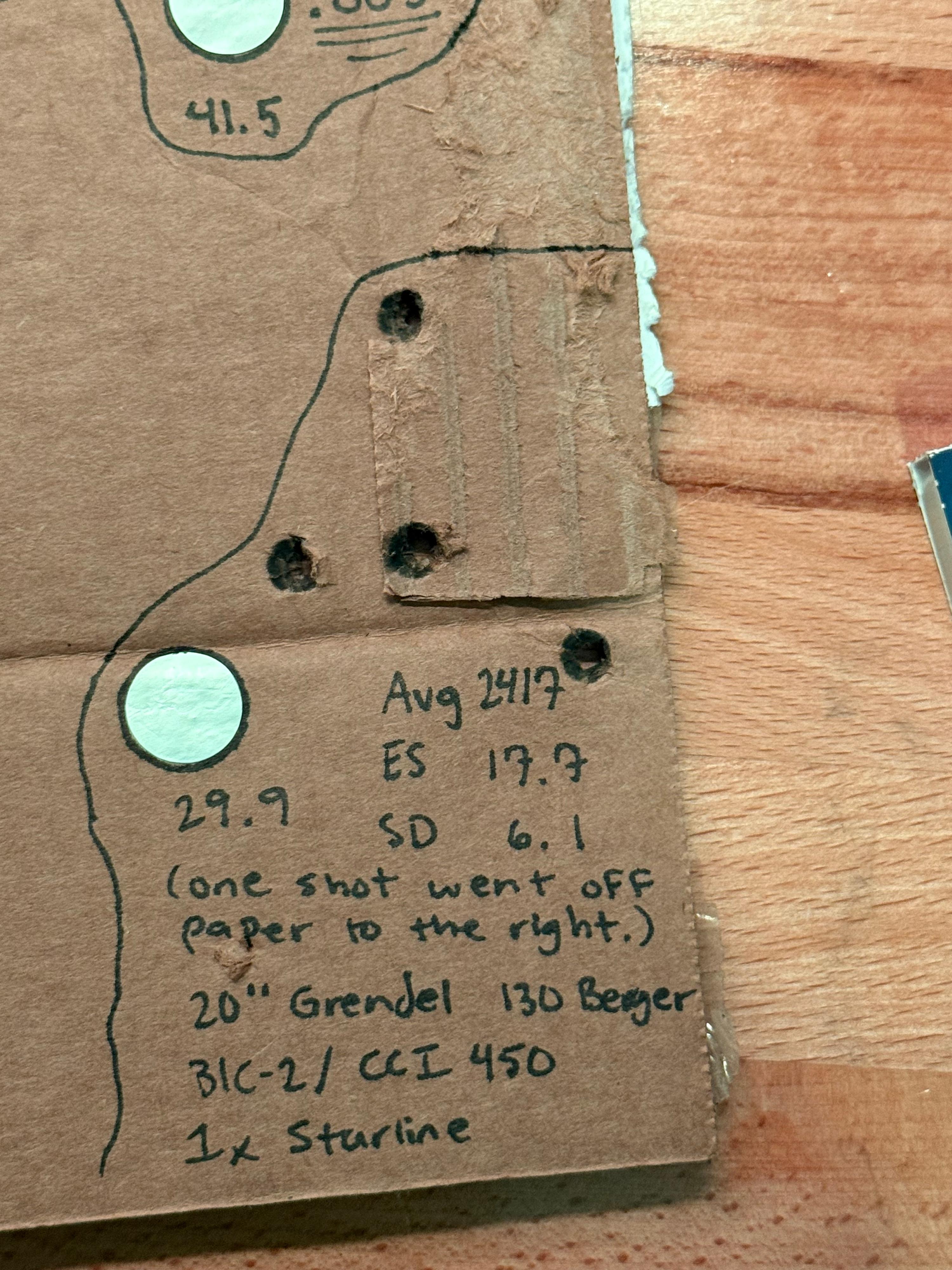

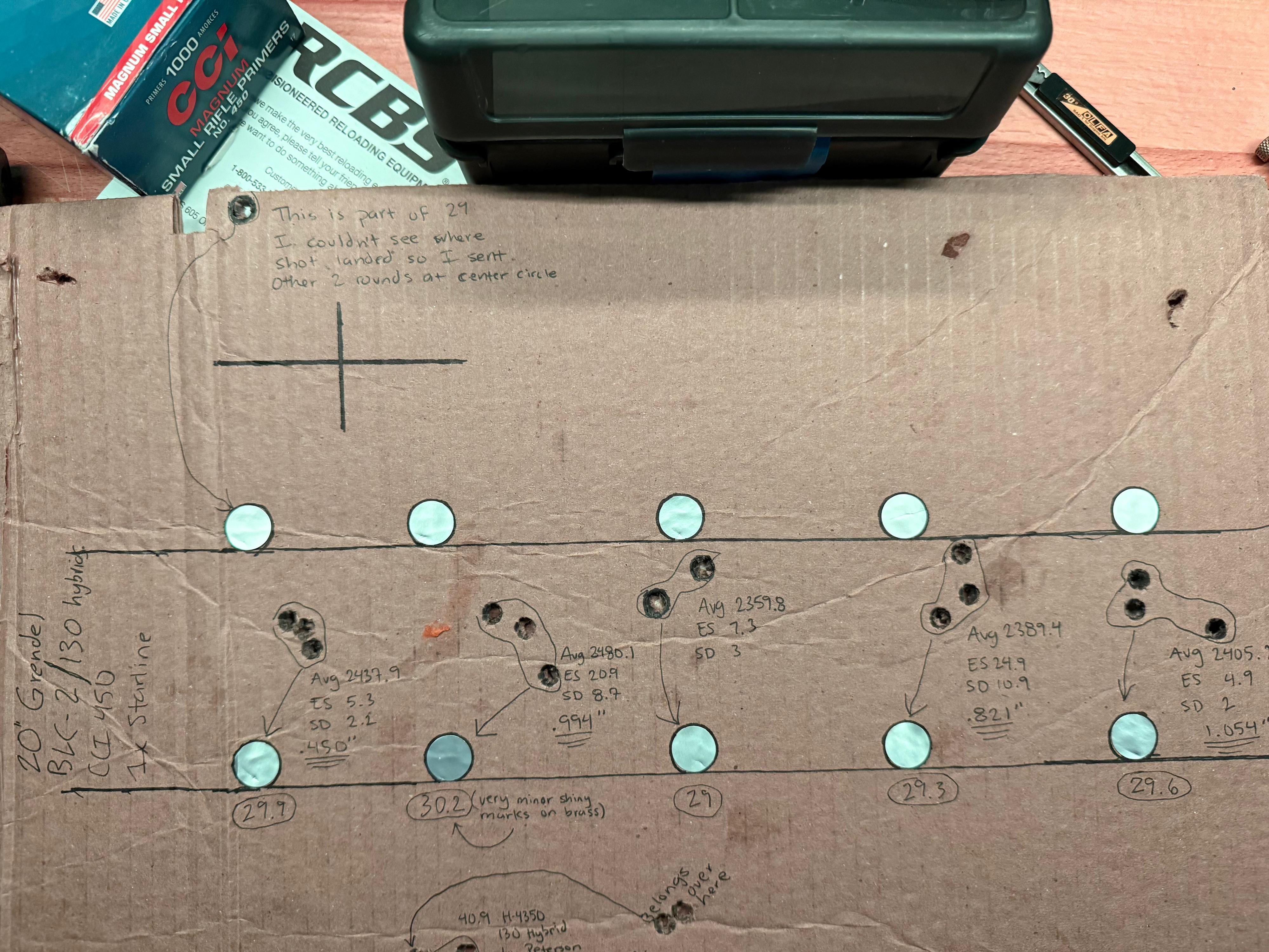

Anyone have any input? I can't seem to get the grendels figured out.
I've never been able to find a load that is satisfactory. I don't like 3 shot groups so much but yesterday I tried some after multiple 5 shot group attempts that all had piss poor results.
1X Starline
CCI450
BLC-2
BERGER 130 AR HYBRIDS
I did not shoot the groups in order from lowest charge to highest, left to right. Reason being, I started with lowest charge weight on top left. I could not see the bullet hole (it ended up at the top edge) and decided to go for a circle more on the center of the cardboard. I carried on from there.
I ended up with a group I actually liked, 29.9, so I decided to load 5 more and try today. I was hoping to confirm it would shoot good.
I adjusted the scope to bring my impacts down. Below are the results.
I can never seem to figure this cartridge out. I've tried TAC and benchmark with other bullets too. Any grendel experts here have any input?

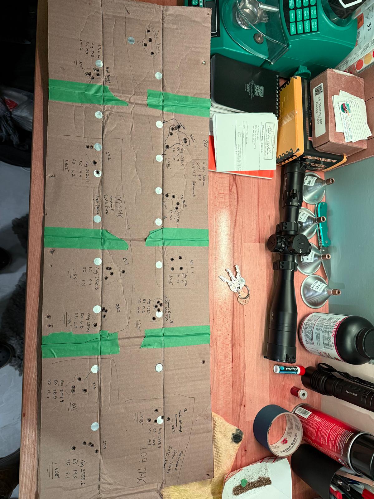

Coincidentally, I am having the same issue with that one haha. I have not been able to get any consistency out of it. It used to be worse with a bad bedding job. It would create shotgun pattern. It got a new bedding job and it's now around 1 moa so I can take it hunting at least.
The top 3 groups that say 20" grendel belong to the one being discussed a few posts ago. All other groups are from the one I had chopped to 18".
One of the groups says bad primers. I was trying new primers I had never used before. I was having trouble seating them and they ended up getting some nasty crush marks, which is why I labeled them as bad primers.
All the rest I was able to seat properly.

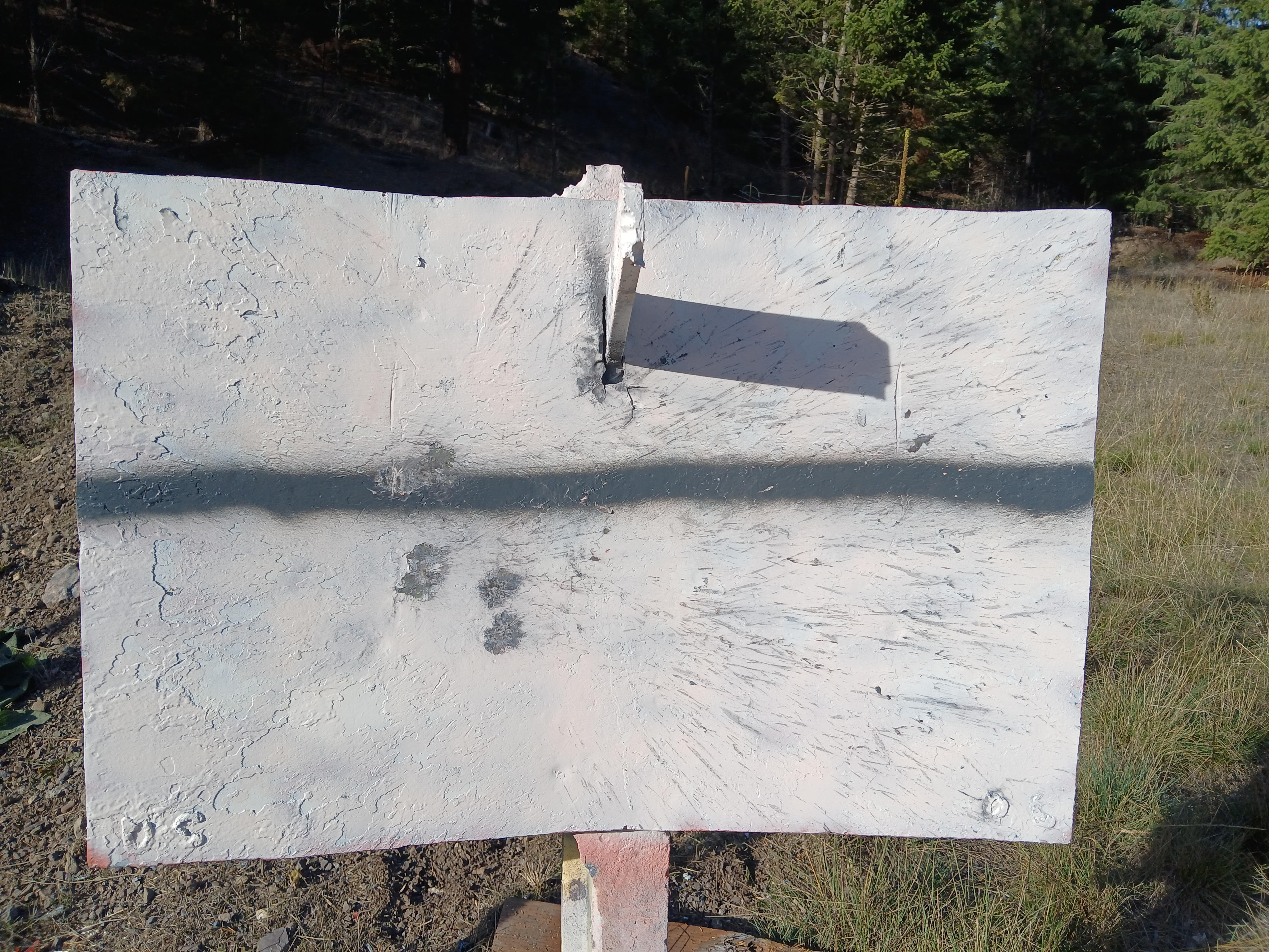

Is it possible you have a problem with your scope?
I spent 4 range sessions cussing my reloader, myself and the bullet manufacturer till I figured out my Leopold scope had came apart internally.
I had to have 2 range guys try and then realized the consensus was something evil way past crappy rounds was happening .
Different scope, whole new day.
I shot a scope that was mounted finger tight once. I'm not too bright took half an hour before I pulled the bullshit card on that.
None of those rounds are grouping, they are not even changing size or shape in a manner that can be read.
Have a friend at the range give it a go, if they get the same result start checking mounts or swap scopes so you can systematically eliminate things. One at a time.
Take any other gun you have at the same time for a "standard" to measure by.
Some days I pack it all up if it seems I'm not doing well enough to test loads, aka my last trip out with a scope I didn't like much .
I will shoot that scope one more time with known hand loads before I pull it off the rifle to eliminate a bad day after rechecking tourq settings.
It's always the last thing you think of checking. Lol.
Good luck
