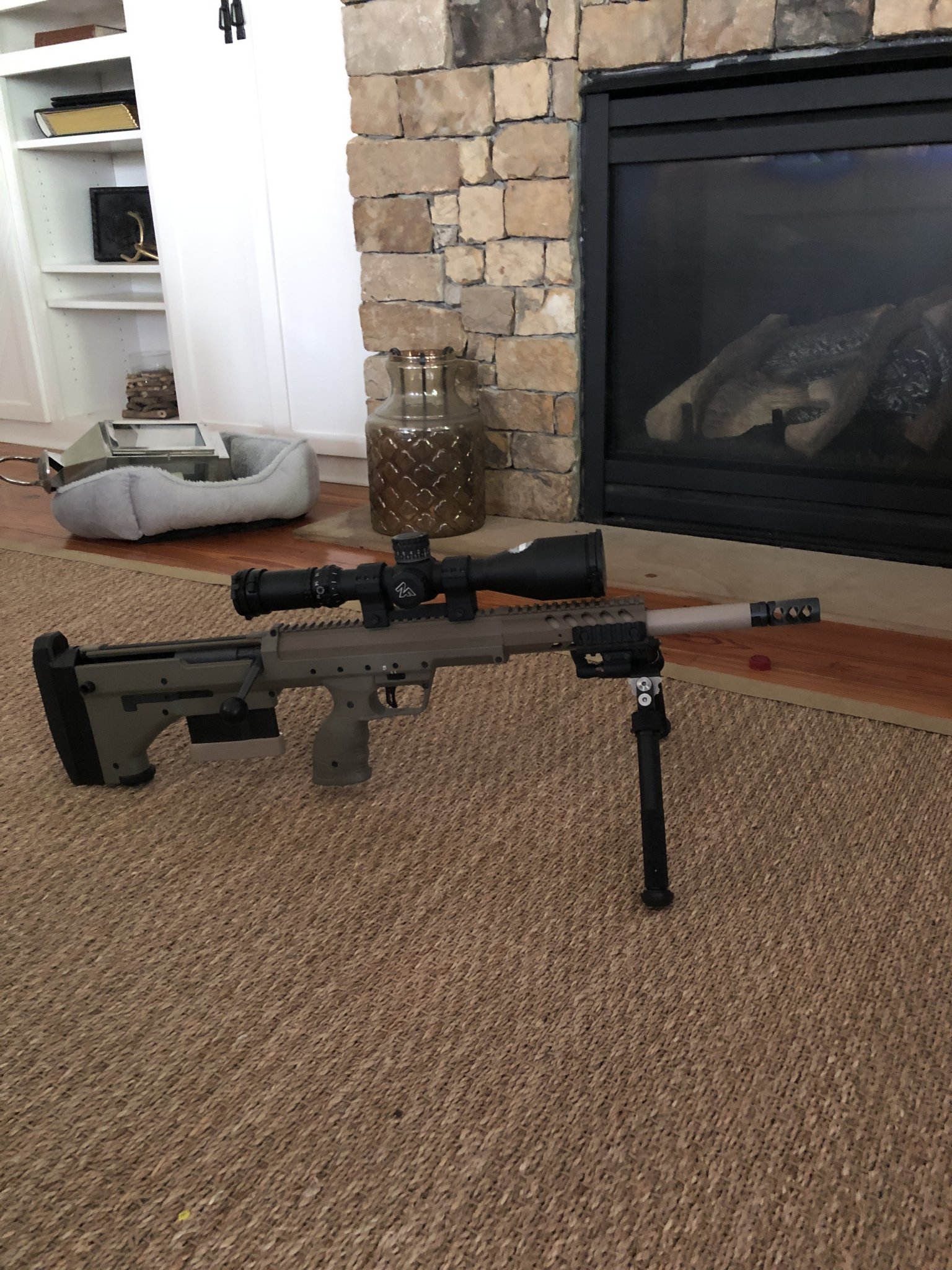

Hey maybe someone in this thread can point me in the right direction. I recently built a 22” 6.5 SAUM. Took it to the range today for the first time. the thing is a tack driver, BUT Using Bertram brass at 60gr. Of H1000 I’m only pushing a 130gr Berger at 2800 FPS this seems slow. (No pressure yet) Any advice? I am running 210M primers would 215M make a big difference? That’s the first thing I’m going to change.

@Mallardmilitia I am using 63.0 H1000 with Berger 130 VLD in my SAUM, using Rem brass and Tula LRM primer. I’ve not messed with Bertram brass but you should have some room to go up. Also, my Bartlein barrel was slow until I hit about 120 rounds, then it jumped.
Reactions: Mallardmilitia
So I’ve heard a few people talk about the velocity jump after break in how big of a jump did you see 50 FPS?
