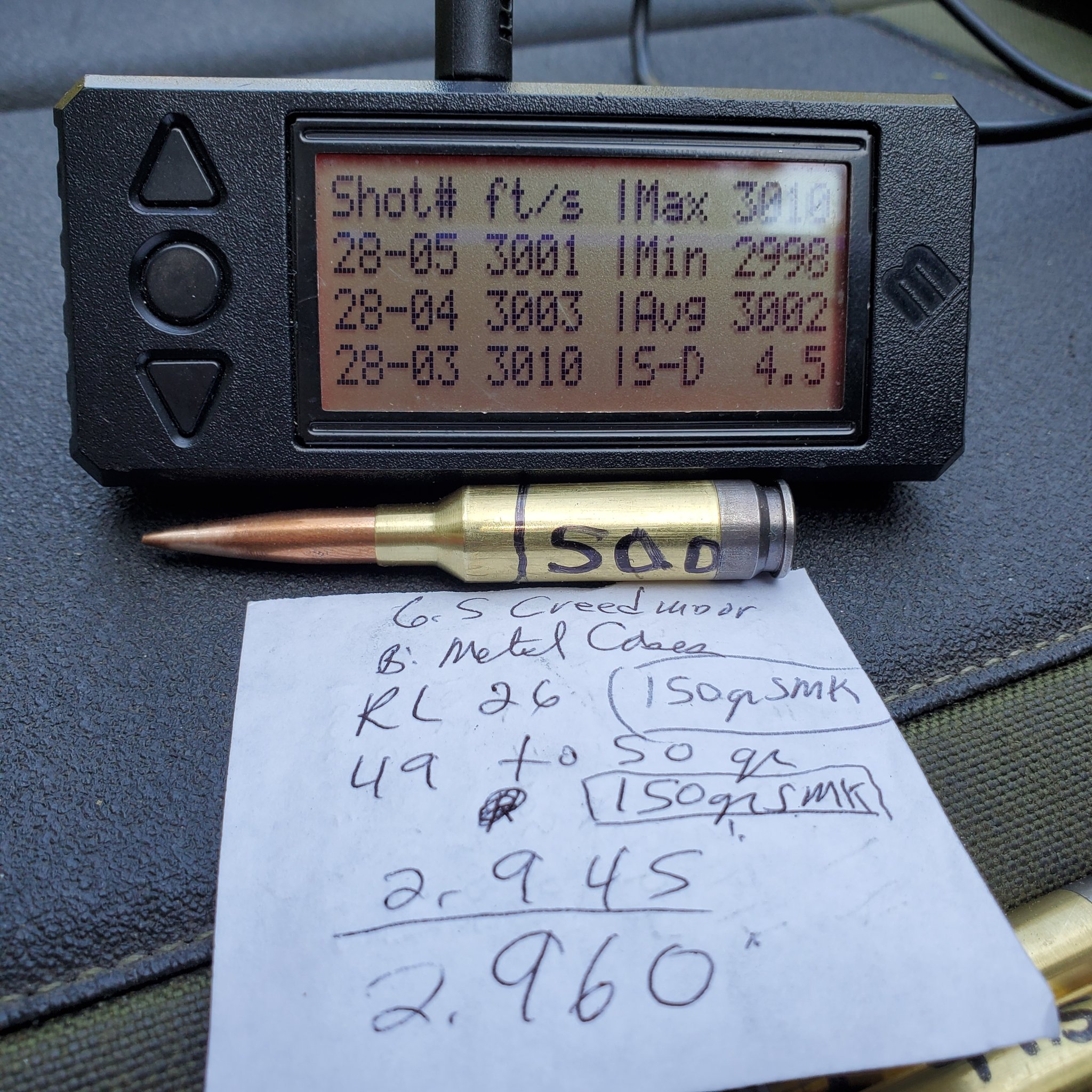

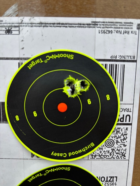

Here is RL 26 in 6.5 CM 150 gr SMK with hybrid 6.8X 51 reformed cases, in a factory 24" Ruger Precision Rifle.
I'm a big fan of RL 26 in quite a few cartridges, but can't get enough in a 308 Win case to beat out 6.5 Staball with heavy bullets, maybe the 250 Atip in long throat long action.

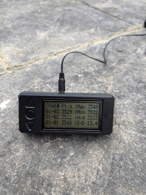

I have with the eld vt bullet. I have an 8 twist 28" barrel so my numbers are a little skewed, but I'm running 60 grains in ADG brass and I'm averaging 3660fps with no pressure signs. I haven't shot enough of them to get a good feel on e.s./s.d. yet, but it looks promising.
