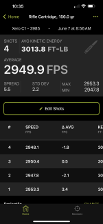

Spent the last couple of days working up a load with the Berger 156 EOL. I’m pretty pleased. Ambient temp was 77 degrees.
Defience Ruckus GA Hunter
Proof carbon 22”
Berger 156 EOL
New Lapua Brass
Federal GM210M
H1000 57.6grns
Velocity was 2949
EX 5.5
SD2.2
Coal 2.9725 shot the best and fits in an AW Mag.
CBTO 2.1880
