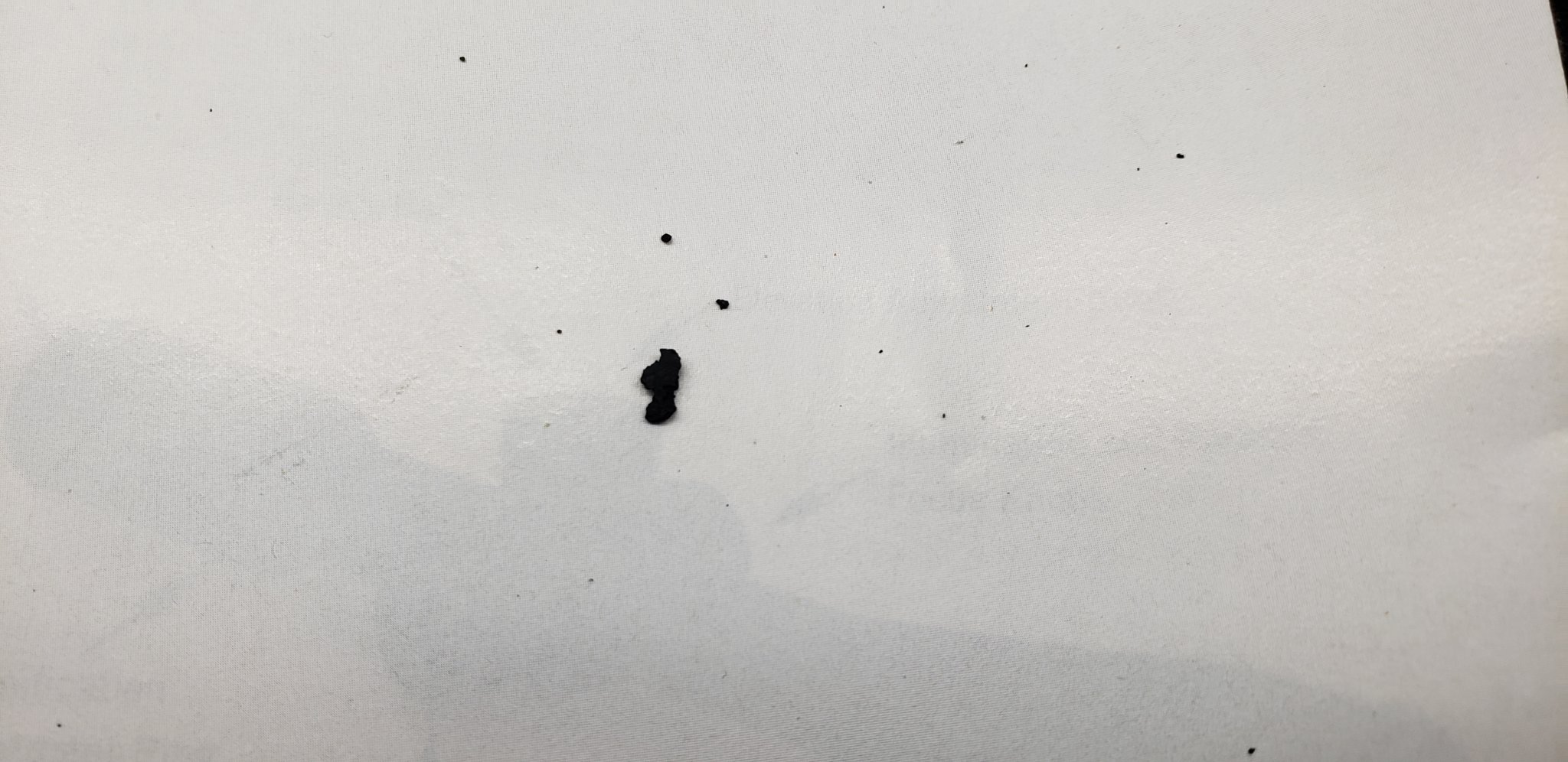

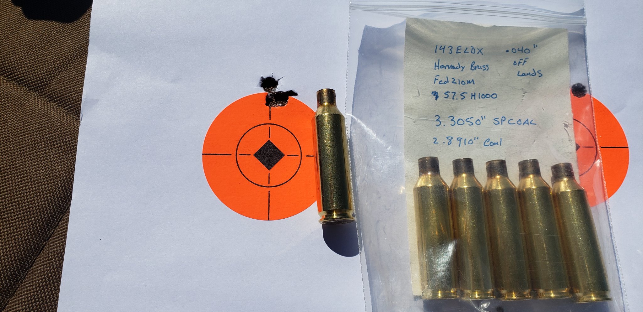

I have around 25 shots through my R700 in 6.5 PRC. I am going to get 100-150 before I do any load work.
My intended load is 143ELDX, H1000, Hornady Brass, Fed210M.

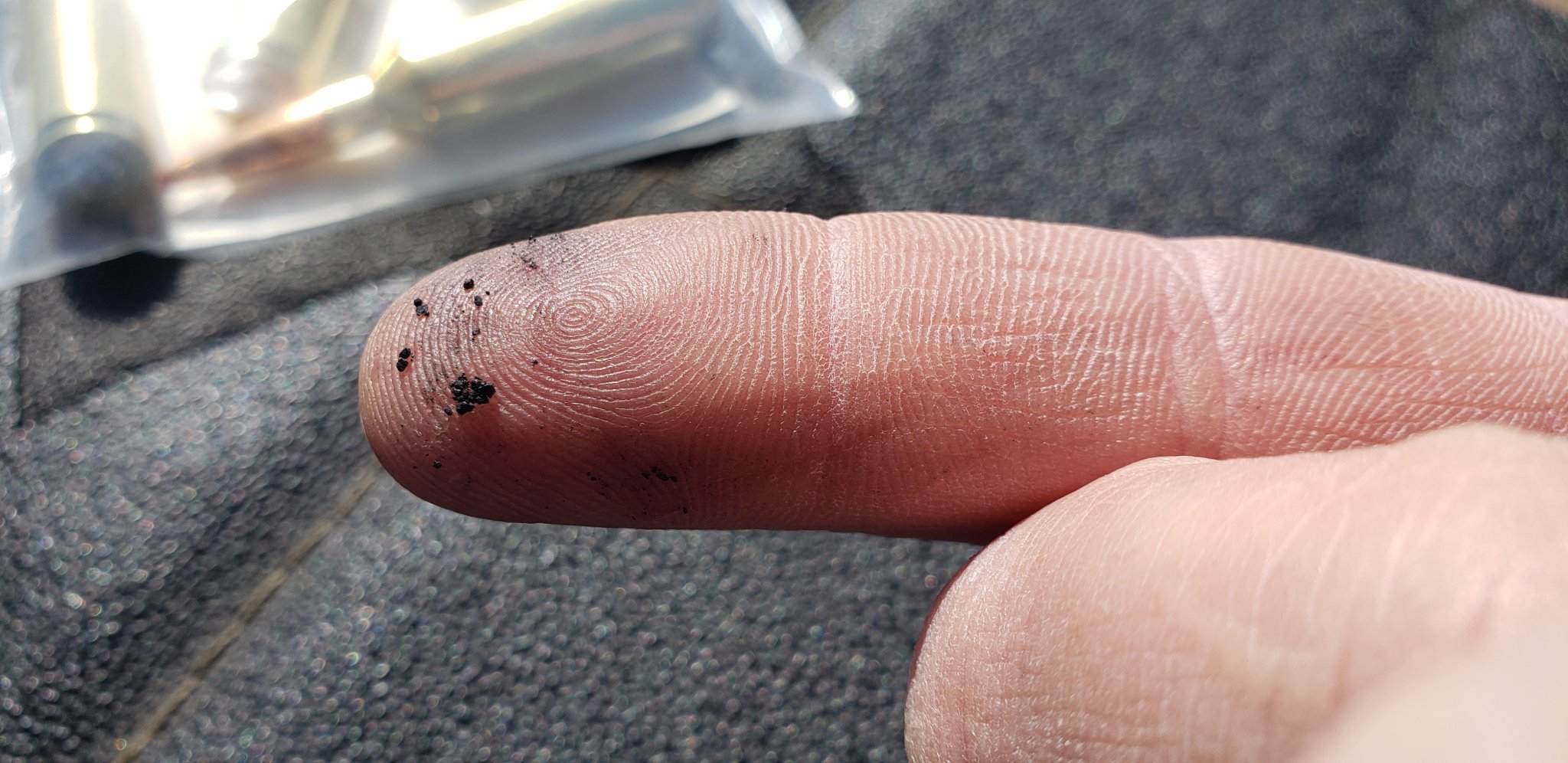

I loaded up some test loads to start break in and loaded from 56.0 to 58.5 to get a feel for pressure. At 58.5 (3 rounds) I noticed a pile of carbon, partially burned powder in the lower lug recess just outside the chamber. Think cat litter size. Nasty crap crushed in the action.
I never hit any pressure issues and had great accuracy, but this has had me seriously thinking about primer choice. All the literature I can find calls for a standard rifle primer.
I looked at the .300 RCM which the parent case to the 6.5 which calls for a magnum primer. I looked at all the flavors of short magnums WSM, SAUM and they all call for a magnum primer. I specifically looked at those cartridges in the 60ish grain territory and they all call for magnum primers. Perhaps the only outlier is the 6.5-284 and the 06' family of 6.5 Wildcats.
I tested some loads at 57.5 today and ran into the same unburned powder crud. Not as bad but
definitely there. As a aside this is fresh powder, primers are kept sealed up and 6 months old.
The only thing I can find on the topic is here:
And a discussion:
"Handloaders will get the best out of it using relatively slow-burning propellants like H1000, Reloder 26, and IMR 7828. However, unless charge weight exceeds 60 grains, handloaders are best served with standard Large Rifle primers rather than Magnum primers, unless the ammo is intended for a hunt in extreme cold, in which case Magnum primers offer a bit more consistent ignition."
Has anyone encountered this problem with the PRC ?
I attached some pictures to give a sense of what I'm talking about.
Thanks
