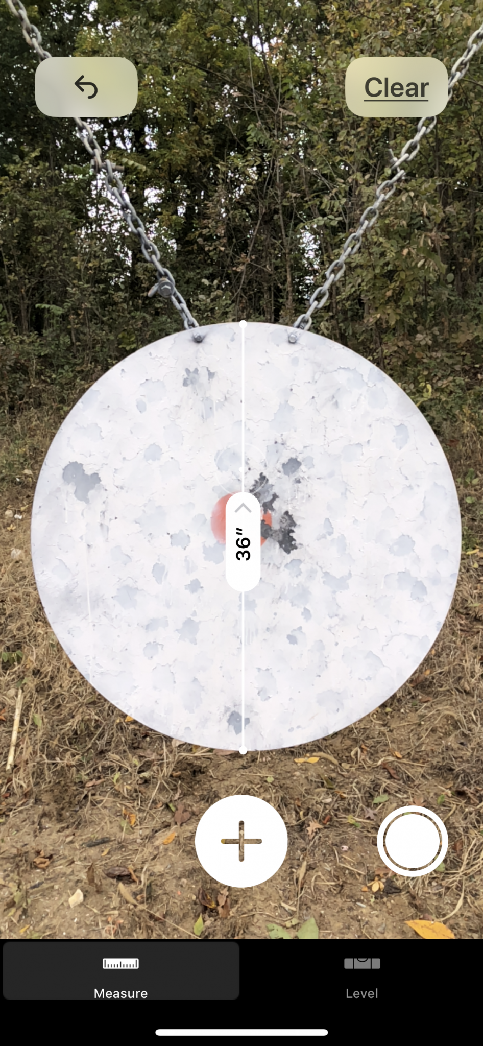

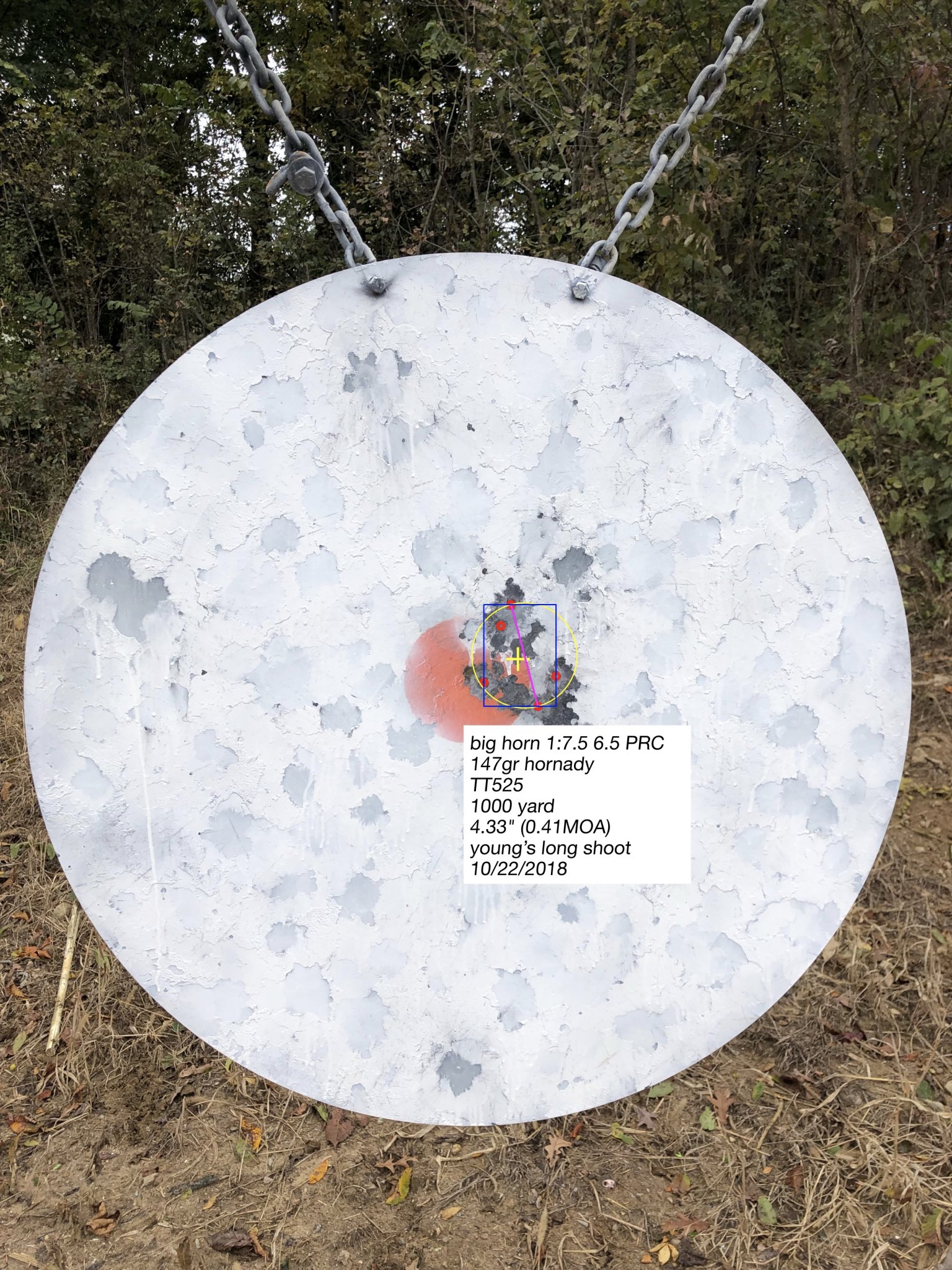

what can I say there are so many potentials in this round. I shoot my 6.5 PRC build to 1000yd with factory ammo about 2930 fps. here is some group photo. I am go to try some 150 smk and 140 beger hybrid this weekend.

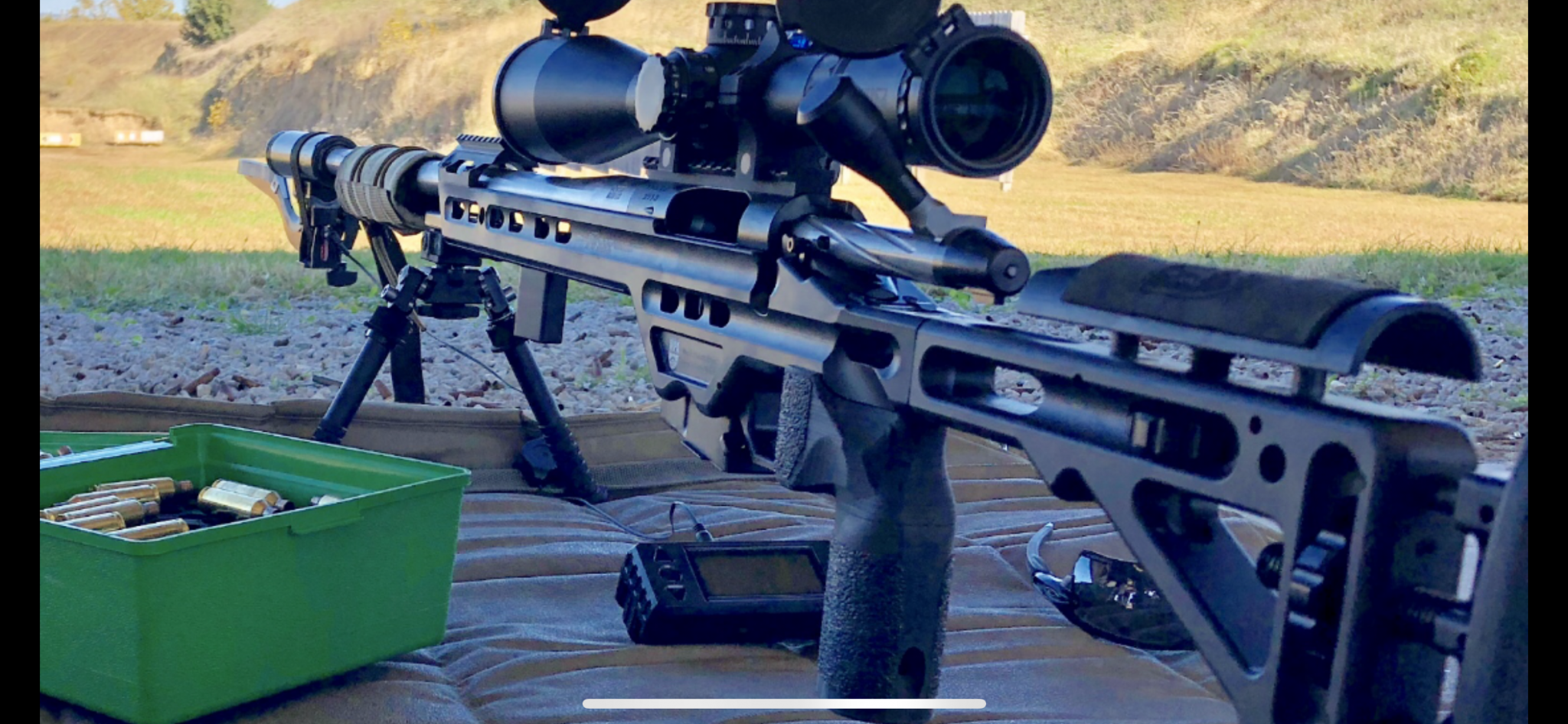

RPR 6.5 prc
147eldM
Hornady brass
Cci250
59gn magpro
2930fps
Sd 4
Shoots lights out don’t have any pictures of groups at the moment. With h1000 so hard to find I tried magpro. It’s working great not as fast as h1000 but groups just as good and easier to work with I have found. Zero pressure signs and I loaded some around 3010 but groups seemed to open up pretty good around 2980fps
