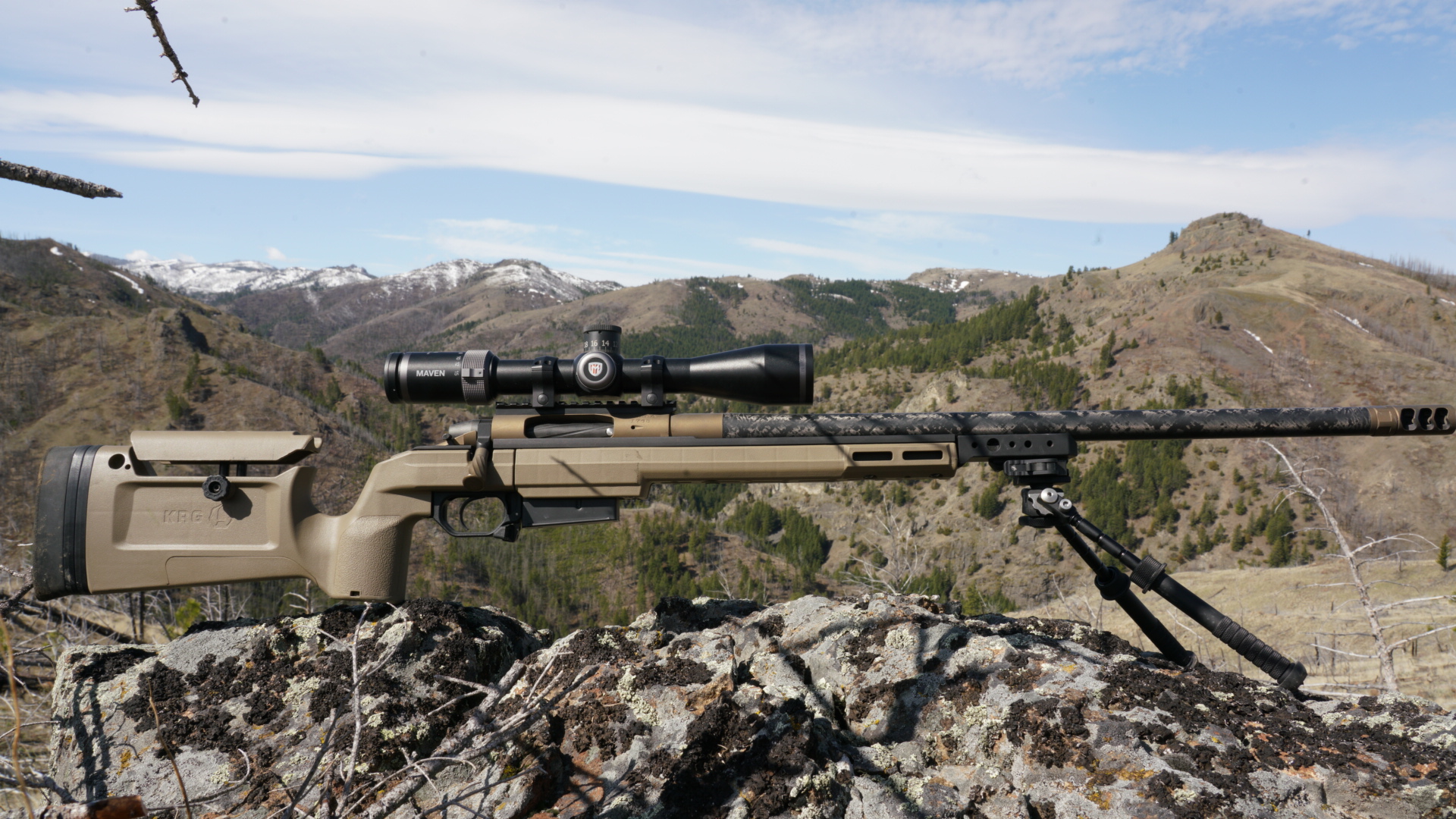

Does well on game. Took this bear here in Montana from 370 yards. Rifle is a PVA with proof 24” barrel shooting factory hornady 143s at 3050avg.

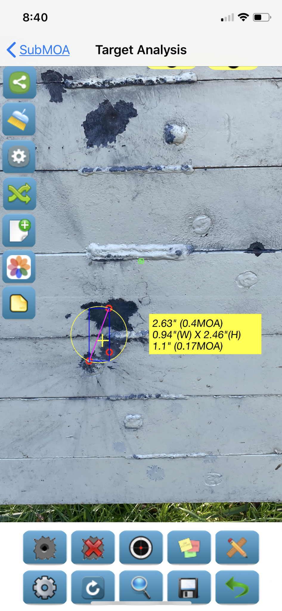

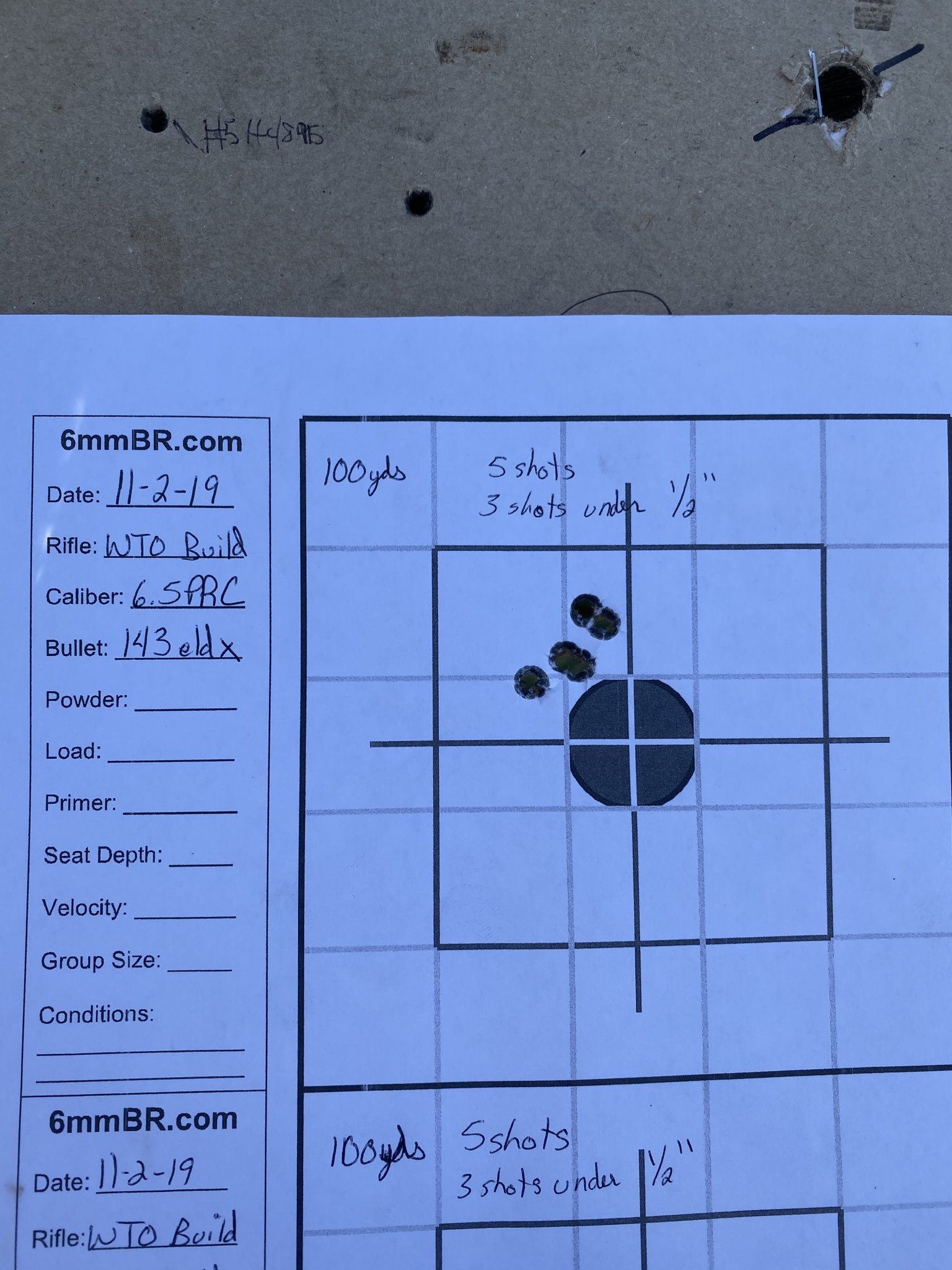

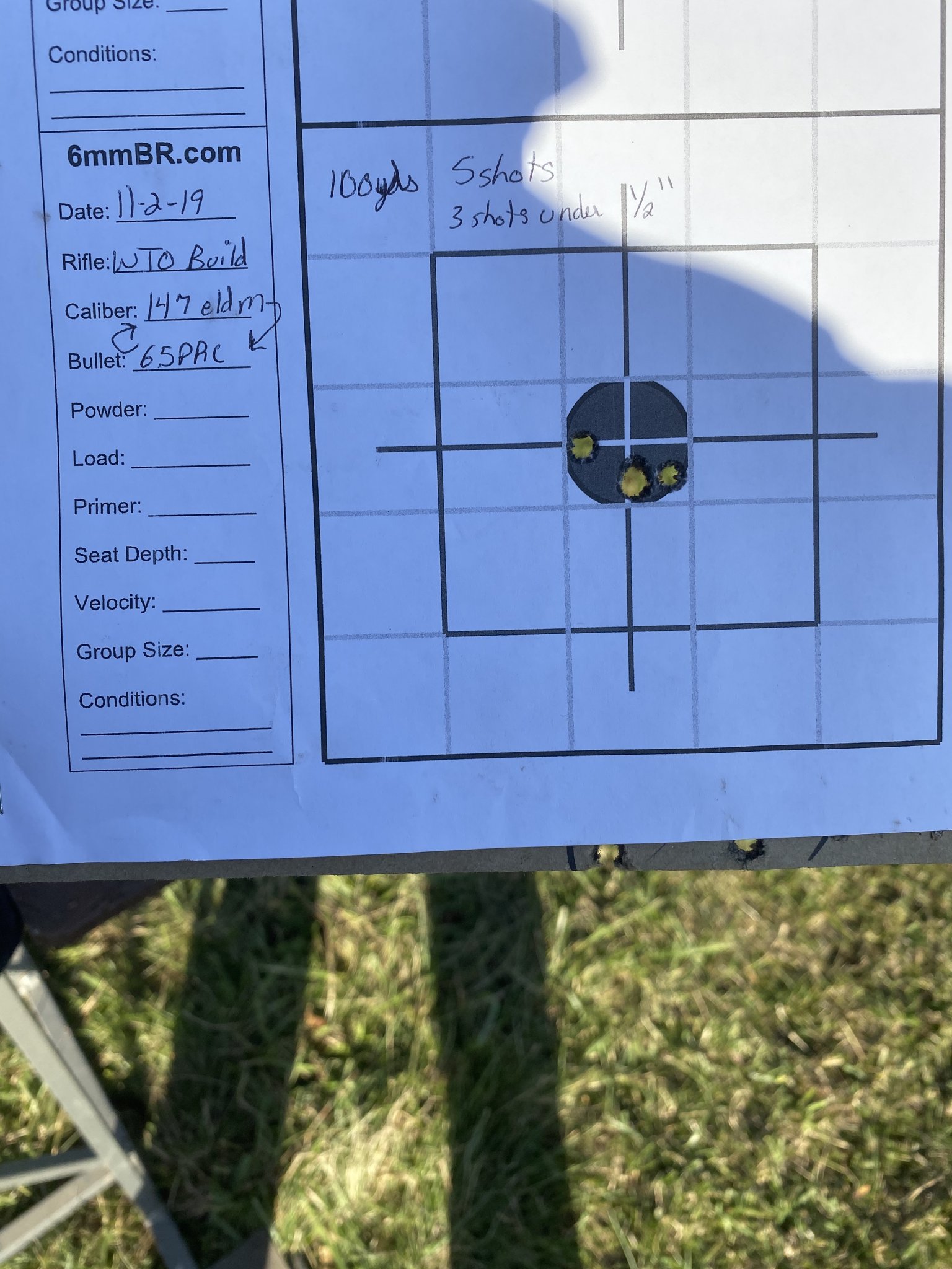

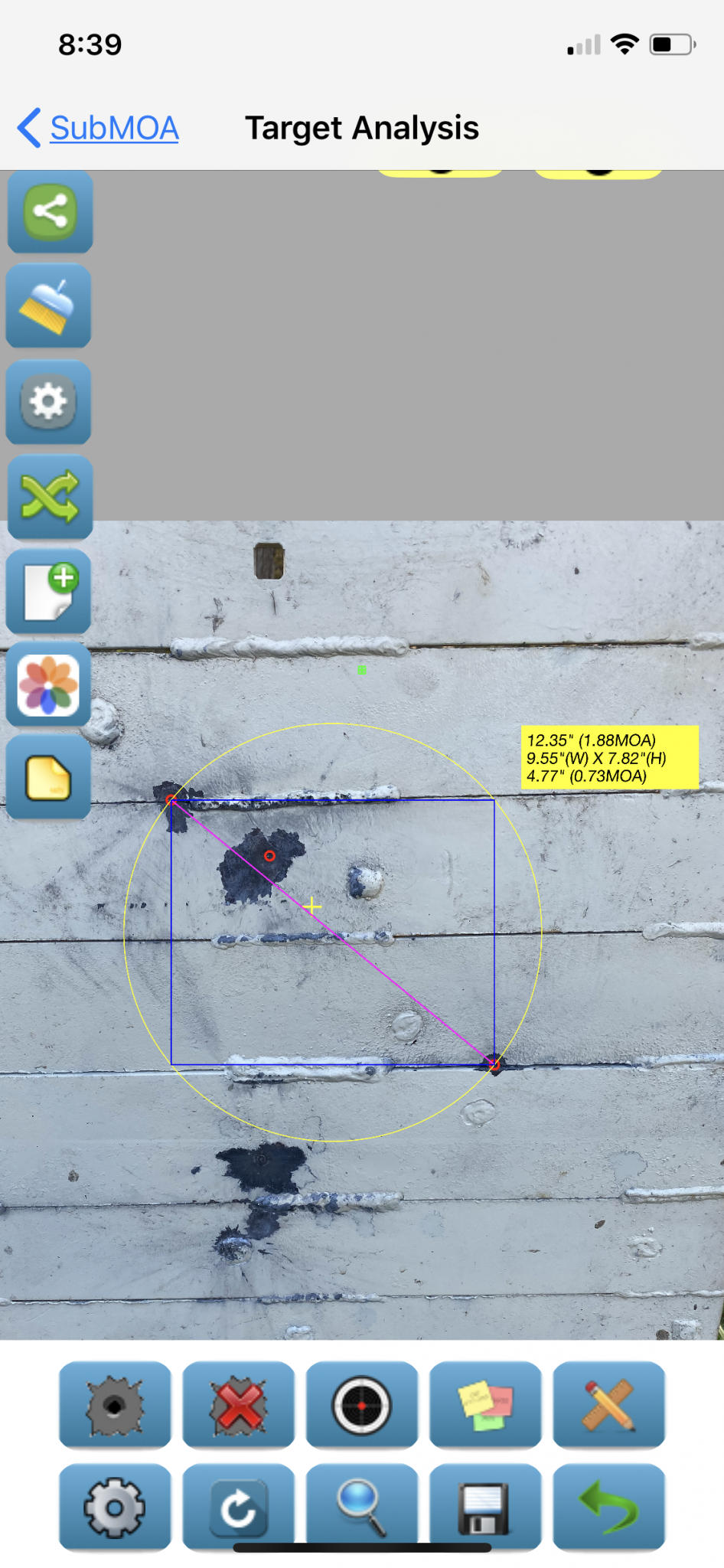

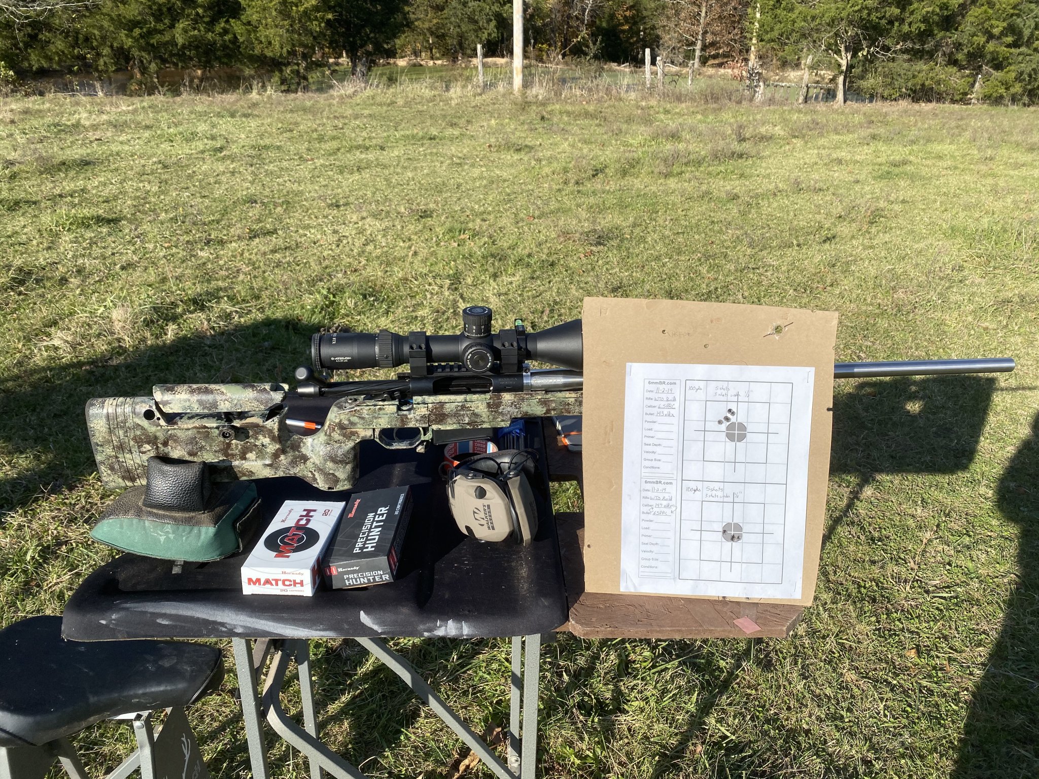

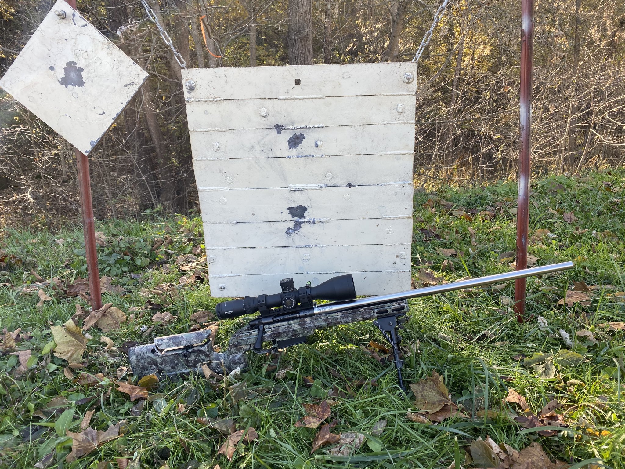

Welp Friday was a break in, zeroing and velocity check, Saturday was a confirmation and try to get the upmost accuracy as Friday I was in a very uncomfortable format(shitty rest, position, just plainly uncomfortable). Today was to take it out farther distance 628yds! I really enjoy the accuracy this thing can accomplish if I do my part. Top group is 143g eldx.....not sure what that horrid flyer was about but I doubt it was the rifle, the wind was a fluctuating some buck, idk. Bottom group was a 147 eldm. Both groups were 3 shot.
BCD4FB61-4E43-476E-BEA1-028D3019F40C.jpeg9952B6BE-B171-472D-B473-081D13FF6935.jpeg91F60C48-9966-4157-B39A-3EFD9549E1D8.jpeg3F2EEE76-31B5-4258-8A39-9E2CFA6DD9D3.jpeg39919E68-8668-4584-A1D4-98A51B35D010.jpegCDE720F5-6BE4-4F89-B1FD-DAC762150C8D.png20521AB1-E7B9-4305-8393-384997475571.png
Cool, IHFarmer07. Still waiting on my barrel... I'm eager to see how far this caliber will reach.
Ya I was wanting to have some load development on this thing by now but it was a little late to get to me, oh well. It came in just in time for deer season and the way it looks is good to at least that range. Anyway, was hoping to shoot a mile with it soon but now finding forester dies in this caliber is all on back order. Hope you can get yours soon to play with.
