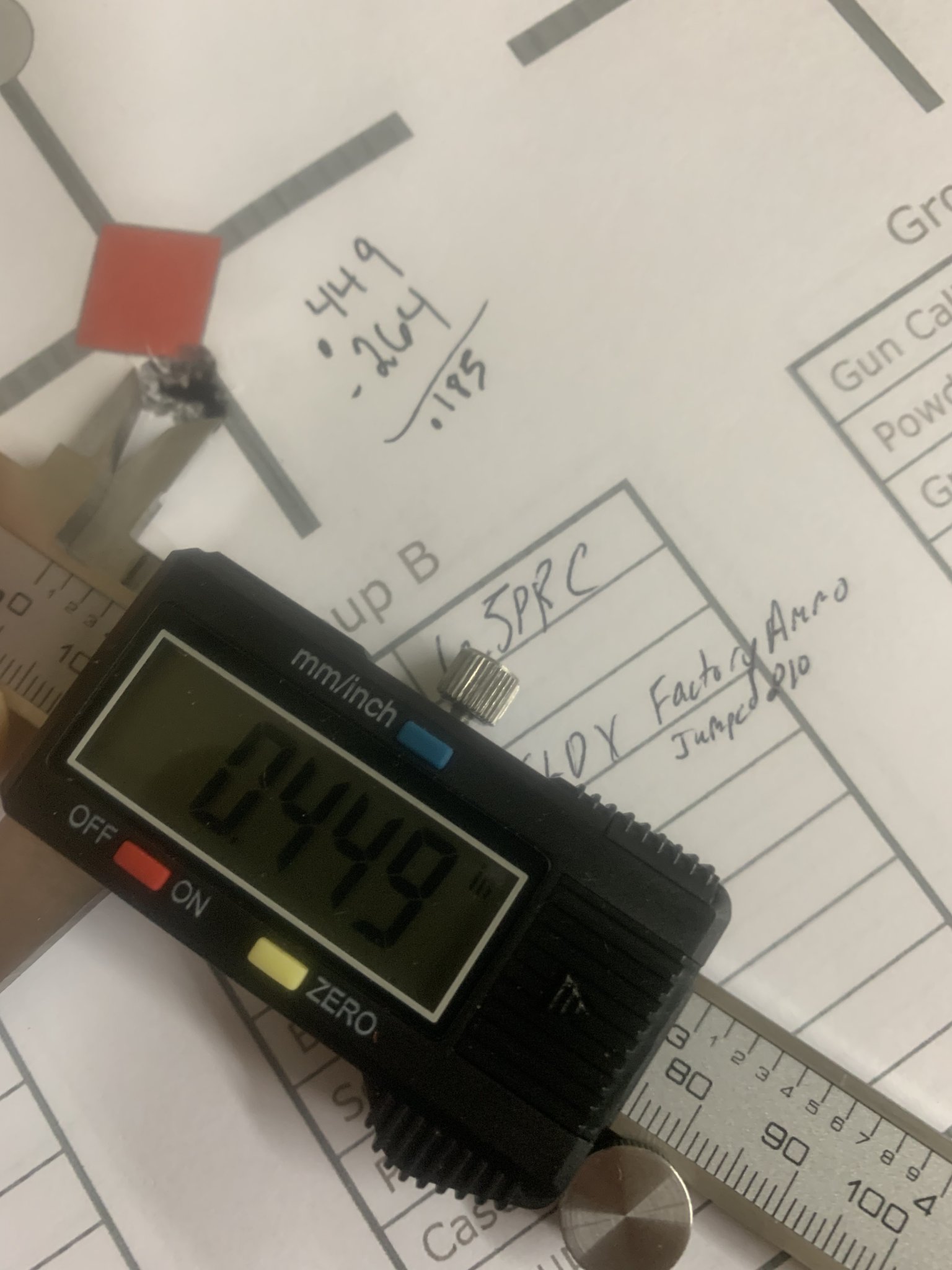

Something else to think about for the guys with the .130 freebore.
I was running low on my reloads today and wanted to go hunting so I took some factory precision hunter ammo with the 143 eldx and just seated them about .030 deeper so that I wouldn’t jam the bullets so far into the lands and it shot great!
This would even work for some of the guys that don’t reload but have a short free bore for some reason, a press and a seater and about 30 seconds to do a box of 20
This was the first and only group I shot before I rushed off to the deer stand

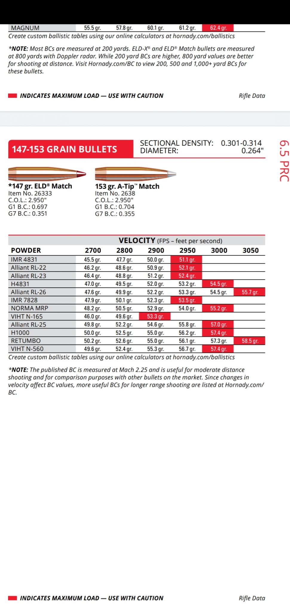

I personally found Hornady's load data w the 147 ELD to be very conservative. I think it had something to do w marketing. Keep the pressures under 54-55K Psi and round count goes up. Run them at 63-65k Psi and your around 1k -1400 rounds.
I'm having a hard time believing the 57.8 is max with the 156gr bergers and RL26. That is over two grains more then hornady book data for the 147-153 pills.
The guys I know who are shooting the 156 bergers all hit pressure well before that.
I haven't seen anything published officially yet but I would be surprised if that is actually the correct number.

I had no problem running the 156 Berger at 57.8 w RL-26. Again i ran Hornady 147 way over their book max. Im my findings, IN MY RIFLE HORNADYS LOAD DATA WAS VERY CONSERVATIVE.
6.5 PRC had 3 reamers that i know of. I ran a .188 FB and never jammed the lands allowing for higher pressures towards the top end.

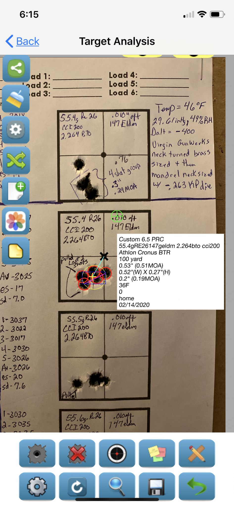

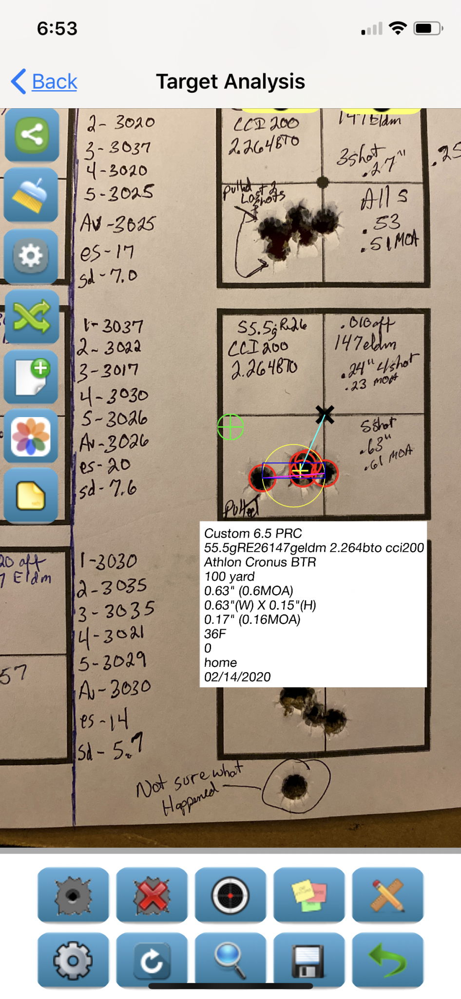

Weather: 41*F, 29.55inHg, 62%H.
Shot some loads to see if I can find pressure and see what velocity I can get today with Rel26 and IMR8133 all at a CBTO of 2.264 which is .010” off. Rel26 seemed the best between 55.3 at 2990-55.6 at 3016 with virgin Gunwerks brass and cci200 LR primers using a MS V3.
Quick Load predictions using ADG’s average H2O weight of 66.9gr yielded a 2950 for 55.3 and 2965 for 55.6. At 56g of reloader 26 I got 3022, but to be nice to the barrel I’m going to stay around 3000fps, so I didn’t need to shoot the 56.5g re26, I did not see any pressure signs of any sort.
It shot the 55.3, 55.6, 55.9 into a 1.44” group at 300. Probably be playing with 55.3-55.6gr loads at differing cbto’s.

Heres the first outing on seating depth test on a powder charge that I thought would be close to my goals for velocity.
Not sure but for now I’m going to try the 2.264” cbto 55.4gr load(top right) again to see if that flyer wasn’t a fluke and then 55.5 and 55.6 at 2.264” cbto to see if I can shrink the group maybe, idk. If that don’t pan out I may retry the 2.224” cbto and 2.234” cbto(top two on the left) with a tenth or two more of a grain on those and see what that gets me. Idk hopefully I can find something without using up too much of the pixie dust powder!
