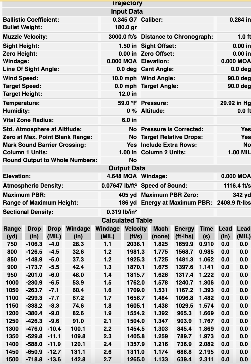

I'm really giving the Gunwerks crew the benefit of the doubt: 180gr .284cal 0.345 G7 @ 3,000fps MV
It was dumb and unethical to take a shot on an elk @ >1,300 yards based on energy alone. That round drops below 1,500ft-lbs before 850 yards. That doesn't factor in the specific shooter's ability (completely missed the first shot).
