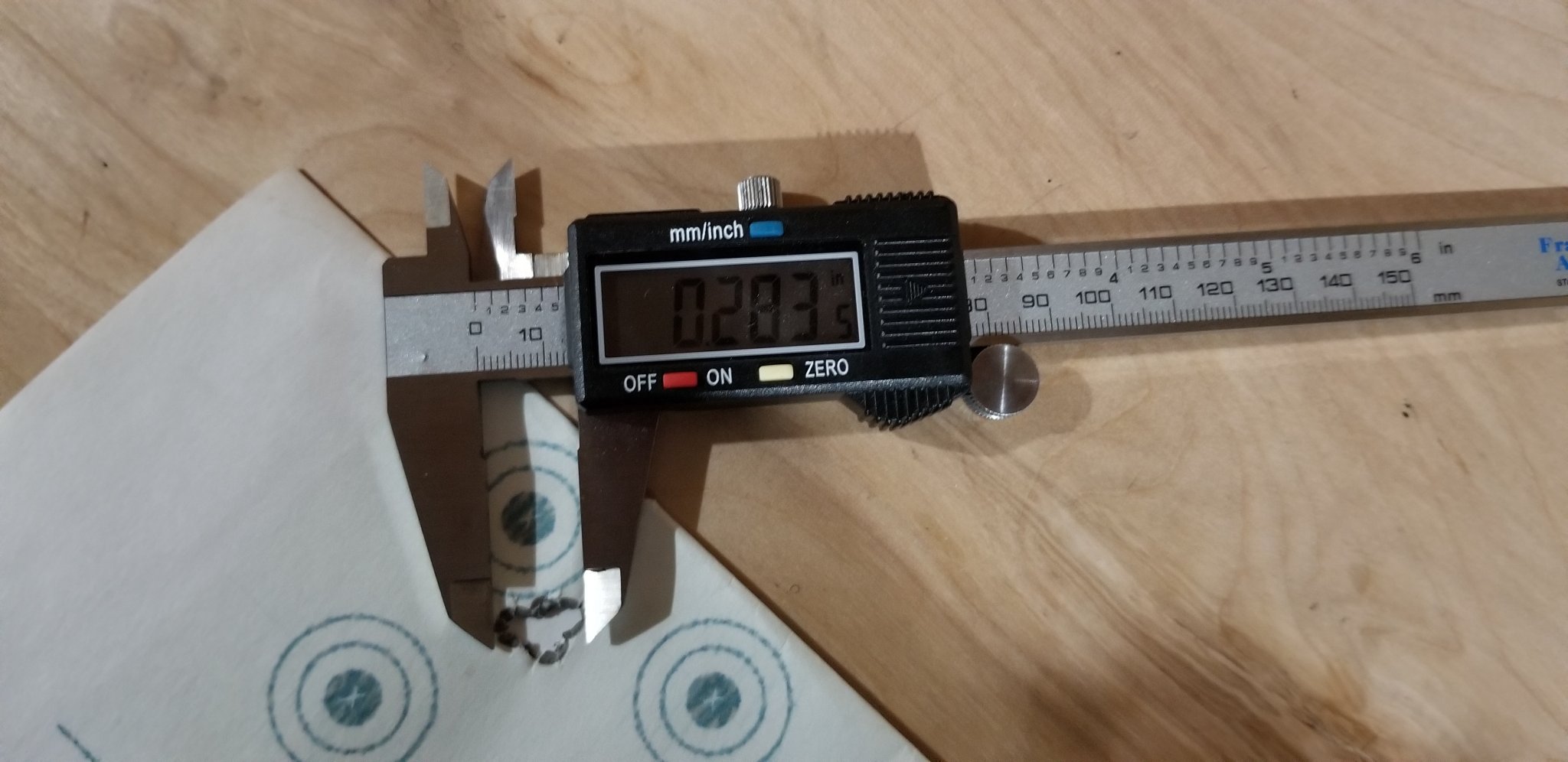

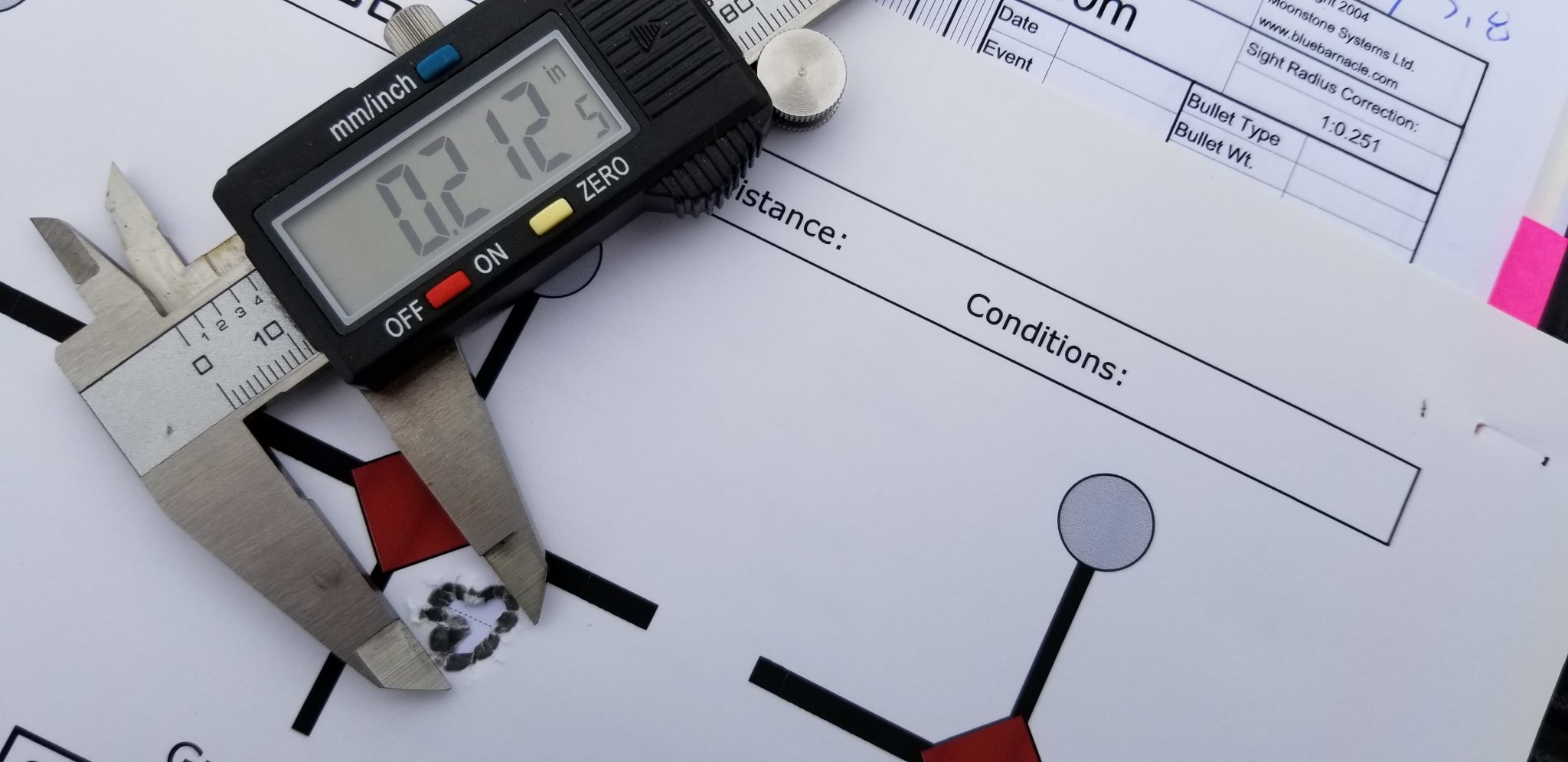

Chronographed some loads today 37.0 and 37.1gr Varget 26" Hawk Hill with 150 rounds on the barrel
Targets were @ 100 meters
First one is 37.0gr Varget Avg 2716fps ES 17 / SD 7.0
Second one is 37.1gr Varget Avg 2724fps ES17 / SD 6.5
Velocity is a bit low and ES/SD are high but it was Virgin brass atleast accuracy is there... it was only 9 degrees celcius out today and maybe barrel will speed up

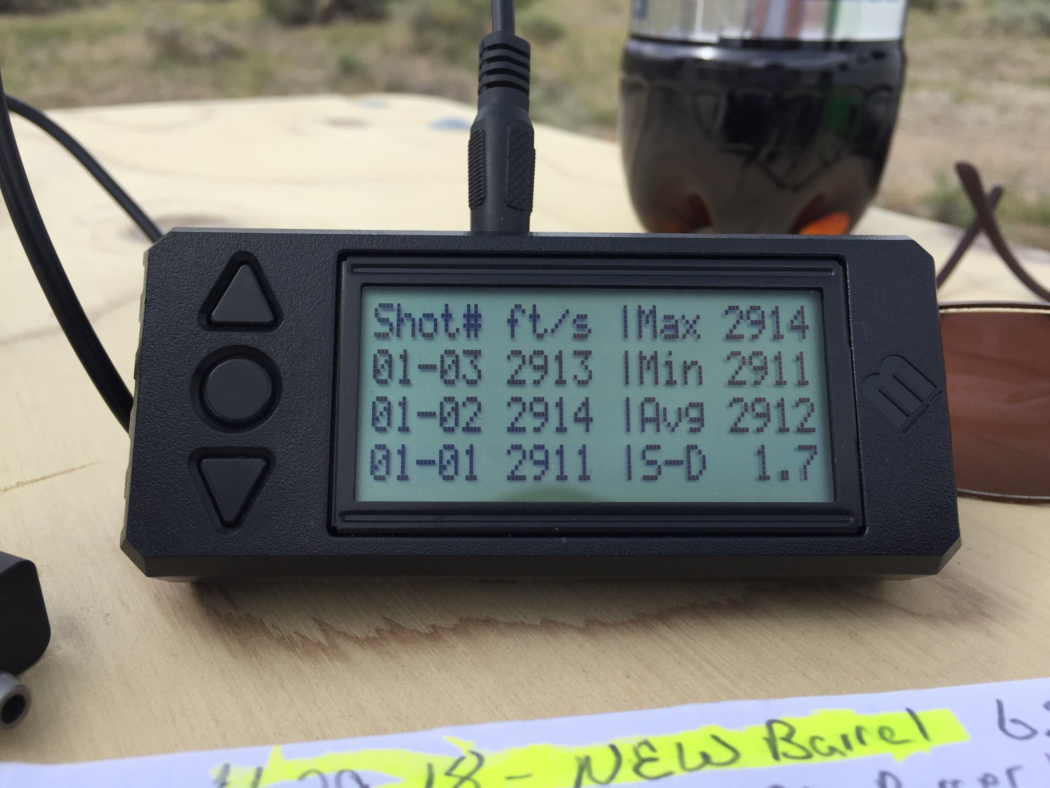

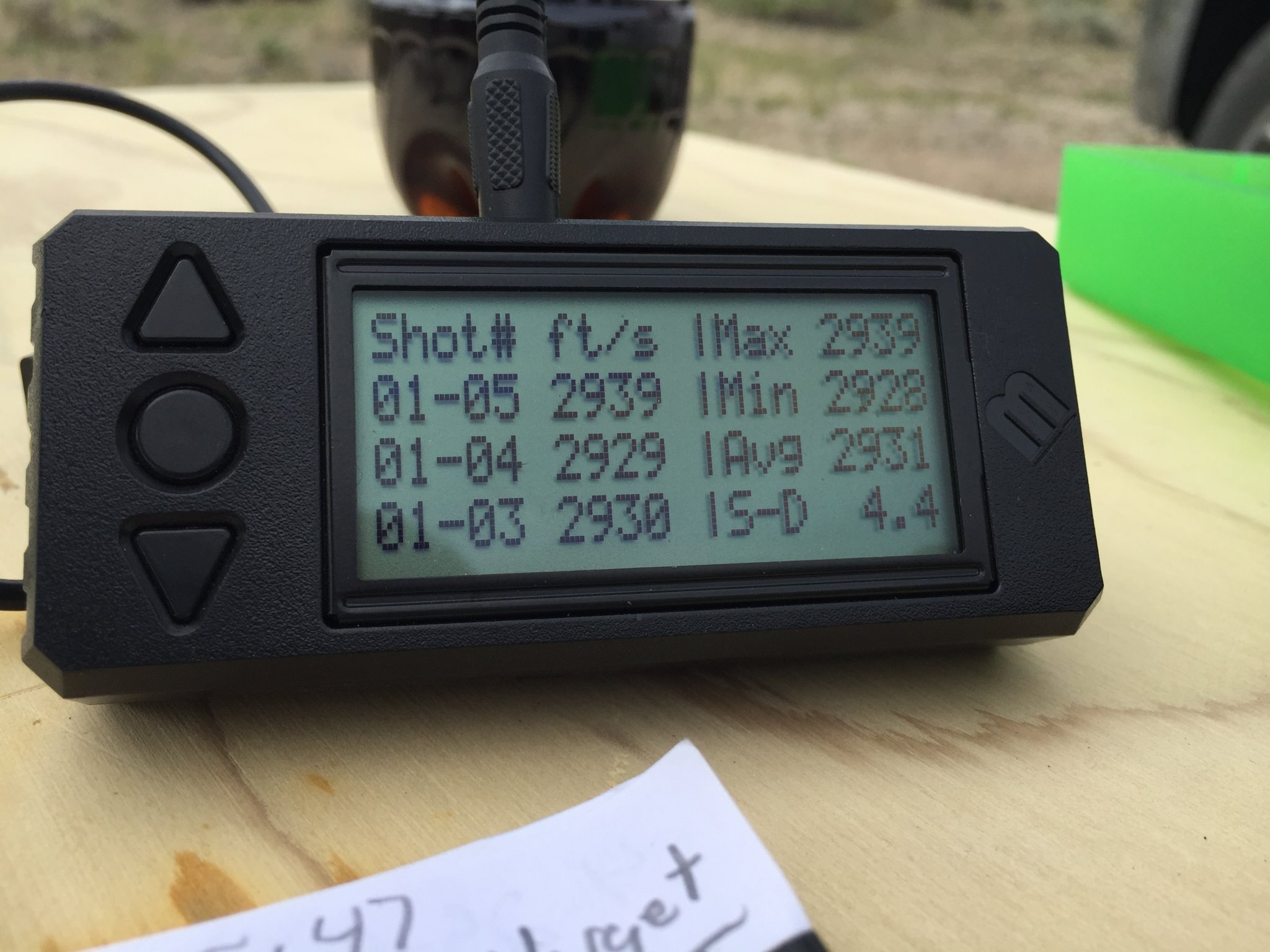

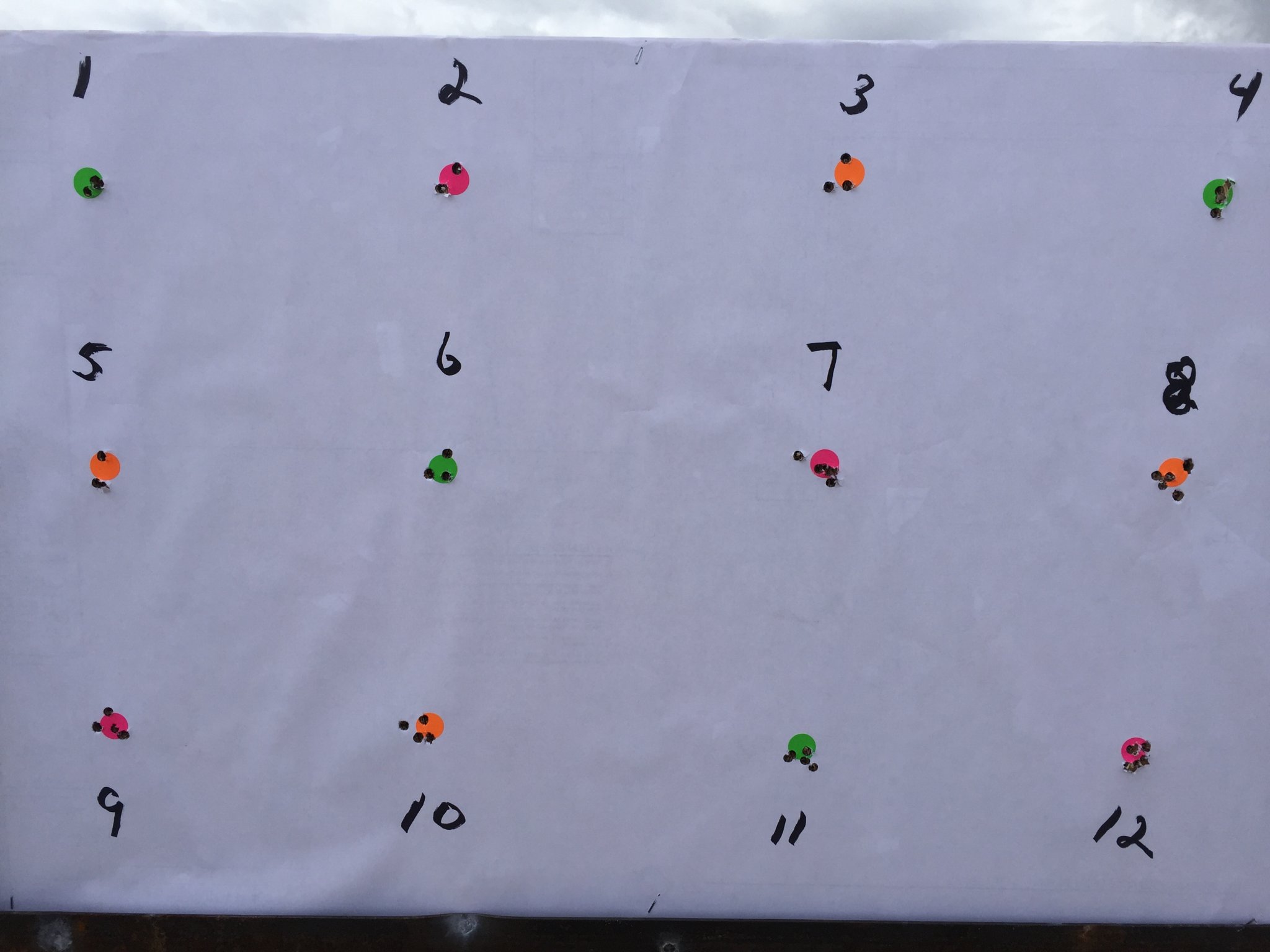

my last barrel quit shooting at a match saturday so i swapped barrel saturday afternoon and went out sunday and shot the new barrel.
new lapua,varget,fed205m,130g berger hybrids .020 off the lands...below is after 13 rounds of break in...i know i know but im one of the ones that believe that a little break in to clean up the throat is a good thing.
#1-#7 37.9
#2-#8 38.1
#3-#9 38.3
#4-#10 38.5
#5-#11 38.7
#6-#12 38.9
first is #5 second is #12...i shot this off a bench and was only my 3rd time shooting off a bench

Yup mine is the same but velocity is just lower how many rounds do you have on your barrel?
I have 168 rounds on this barrel. I did have to retune my load around the 100-120 mark to get it back to shooting in the .1s and .2s again. Its a Jon Beanland build with a .170 throat.
i shot a long range varmint silhouette yesterday with the 38.9g varget 130g berger hybrid load...i shot a 30 outta 40 possible...velocity started at 2930 and ended at 2960...124 rounds so im pretty sure the barrel is done speeding up...there is no doubt when the 130 hits the coyote at 850yds.
im pretty happy considering i had no data..new barrel(only 50 rounds through it)and contour..new bullet...this will be my combo in the 47 from now on.
